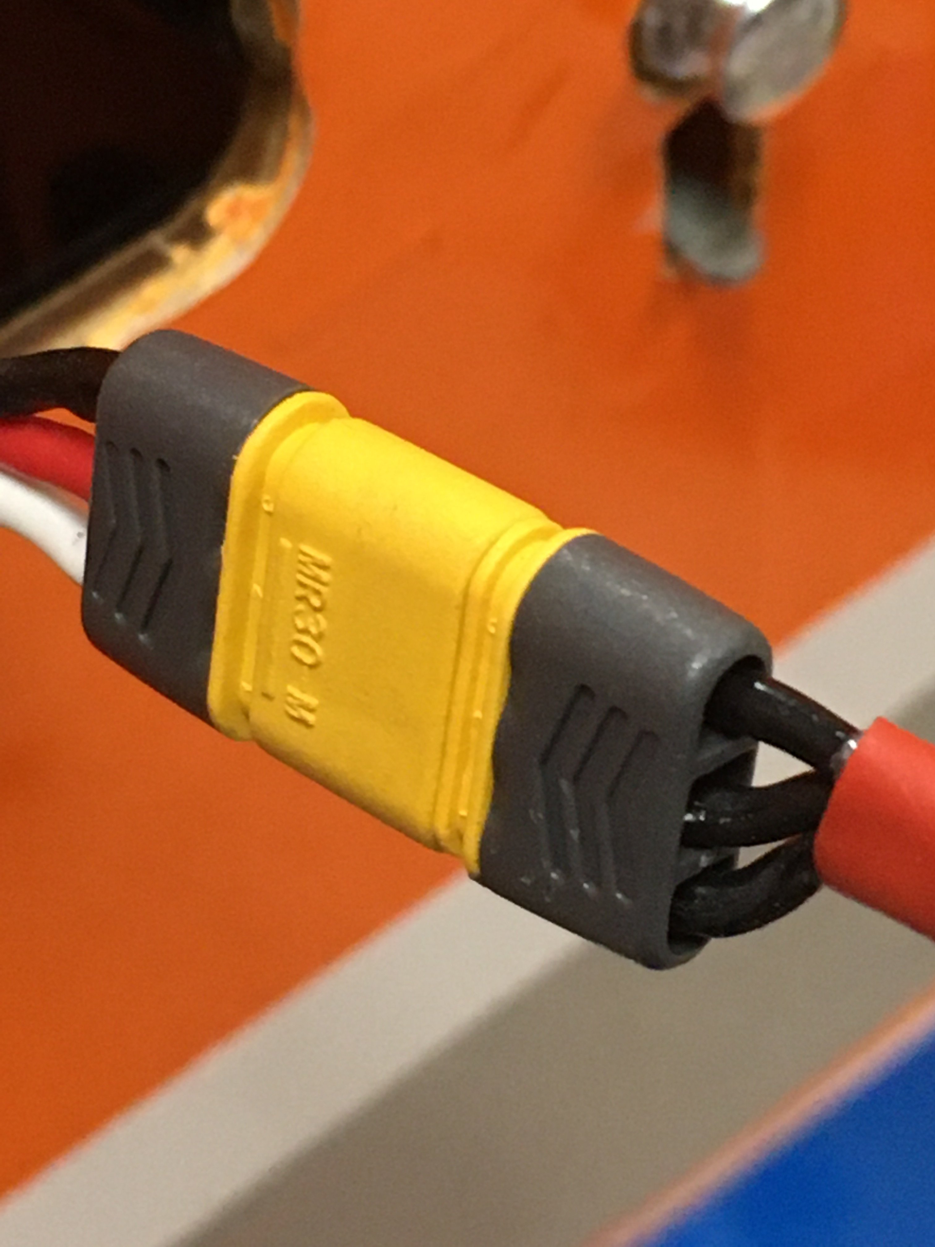

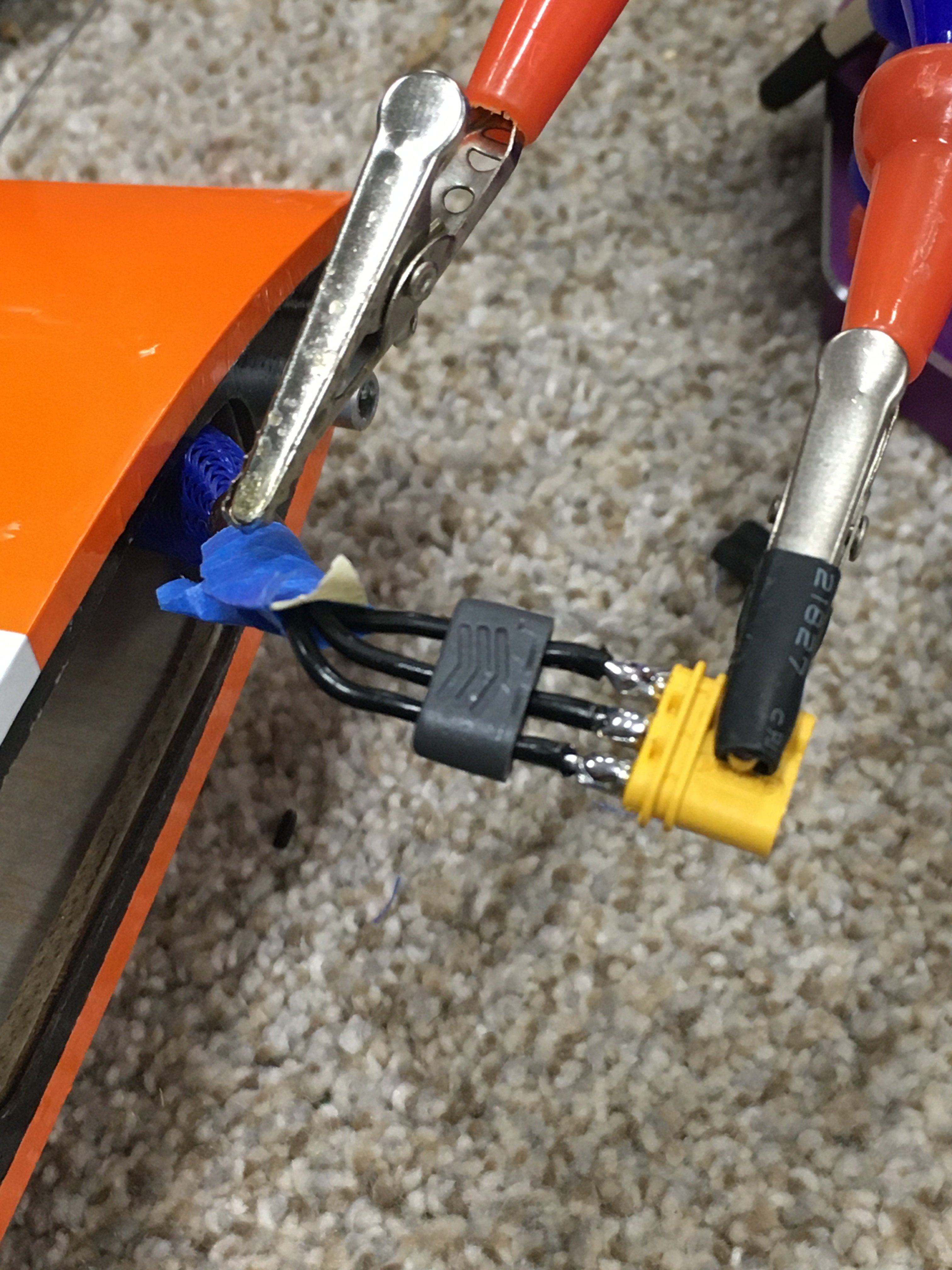

The AMASS MR30 connector looks promising. Can you take a picture of a normal servo connector side by side to get a perspective of size. They look very interesting the only all I need right now is another different one in my collection but they sure look good.Trying something new. I saw a post on social media a while back about using AMASS MR30 connectors for tail servo connections. No need to use a locking mechanism and they are polarized.
They feel very secure.
View attachment 115487 View attachment 115488

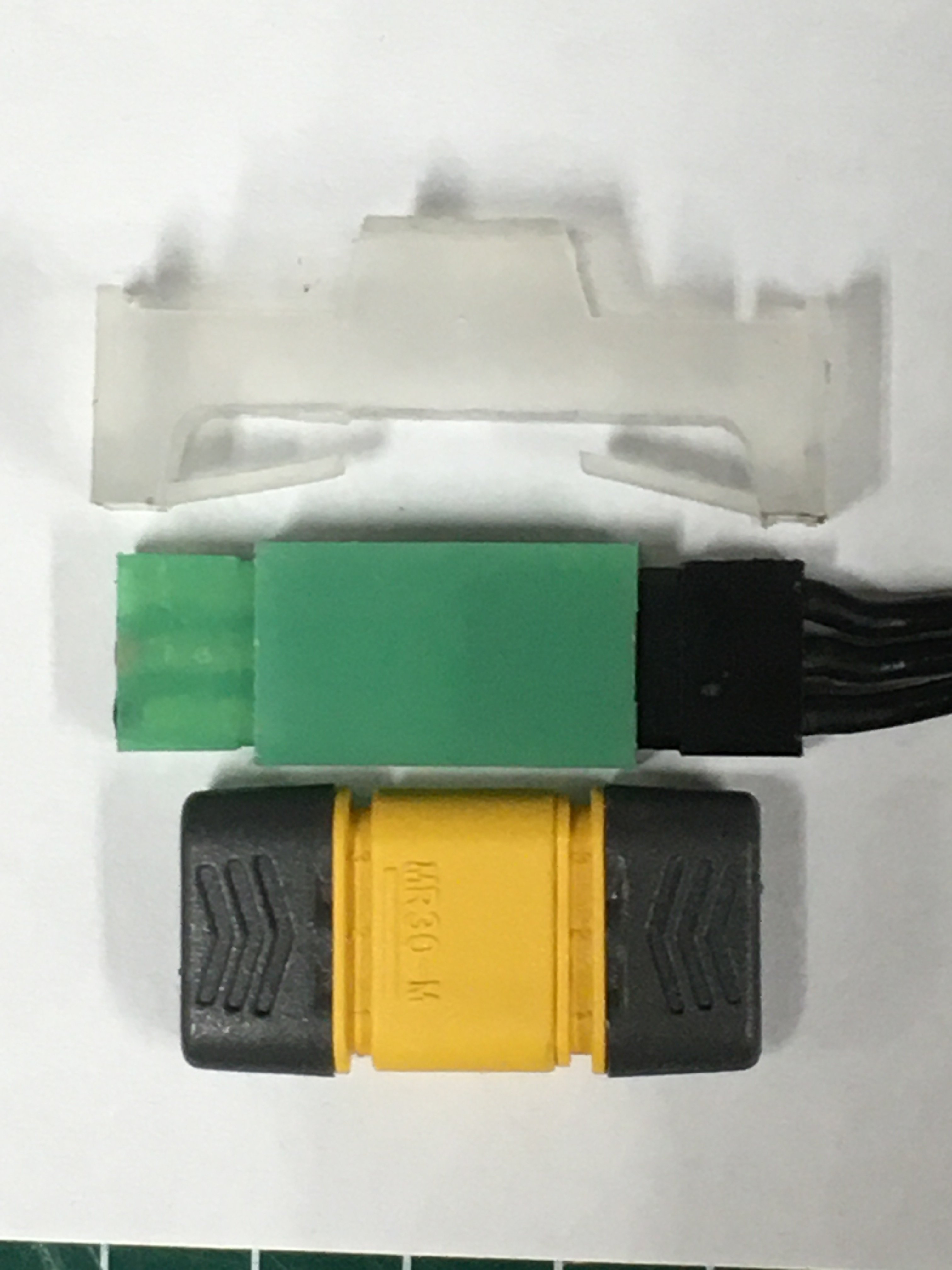

Thanks for that, looks close enough for me in size and capability goes from 5 amp to 30 that is a win win for me. Will see if I can buy some in bulk like 10 or twenty pairs. This will give me the ability to up grade as needed. One question they do not need any additional support to hold them together.here ya go. Not as long, little bit wider/taller but not by much.
Thanks for all the infoThey are about as hard to take apart as T connectors/Deans. . . so a decent amount of effort required (they are small too) therefore no need for additional security like servo connectors need. This is my main reason to use try and use them.
