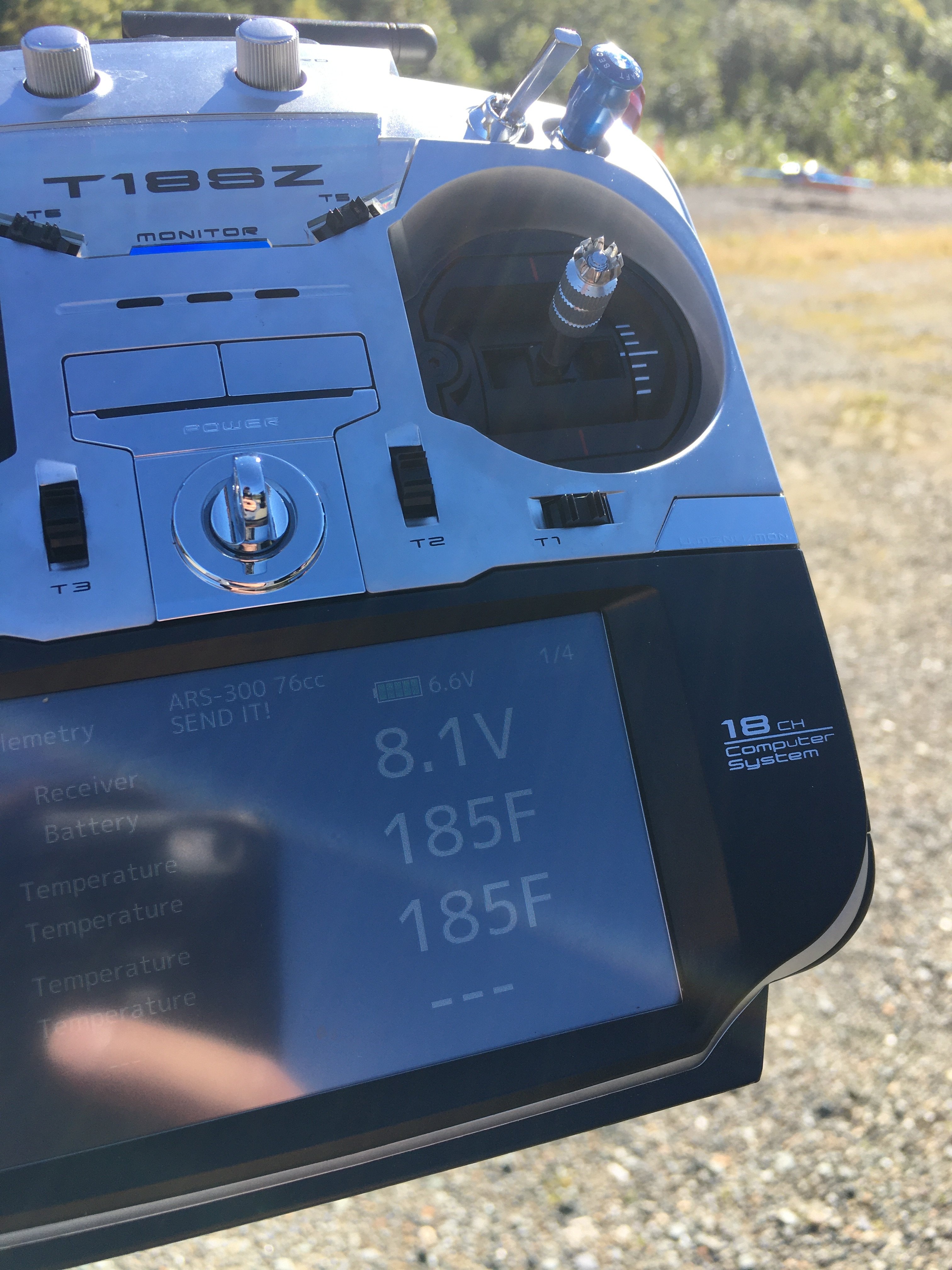

In flight just under half throttle and above the temps climb again. Hovers around 275F but rip roaring around it after a couple laps temps are shooting to 300 and well above if I let it.... the only thing I want to try now is an air dump for the cabin somewhere. As when I open the canopy there is a lot of heat inside. #2 likes to run hot.
