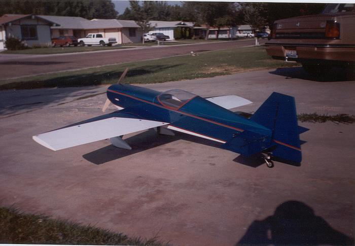

    To answer both questions... old school to me is make up my wing skins for each side of the wings, stabs and fin/rudder. I will then glue them into place with the cores in their perspective shells laden with equal heavy pressure covering the entire cores. Like you Doug, I just can't justify purchasing a pump and all the accessories to build one foam core plane. The three previous foam core planes I built came out beautiful and flew amazing. There are many people like Terry Wiles, Joe Mitchell and Randy Hinton that are far ahead of the game, (and me for that matter) that I totally get why they use them. I just don't build enough let alone foam core to make it worth the expenditures.
    Here are a couple of photos of the foam core planes I built a number of years back. No vacuum system.
    Ok, one. I can't seem to find my photos of the rest. Maybe on my other desktop pc? You've all seen my Lanier Extra. At any rate, this is my old school way.
