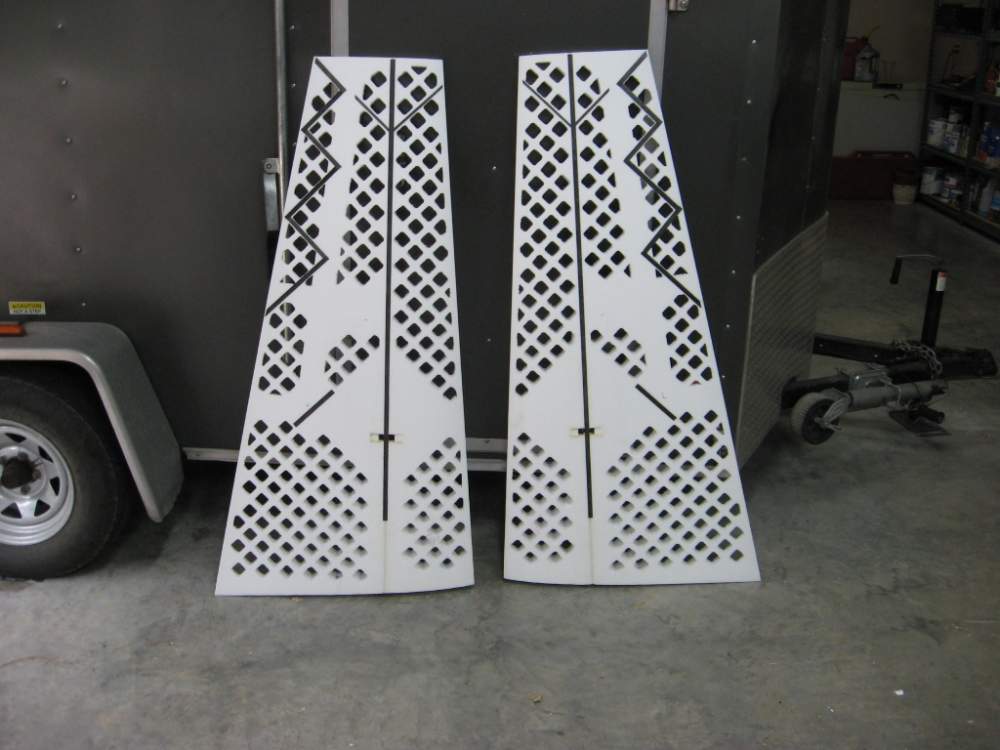

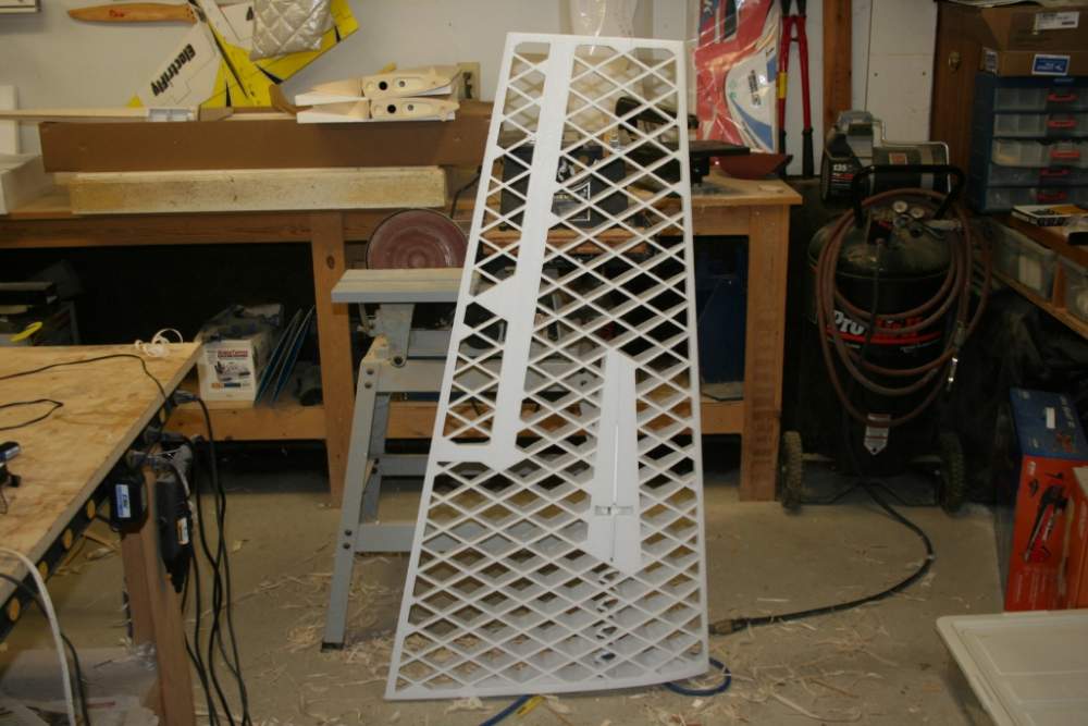

Did a little research on coring there is basically two ways of doing it the octagon or the triangle cut outs this is the best way to control loading distribution and not end up with concentration factors. The tow attached show how it is done one is normal and the second one takes it to extreme. Just something to look at.

View attachment 100937 View attachment 100938
The 2nd photo was one of the core jobs I was thinking about. :applause:

Guess I would have a "LOT" to learn about the new way of building these days. This to me would be more work than I really would want to bite off. Plus, is it really that strong once it is sheeted?
It is not as strong but if you do core the foam you need to do carbon strips to reinforce the wing. If you look at the top wing the person has started to add carbon fibre strips.
