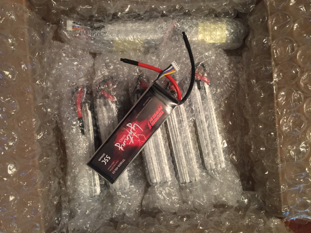

ImageUploadedByTapatalk1440420243.433559.jpg. Got some fresh Thunder Powers for my Slick! I've Slowly converting over to thunder power only for batteries and now I'm complete!
