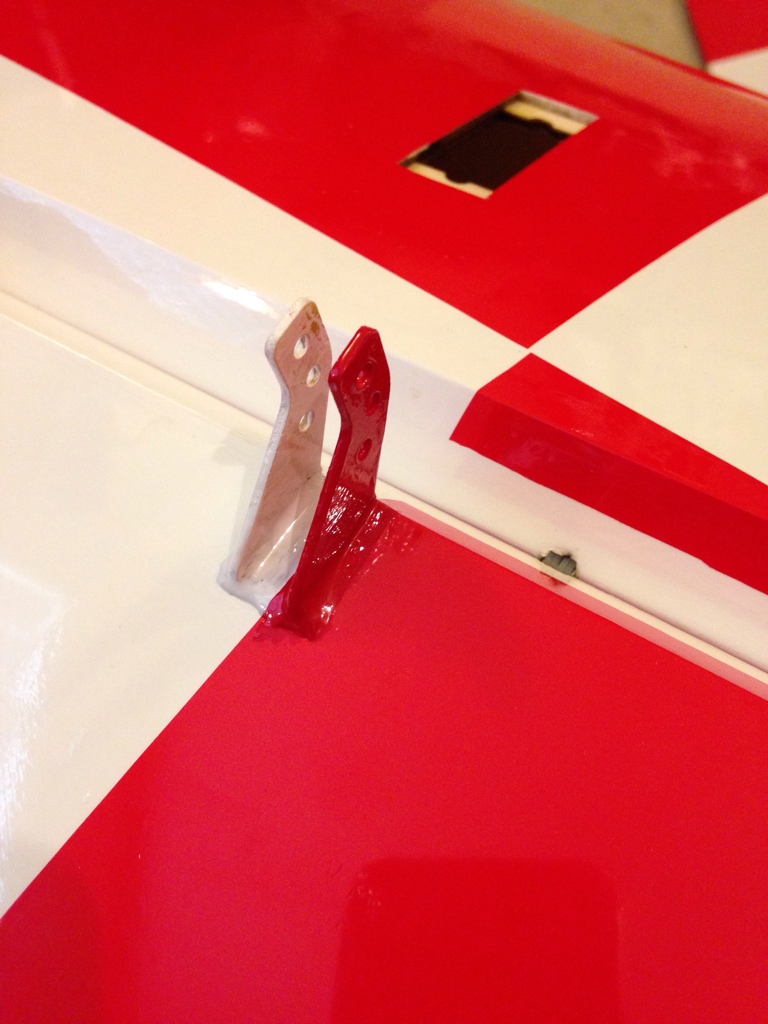

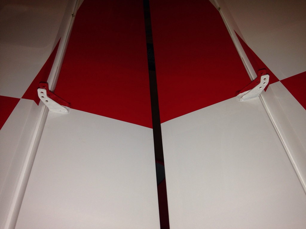

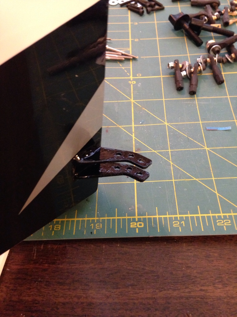

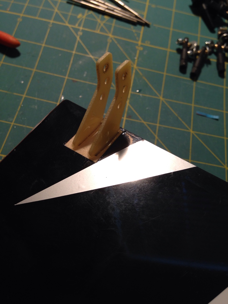

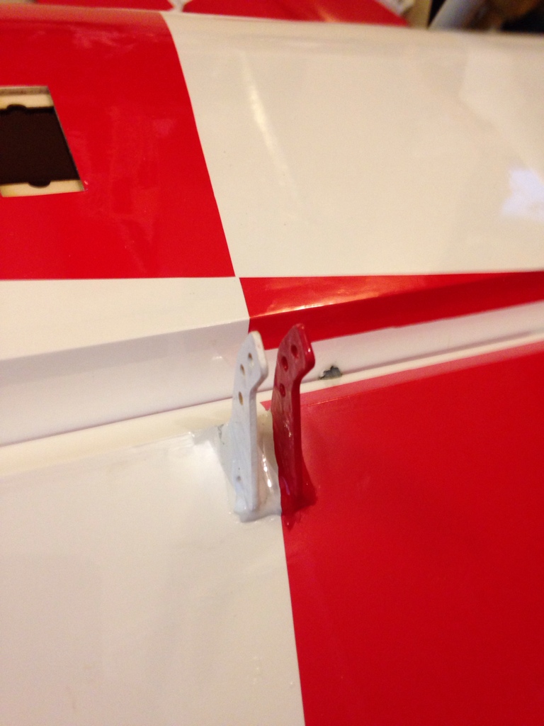

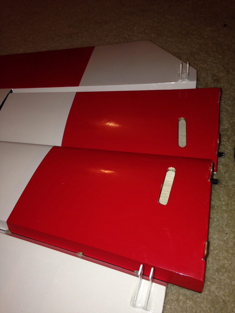

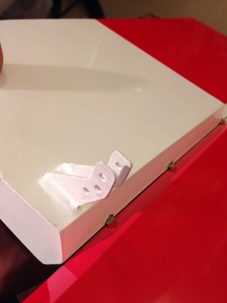

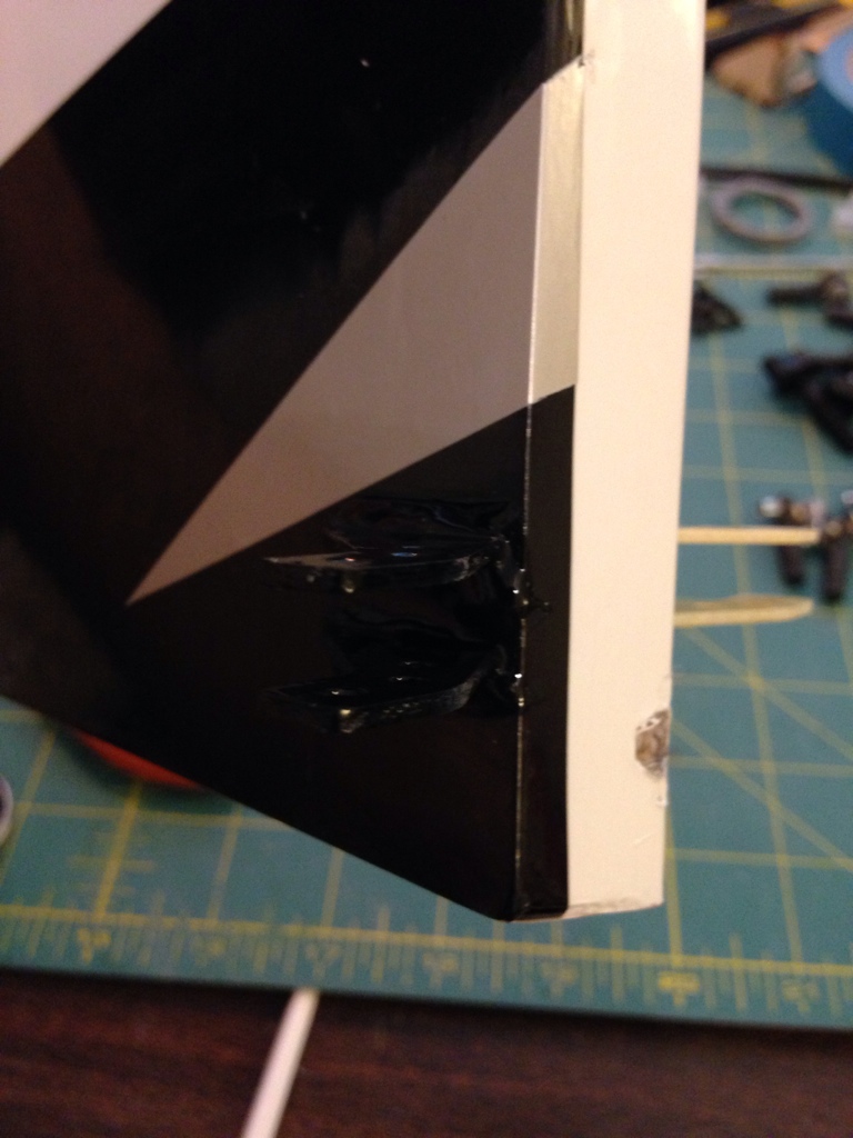

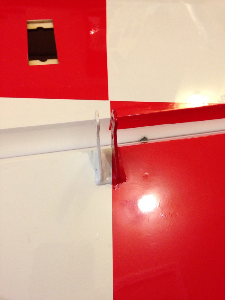

Ok, so control horns are done!
ImageUploadedByTapatalk1393790266.608892.jpgImageUploadedByTapatalk1393790250.701378.jpg
ImageUploadedByTapatalk1393790288.999194.jpgImageUploadedByTapatalk1393790297.292064.jpg
ImageUploadedByTapatalk1393790308.818636.jpgImageUploadedByTapatalk1393790325.403847.jpg
ImageUploadedByTapatalk1393790335.261609.jpgImageUploadedByTapatalk1393790358.878593.jpg

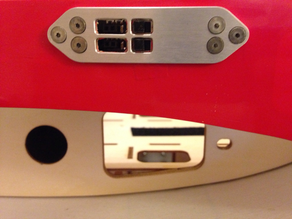

Also, got the Fromeco Wolverine switch installed

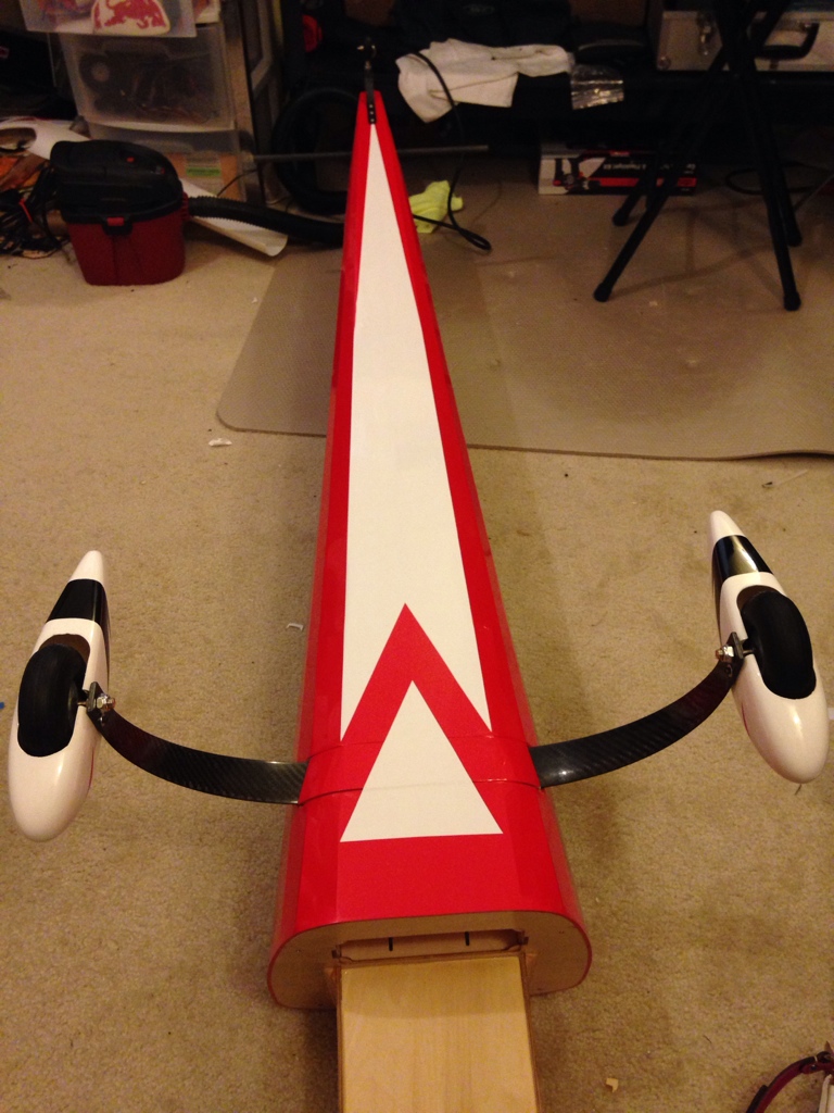

And added a little more white to the bottom. I didn't like the top and bottom of the fuse both being red, so I broke it up a little.
You can see in this photo that there is a nice red landing gear cover. The intent was for it to be installed with the gear bolts holding it on, however I didn't like that for a few reasons: 1- the included bolts were too short, 2- you have to puncture the covering to access the bolt heads, 3- the wood on the cover isn't as strong as the CF, so I don't like the idea of using it over the CF to hold the gear on.
So... I just enlarged the holes so they fit over the socket heads, and installed the cover using welder polyurethane glue. It's very strong but still removable. Also, the white triangle of covering ads some extra support.
