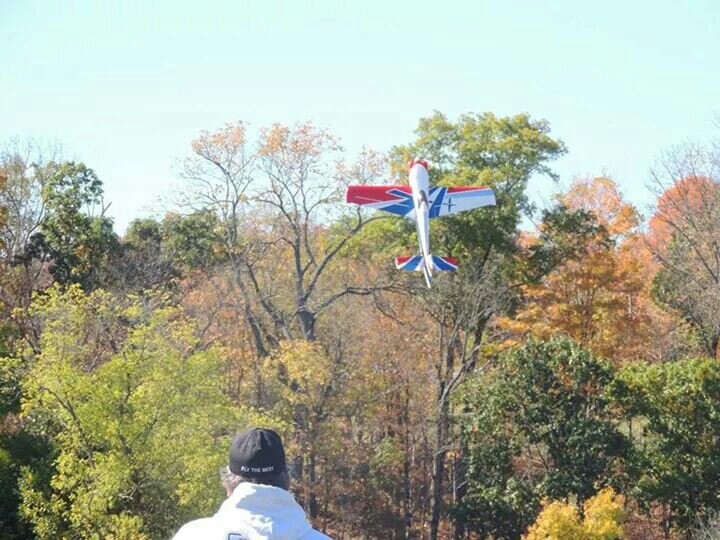

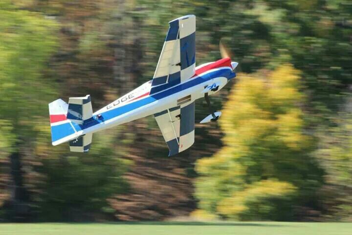

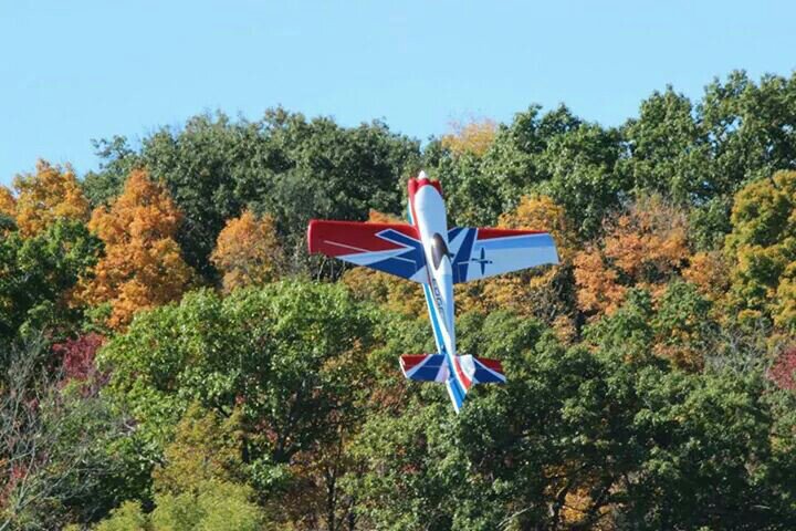

Awesome flying last Sunday!
njswede
Great shot, and of course, I love the significance of the text on your hat... :)
Haha! That was completely unintentional. I'm an equal opportunity pilot of awesome planes. And "Fly the best" is very suiting. This is the best 76" Edge I've ever flown! :) Seriously, it's really good. I think I've worn out the free servos, though.
