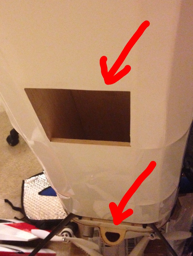

Based on my experience with the 3dhs cowl opening and gp61 temps I saw, I had to have a straight line of air across all jug fins. This cowls inlet will defiantly straiten out the air flow but only looks like the top fins see the direct air. On the exit side this cowl has geometry that generates a low pressure pull. I guess this all adds up to good cooling.

Kole had his 92 Edge flying at the Nall with just the cowl scoop opened so I'm starting with that. The different is his was piped, so not sure how/if that hurt or helped.
I opened up the big canister tunnel exit on mine, and between that and the built in cowl vent (you can see both in the picture) I "think" I'll be ok. Figure I can cut more later, but not really put back ;)

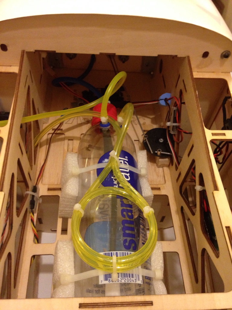

Looks nice...Can you shoot a pic of your layout of receiver and batteries behind the wing tube? It looks like the inside is a lot wider behind the wind tube than most.
I followed your lead and ordered a 20oz WrongWayRC tank... took my 16oz tank to Empty a few times when I got could not stop doing fast passes for 12 minutes. The extra 4oz should help with the safety factor.
