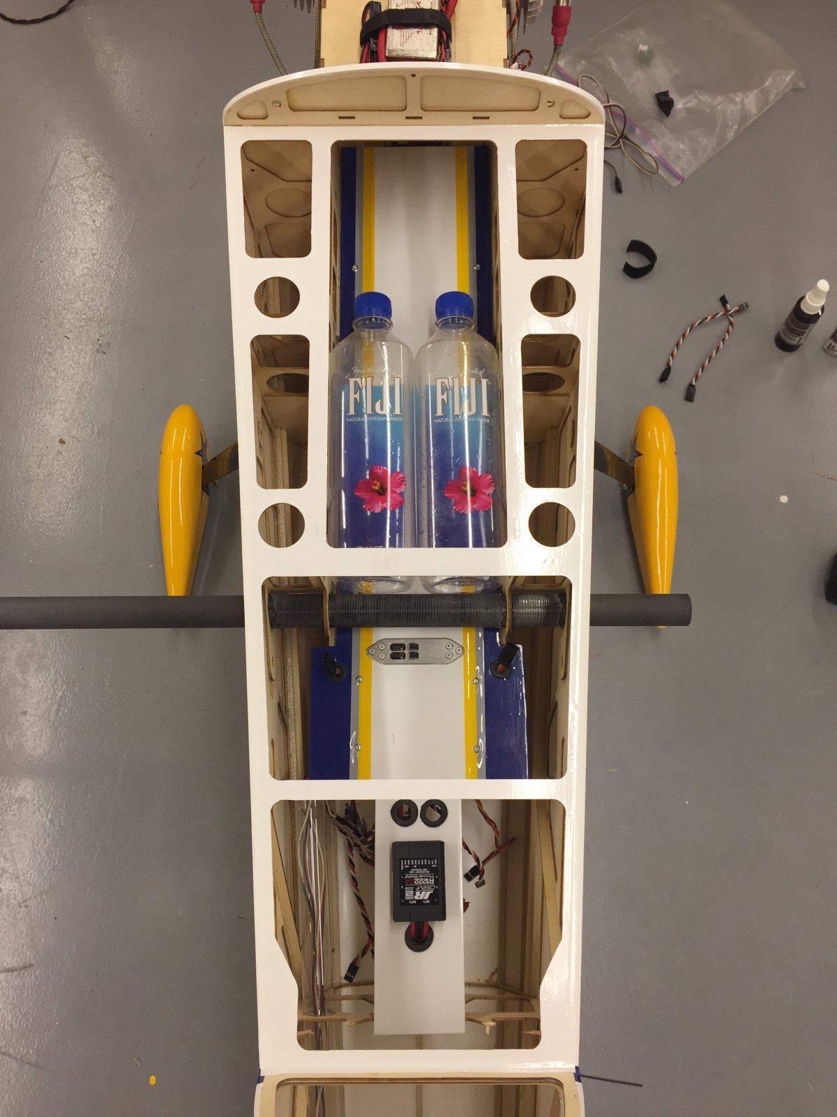

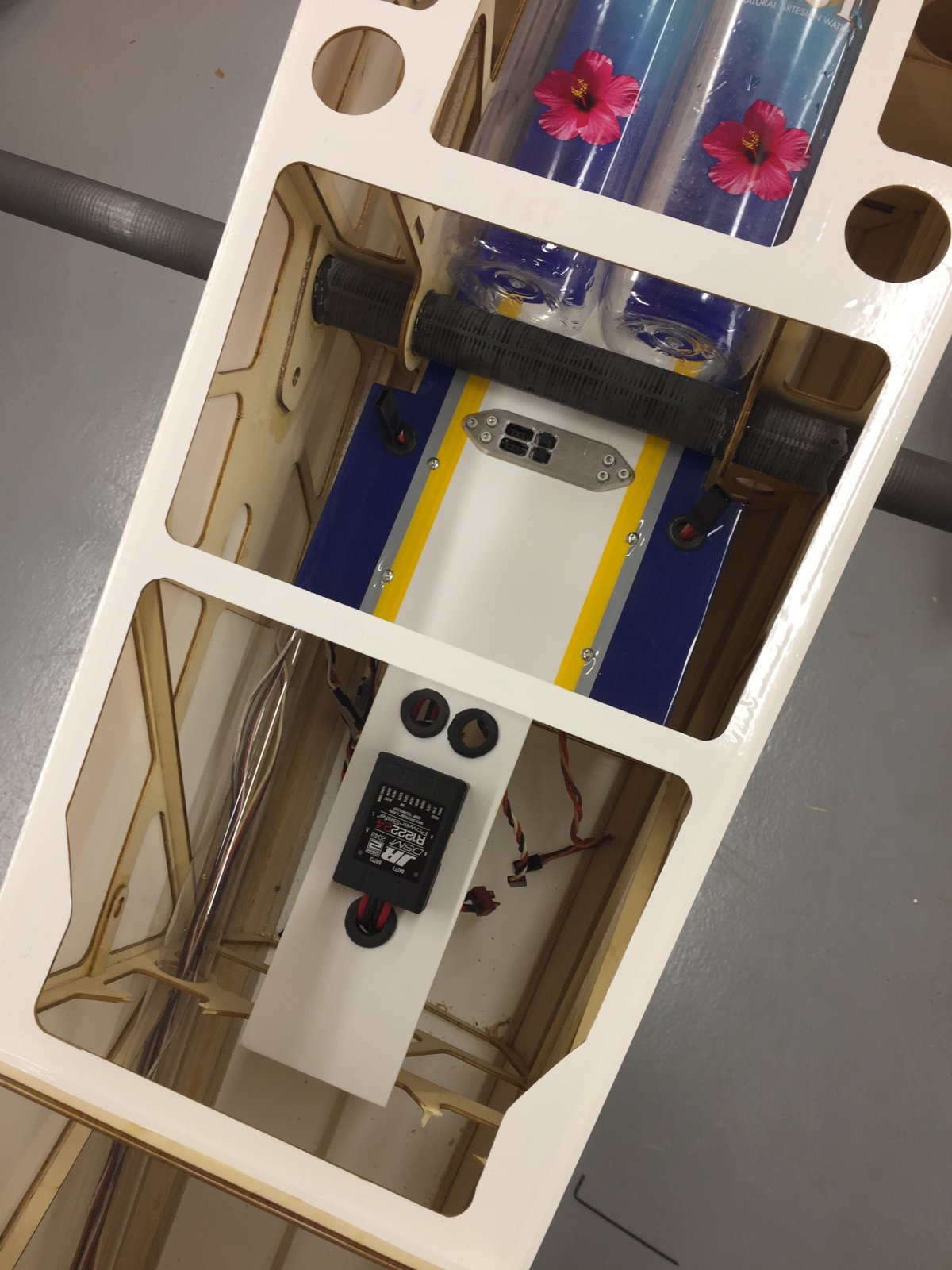

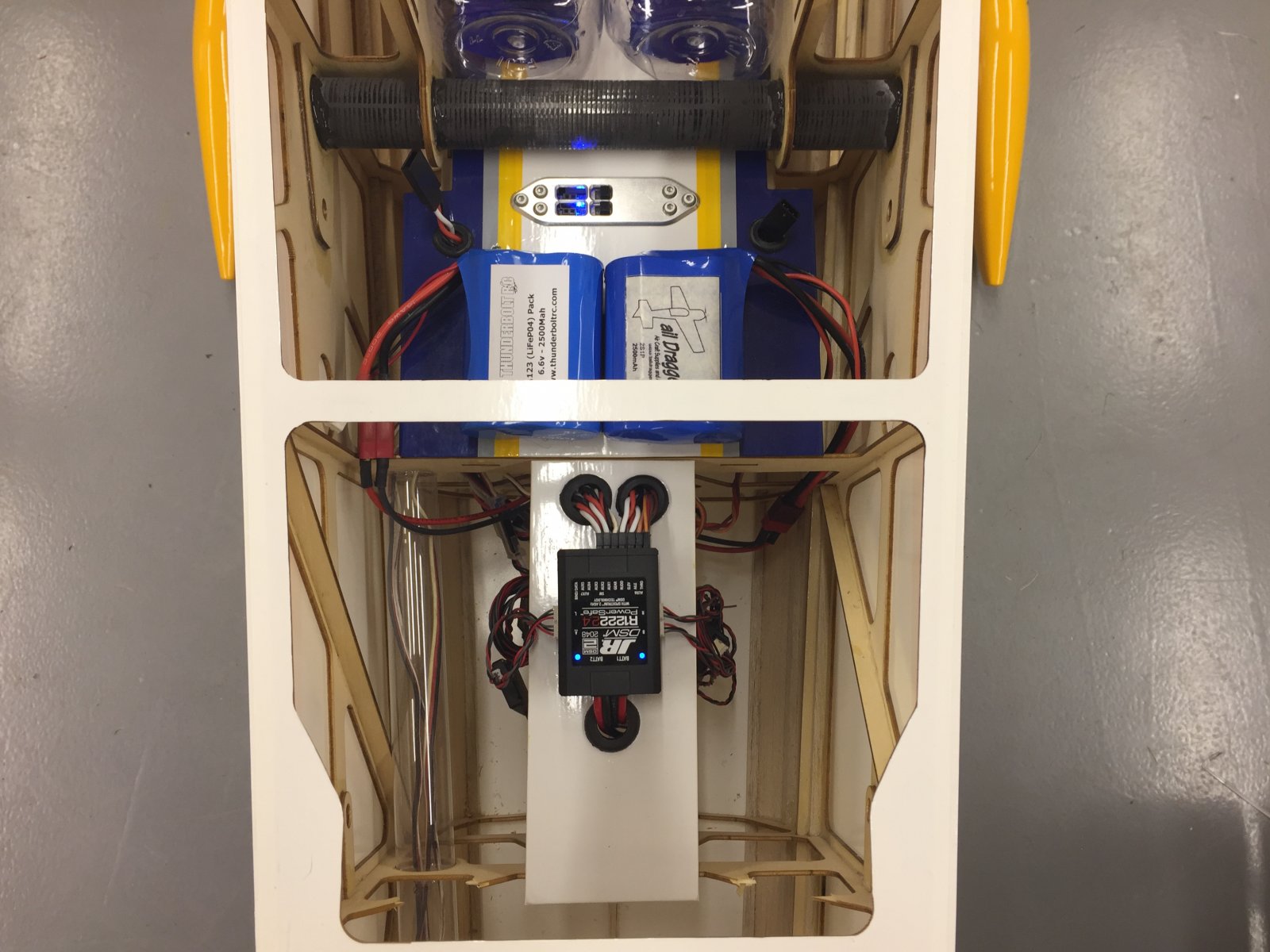

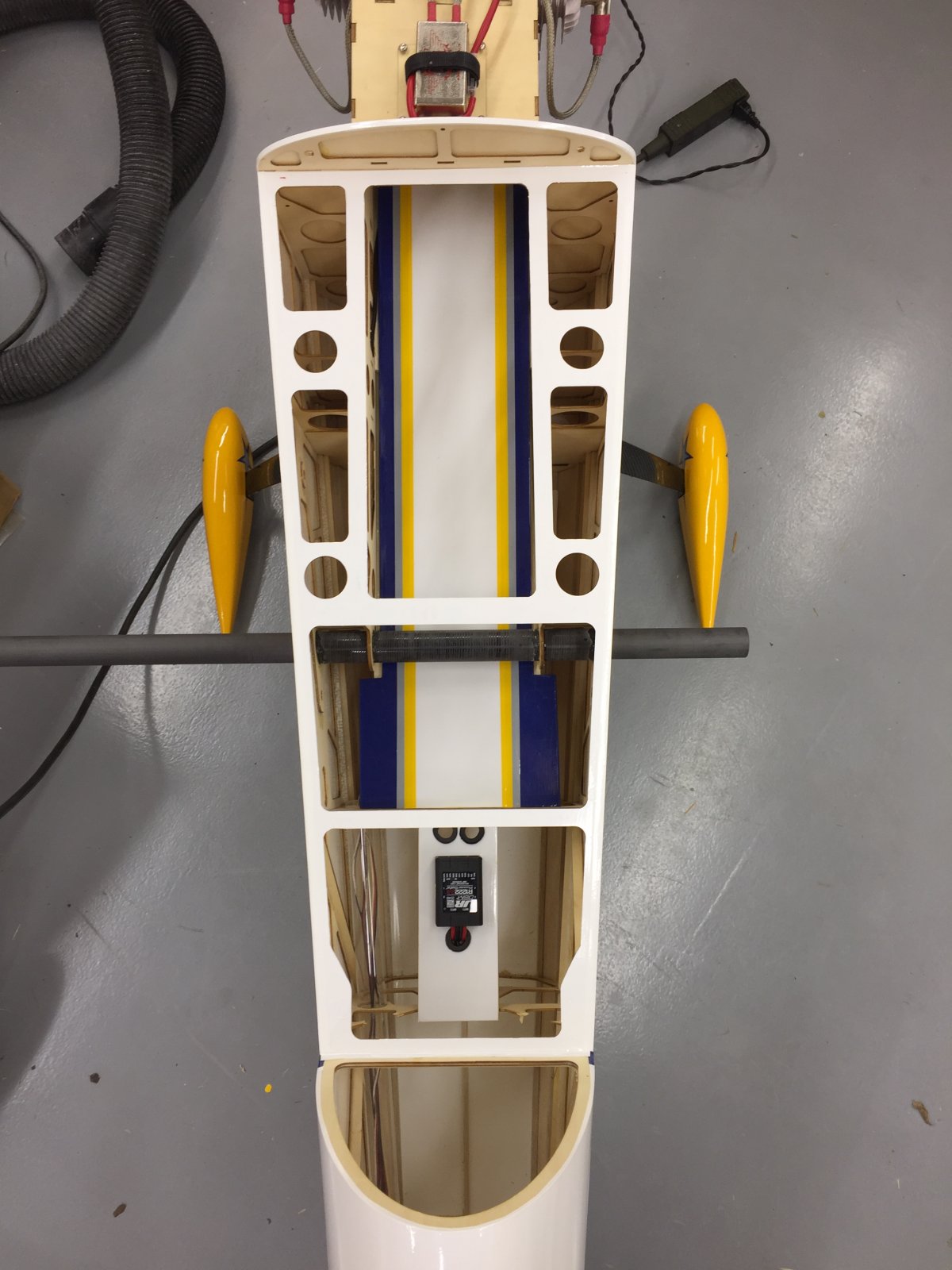

The switch is awesome... it works and looks great. It has 2 inputs and 2 outputs. (2 for the receiver and 2 for the switch). You can order it with different connectors if you use something different than the deans. You can't balance charge through the switch though, I do that directly through the battery balance port.

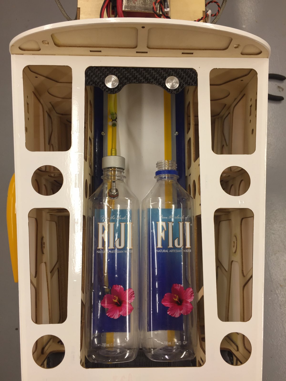

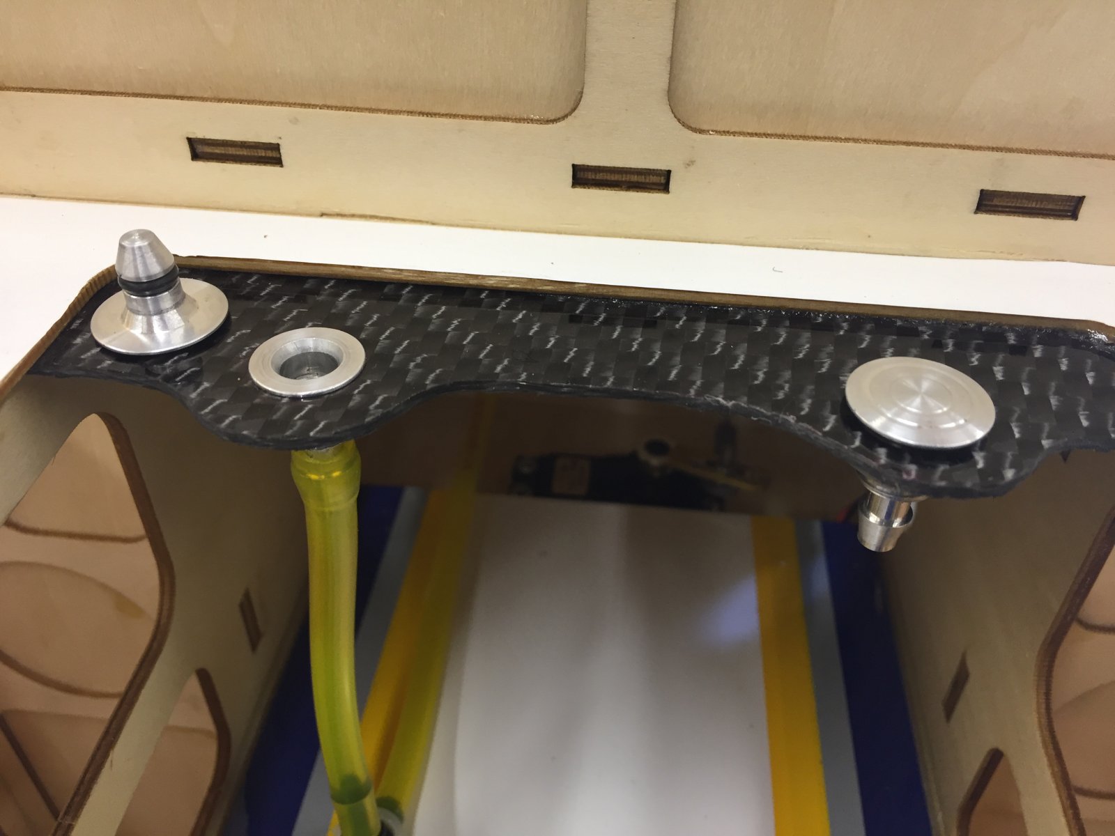

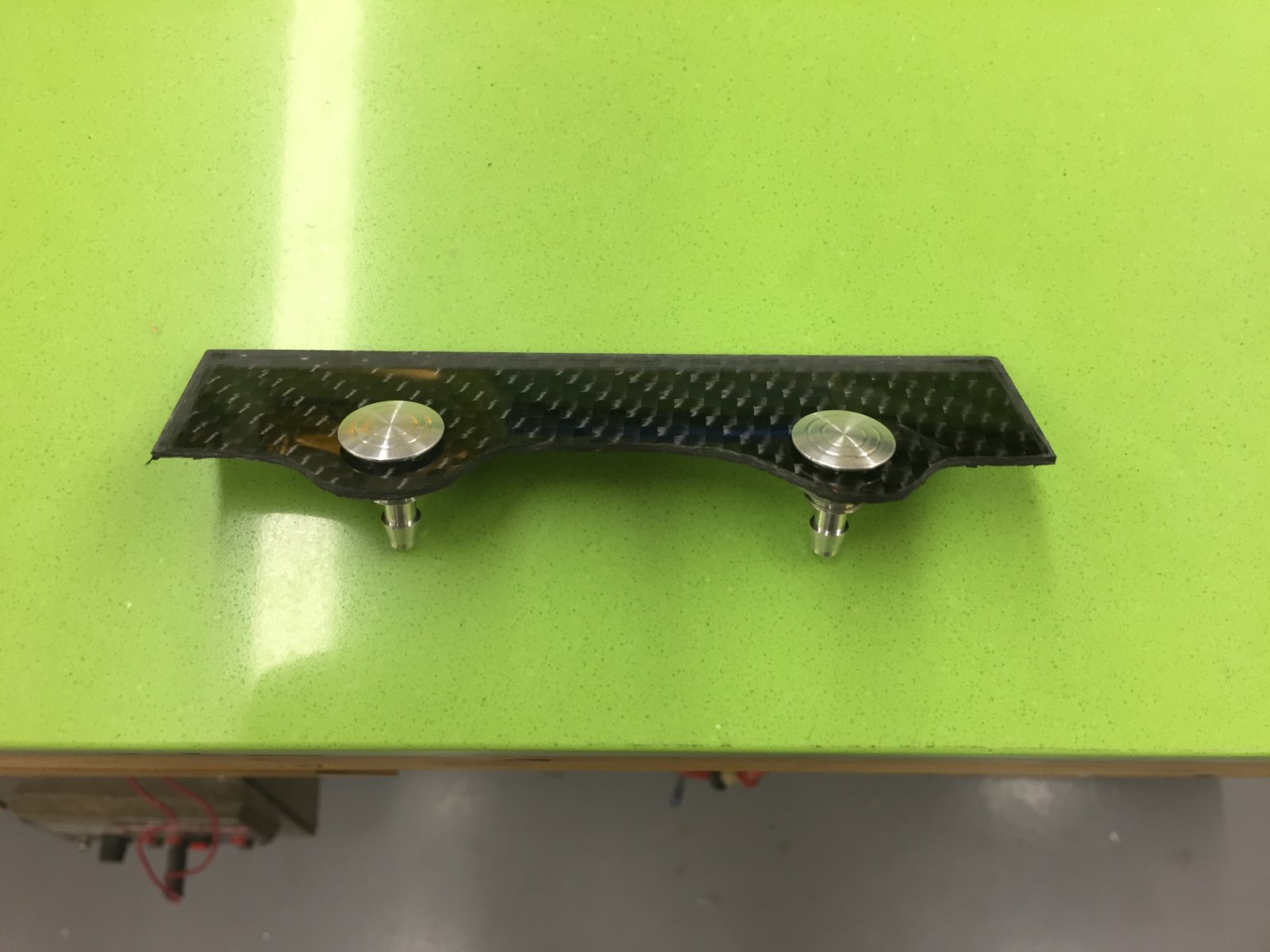

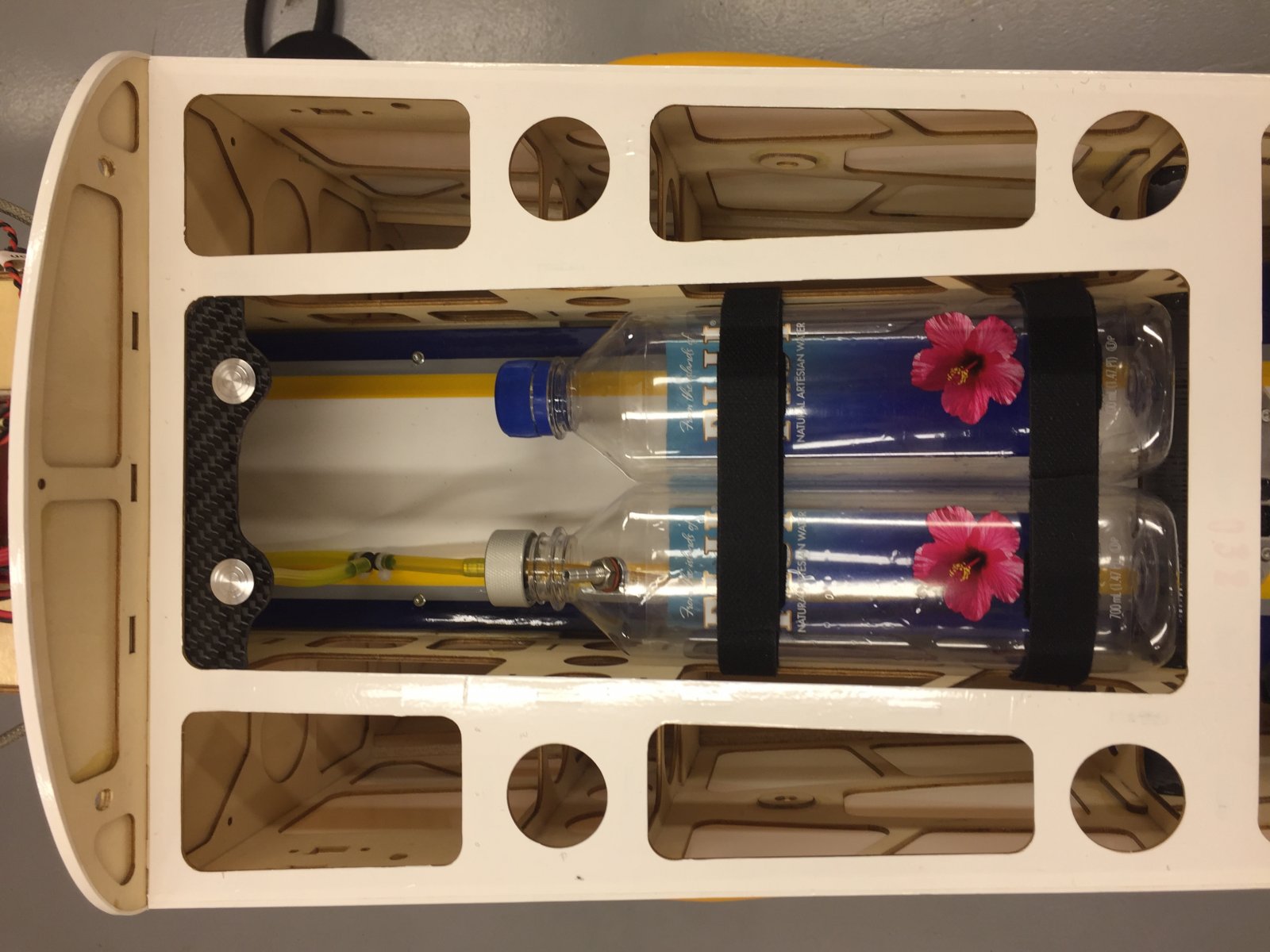

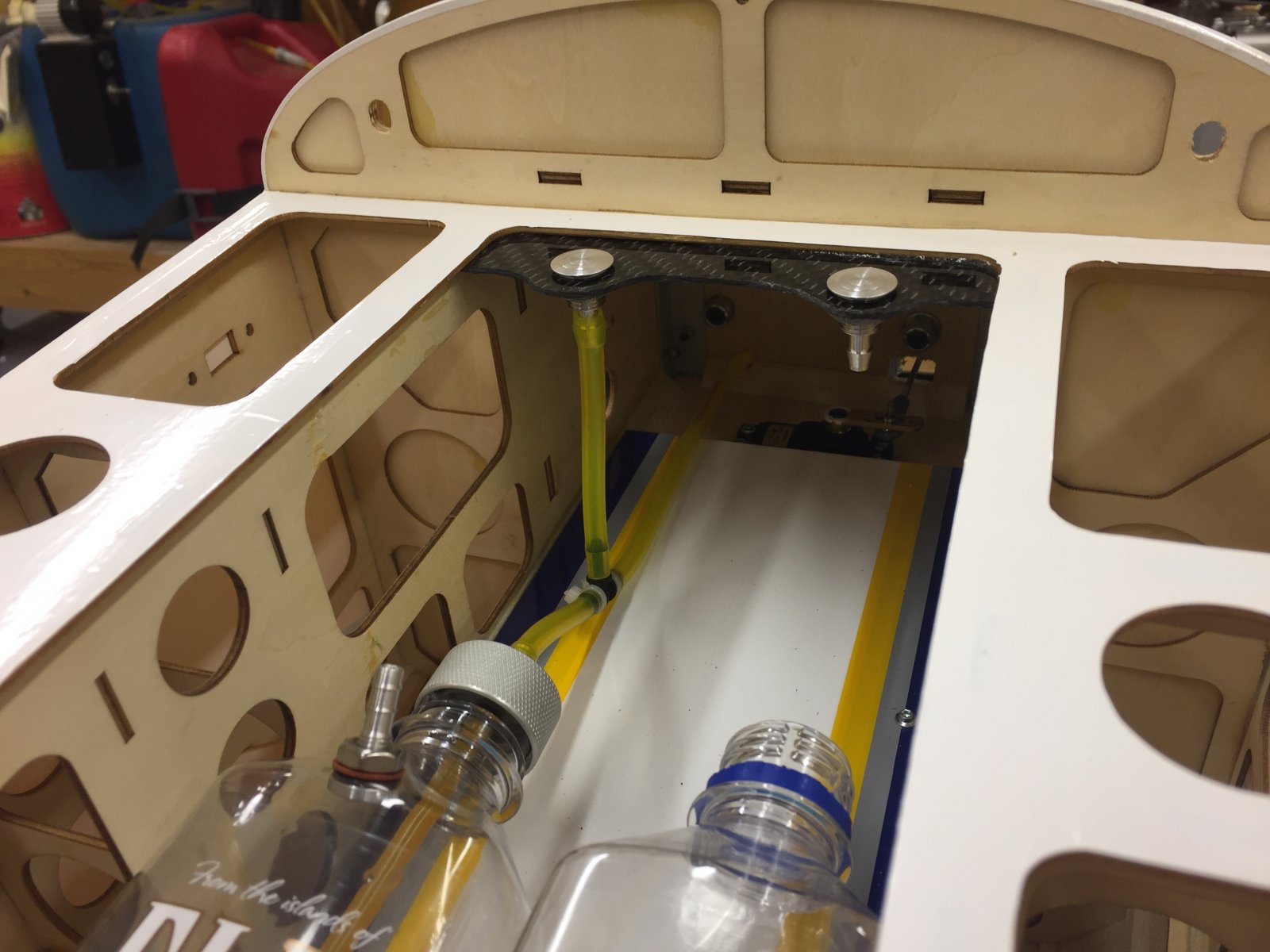

On the fuel dot, the fuel line is connected to the body, not the cap. So when you take the cap off, the fuel line doesn't move at all. It would definitely be too short for the more common fuel dots where the line is connected to the cap, this one just isn't made that way. And I hear you on fueling/defuelong...I'll be sure to be careful. I don't really want to get fuel everywhere in the plane :/.

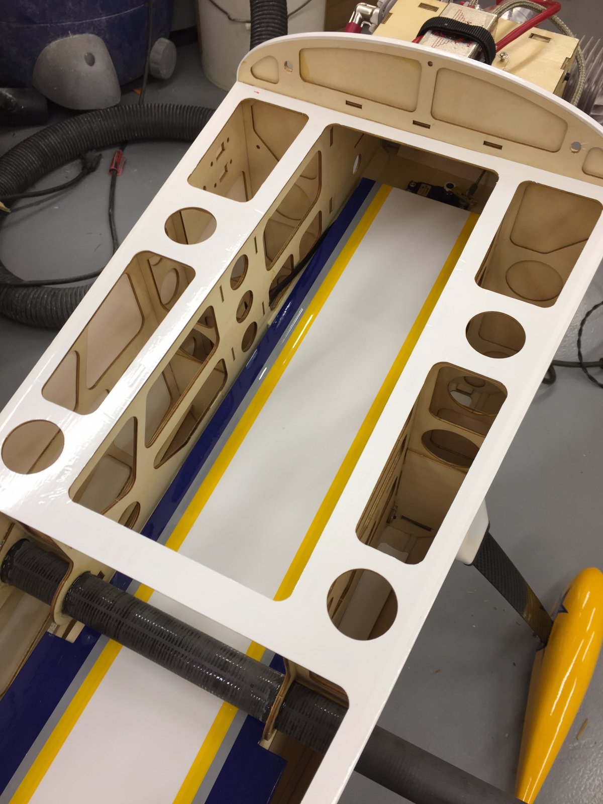

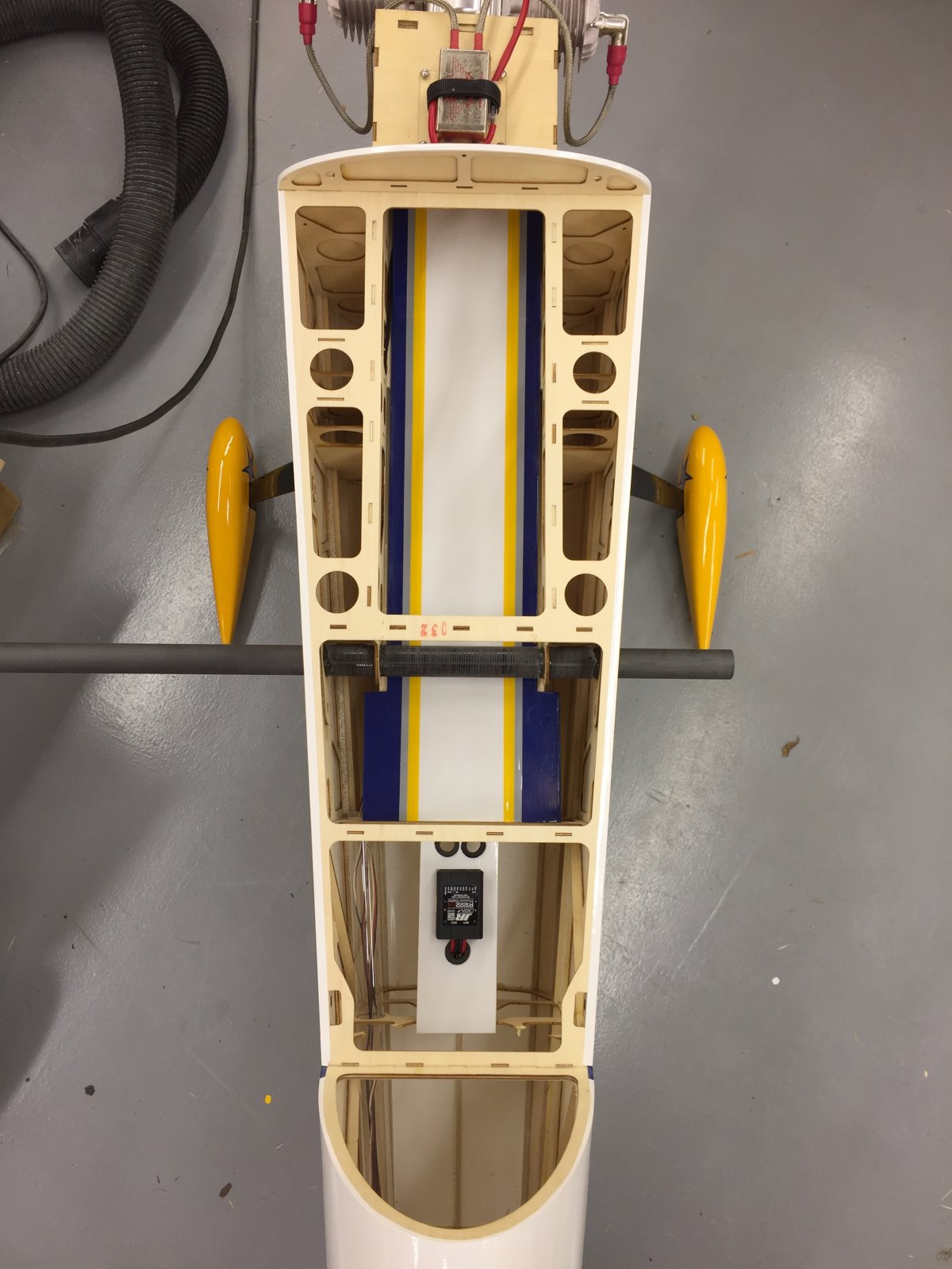

I broke the 45 degree wood supports out when I installed the covered tray the first time... it was my fault :/. I'll clean it up before the first flight.
I have 2 Harris smoke pumps right now that are just sitting in a drawer... mainly, im waiting to install the smoke stuff because I'm just being lazy and I want to fly this thing!
