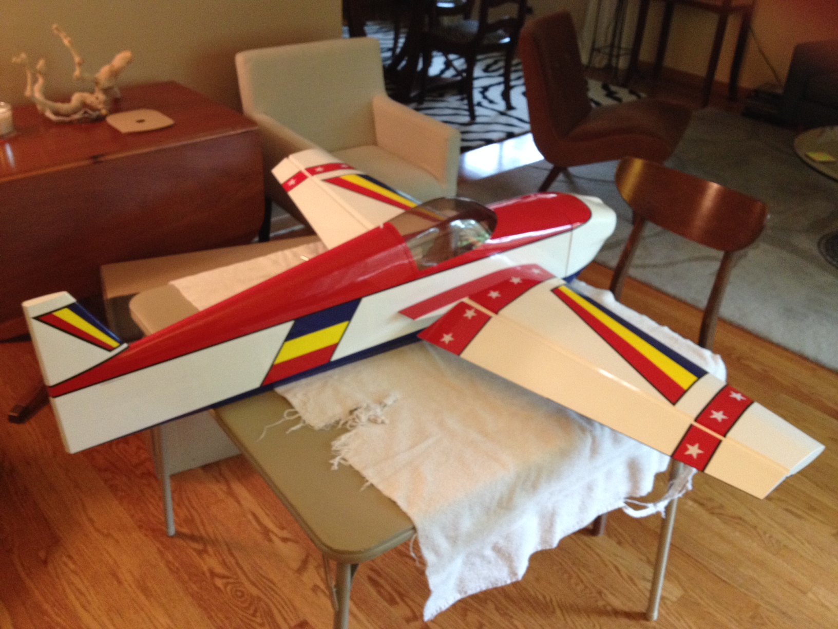

Aj aircraft 93,73,56 laser
I did not like the visibility from what I saw on videos of that scheme. I got to see them in person at Toledo and Nall and I went with the competition purely for orientation. You will never question where the model is with all that jazz.
56" Laser
I thought you could see the Competition scheme better as well so that is what I went for. Just started putting things together this weekend but was interupted a lot.
I was thinking of putting the wheel pants as well but the grass field thing has me concerned. I just flew my 51" Sukhoi yesterday on a soggy field (rained like hell the past few days in Chicago) and at one point I could not taxi the plane back to me after a flight. The plane sank down to the axle and I am using 2-1/2" wheels (no pants). I figure the wheel pants on the 56" Laser could cause the plane to tip over at speed in some situations and cause damage.

56" Laser

Every plane that I fly with wheel pants ends up shedding them eventually due to the fact that I fly on a grass field...even though it is well maintained, it is still grass and it creates much more strain on the wheel pants.
I was just looking at my fleet, and my 30cc stuff is mostly pant less. For some reason the 60 laser wheel pants are working wonderful, but that is about it. My 89 slick has gone through a few sets and I got tired of replacing them. I never put them on my biggest plane, my 110 yak. The things EF supplies with it are just plain aweful. Now my Pilot Yak had real nice spats. Since weight is going to be a concern I will leave them off initially.
I got a couple of Savox 2231s for the Yak and I might use the pair of those metal arms they come with for this plane's ailerons. Then I won't have to dink with the ball links. Funny having Savox arms on Hitec servos (new futaba spline). Just depends on the hassle factor.
The pilot yak spatz are still in working order. In fact they out lasted the landing gear. The pilot wheel pants also seem to be a lot better then the EF ones.
I live by La Grange (western suburb).
I am pretty much convincing myself that the wheel pants are not going to be worth the hassle.
