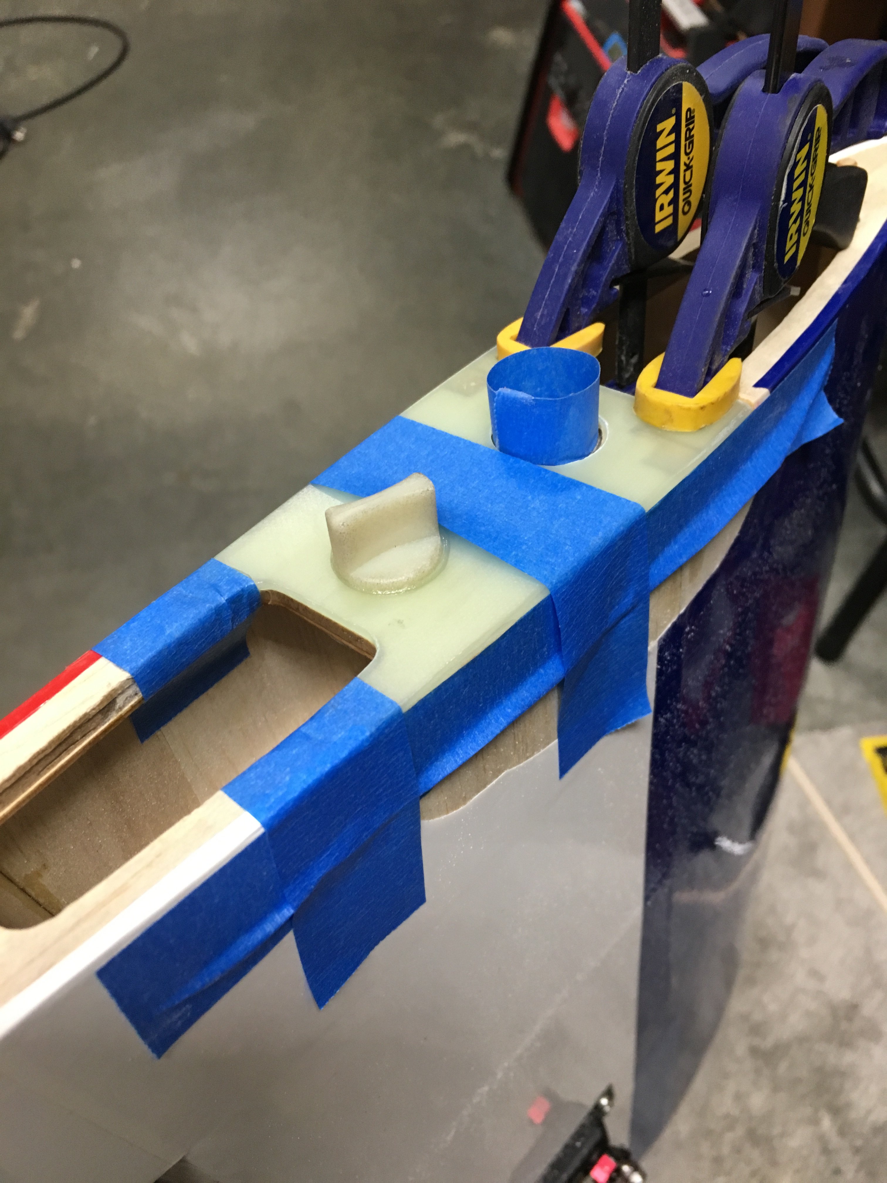

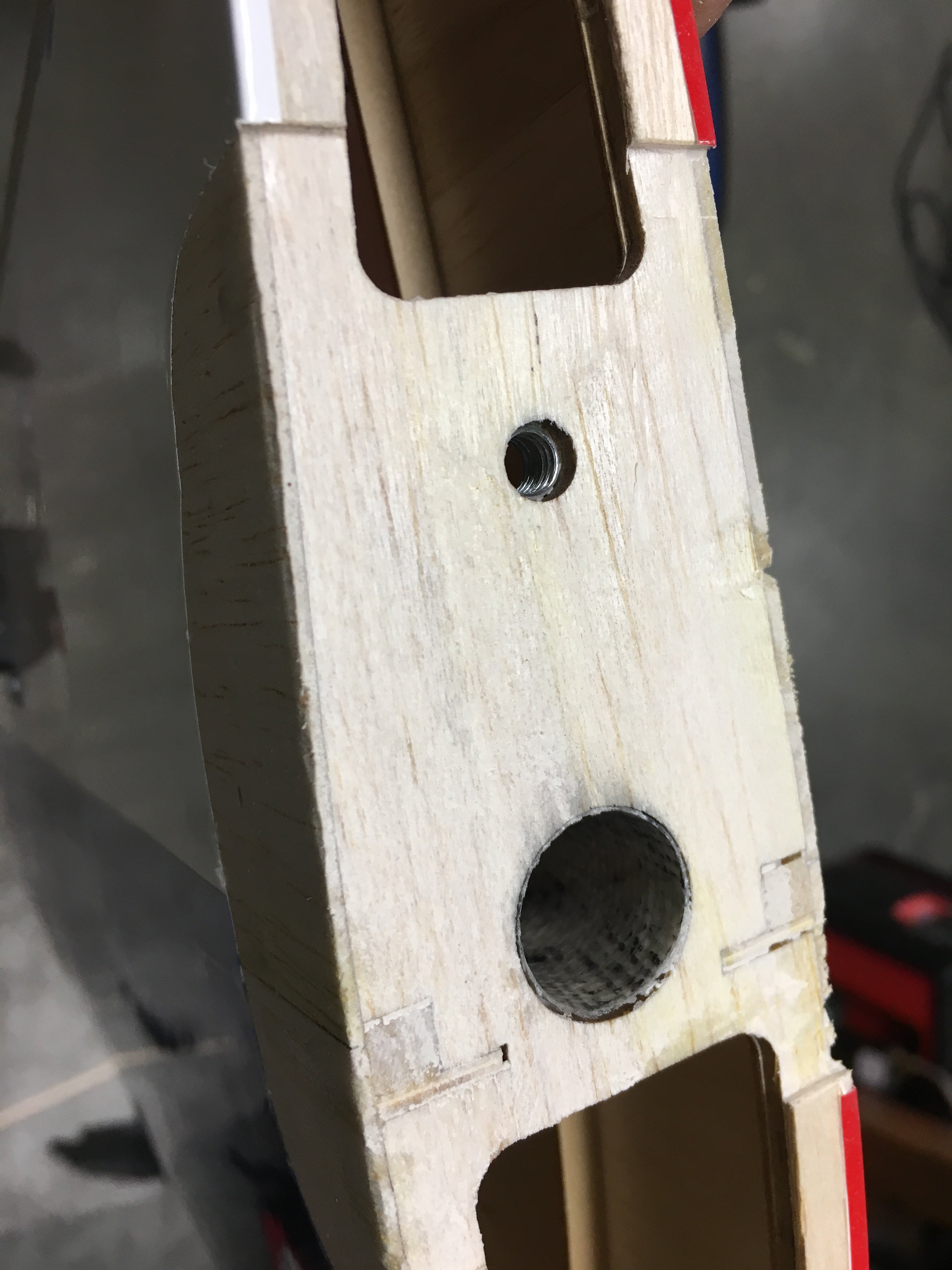

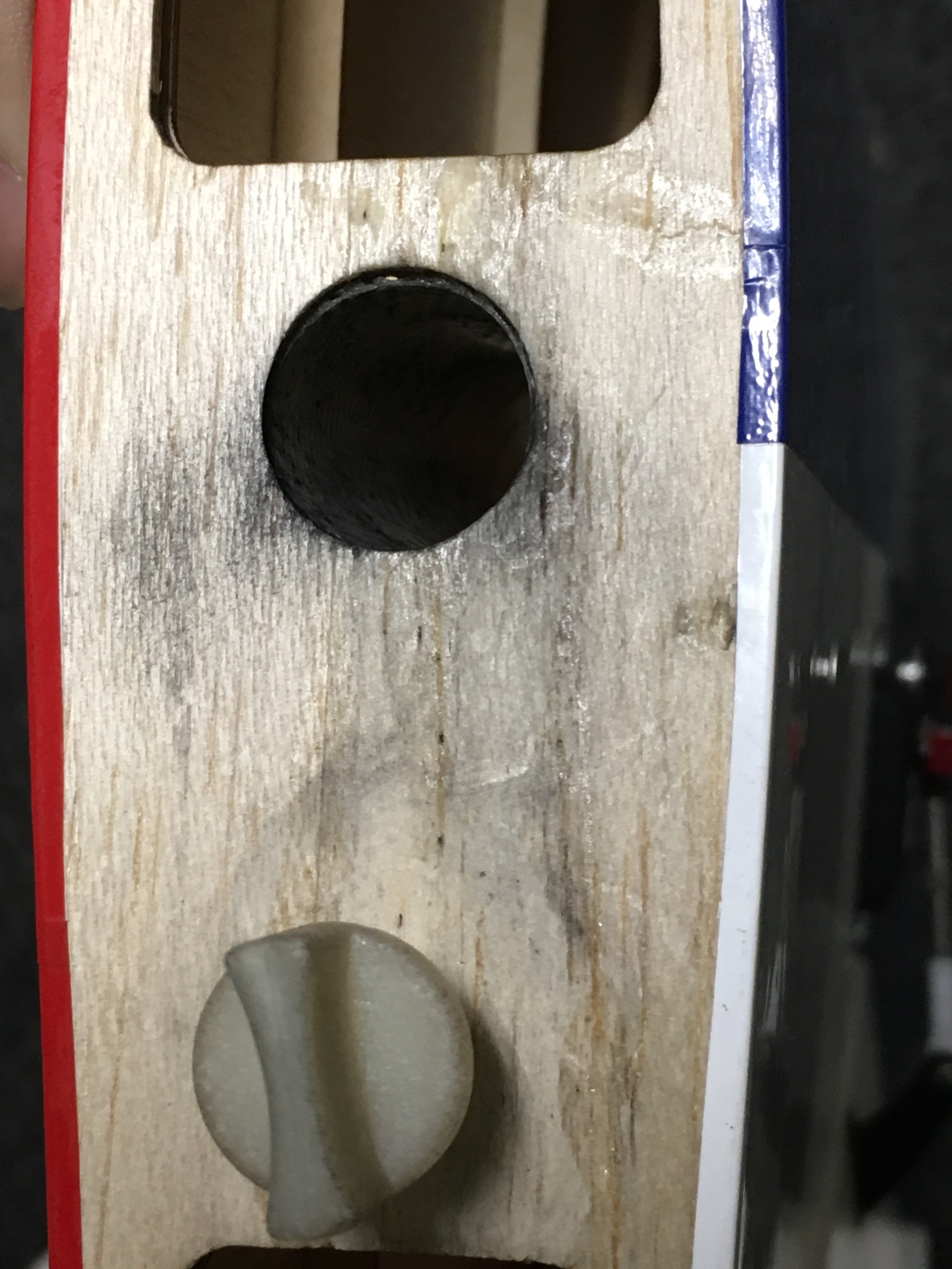

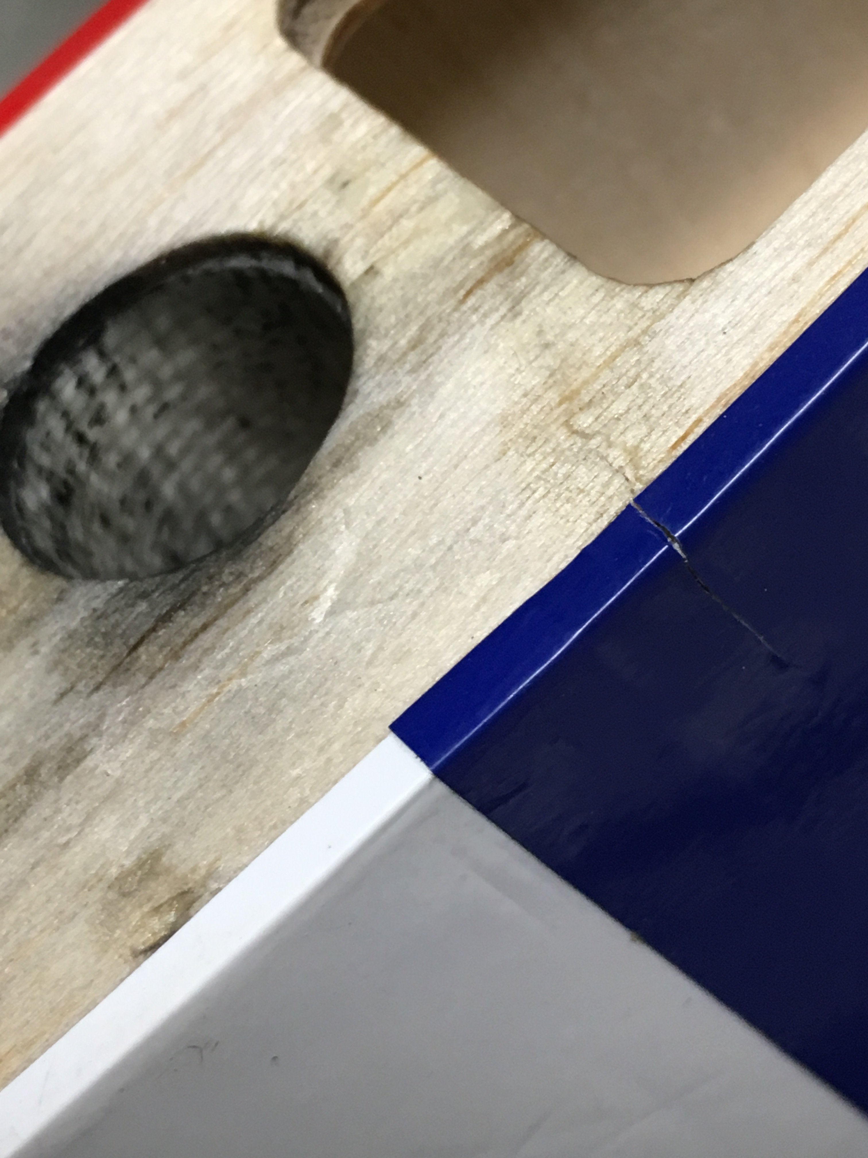

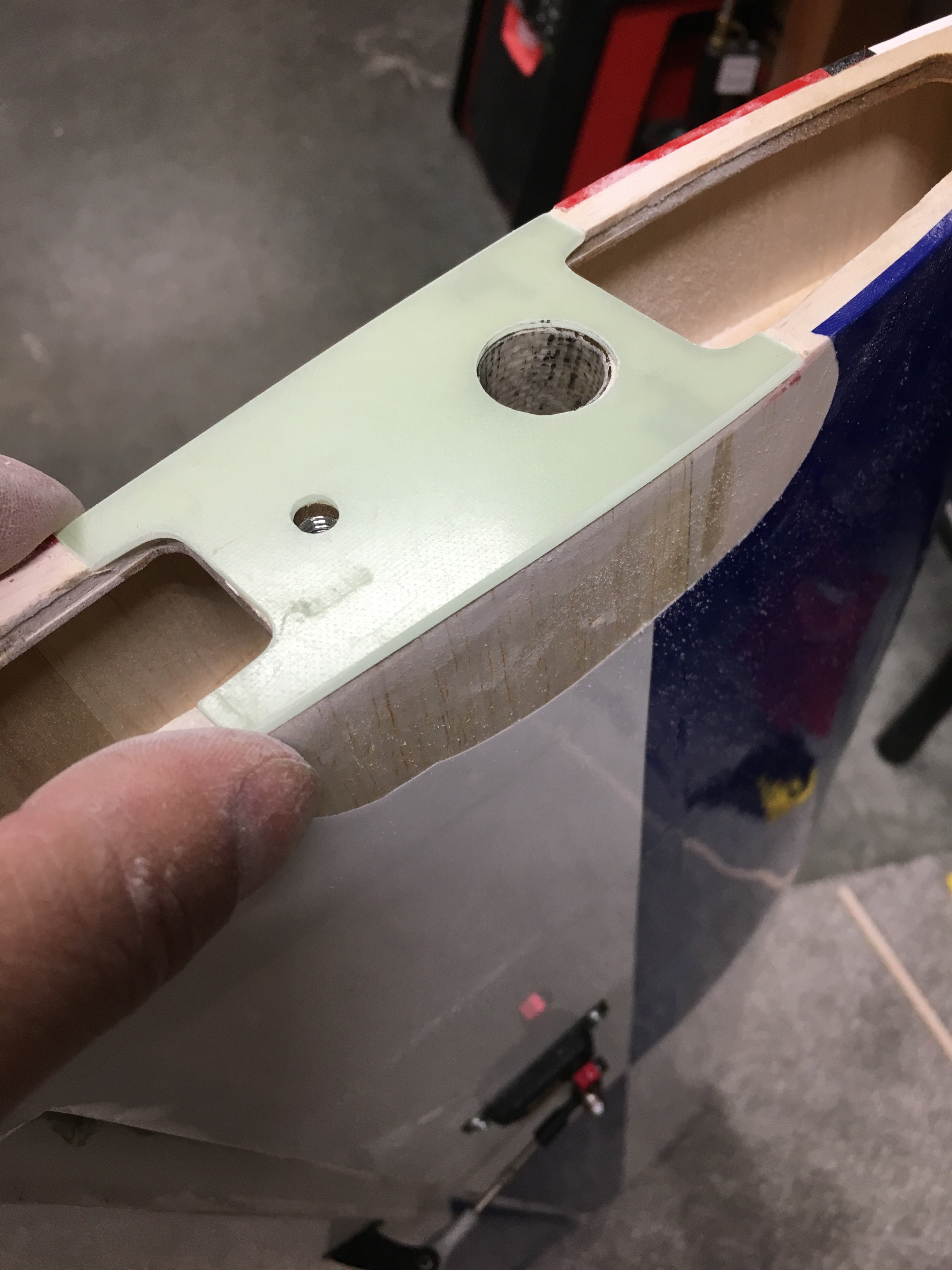

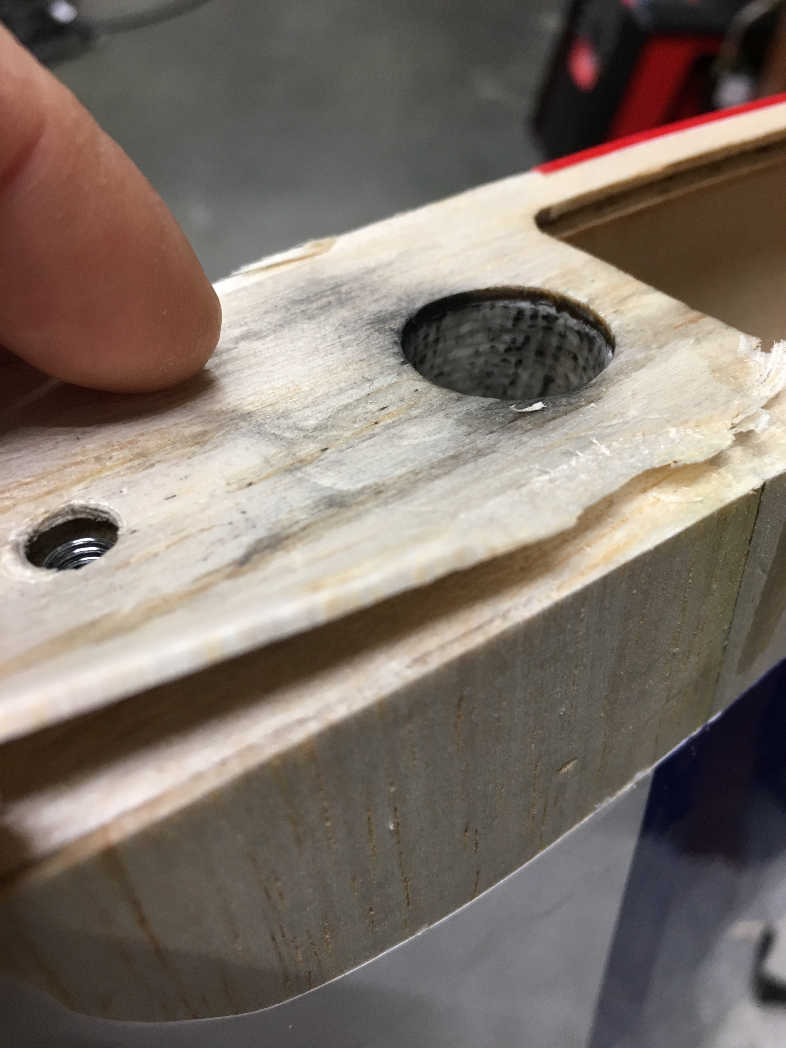

Did some wing rework. Cracks keep showing up around the wingroot/tube area. Probably from taking the wings on and off so much with tens of gallons worth of flights.

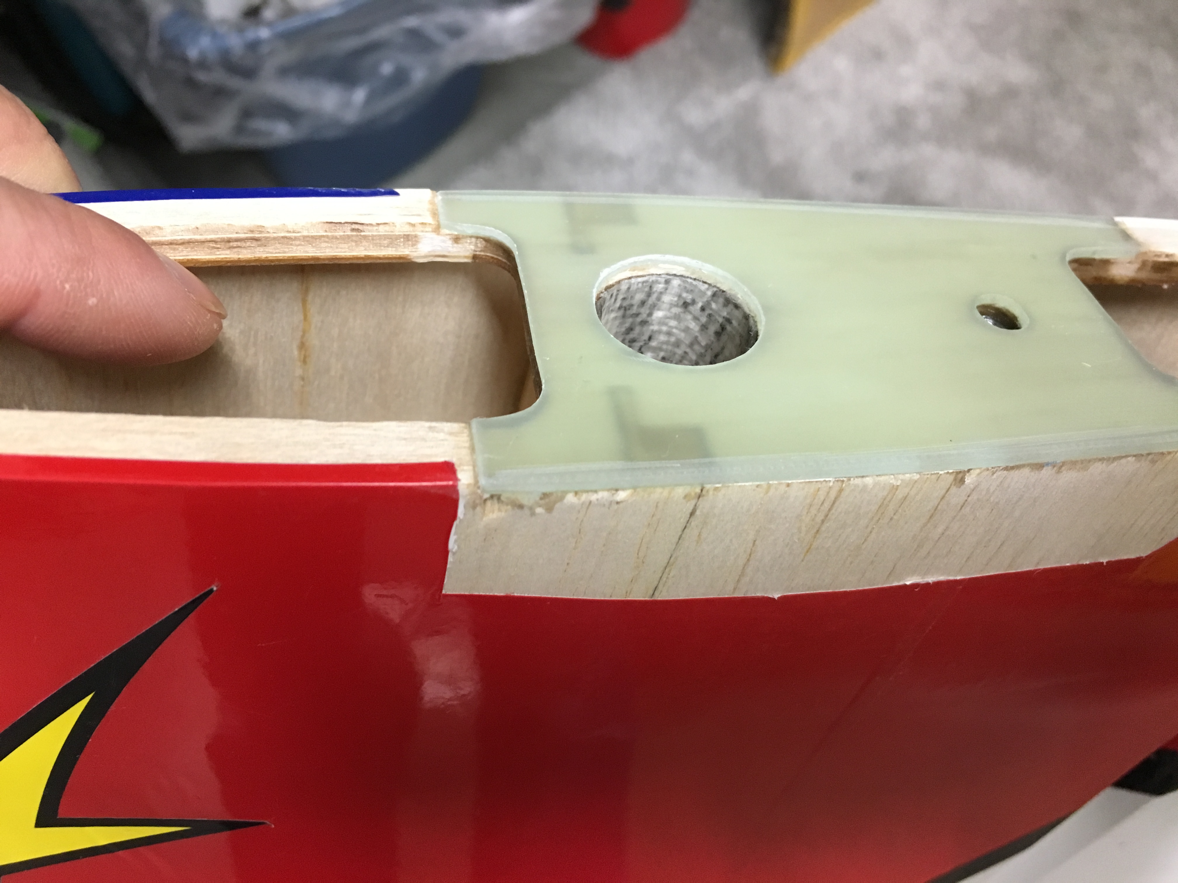

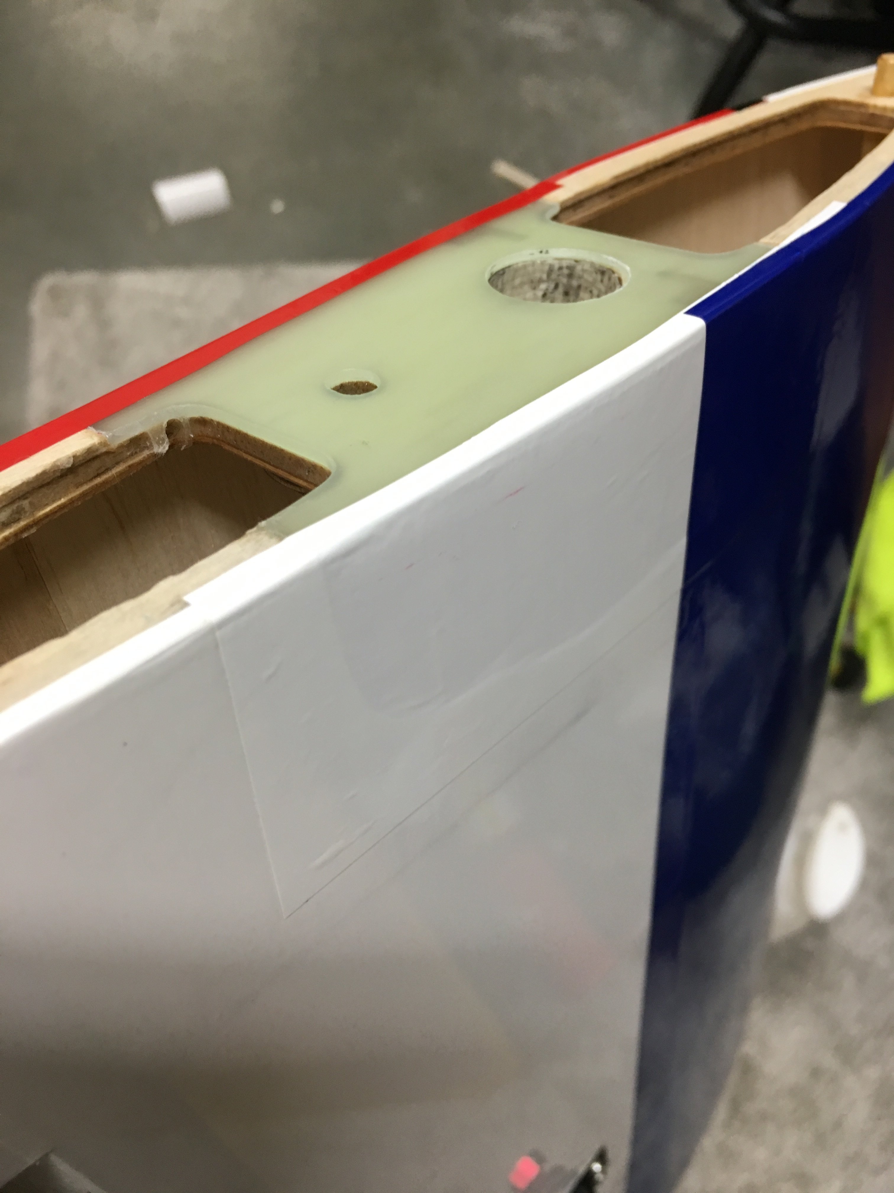

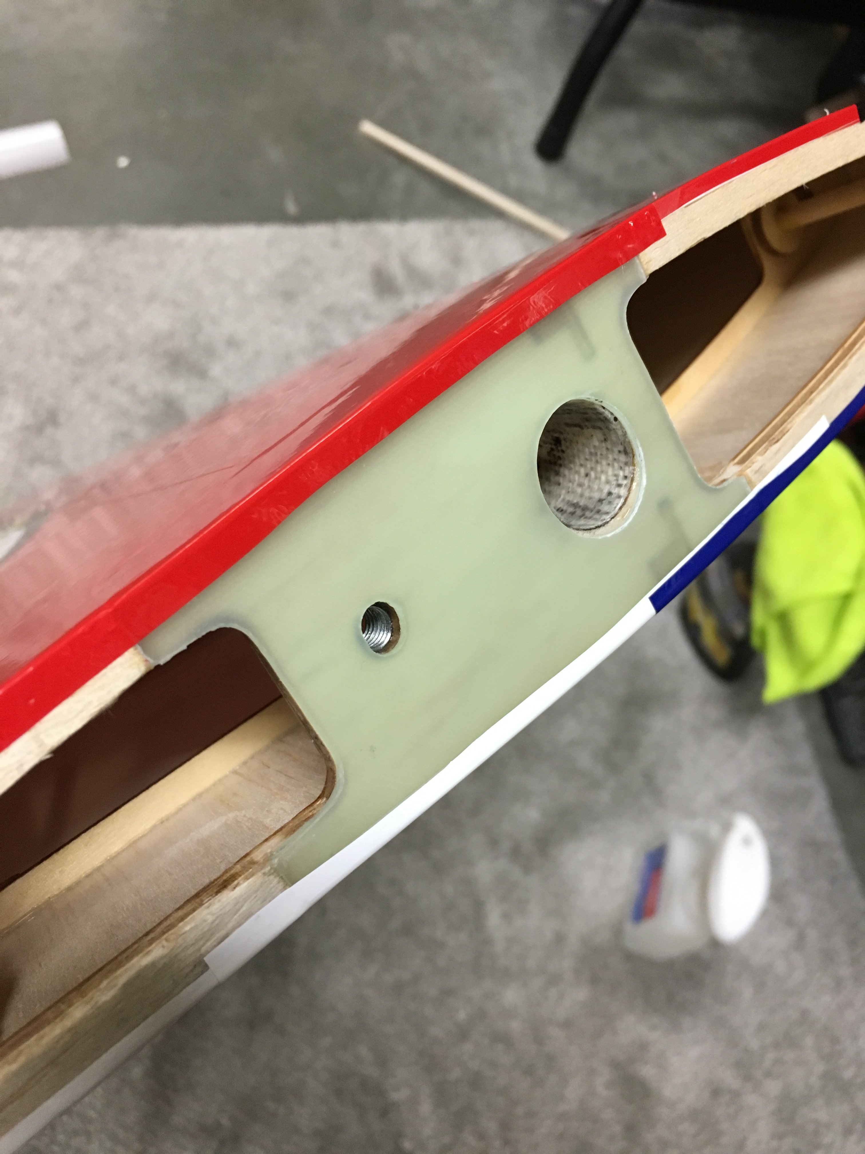

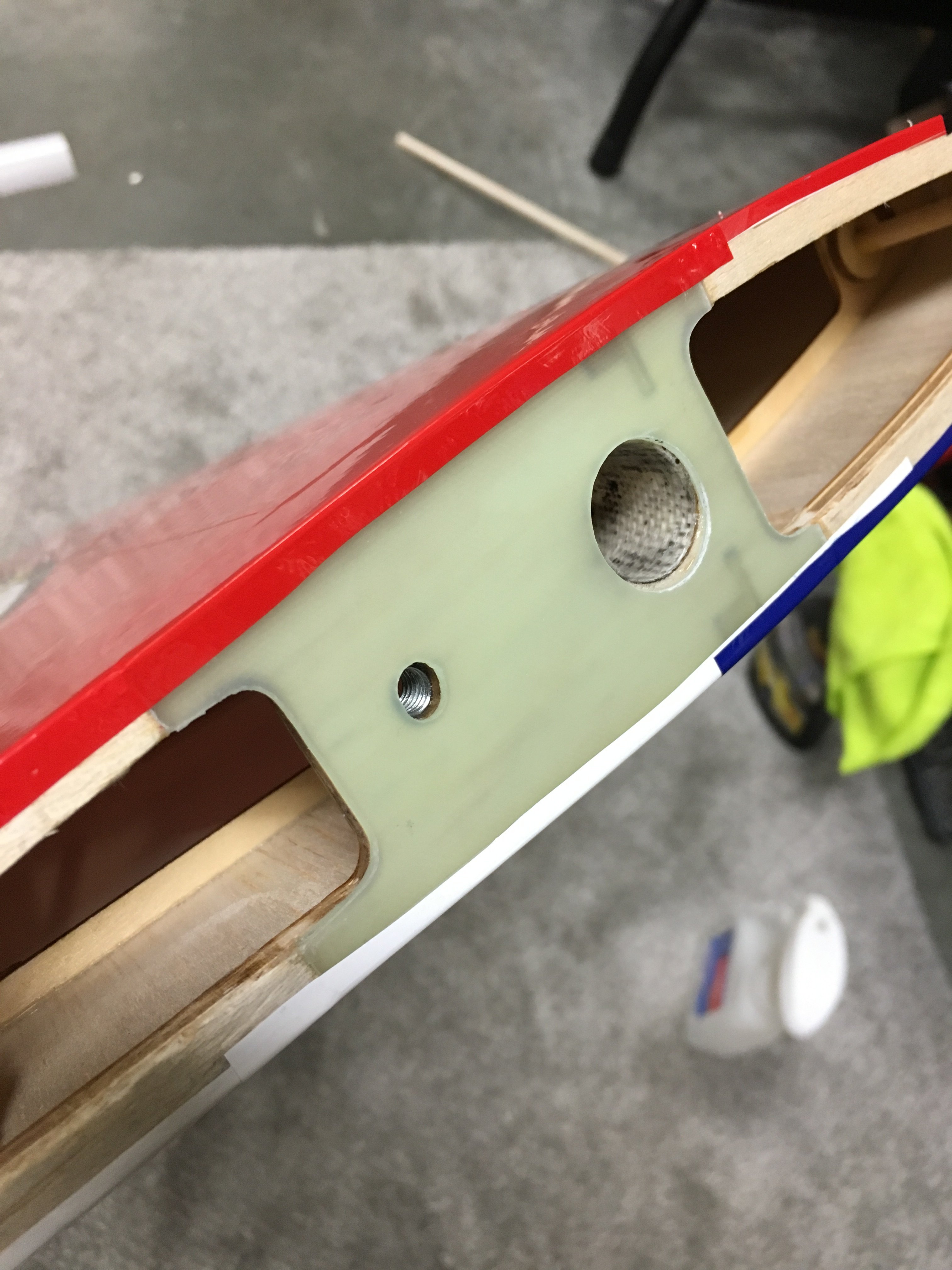

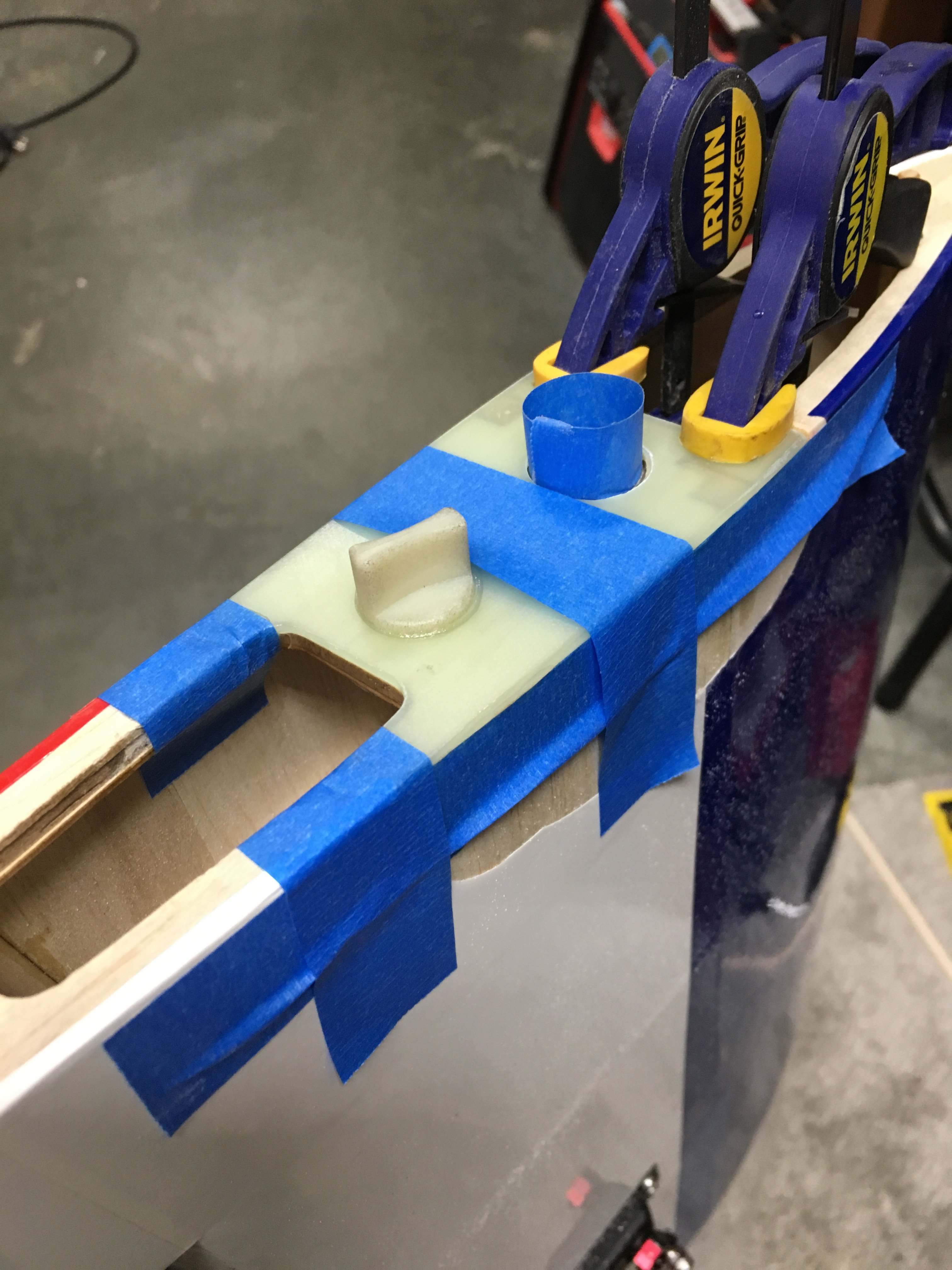

I removed the partial section of sheeting from the wingtube to the hold down screw. Made a G10 sheet and epoxied them in place.
Recovered and should be good to go. Might even do the other side (not as bad).
