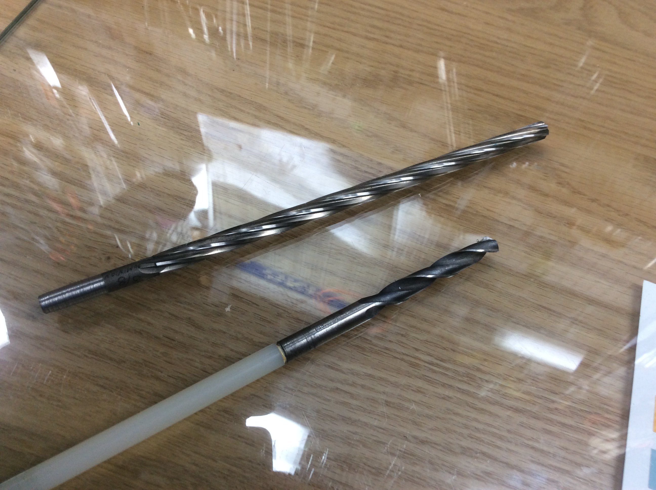

    Ok if you want to end up with a perfectly round hole and dead nuts on 10mm diameter you do the following. Drill the hole with a standard drill just under 10mm I would say 9.75mm would be good. Then take 10mm diameter reamer and drill it Agan with the reamer you end with round hole 10mm in diameter. A drill with only 2 flutes is never round it is always egg shaped. Just hang on a bit I will go down to the workshop and take a picture of the 2.

    You got it you will be happy. But keep it wrapped up or in some kind of tube to keep it sharp. Make sure it has at least 5 cutting edges on the perimeter.
  3. Had to go look at the one I just ordered but it has 6 flutes. The prop is already drilled but not for the 10mm of a Valach shaft, it will thread on but come to a stop at the unthreaded portion. I don't know how much difference there is, not much, but just enough to not fit. The flute should work out real well and seeing them I may one day order an entire set, standard and metric, as we are always having to open up a hole in something.

    Just get the tools to drill and ream 10mm, 8mm, 5mm and 4mm. What's the Valach's prop bolt pattern? Have a drill guide for it?

  8. You haven't seen the boxes screws and bolts I have, when scratch building just about everything up to 3/8" get's used. And many times, too many, I have sat with a dowel wrapped with sandpaper getting a hole just so. Wing tube guides are a good example, one can only do so much with a standard drill bit, and wood bits don't work well on balsa. So drilling out one or two sizes smaller then using a reamer to finish off with sounds real good.

  9. The reamer came, man what a difference the right tool makes. Just wish the last two items, bonded washers and baffles, would hurry up and get here. I need to start dismantling this half of the shop so it can be moved and butted up to the other (new) half. And once I start that everything will be on hold as in packed, stacked, and no power.
