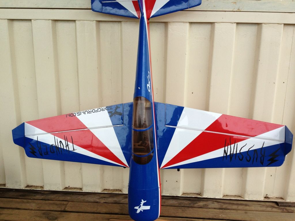

ImageUploadedByTapatalk1370837292.909935.jpg love the vinyl thanks gyro
