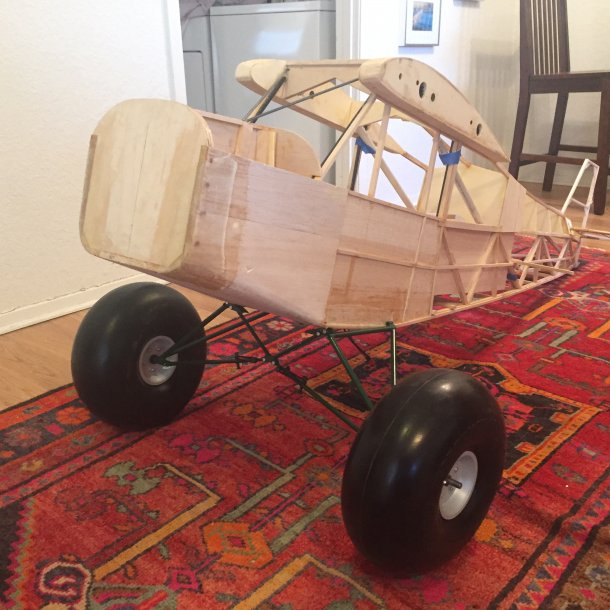

So, I got my landing gear built. Buying those landing gear was a great idea. It was easy to just bolt them together, and of course, I had to mock it up! It's going to be a real bush plane! Here's a photo of mine and the real one.

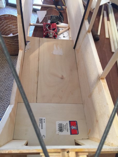

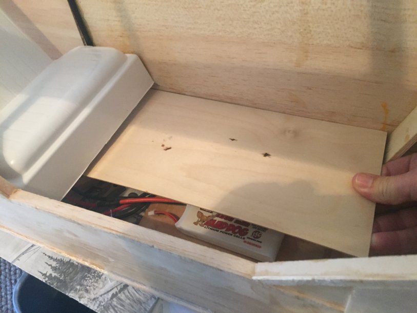

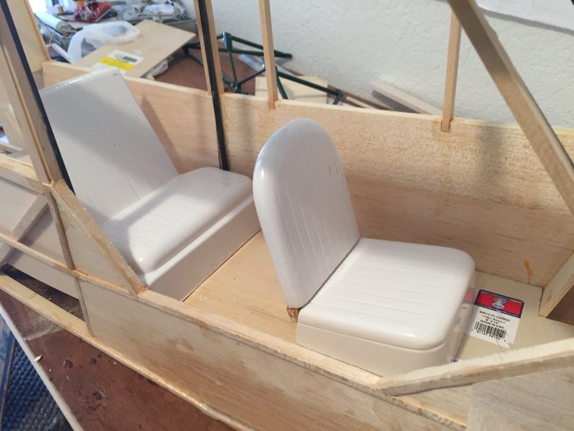

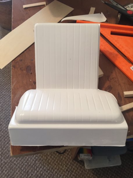

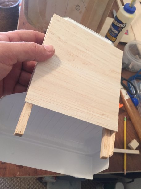

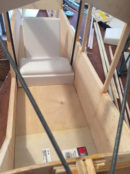

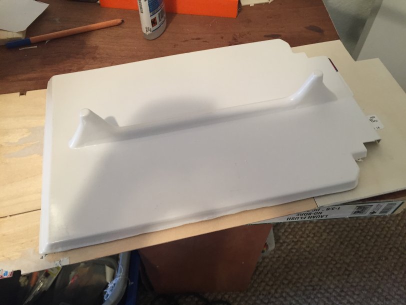

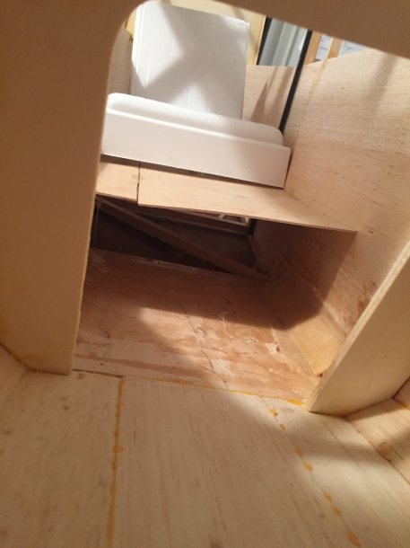

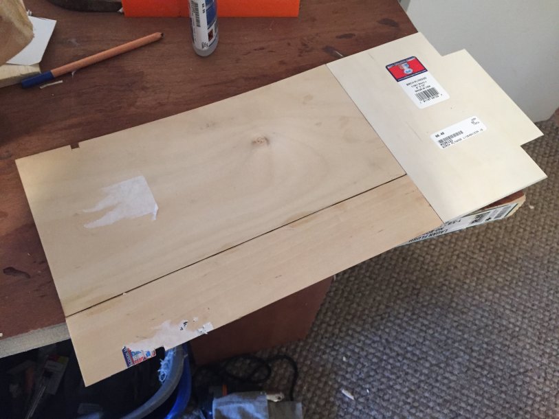

So a little update. I've been doing the tedious interior work. I created the chair back for the rear seat and planned out the floor installation. Because my electronics and batteries will be below the cabin floor I had to plan how to connect the seats, namely the rear seat to the cabin floor and still be able to access below the floor in the cabin and the baggage area. I decided not to use the plastic cabin floor that came with the kit but to use a wood floor that will be stained later on. There's plenty of space below for batteries, RX, and smart-fly.

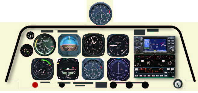

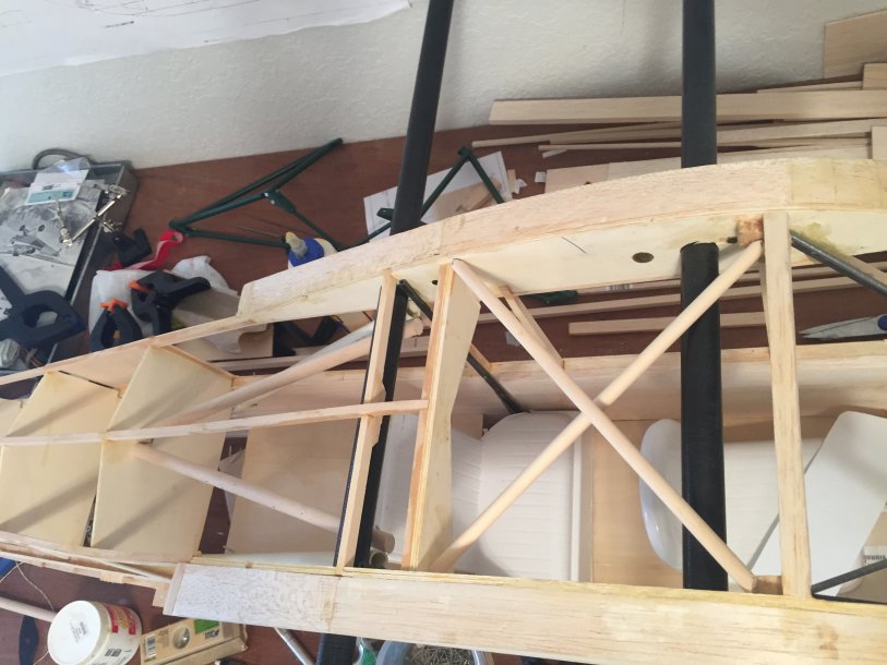

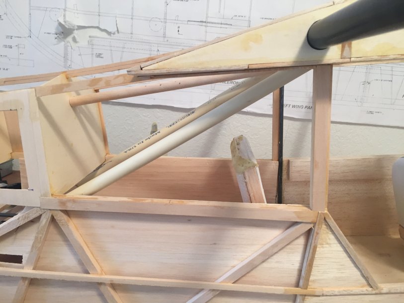

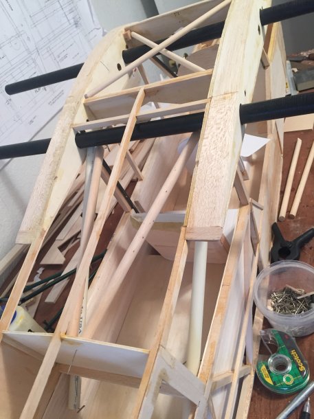

The next big step will be painting the interior, but first I had to go ahead and mock up all the support tubes. The support tubes in the full scale are all green, and the interior is white. The instrument panel in the full scale is a more modern square panel, which I custom made in Adobe Illustrator. Here are a few shots.

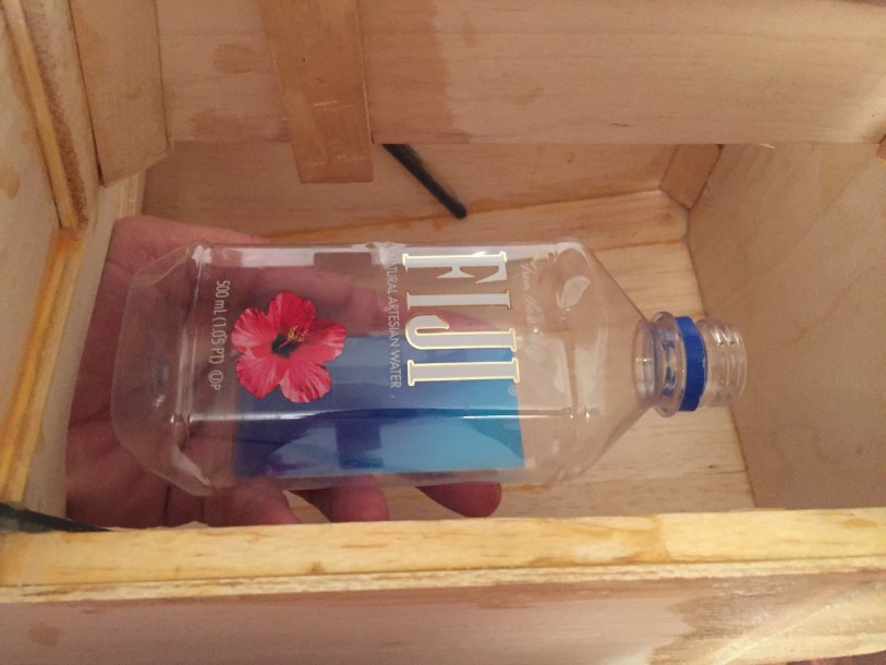

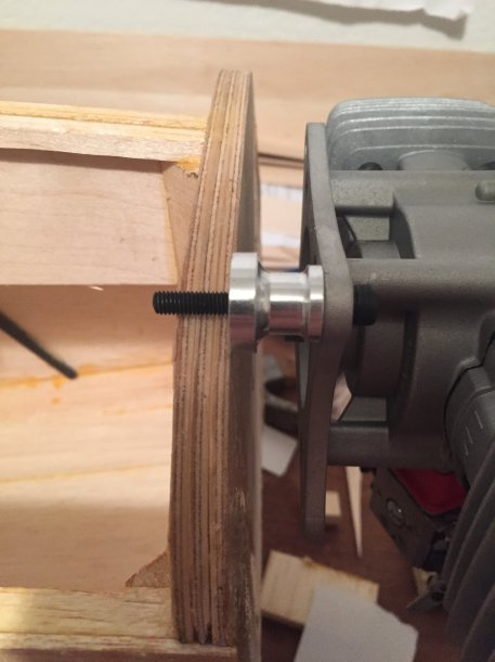

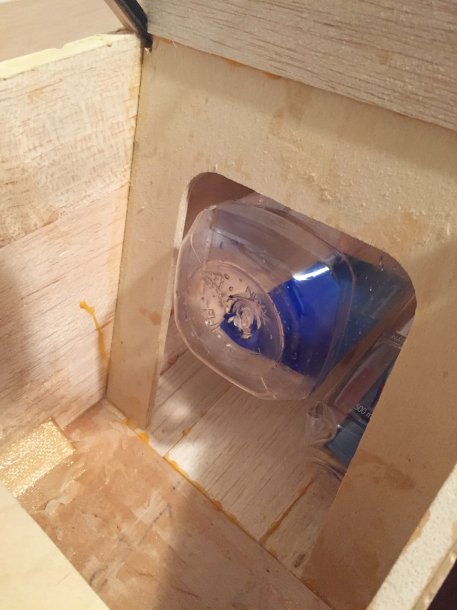

After interior paint, which should happen today or tomorrow. I'll go ahead and mount the engine. I had to buy mounting bolts for it, and hopefully they're long enough. I guess if they go all the way through the blind nut and I'm using high temp lock-tite.... that's all I need. Another problem that I think I've worked out is that instead of one large fuel tank that's sticking out into the cockpit, I'm going to have 2 500ml daisy chained fuel tanks that will be hidden up forward. I've asked around and this should work fine. Now, one thing to note, is that the 1 liter fuel tank will fit under the floor in the cabin, but since this is not only a taildragger, but huge tundra tires... the distance from the tank to the engine would be pretty extreme, so I decided against it.
