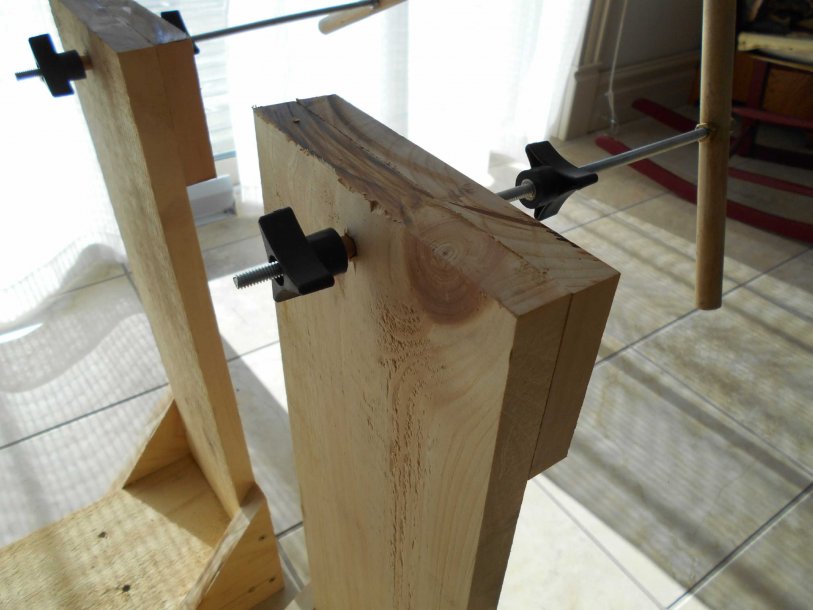

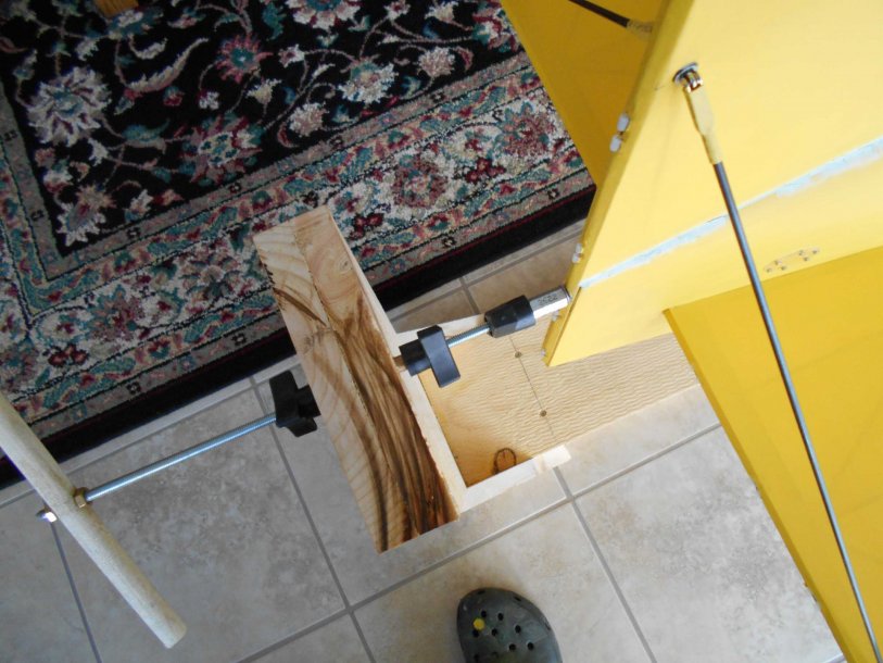

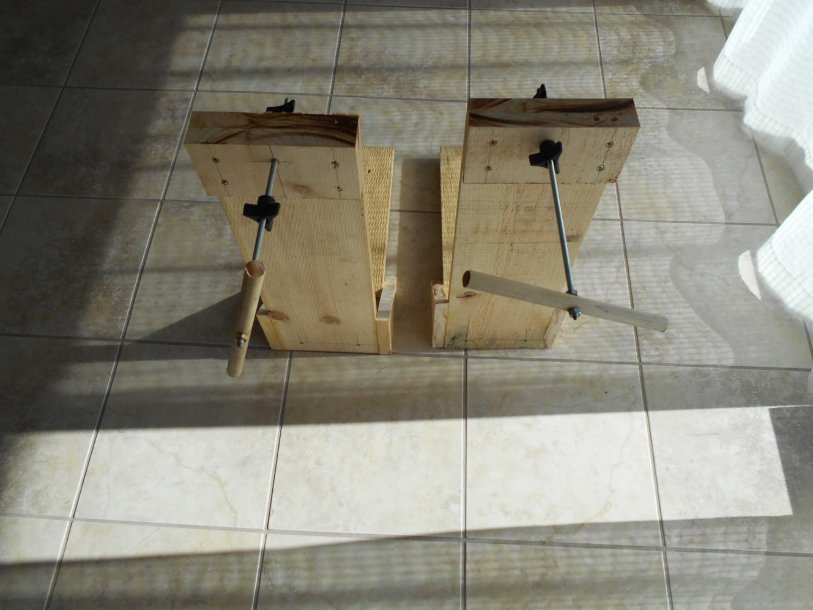

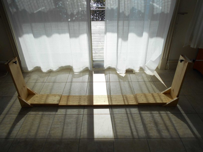

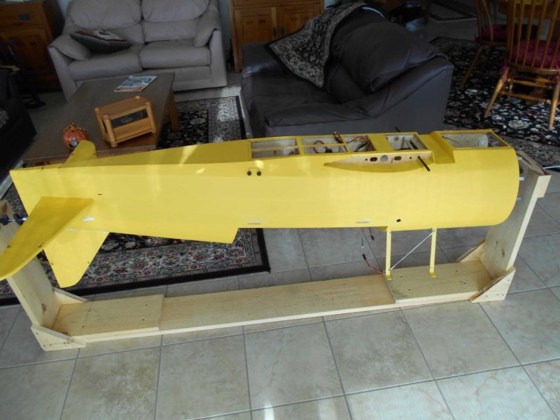

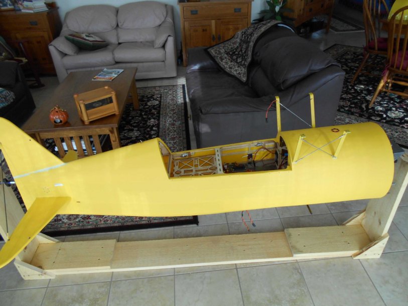

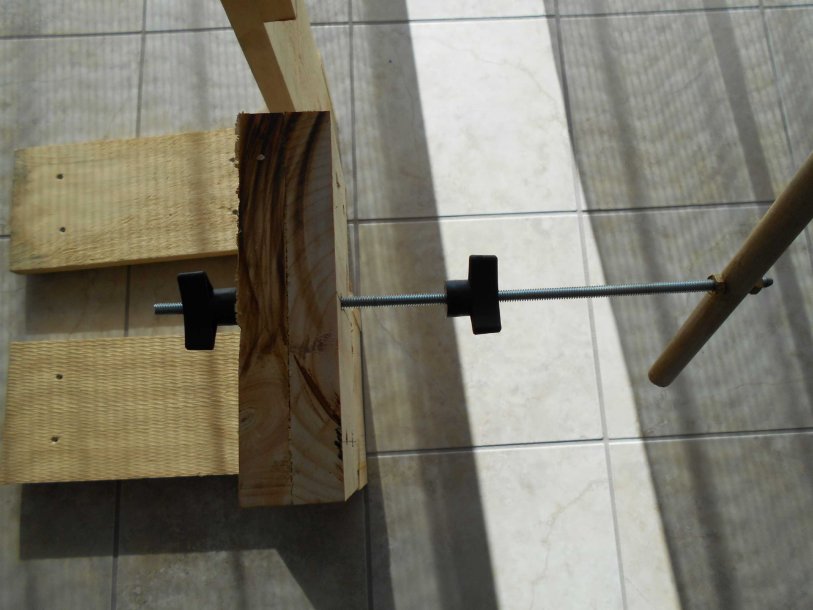

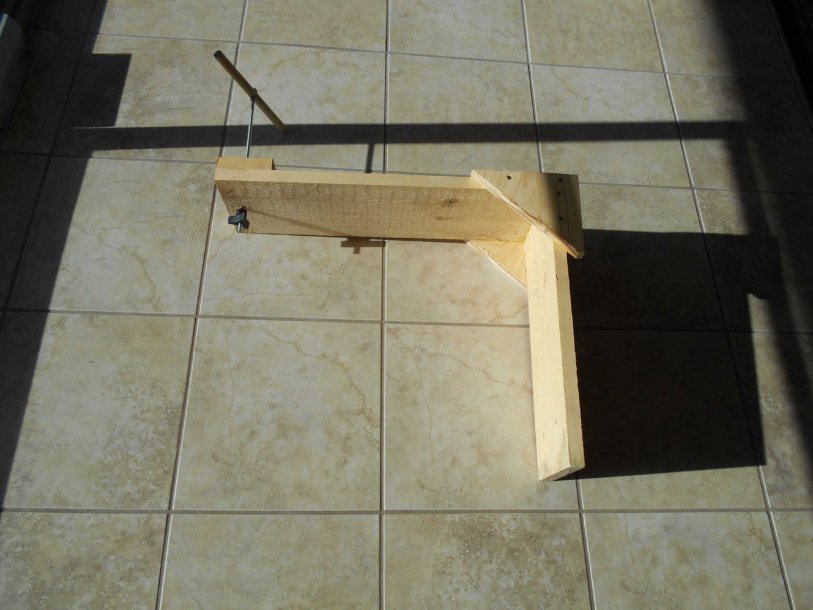

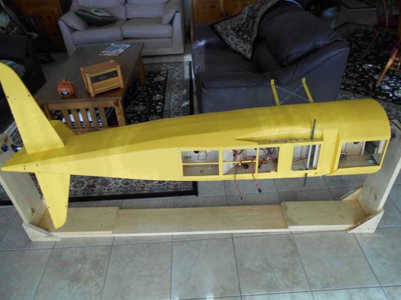

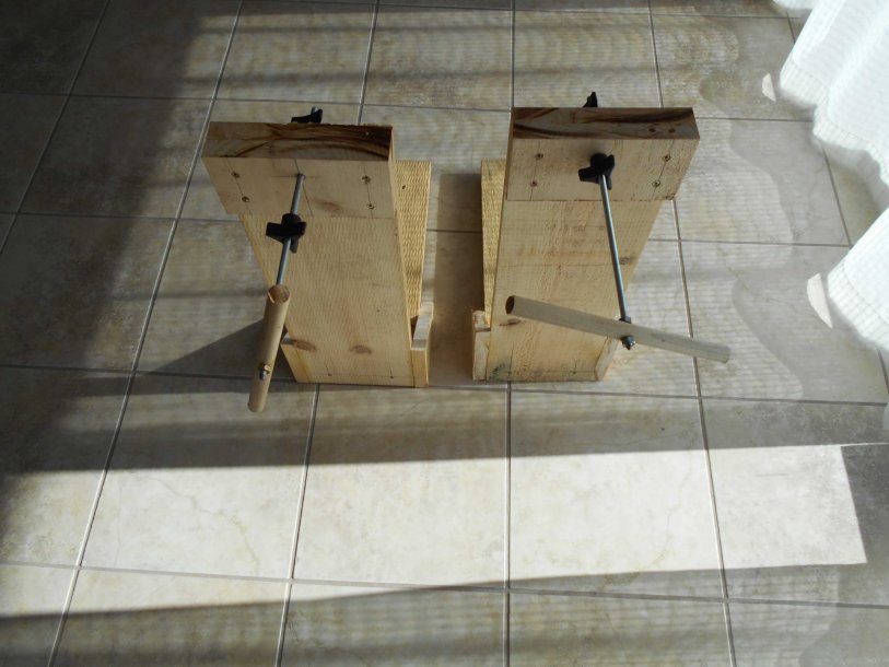

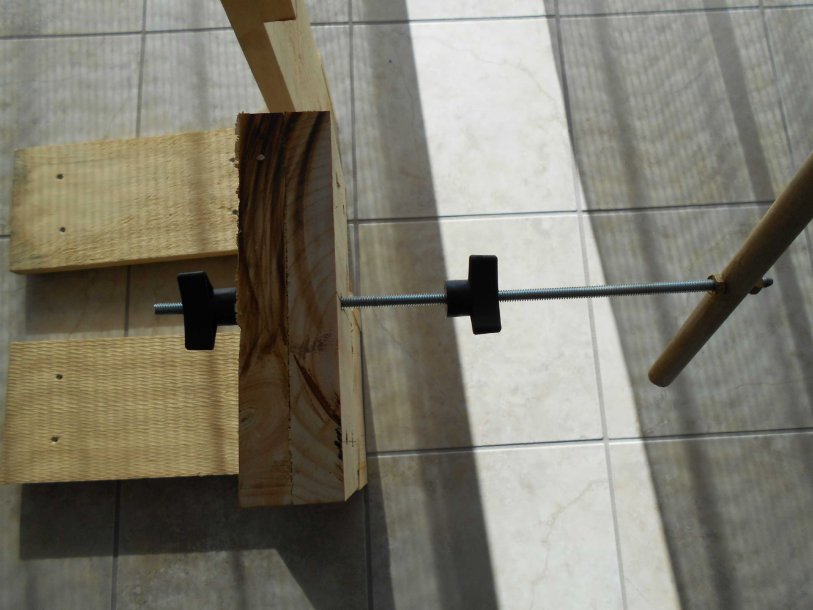

I am getting close to start the painting of the fuselage so I decided to build a jig that would allow me to rotate the fuselage during the painting operation.

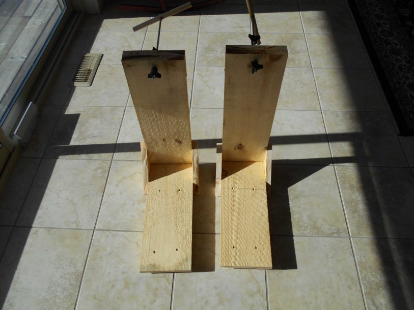

I built the jig out of some left over 1" by 8" pine. I made it in 3 pieces so I can store it easily.

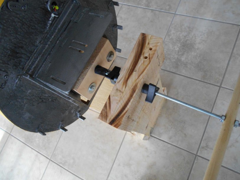

At each end I installed 1/4" sintered bronze bushings to allow the 1/4-20 threaded rod to rotate easily. On each end I put Jam Nuts so that I can lock in the correct length of the rod holding the fuselage in place.
Each airplane will have its own unique clamping mechanism; on this one I made a simple wooden bracket to attach to the firewall. I used another Jam Nut to clamp to the firewall wooden bracket. THIS IS WHAT KEEPS THE FUSE FROM ROTATING.
At the other end I installed a small aluminum 8-32 threaded insert into the fin. I made up a small fixture that allows the 1/4-20 threaded rod to screw into the rudder retaining device and that it will stay in the proper orientation.
Now I can start painting the fuselage and I won't have to worry that part of it is touching an object during the spray painting operation.
