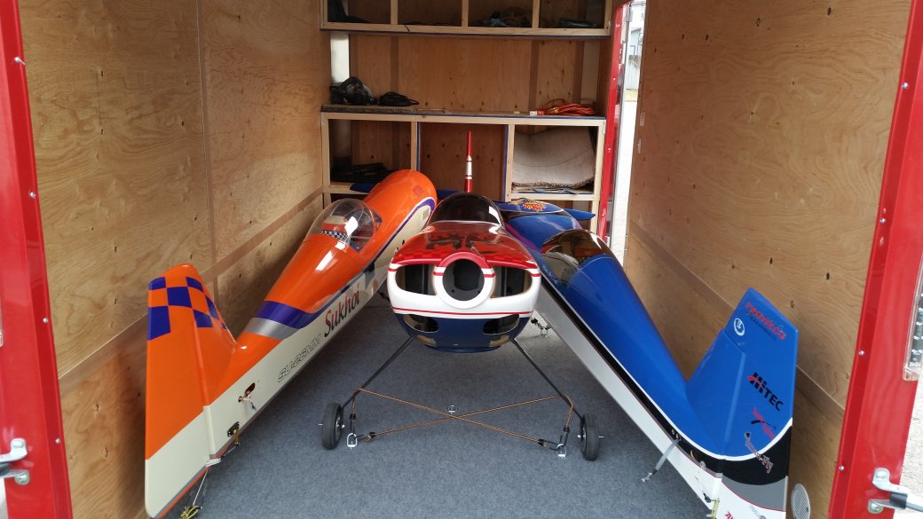

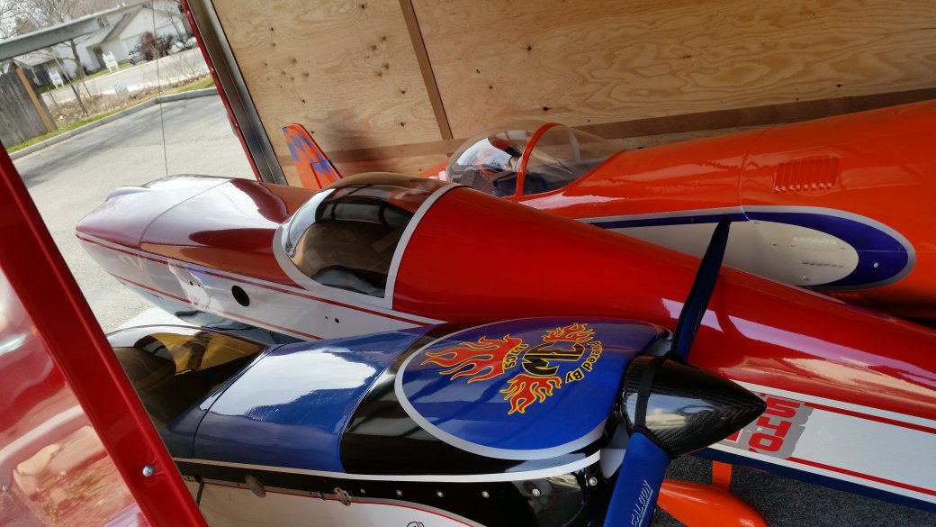

That looks right at home, but I think you will need a bigger trailer so you can haul more toys :)
See Mark? They fit. Just need to plan ahead. LOL....Once the second tier is built, I should be able to get all 5 of my big boys in plus my sons 43% Edge and his 30% Pilot Edge.

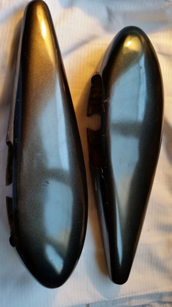

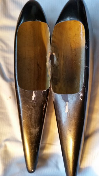

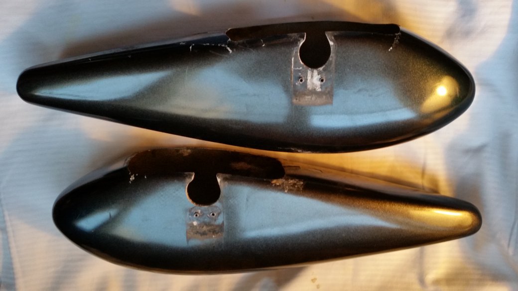

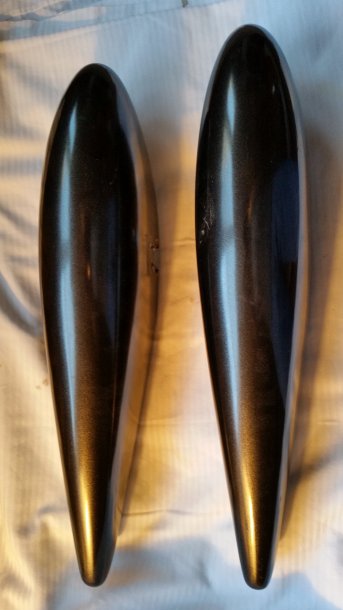

I am right there with you. Getting really excited. I did get some time to start working on the wheel pants. Yuk...they are some ugly beasts. Quite a number of stress cracks around the parameter of the opening for the wheels. Not serious enough to replace, but definitely in need of some reconstructive surgery.
20150303_171918.jpg 20150303_171931.jpg 20150303_171945.jpg 20150303_172008.jpg

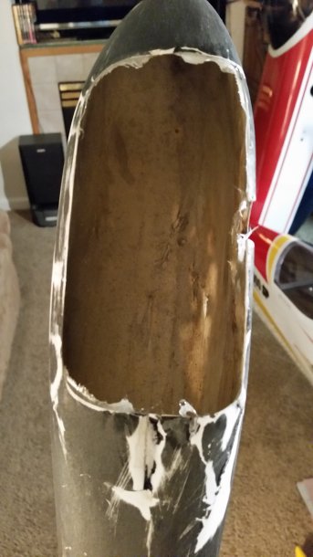

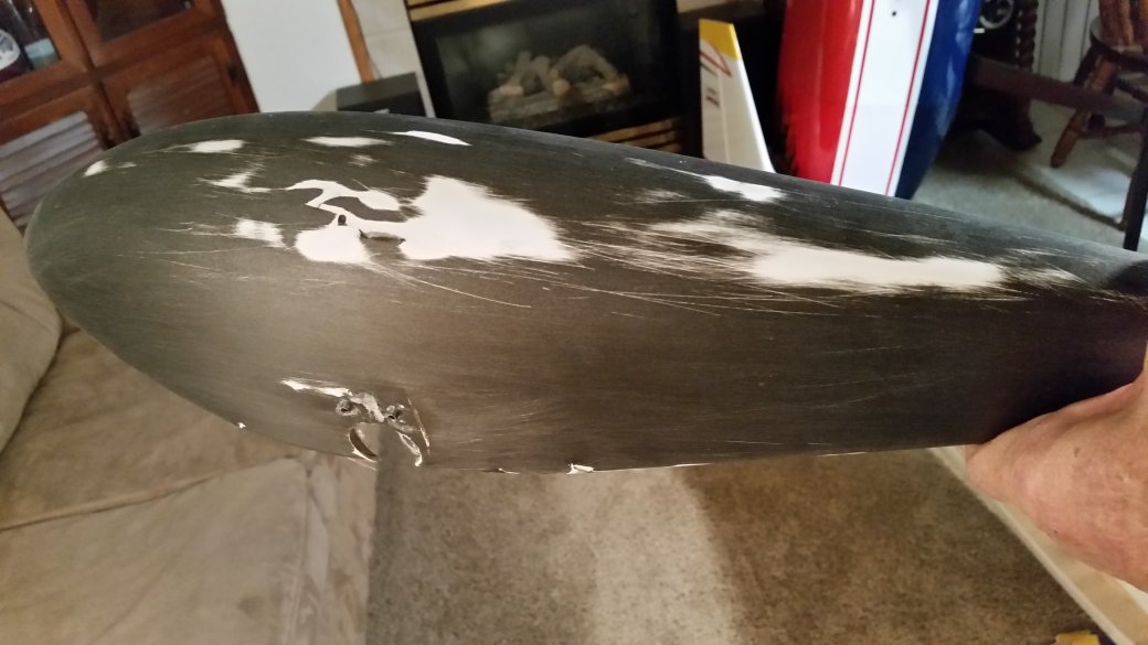

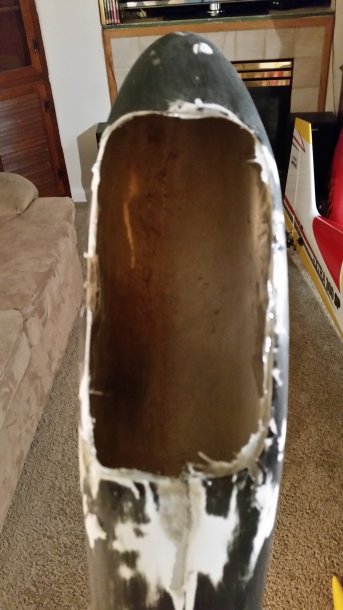

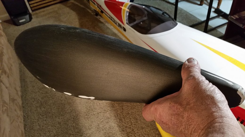

After sanding through the original paint, I was able to see just what really needed attention. I sealed up the cracks to hold them in place while I worked on them. CA works great for setting cracks. All inside work finished and waiting for the fiberglass to set. Once cured, I will do some reshaping of the wheel openings and do another final sand before priming. I should have them primed and painted tomorrow.
