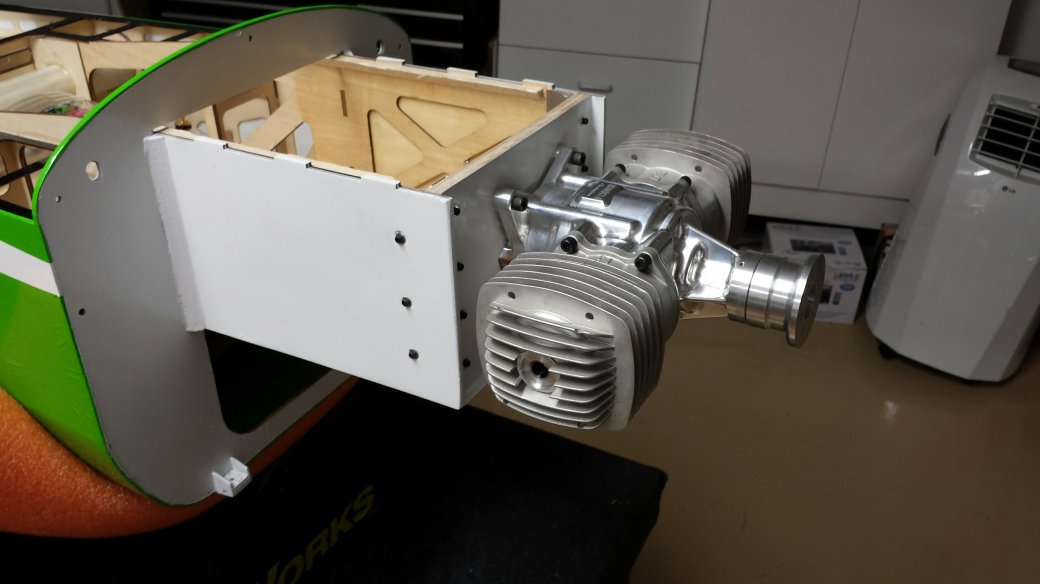

I installed 3/32” dowels next to the engine bolt holes to prevent the plywood from crushing resulting in a loose engine.

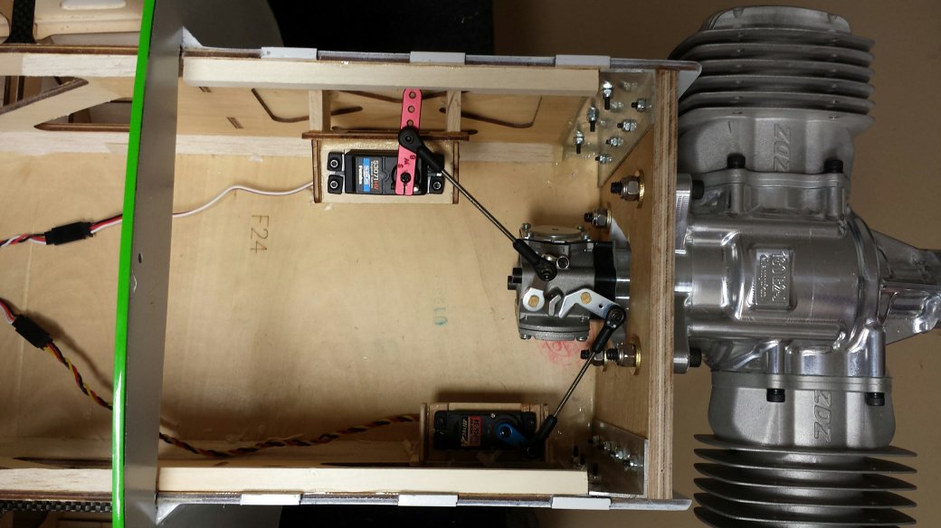

The engine box is painted and ready to install the ZDZ. I am keeping the top removable so that I can get to the carb and throttle servo. I am trying to decide whether or not to use a choke servo. Would love to hear some opinions on this from anyone with rear carb ZDZ experience.

Ok so I'm over my cold and back from the Lodi huckfest. Ready to go full speed this week and finish it up. I installed the throttle and choke servos. Decided on the choke servo after referring to Terry Wiles and Joe from ZDZ USA.

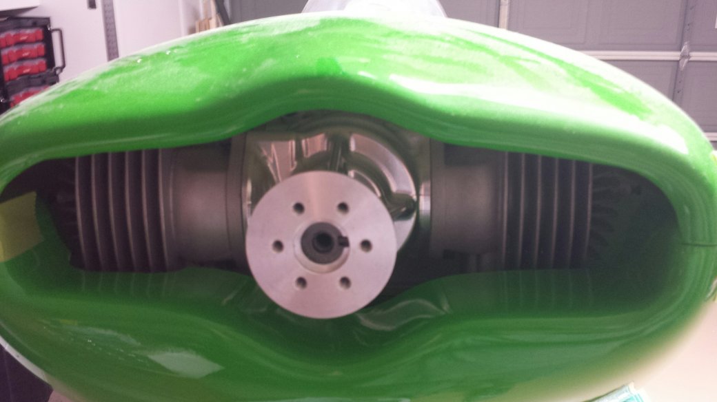

Engine is on and baffles made. Pilot makes the cowl on the Extra 300 with the baffles as part of the cowl and the builder just needs to trim it around the engine.
