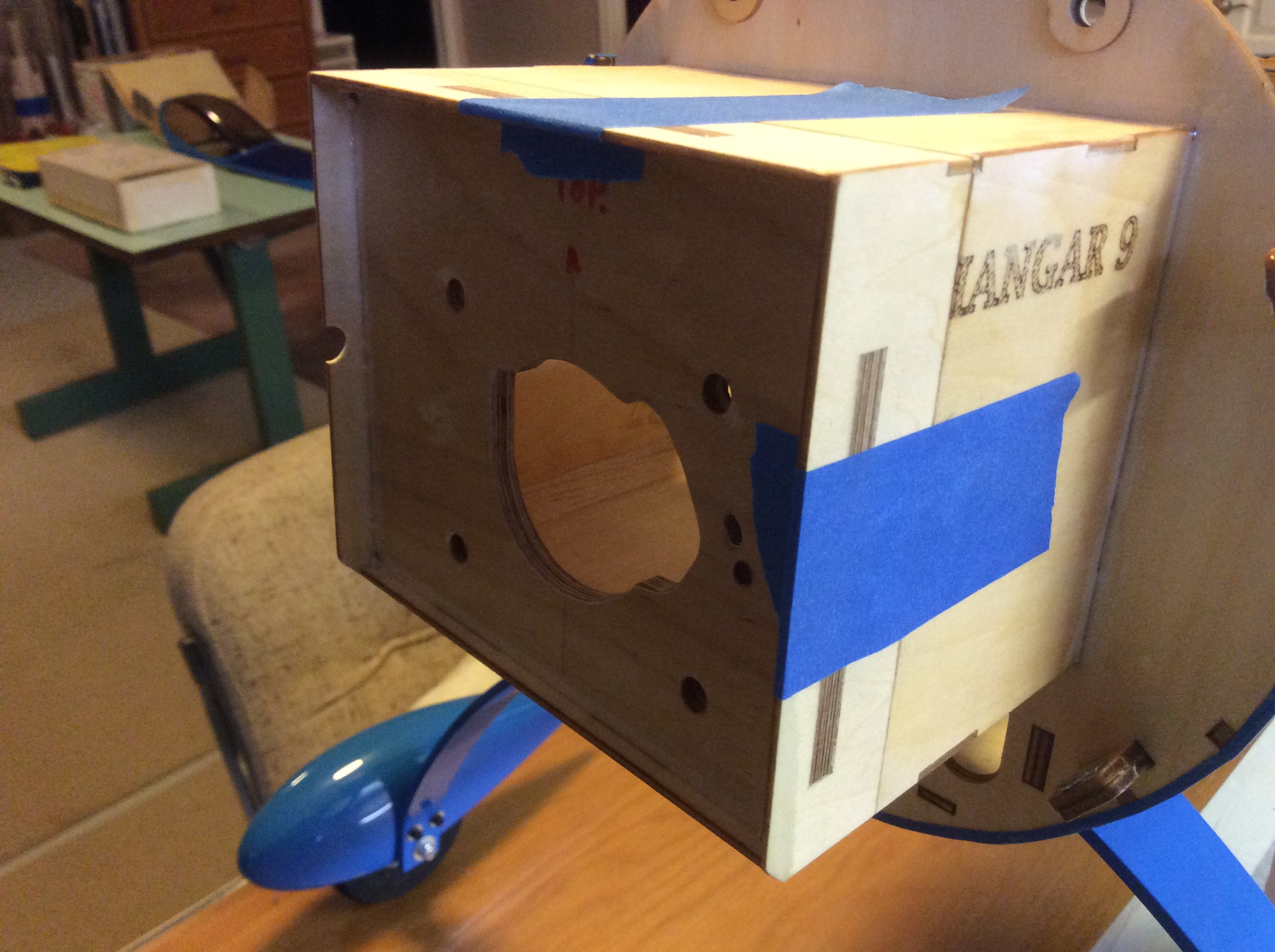

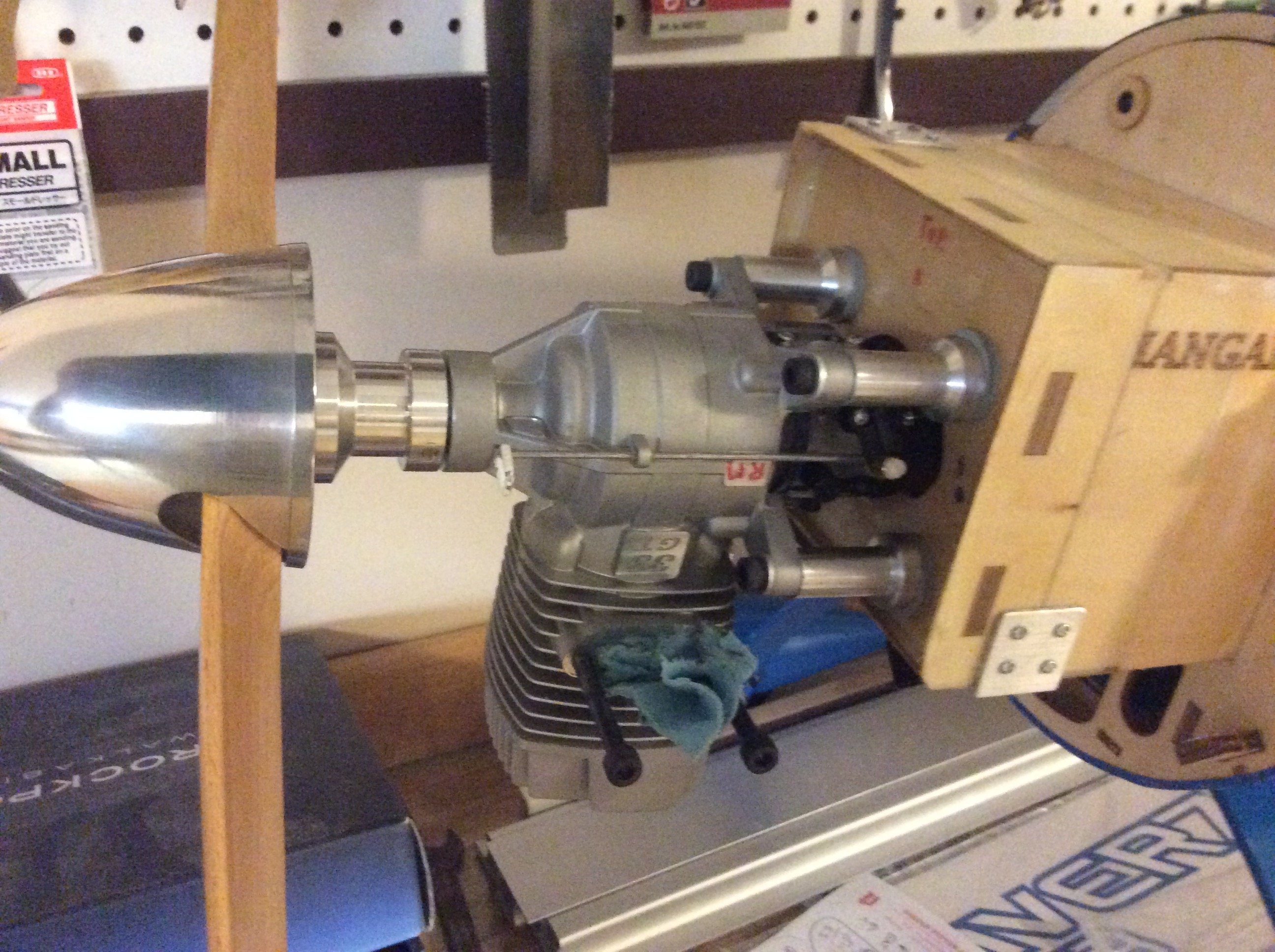

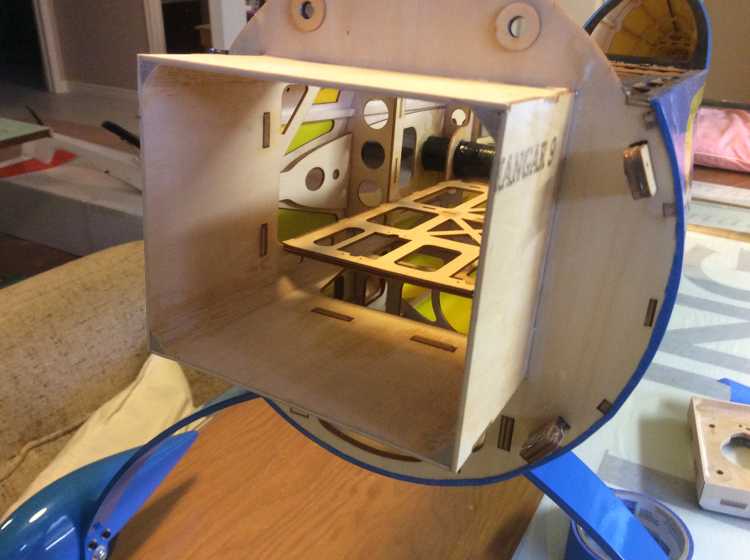

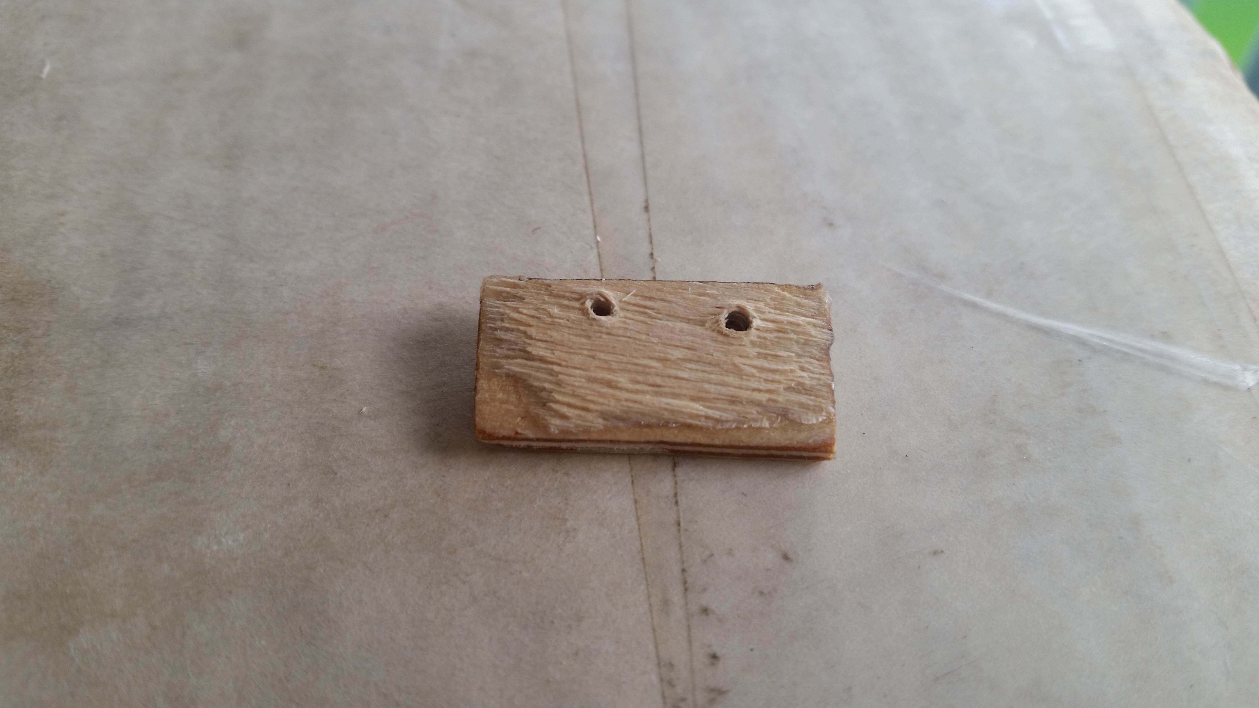

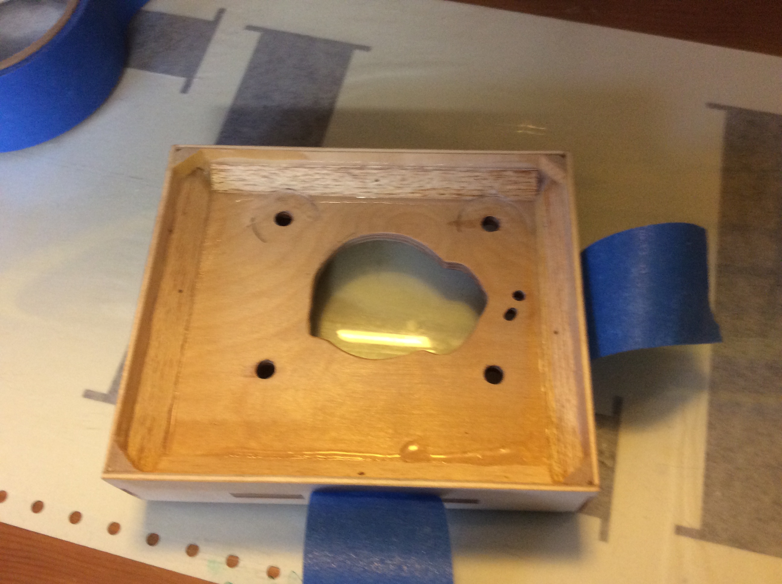

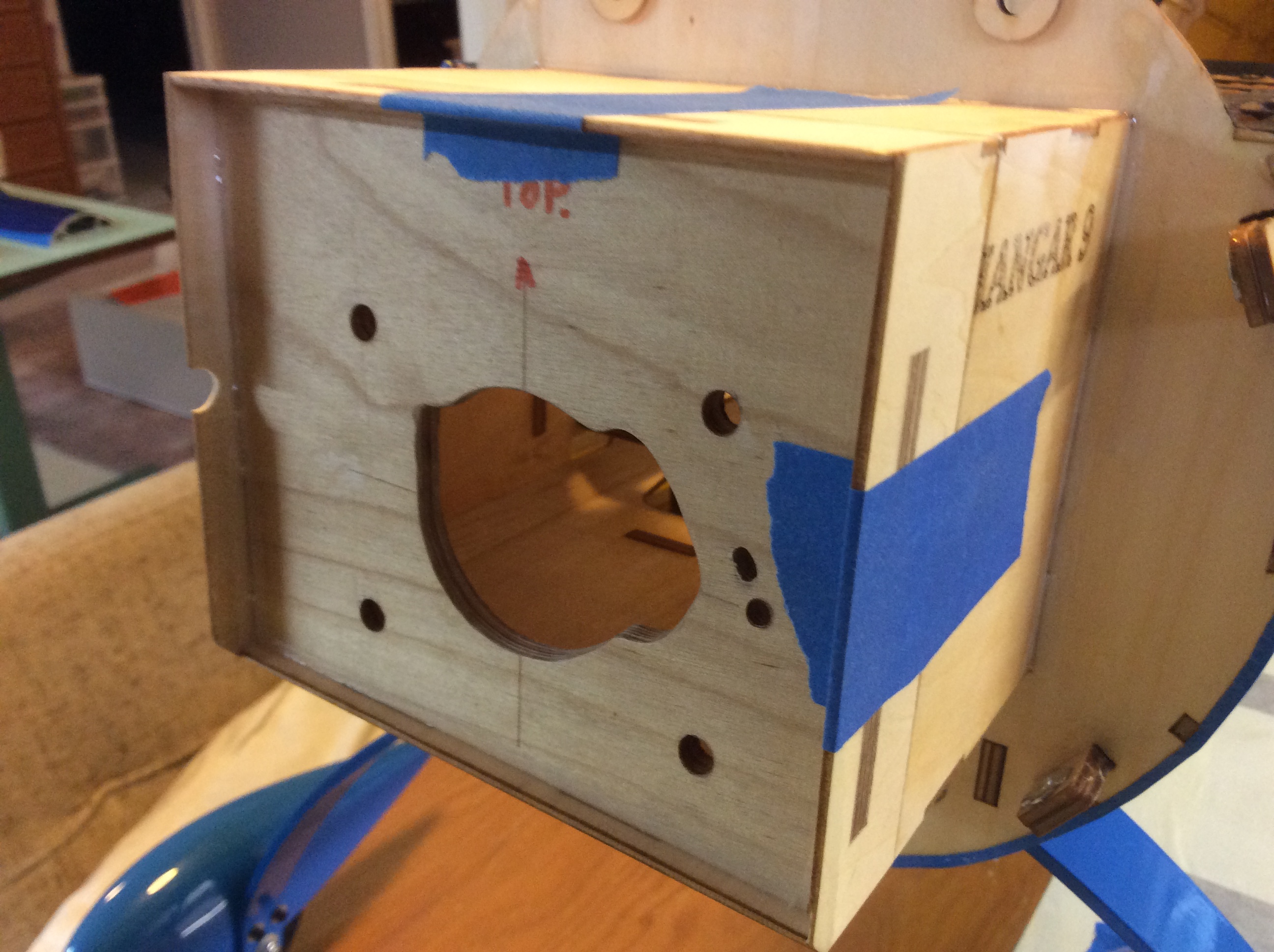

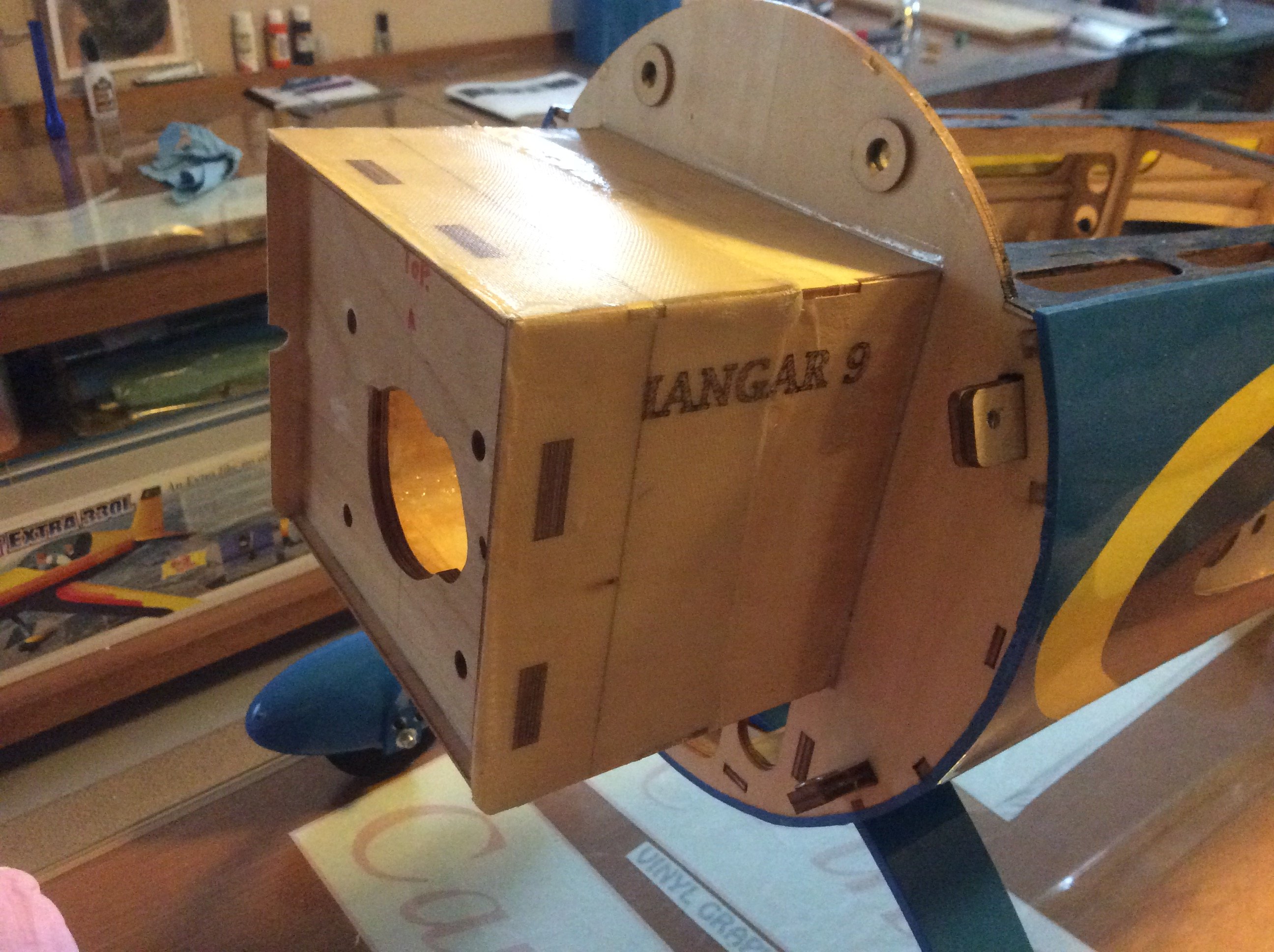

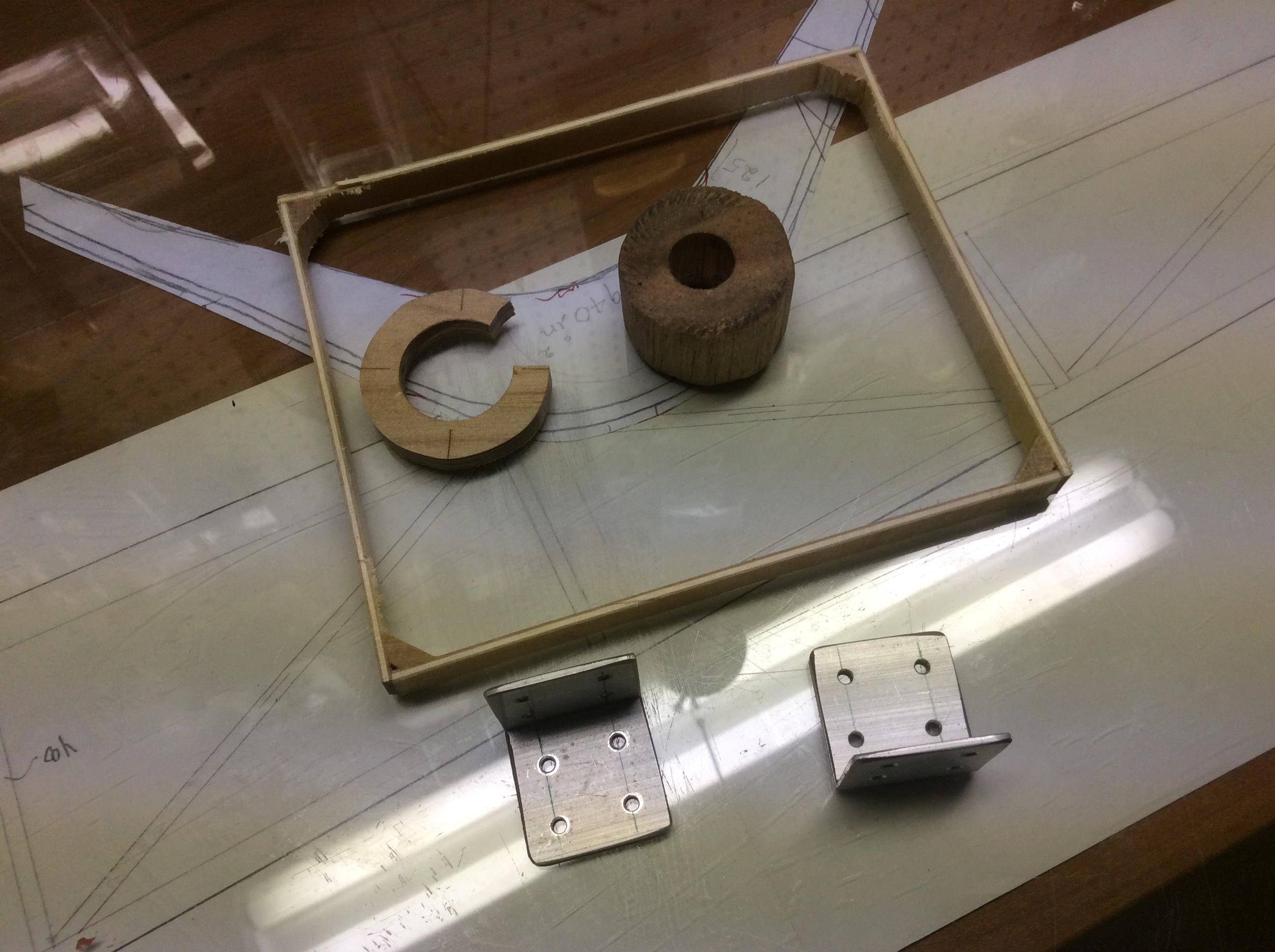

Had the difficulties you are working your way through, this is what I did to my Yak to get the engine to fit and everything to line up. You can do this several ways. If have any questions please ask.

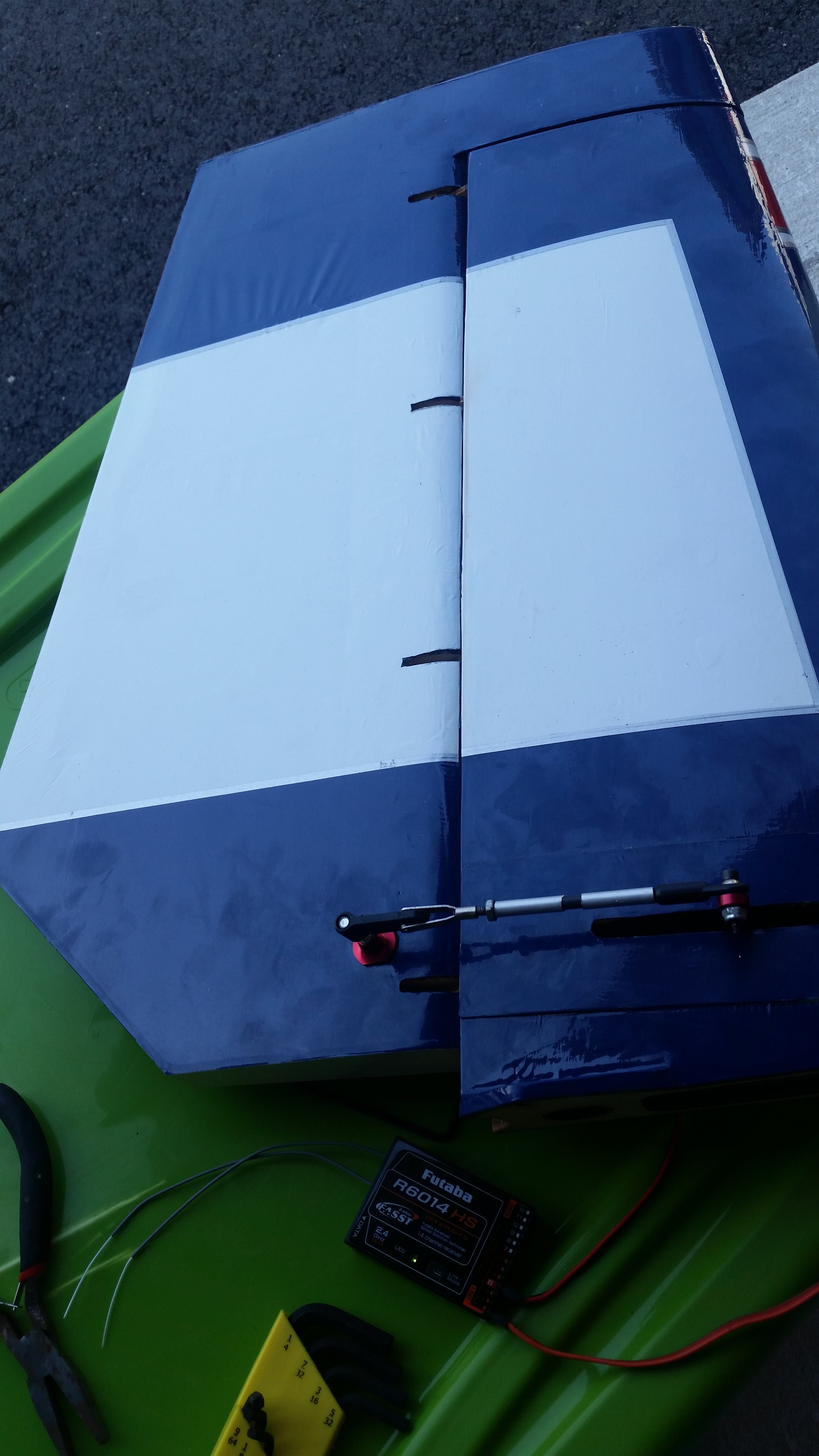

Even though the staggering temps the last few weeks have kept me from the flying field, I decided to try a little work on my Yak. I got up early Sunday morning and went to the shop. I don't have A/C in my shop, but it is in the shade and I had the double doors open with a nice breeze blowing. In a matter of about a half hour, I was soaked from head to toe so I closed up shop after about an hour and a half and went back in the house. I managed to get the two elevator servos in along with both servos in the right wing. I didn't get any pictures of the wing, but I have a couple of the elevator.

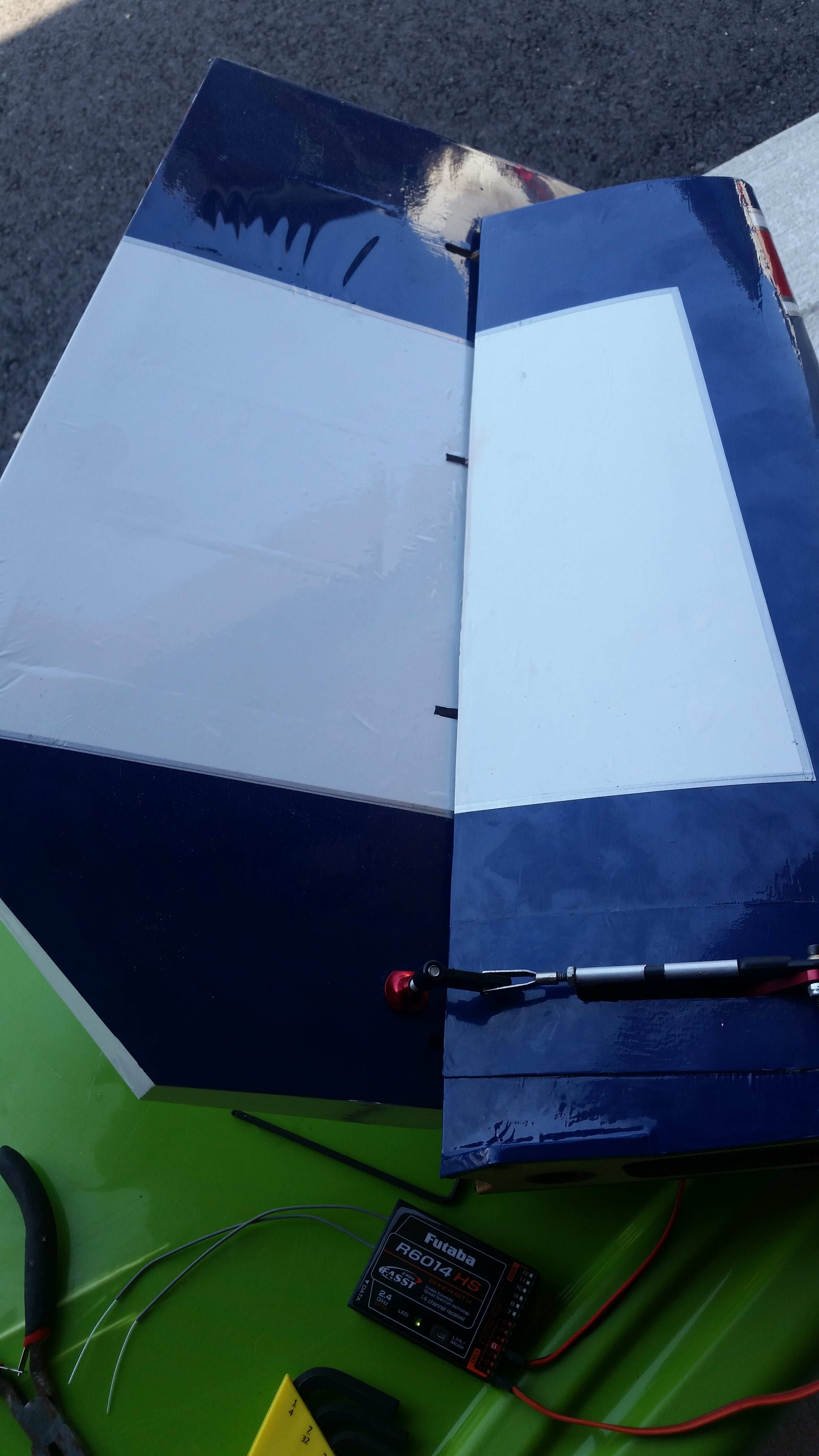

The above picture is with the linkage that came with the plane, but I'm considering changing the pushrod to a turnbuckle for ease of making adjustments. The second picture is full elevator throw
I know it doesn't look like allot of throw from the angle of the picture, but it's more elevator that I'll ever need. . . . . :yesss:. We're supposed to be getting a break in the temperatures tomorrow, continuing for a couple of weeks so I am planning on getting some more work done on my Yak in the evenings this week and hopefully some more work next weekend. My flying Buddy said he will more than likely re-break-in the DA-100 this weekend as well. If that happens, I might have my Yak ready to fly in a few weeks, good Lord willing. . . . . :big_yes:.
I also just noticed when I posted the second picture that if I decide to keep the linkage, I need to move the nut to the clevis end of the shaft on this elevator. . . . :do_not_know:.
Looking at the linkage the clevis and the horn on the elevator does the pin go all the way through the horn and the clevis so that clevis pin is properly locked in on both clevis arms. Looking at I do not think the pin is fully in gaged, make sure it is. If not it will be short flight if that pin is not fully in gaged on the elevator.
HRRC Flyer
Good eyes @Snoopy1. . . . . . :yesss:. As a matter of fact, the pin was not all the way in the clevis when I took those pictures, but I can assure you that the pin is all the way through and the retainer clip on the other side is locked in place. I learned my lesson with this type of clevis when I lost my Hanger 9 Miss America with a YS-91 on its maiden flight because I did not have the clevis on the clevis secured properly.

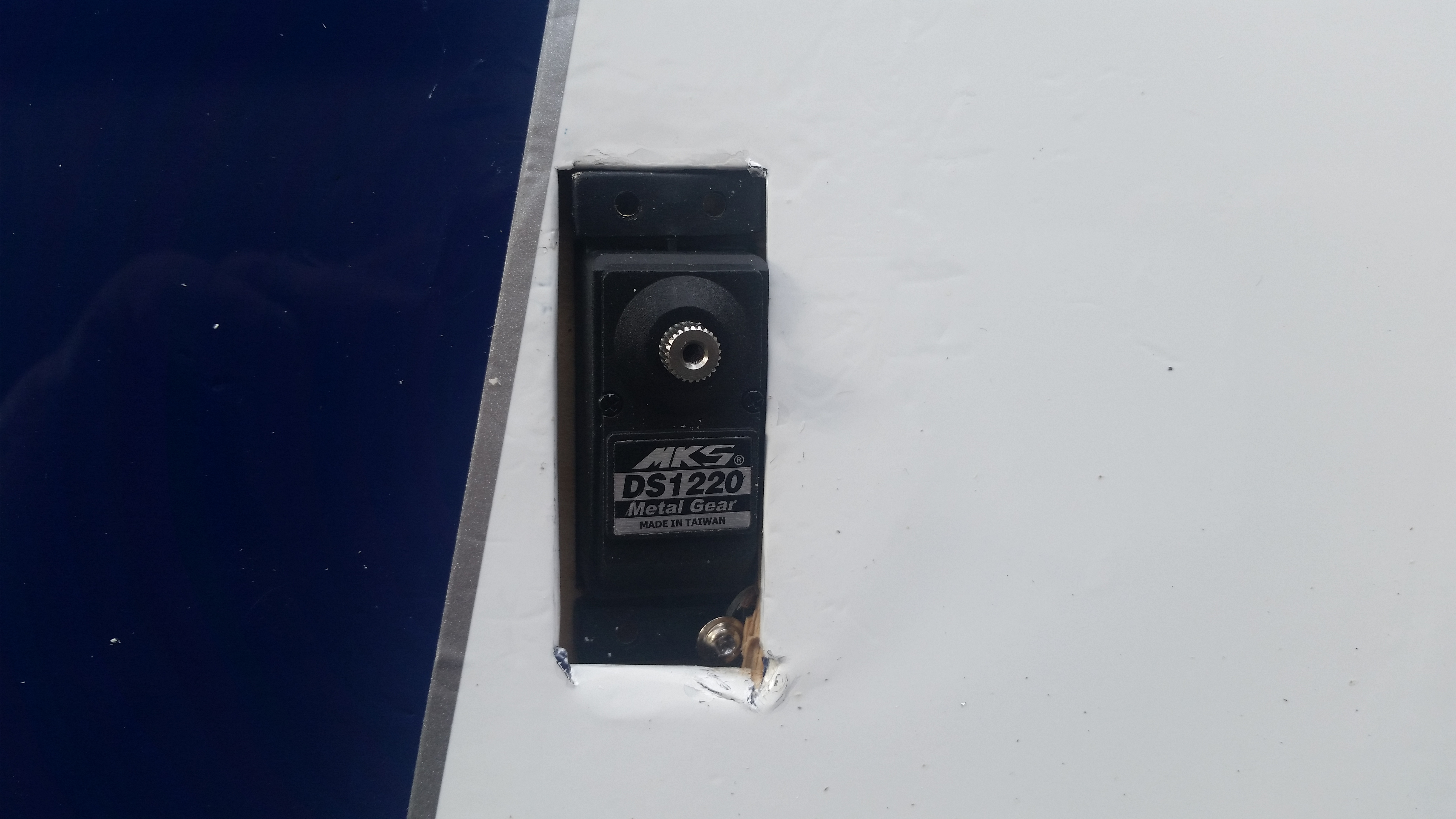

It was cool and sunny when I got off work so I decided I would do some work on my Yak. The only thing I managed to do is cause real damage to the right wing that is going to be a real Pain In The A__ to fix. Let me start with picture #1.

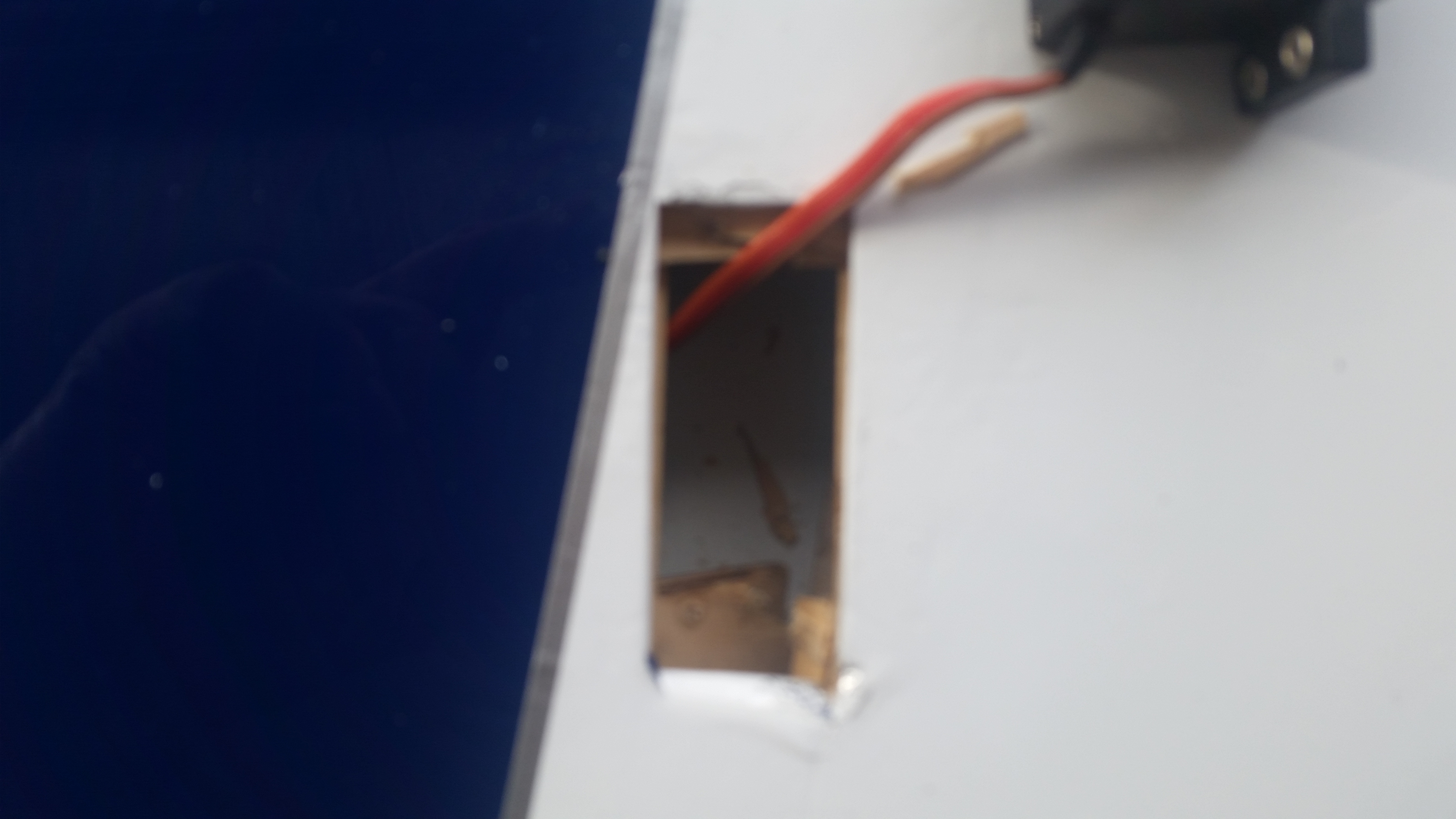

Yes, that is one of the aileron servos going through the edge of the wing sheeting. No big deal right? The more observant of you Fellas, like @Snoopy1, will notice it's a bit worse than it first appears because the damage doesn't stop there. Let's continue with picture #2.
YIKES, what stool knob took that picture? As bad as the picture is, you can see the servo didn't just go through the wing sheeting, it also went through both of the plywood servo mounting rails. As you see in the picture (maybe), the lower plywood servo rail is broken in half. In case you're wondering, it does get worse. . . . .
It broke the top servo mounting rail out completely. So now I have to cut the wing open to see what it's going to take to fix this mess. To say I'm unhappy is an understatement. The ironic thing is that this happened on the third aileron servo and the first two went in without any problem whatsoever. Obviously, any chance of wrapping this plane up fairly quickly and flying it just got flushed down the toilet. . . . . :frown:.
