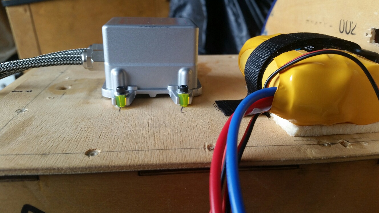

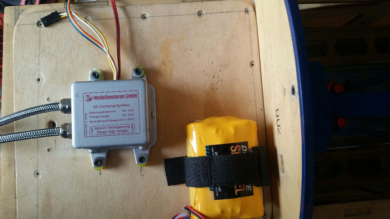

    As busy as I was this weekend, I managed to put a few minutes into working on my Yak. I decided it was time to go ahead and mount the ignition module for the red headed Beast. I decided to install it on the top hatch of the motor box.
    I talked to my flying Buddy about mounting the ignition module. He told me he has mounted all of his modules like this.
    That's a 2-56 bolt going through to a blind nut on the bottom of the top hatch. There is also a washer above and below. The fuel tube acts as a vibration isolator which is why the bolts are not cinched down tight. The ignition battery is also mounted, but I still haven't made up my mind where I am going to put the switch for it. I need to get this plane done so I can have something to fly. The covering is really starting to come off quite badly because of age and I am getting leary of flying it any more until it is recovered. Hopefully I will get some time to work on it in the evenings this week.
