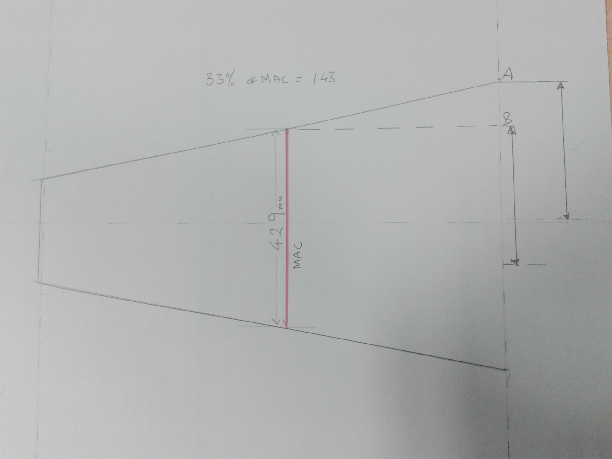

  9. Here is a sketch of my calculations...note..it's not to scale but the measurements are !
    THE MAC turns out top be 429mm, and 33% of this is 143mm (surprisingly what the manual says it should be). How, should the COG be this distance back from the LE of the wing at root or from the LE at MAC?
