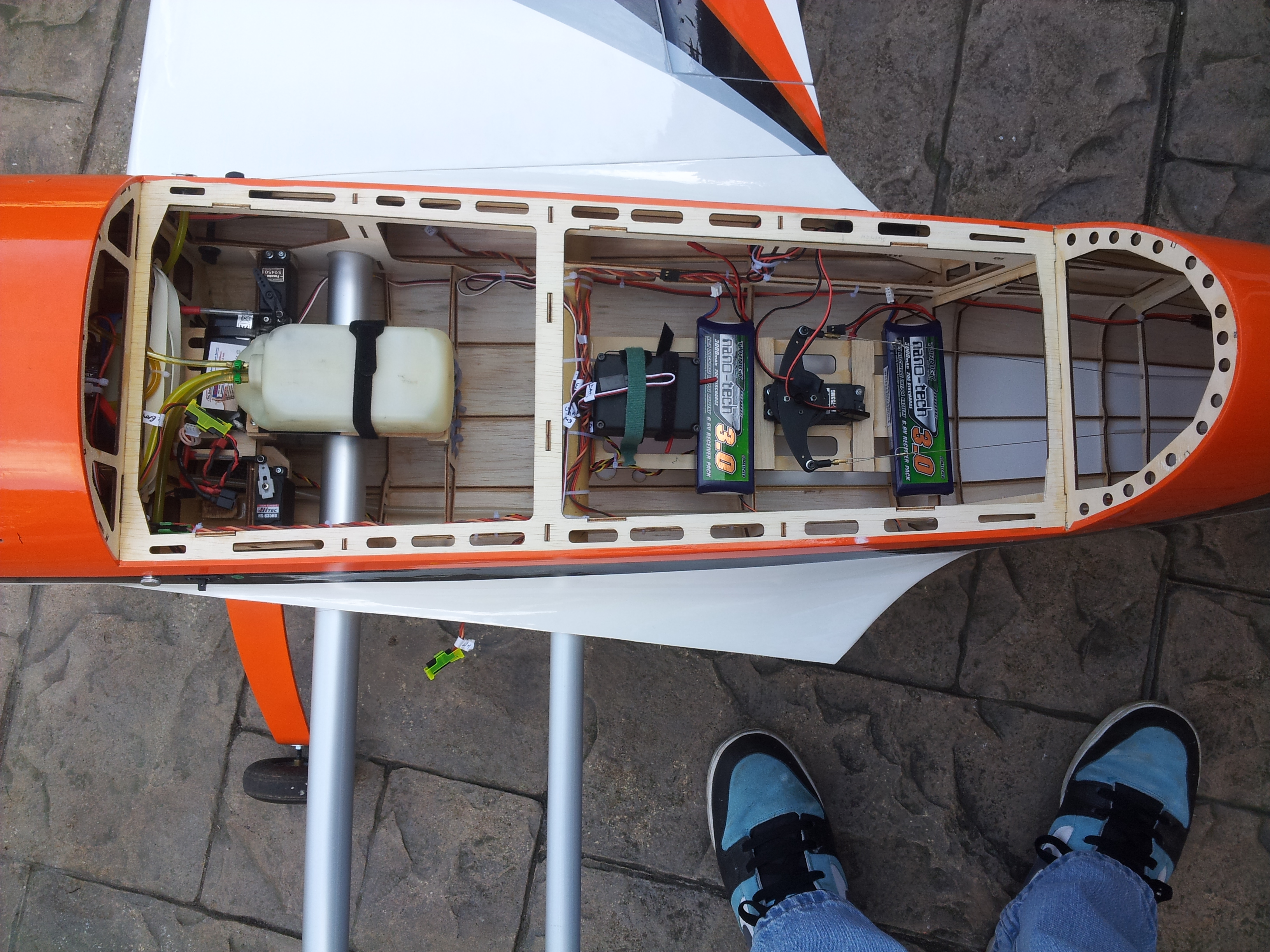

after much checking and re-checking, I went with the COG 143mm back from the start of the MAC. It took off ok, but the landing was anything but nice.. seriously tail heavy. Managed to get it down in one piece. Started adding some lead to the nose. Not much of an improvement and second landing was worse. Broke off the UC and broke the prop.

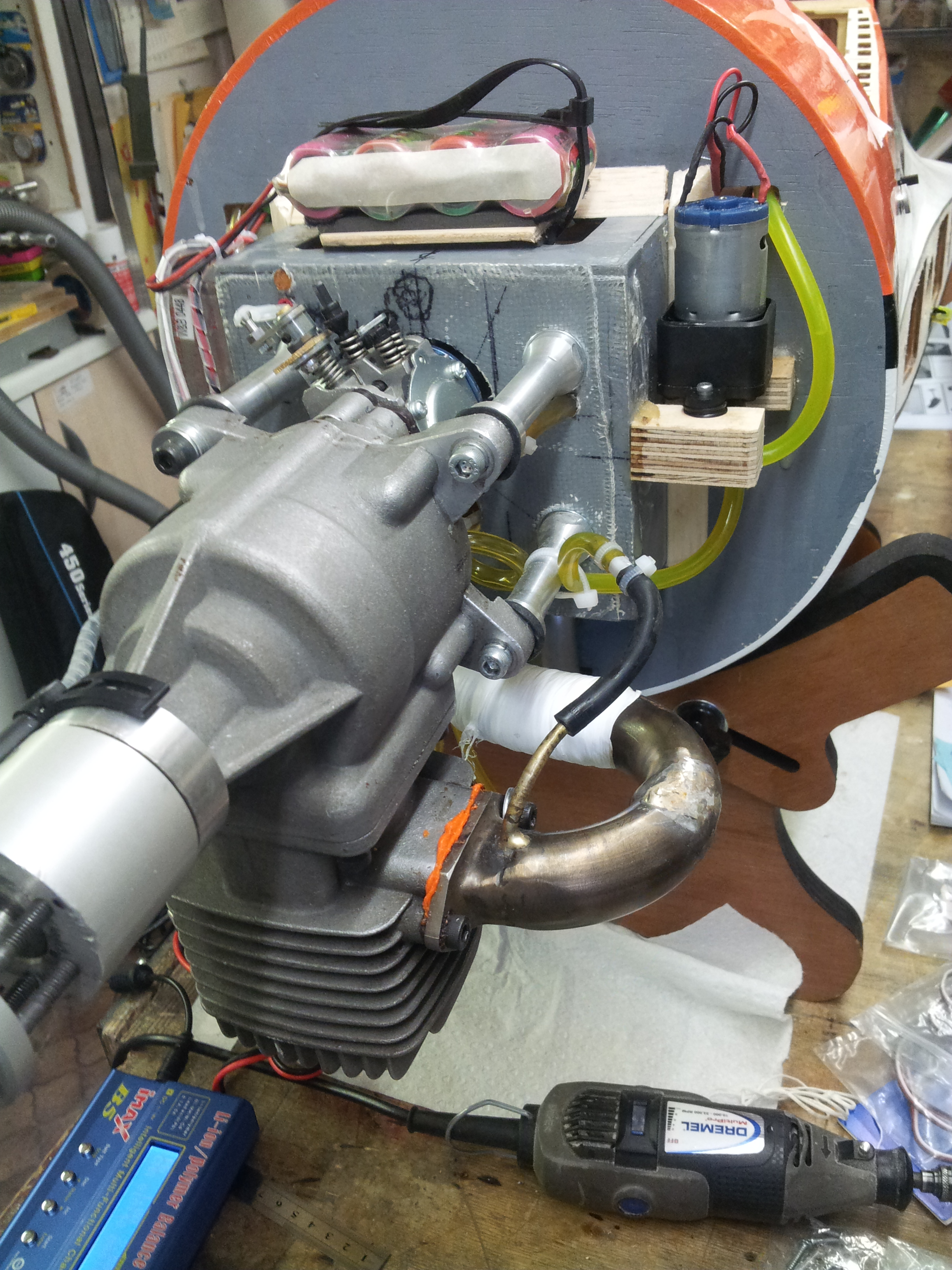

I have the Sukhoi to my friend Nigel who did some serious work on it. He build a new engine box around 3 inches in front of the original. He also moved all the batteries as far upfront as possible.

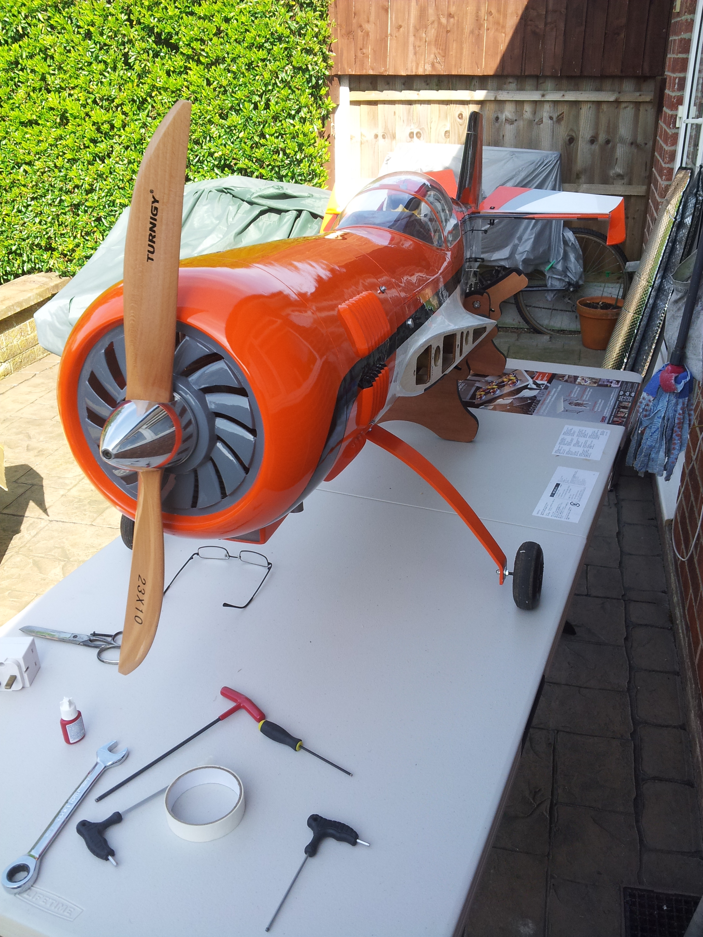

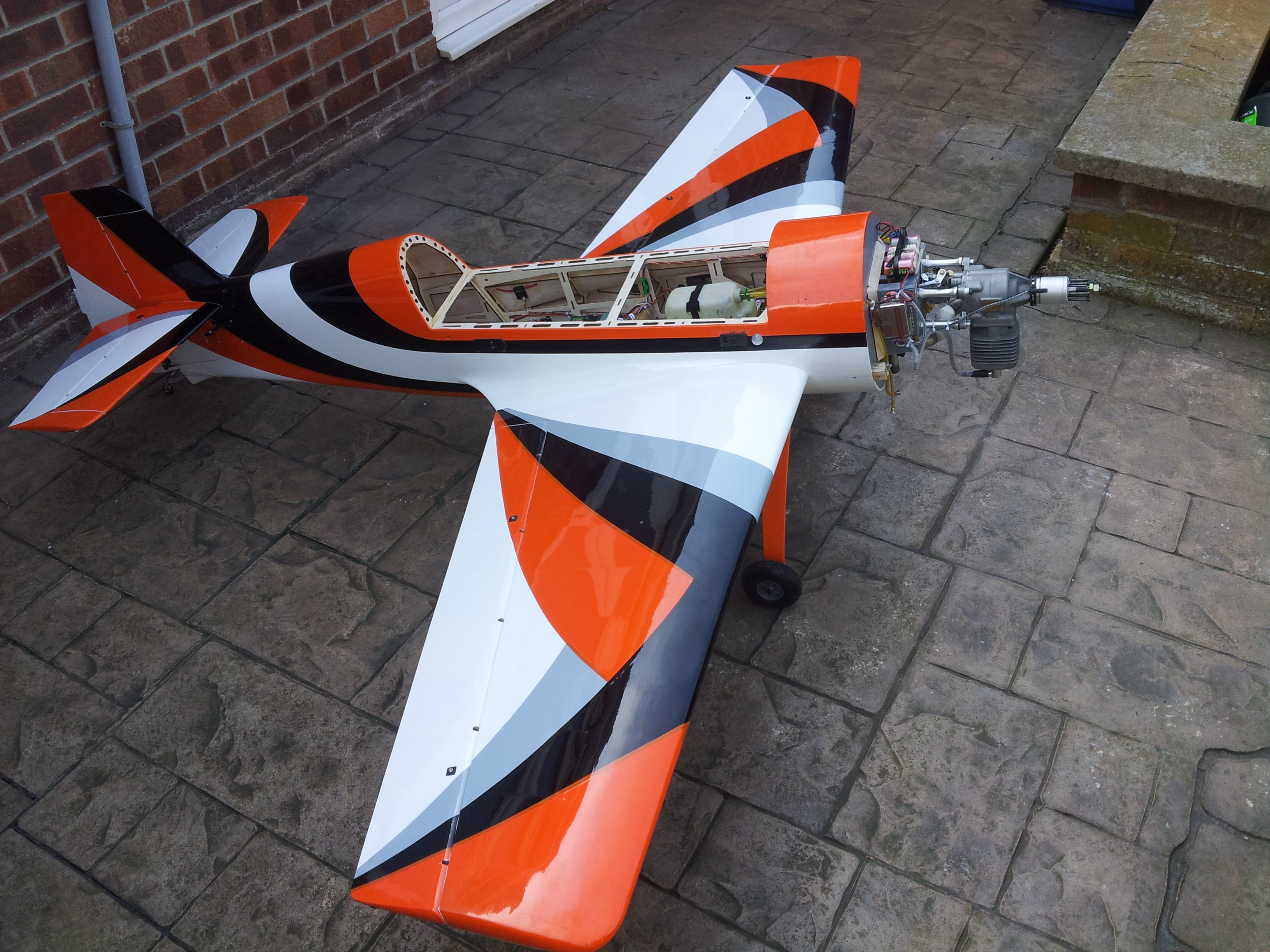

Very interesting video? I know this kit is not the best quality but when I got mine I thought I was going to do well at a cost of £299.99 for a model of this size but the first thing that put me off a bit was the hinge method as my elevators especially are not as solid as they would have been using Robart type and I think that will be the first mod I make after the test flight, I have mass balanced the elevators as I don`t want to induce any flutter. My engine is a ZDZ 60 sitting on standoffs which are about 60 or 70mm long I forgot to measure them before fitting the cowl today. Having now got it ready to maiden I think it balances around the stated 143mm or just in front, if I pick it up with the larger of the two wing tubes it noses down a bit so I hope it will be ok for the first flight at least then take it from there. We have a tarmac and grass runway at the club site so hopefully I won`t have the nose over problem unless I have to land on the grass. Depending who is on the field when I take it for the maiden I will try and get some flying shots and maybe a video to post on here. Do you have any expo programed?Su 26m-23.jpgSu 26m  -  27.jpgSu 26m  -  31.jpg
