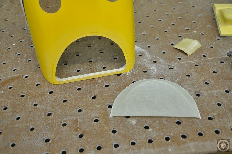

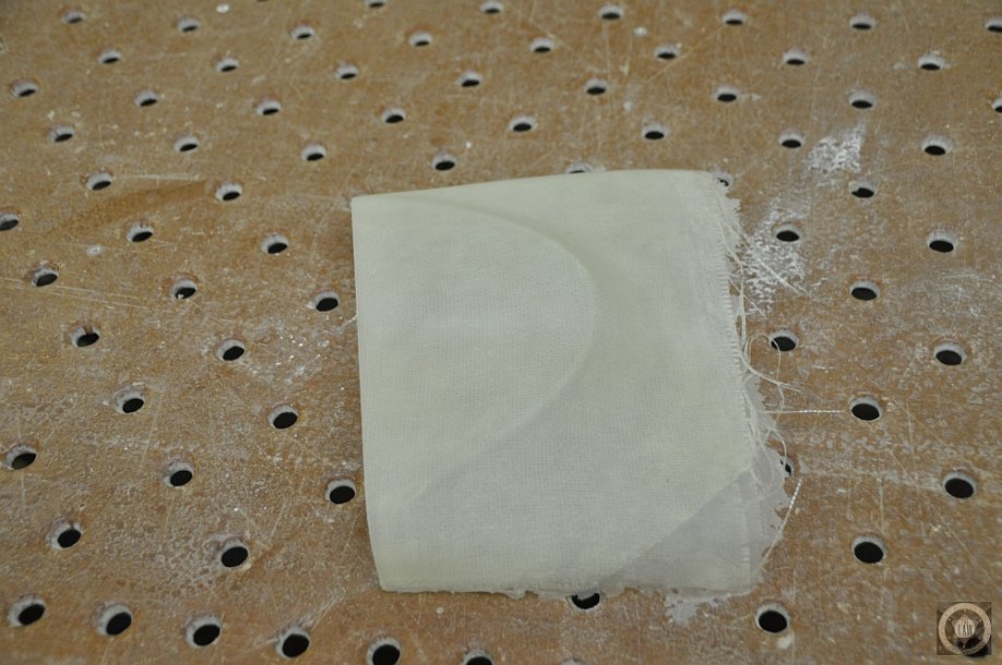

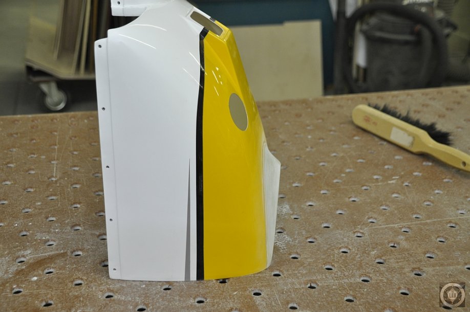

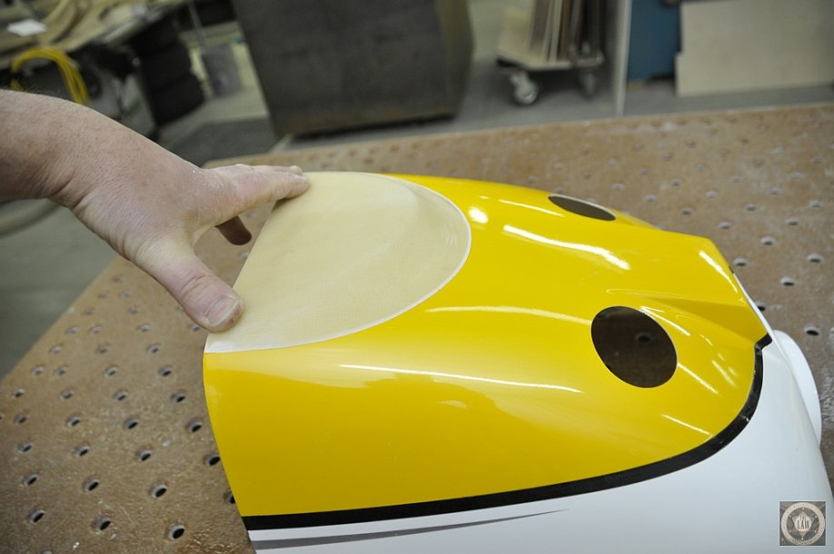

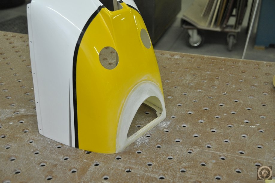

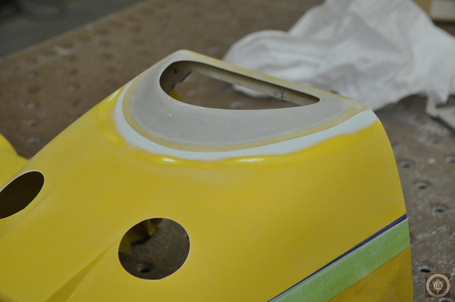

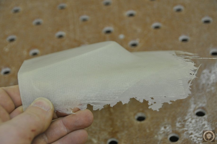

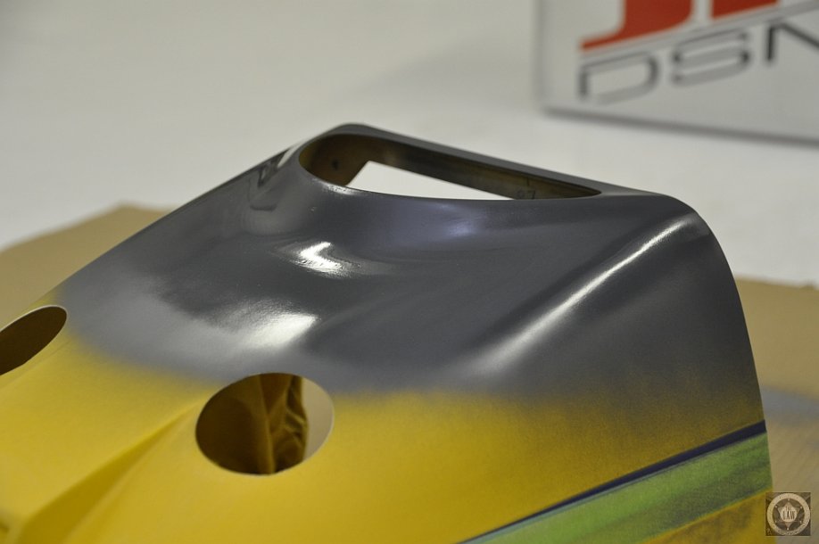

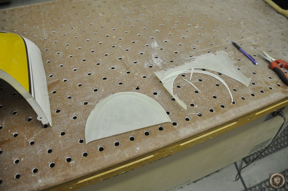

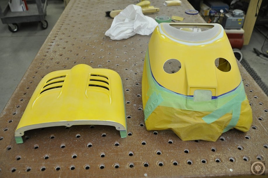

I got back to work on mine later tonight and here is what I came up with. Really pretty easy, no special tools or anything. I used some 3oz satin cloth first so I don't really have any pinholes. I did this so I could cheat and use some rattle can primer to prime and tomorrow morning I will sand most of that back off anyway.
Tyler called and he shipped my paint and I should have it tomorrow!!! @tylerzx9r is a wizard, thanks man!!!! Glacier LiPo batteries showed up. I already have all my heavy duty extensions, etc. from taildragger as well as his new flange mount dual servo wire connectors. Also got an E-mail and my new HV servos are headed out in the mail tomorrow so I'll be all set!!!!:banana-dance:
Probably try to get these parts painted tomorrow or Thursday AM so I can wrap this baby up. Hoping for some non-windy weather next week for maiden. Been crazy windy here for weeks now:confused??:!!!!!
