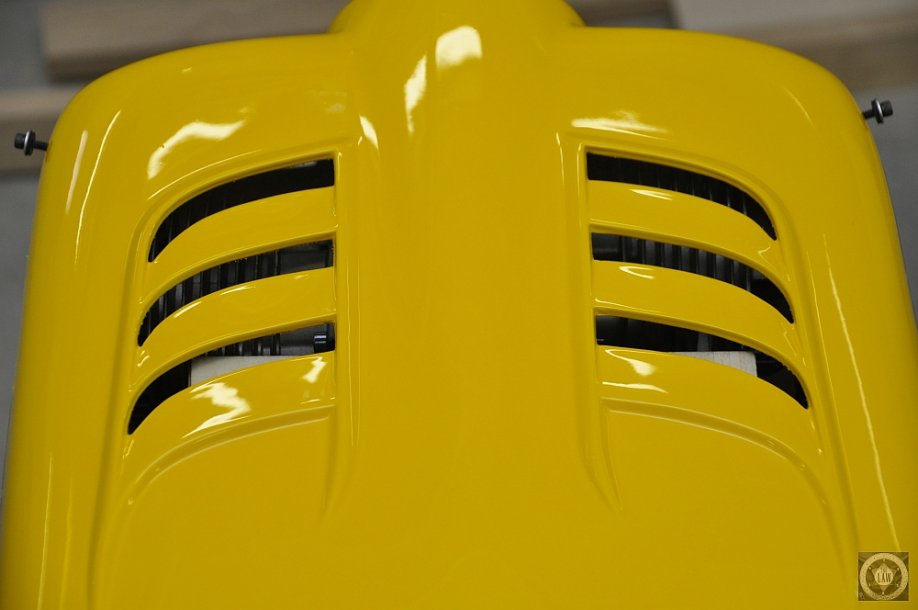

I've been away for a while...Wow! The Viper is too cool for words. Awesome colors. My favorite part is the vented cowl. Bad to the bone! I would love to have one someday. It's as sexy as a Formula 1 racer. Like ryan_m...I'm at the 50cc limit. I'm still working on getting the hardware for my 50cc Redwing Extra. Congratulations Terry and Herve...good luck keeping this one in stock.

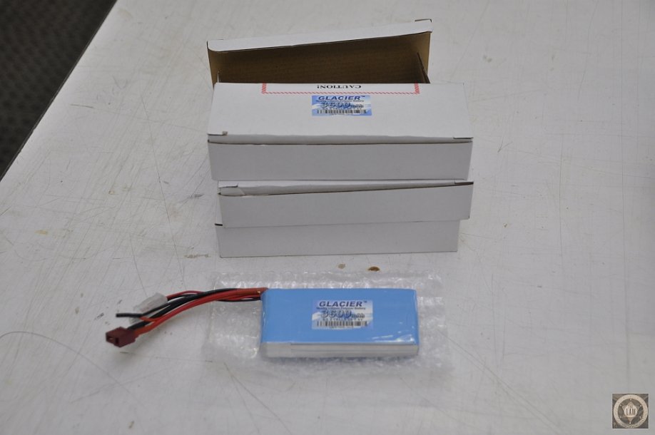

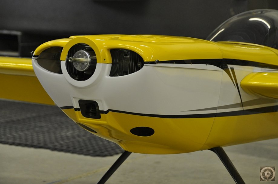

Let's get down to business. Here are some of the goodies that I'm putting in today:
- Got my 3600mah Glacier packs, very highly rated and recommended. Next choice was Pulse, may have to get a couple of those as well.

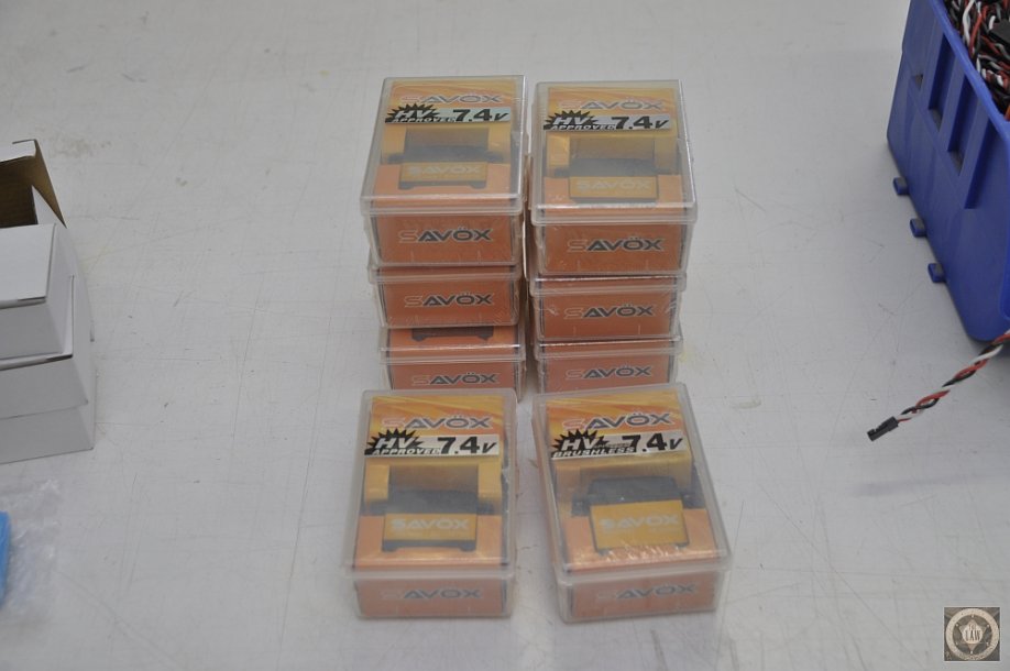

- Savox Servos. 1270's on all surfaces, 2230 on rudder and 1267 on throttle.

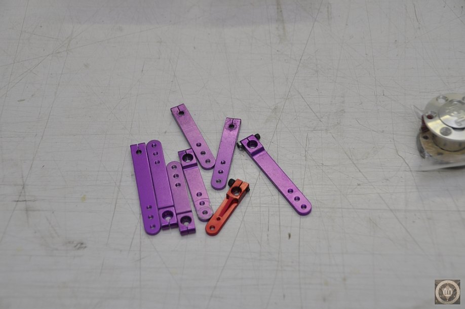

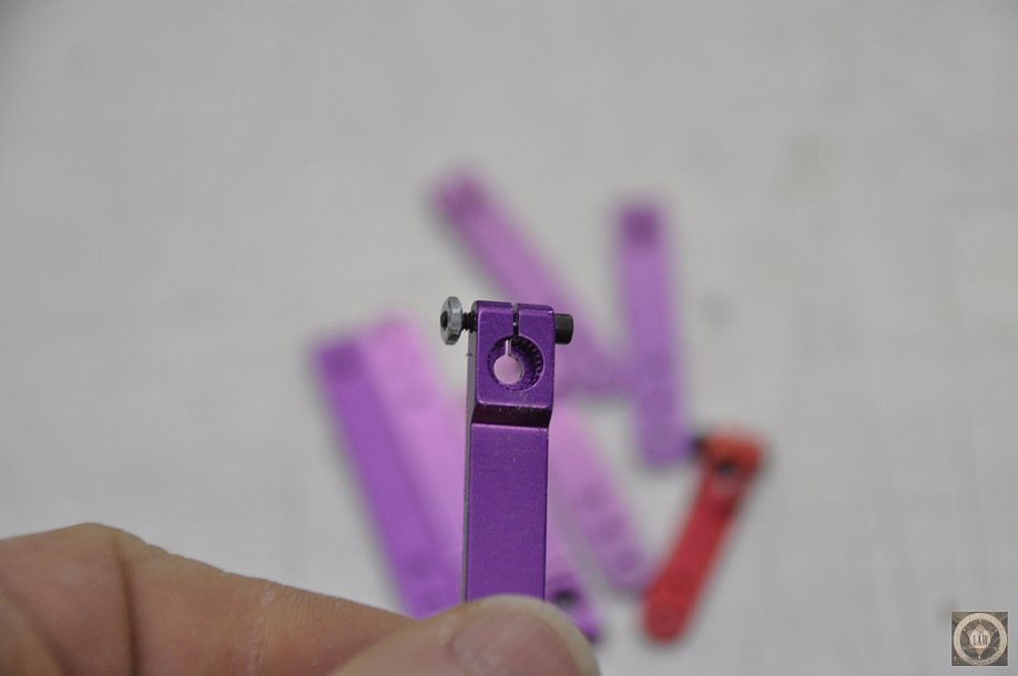

- Servo arms from @Taildraggerrc which have been really great. This is the third plane this set will be on and the only thing I have had happen is the M1 screws heads poped off on most of them. I drilled them out and use a 2-56 with a nut and threadlock, no more issues.

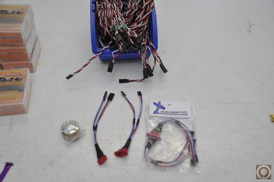

- Heavy duty extensions, flange mount aileron multi-connector from Taildragger and a DA fuel dot that I have on hand.

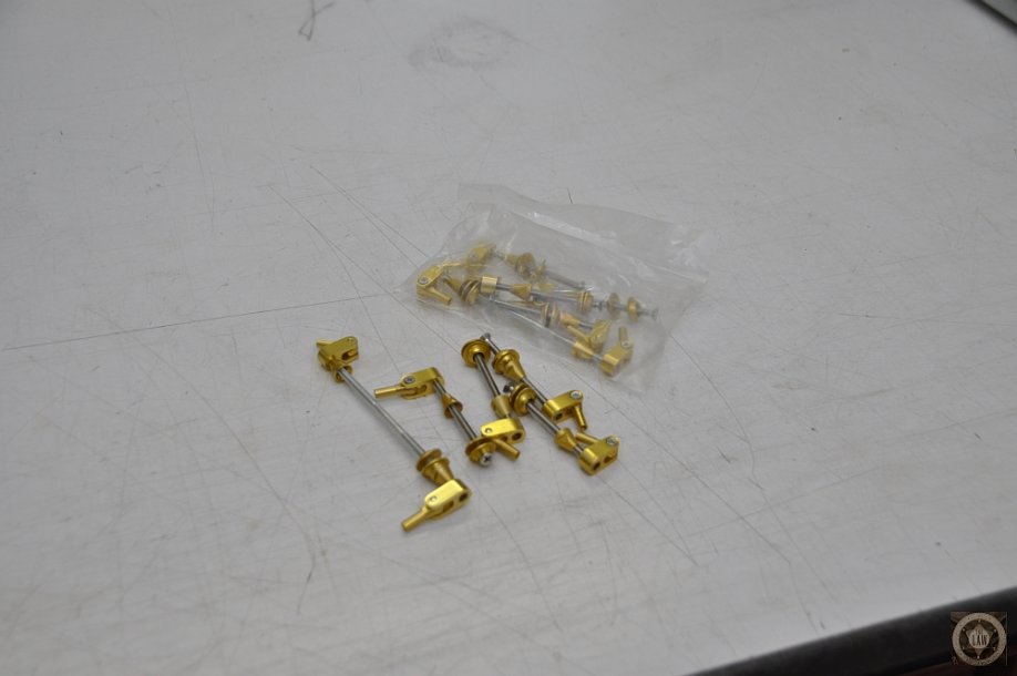

- PAU kits include the adjustable hardware and control rod links, since this is a prototype I am making all my own links to determine the correct lengths for the kits. I do this with 4-40 threaded rod sleeved with carbon fiber, really works well as long as you put some glue so that the carbon fiber is not loose on the threads. I use thick CA for this.
