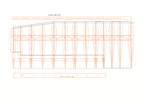

Bottom wing modified with straight spar.

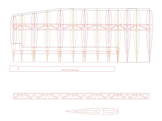

This morning I had a new idea and modified a few things on the wings to make building a bit easier. Here is the final design on top and bottom wings.
