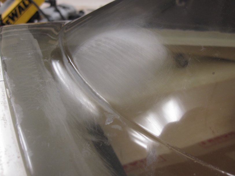

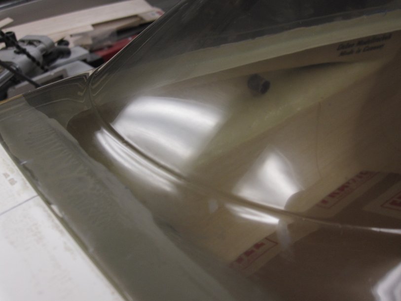

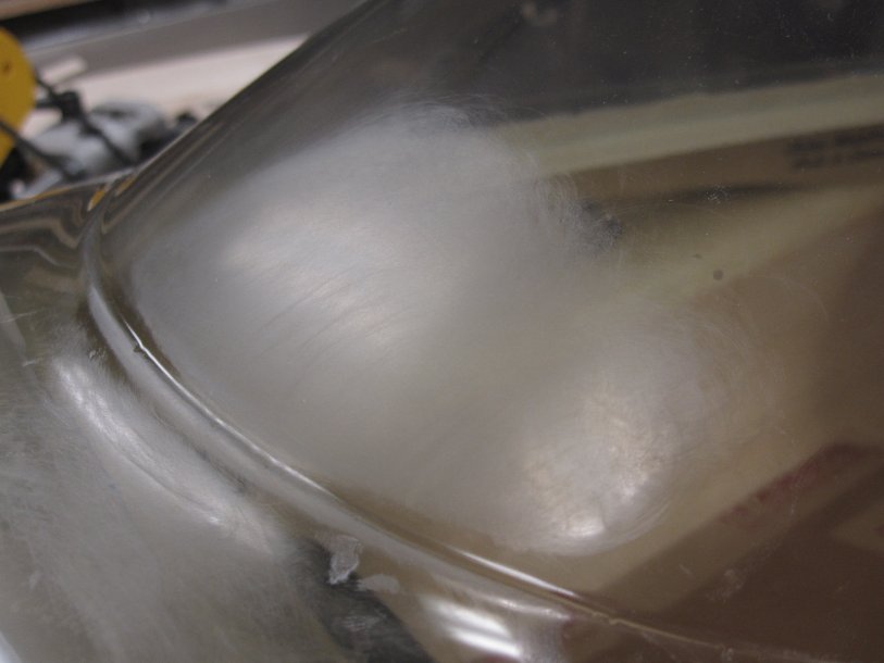

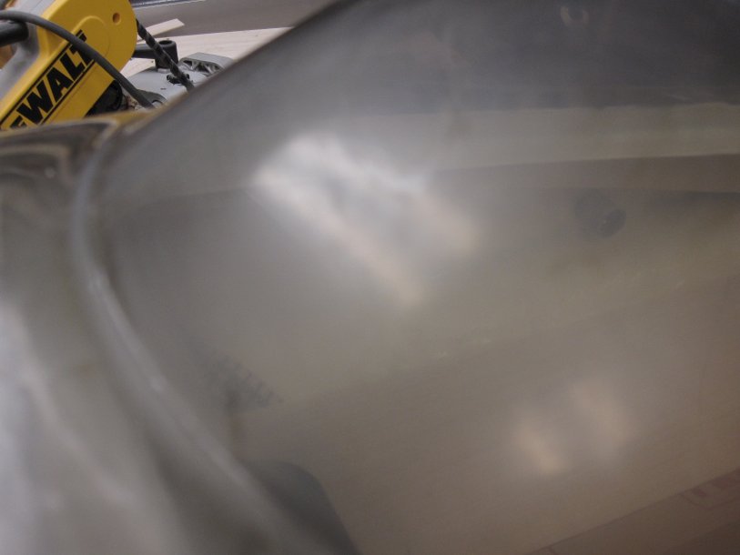

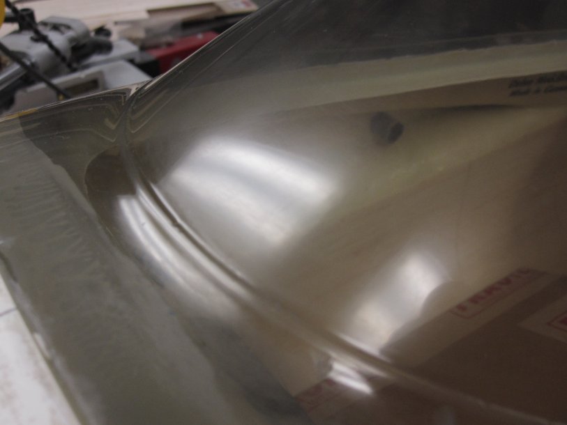

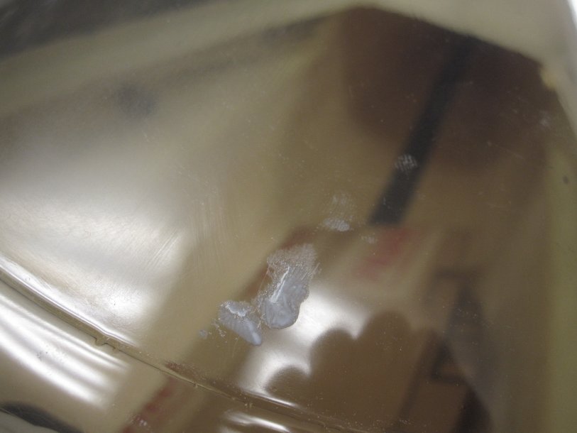

    Here's a little progress of the repair process...
    Original Hysol on the canopy
    After 800 grit sandpaper to remove the epoxy
    after 1200 grit
    After 2000 grit
    After the coarse plastic polish
    Final results after final plastic polish
    It looks better in real life and there are still a few micro-scratches in places that will no doubt be easy to remove...I'm waiting until I have the full canopy complete and I will give it a full polish prior to Painting to remove any fine scratched I may cause during construction...It'll be the nicest canopy I've ever had after all this!
