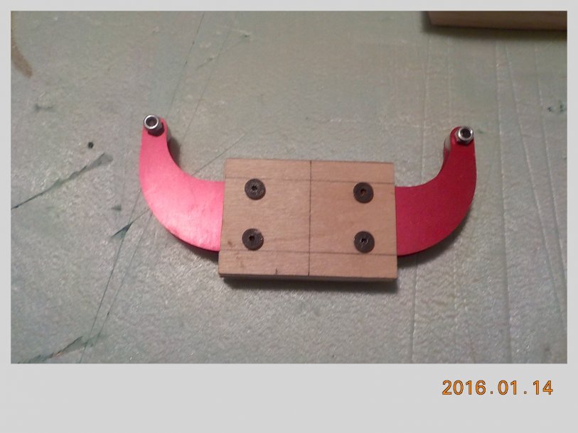

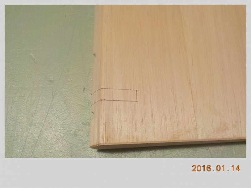

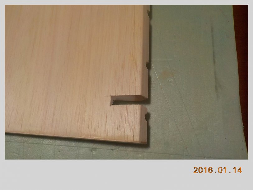

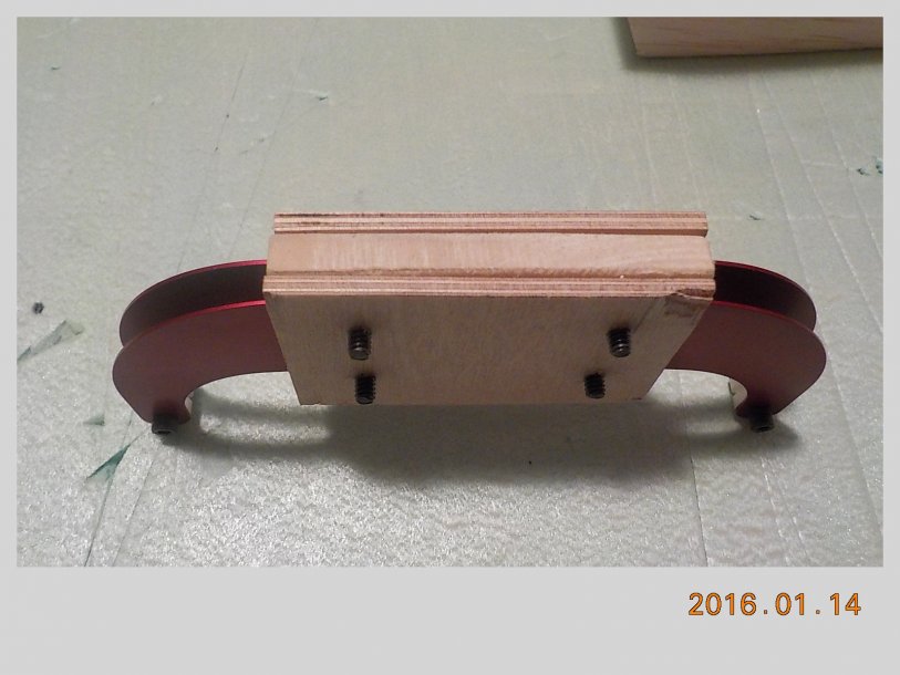

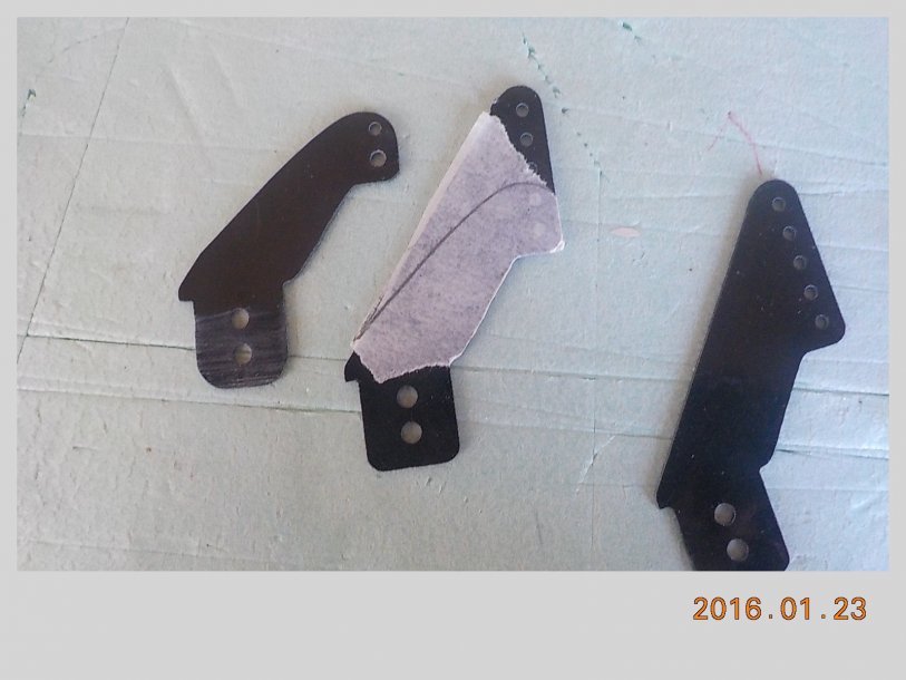

Few pictures on how I'm doing the swb servo horn.

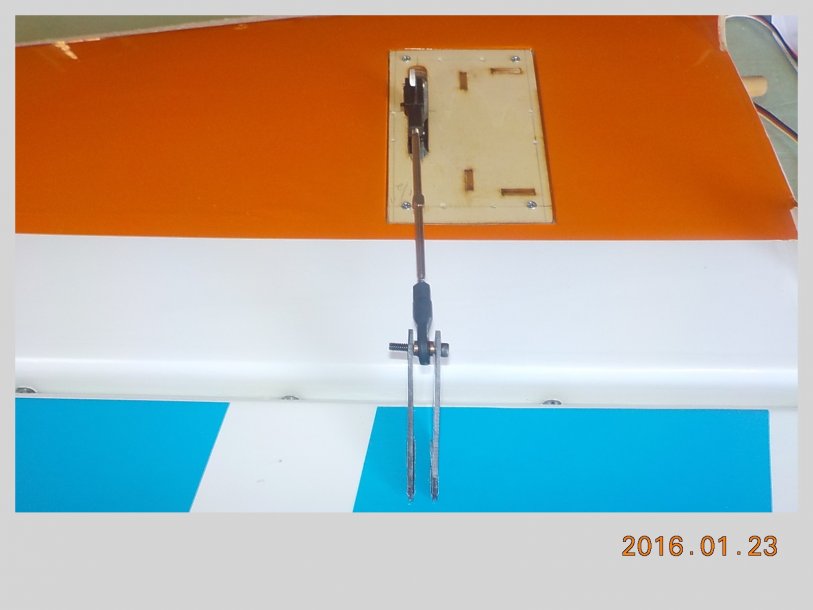

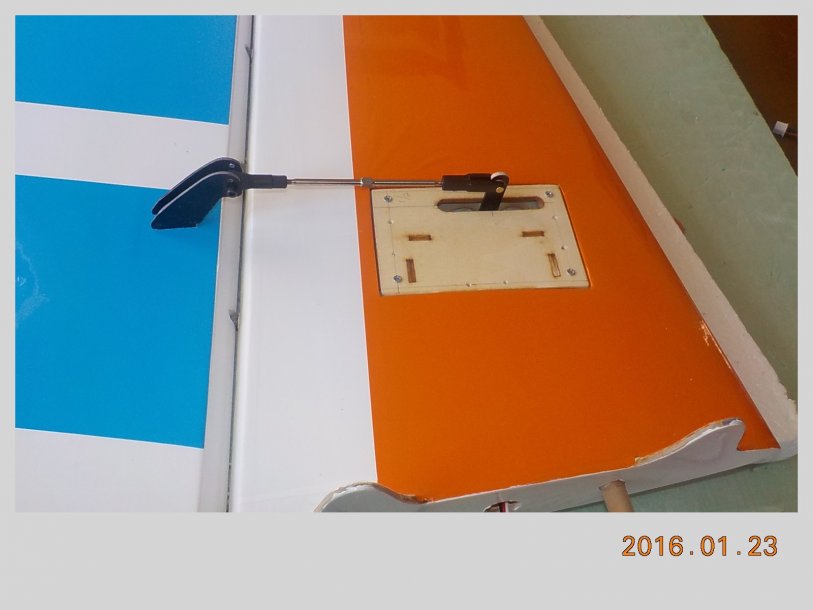

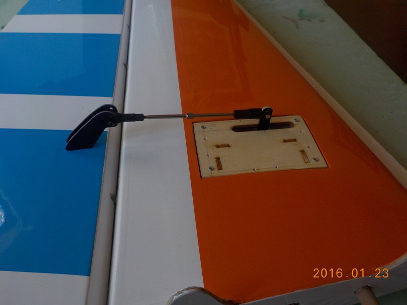

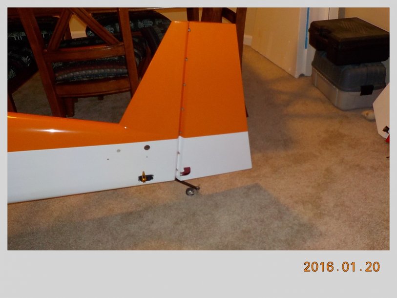

ROLLERMAN
Well I got some more work over the weekend. worked on the stabs servo installation. Turned out just as I planed, Lucky I guess. I have a one inch arm and I'm able to get over 20 degrees on throw, which is plenty for IMAC flying.
