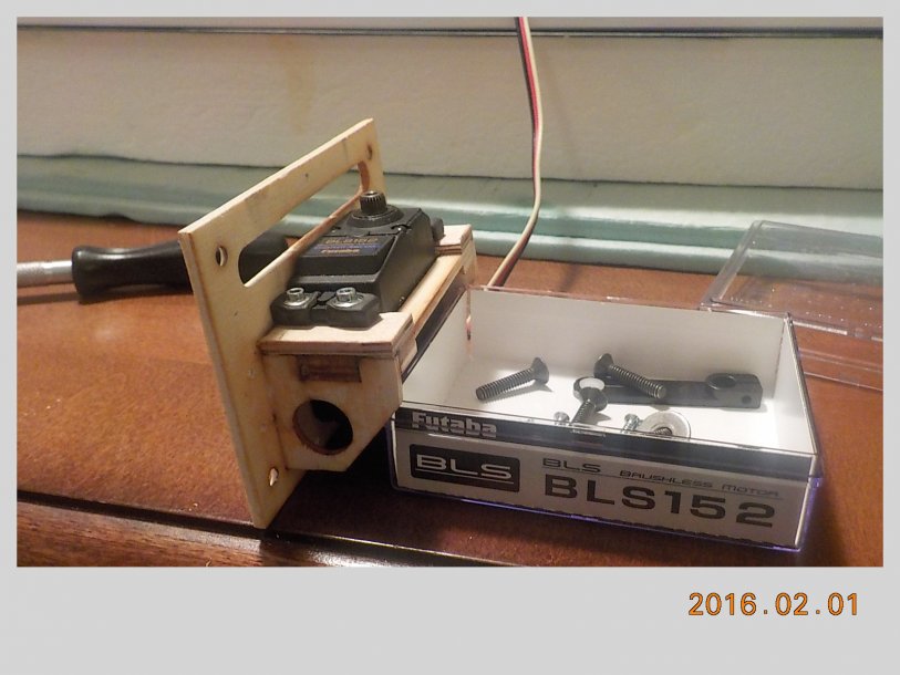

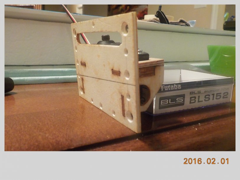

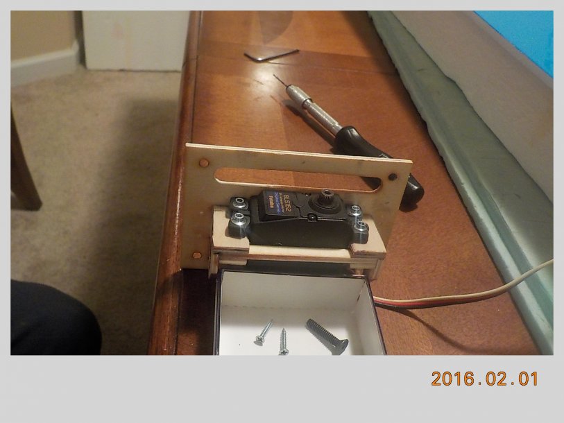

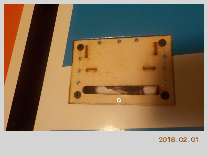

Here are some detail pictures from my aileron servo mount. The black flat heads are 6/32’s with blind nuts on the box. The wood screws are mainly to keep the plate from flexing under high loads.
