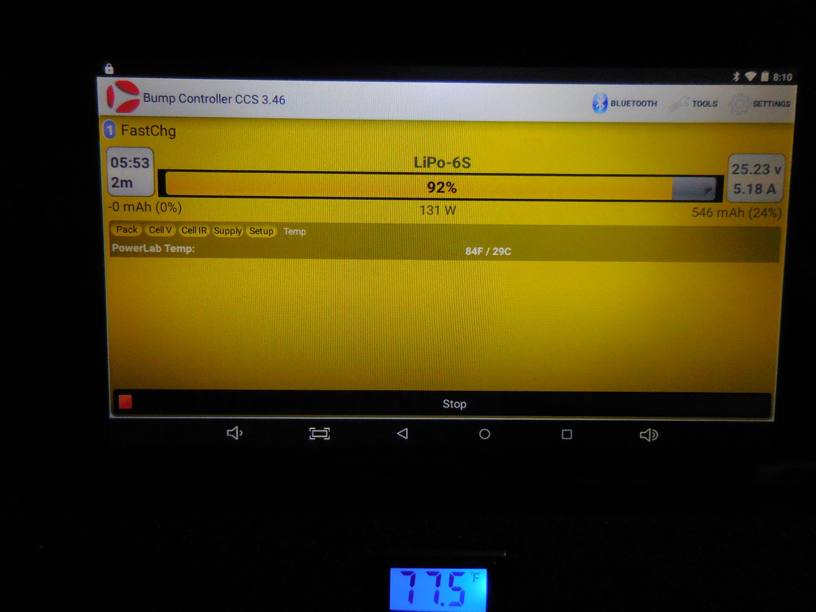

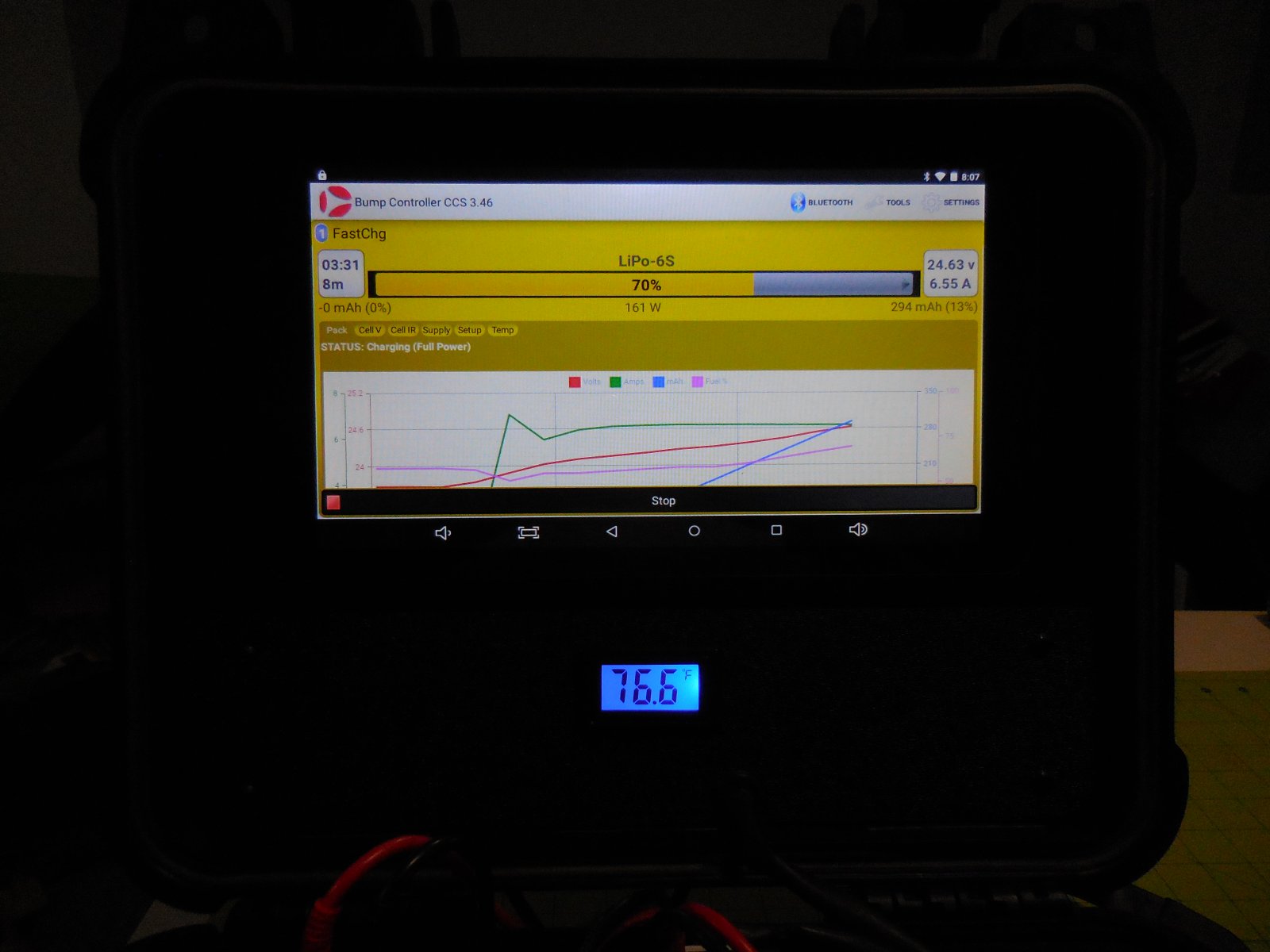

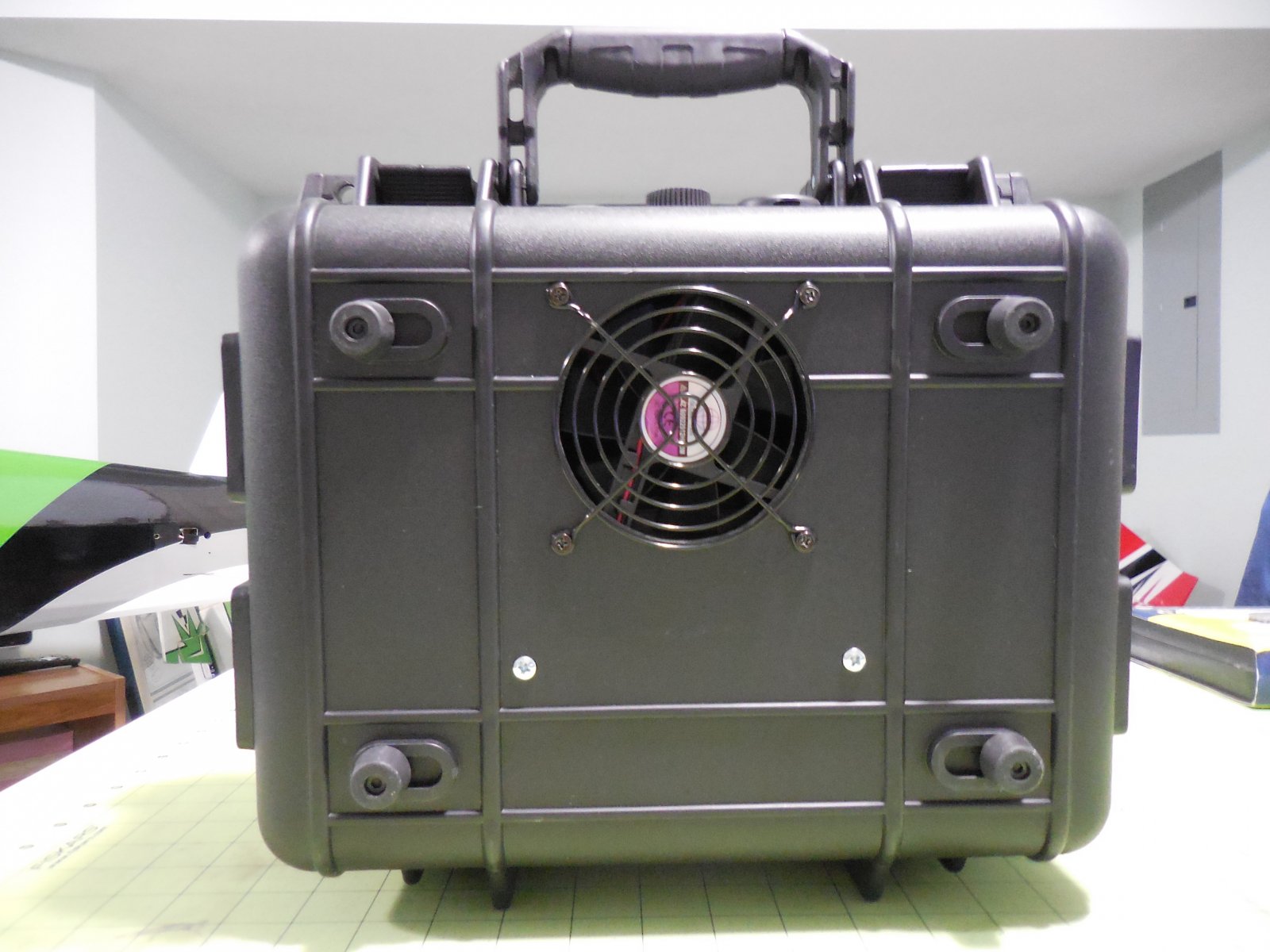

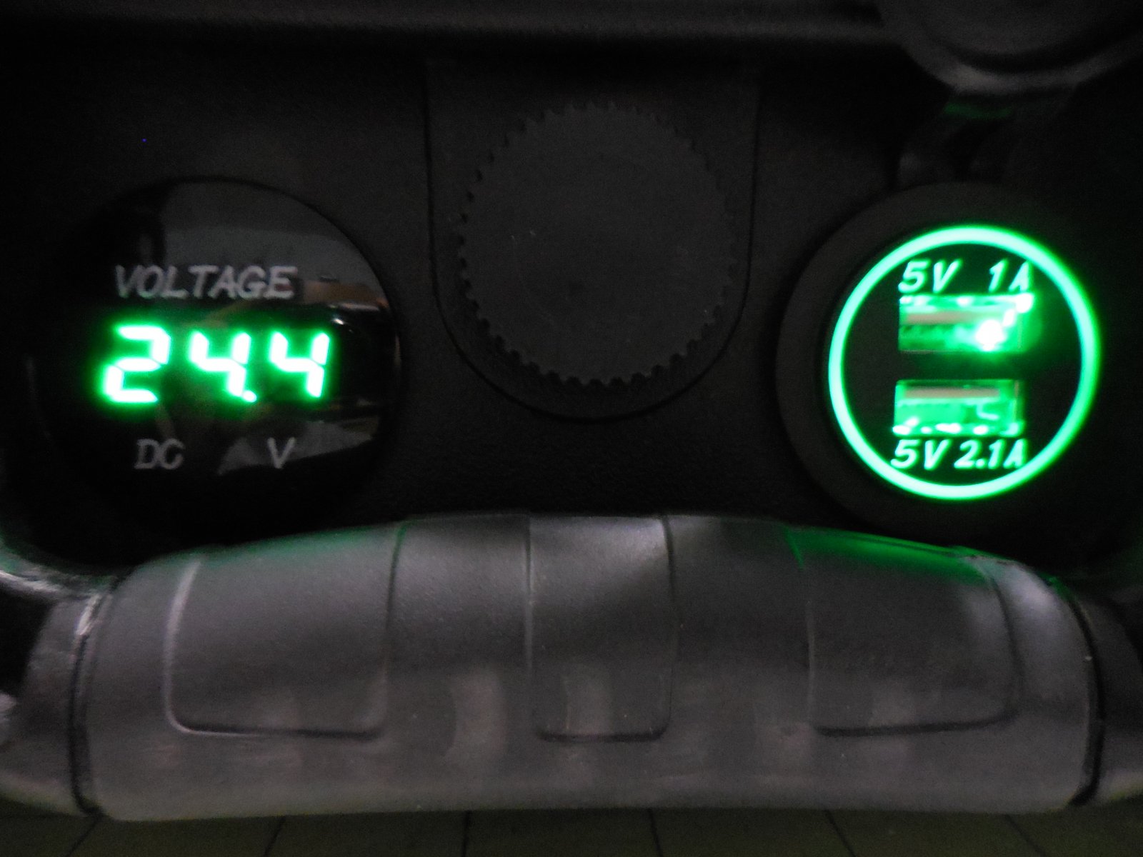

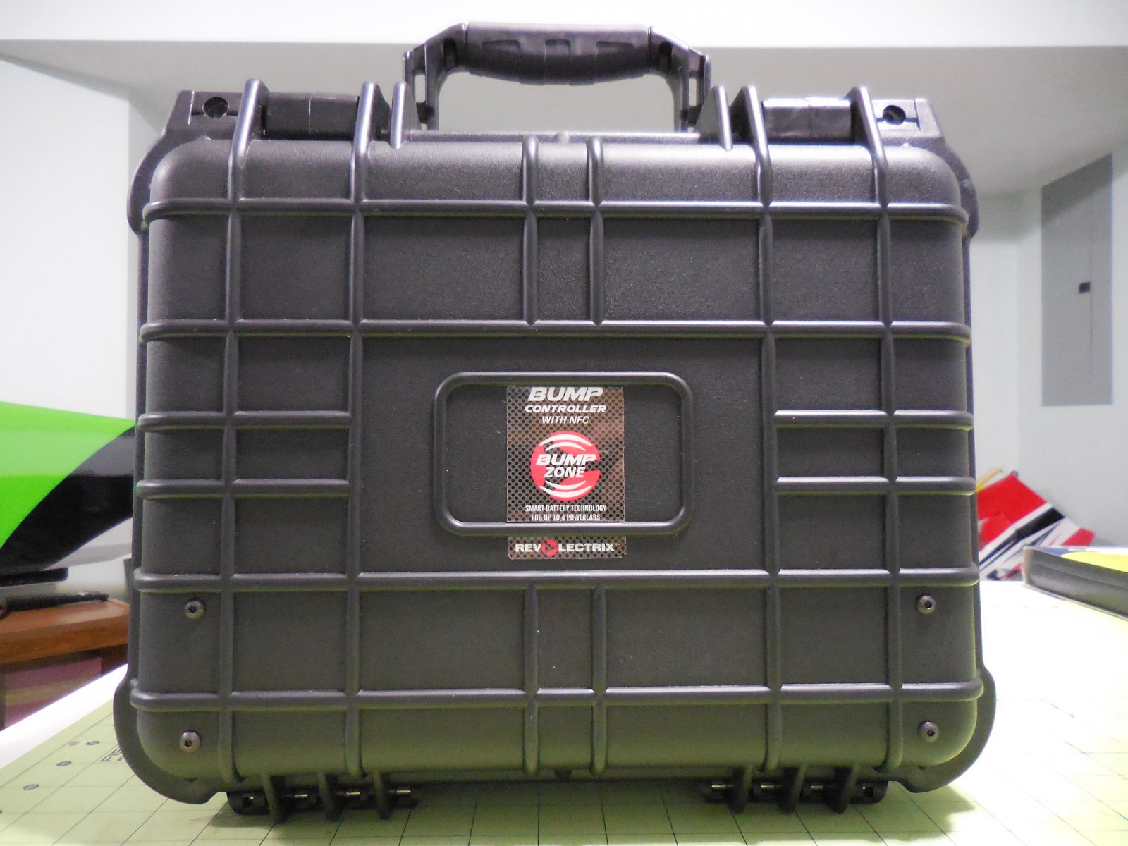

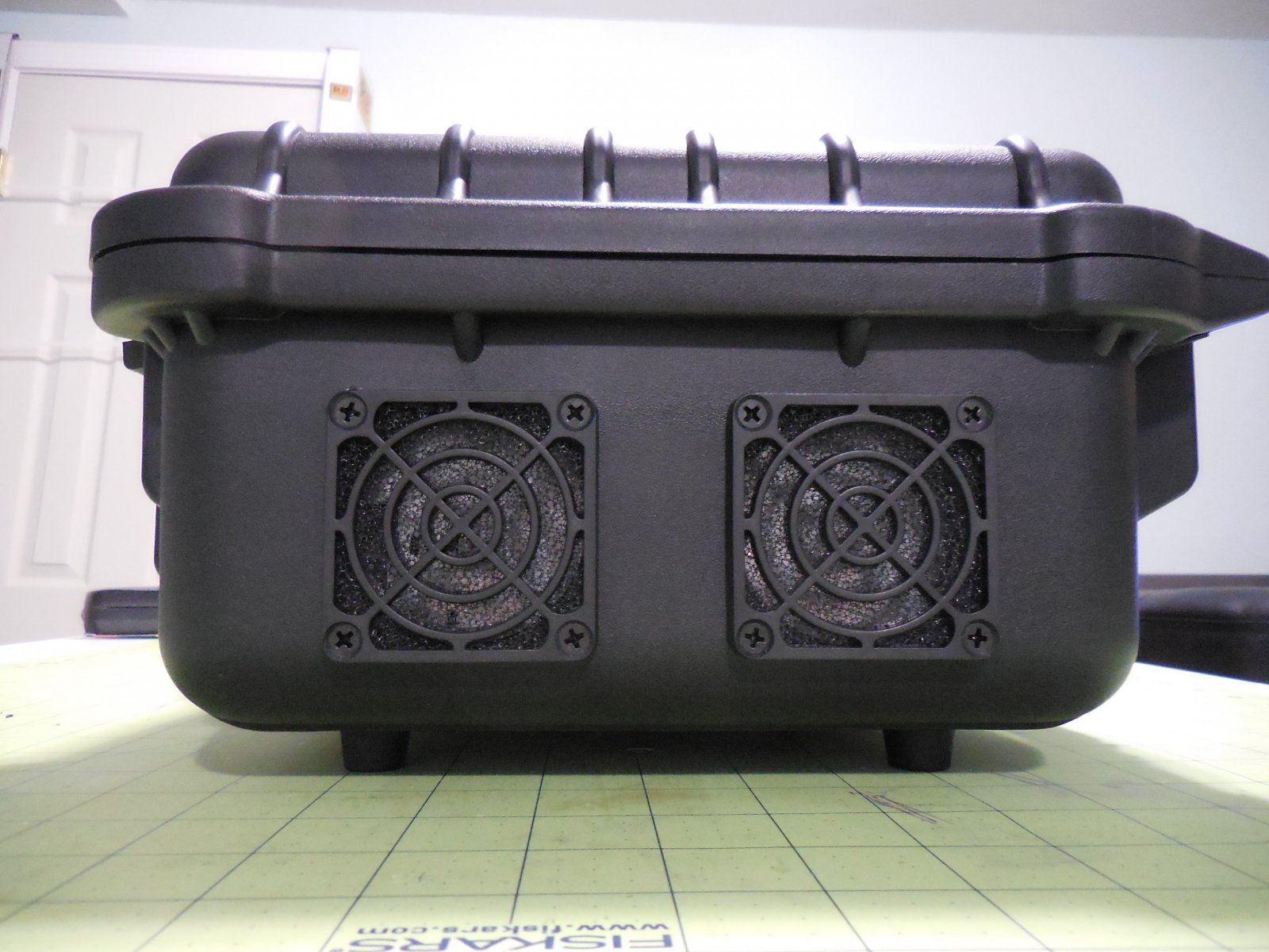

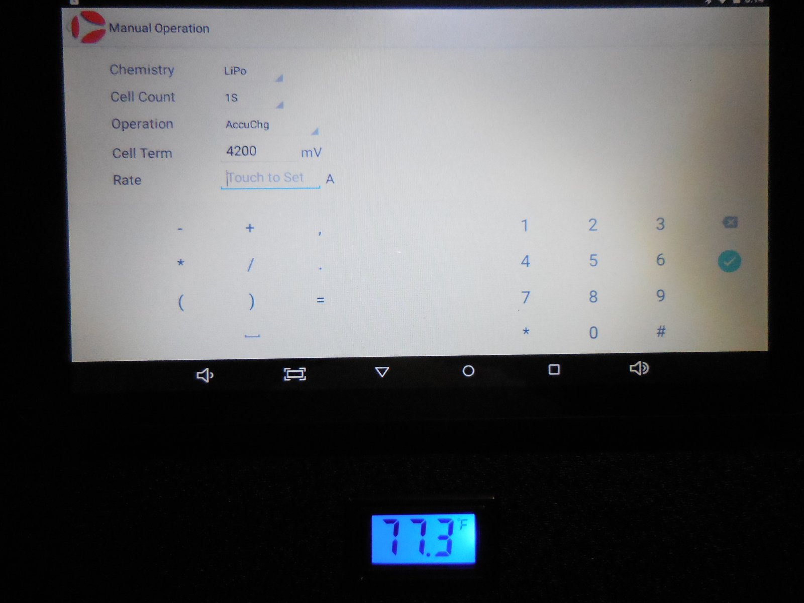

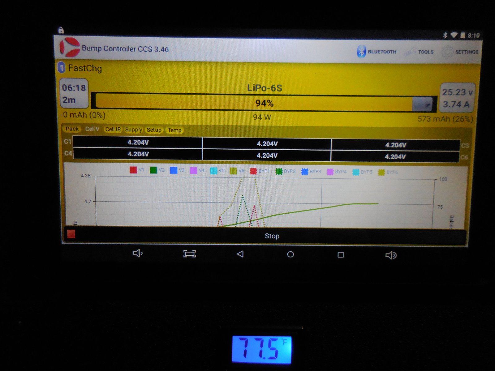

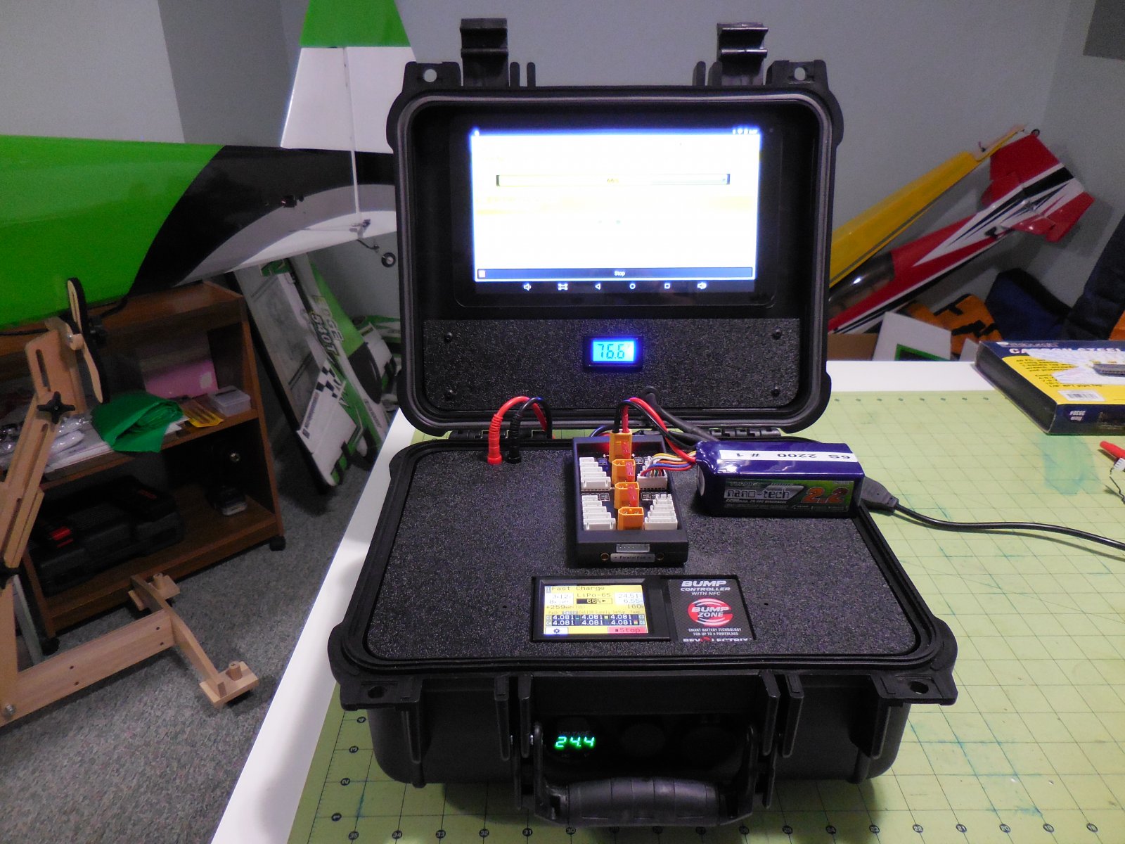

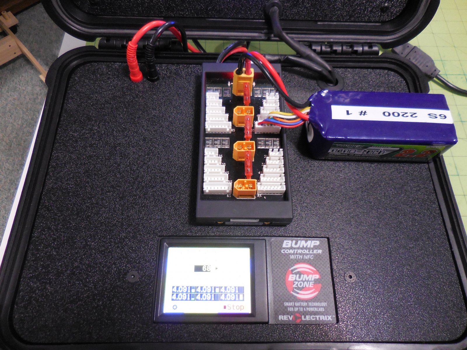

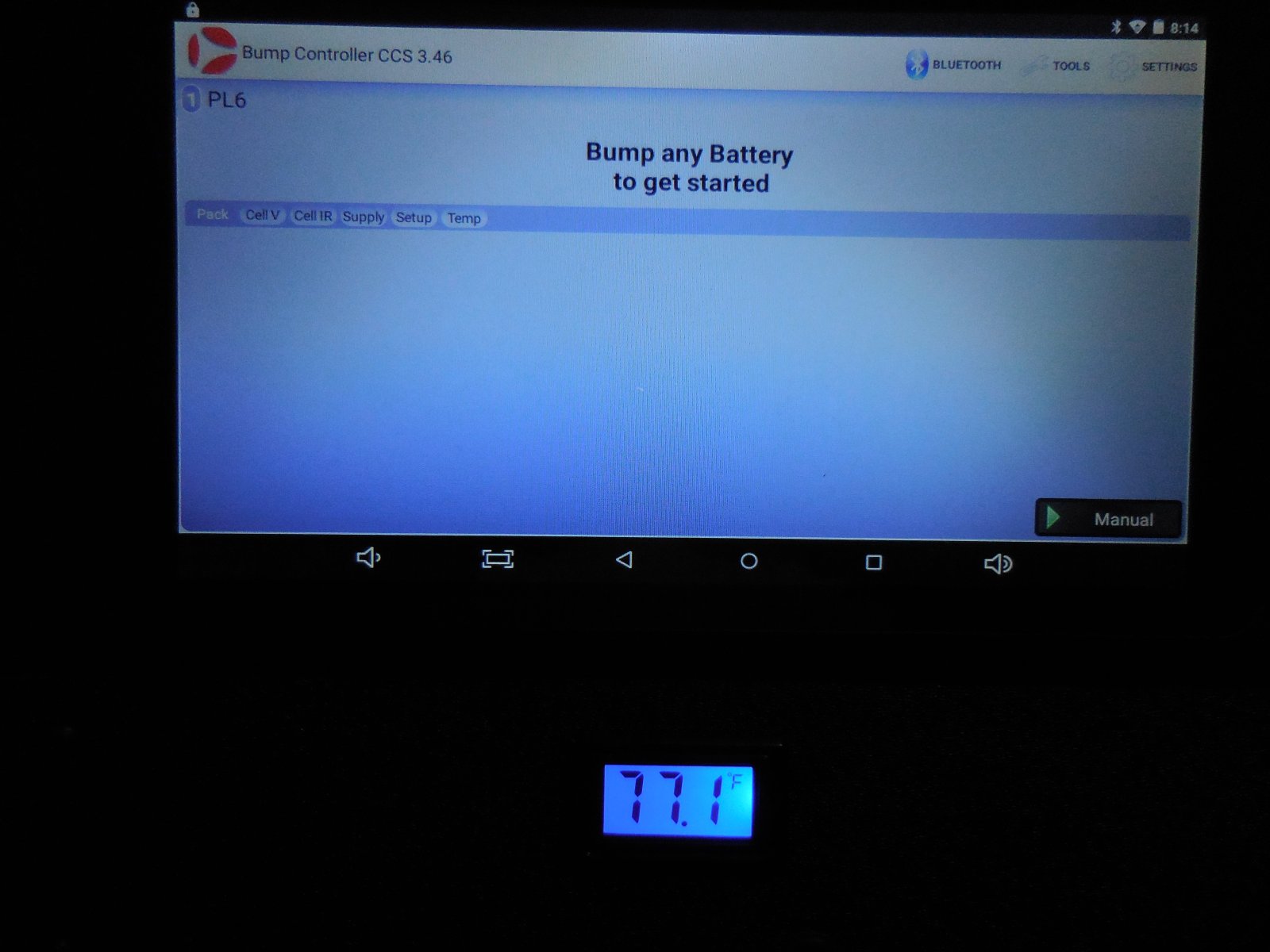

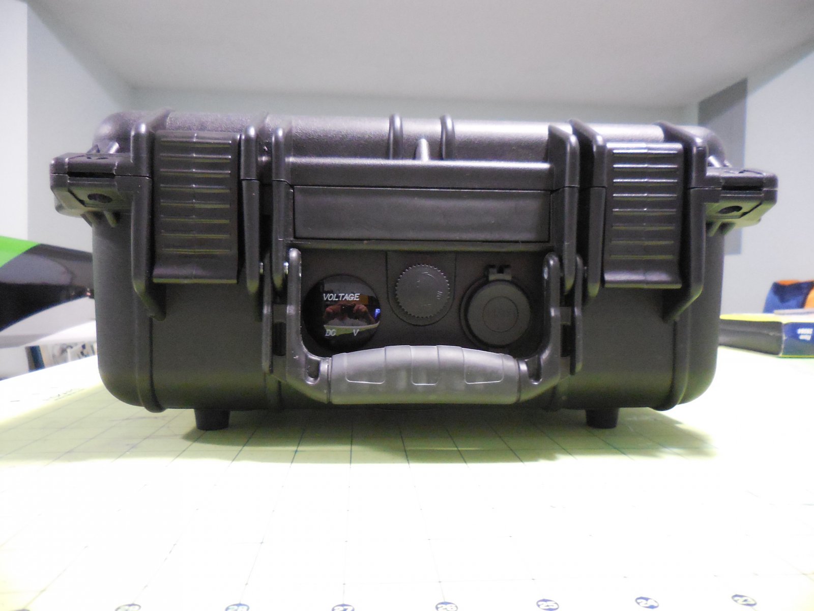

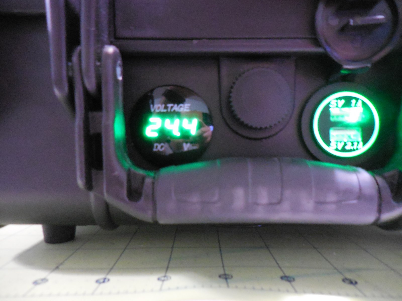

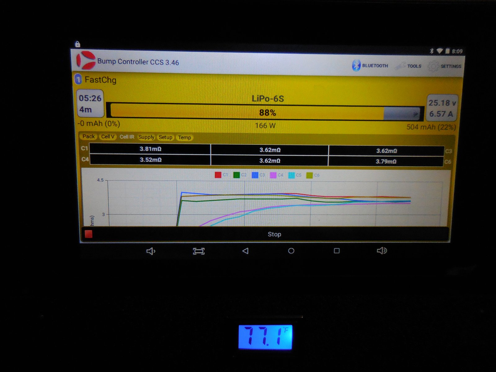

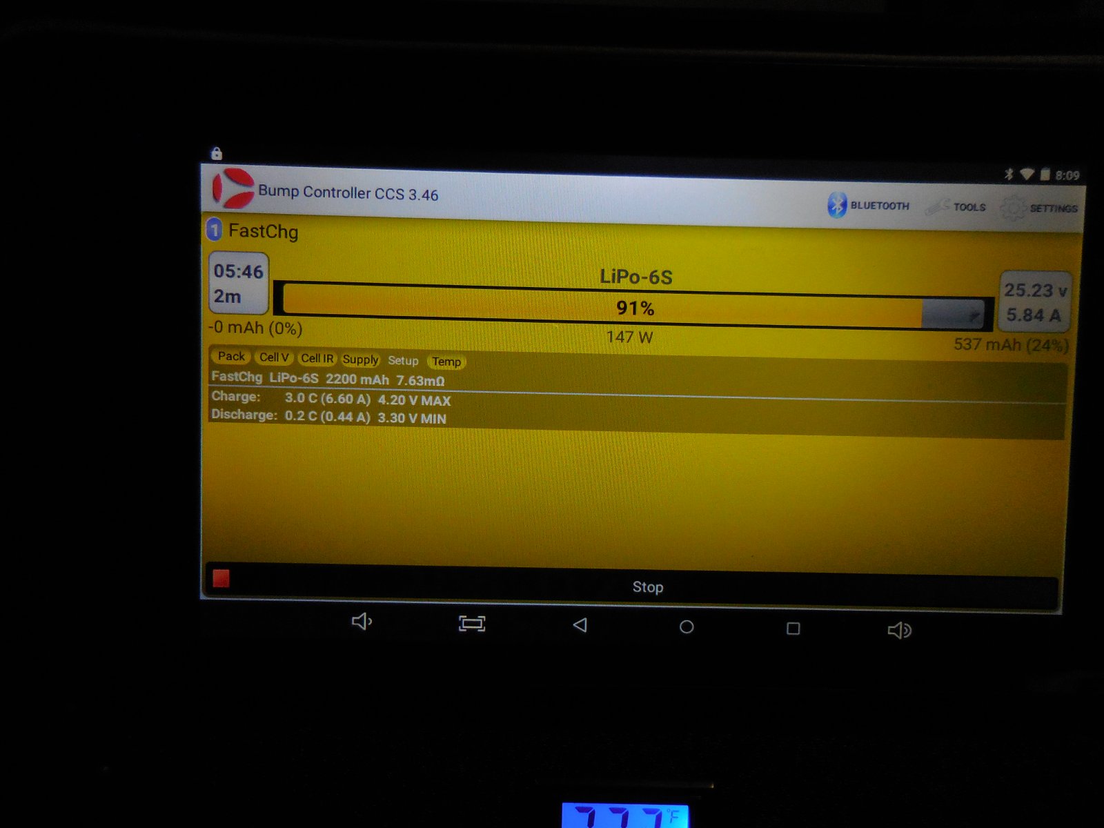

Okay - it's complete!
My new ultimate super duper compact portable charging station...
Inside:
PowerLab 6 - qty 1
Bump Controller - qty 1
Digiland DL1008M 10.1 tablet - qty 1
Digital Temperature (internal) - qty 1Plastic Deck (1/8") - qty 1
24 volt Power Supply - Two DPS-1200FB in series
80 mm Cooling Fan (exhaust) - qty 1
Wires - a hole bunch of them
Various jacks, connectors, and extensions
Outside:
Digital Voltage (power supply) - qty 1
Dual USB Outputs - qty 1
Y power cable - qty 1
55 mm filtered fan grilles (intakes) - qty 4
80 mm wire fan grille exhaust - qty 1
Photos below (sorry for the poor quality)
Let me know what you think of it.

Great job brother. Mikey like! :yesss:
