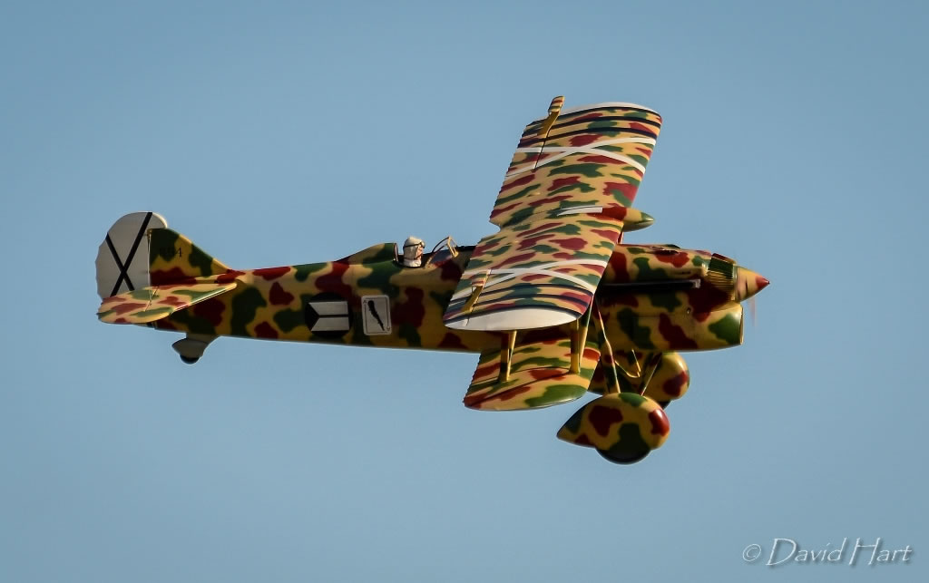

    I am sure you have more "biplane" experience than I do, but I set up my Fiat with the upper wing having more incidence than the lower. From what I read the main reason this is done is because when the airplane stalls the upper wing stalls first, and this moves the center of lift further back because the lower wing is now lifting (this only works if the upper wing is in front of the lower wing!) Now with just the lower wing lifting the center of lift is further aft of the CG which helps to cause a nose down pitch for stall recovery.
    The Fiat is my only attempt at a biplane design from scratch, and it seems to fly pretty good so I think I got things right?
    Thats the cool thing about this silly hobby, there are no rules! Go with what works for you.

    Doc, a lot of builders do the same, I am not one of them. I learned to fly them to the ground and typically build per full scale and a lot of full scale don't make the same adjustments. Again, my Eagle as an example, is built per full scale as in no engine offset thrust, no incidence on the wings, 1-1/2°+ on stab, per full scale plans of the aircraft. And it flies like it is on rails, lands a bit hotter than typical though, pure enjoyment.
    My Cub has, like seen in the pics posted by Larry, an adjustable tail. It is on a servo and mixed a little with throttle to aid in maintaining level flight at different speeds.

    I follow the reasoning behind positive decalage I just have had good luck with my method. Its true my Nieuport doesn't break when it stalls it just sort of settles, no wing drop tendencies, makes real pretty three pointers. It's real lightly loaded , only 32 oz per sq ft
    Doc
