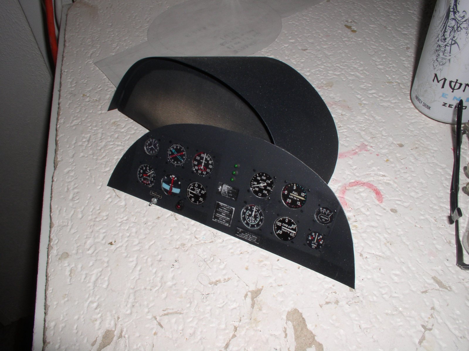

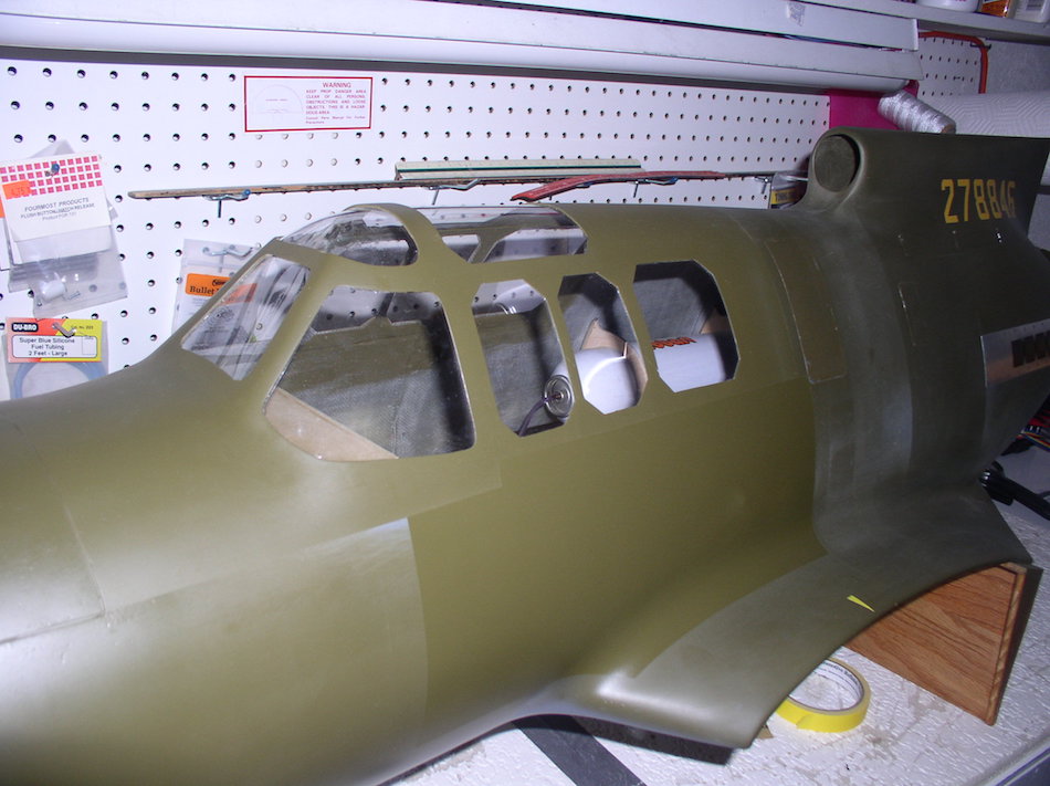

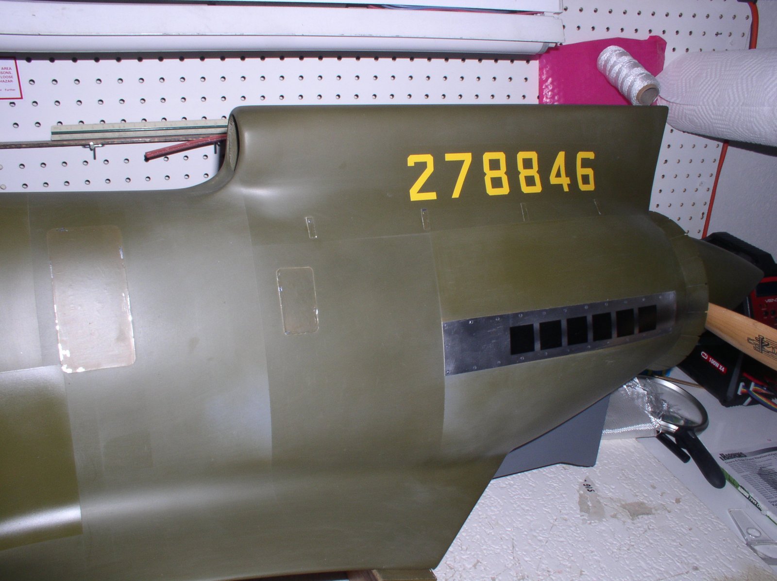

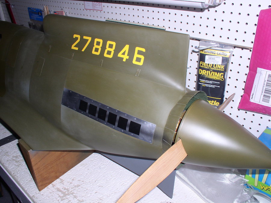

Made some more progress this weekend. Windows are all glued in place, and I did it without getting any big glue fingerprints on them! Also got the spinner painted, the serial number painted & a good start on the instrument panel. I still have to make the cut-outs for the exhaust stacks but I'm waiting until I have them all cast in resin. Still a bunch of little stuff to do but it's coming along.
