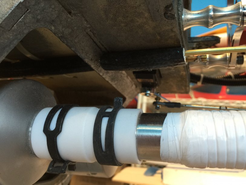

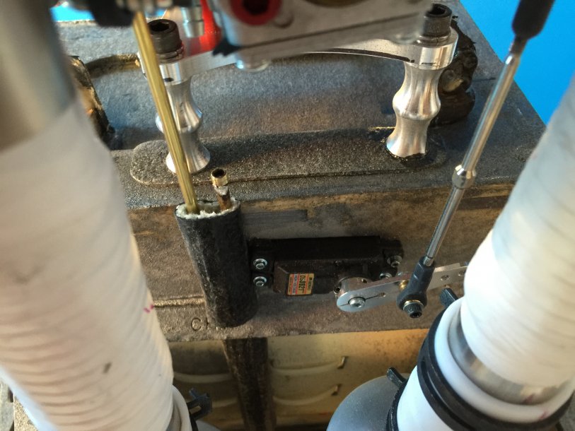

well, i do not know if you can see this in the pictures.
What i have done is installed a brass tube from the engine compartment that travels to the fuel tank bay. This results in shorter Tygon fuel lines.but, what i want you all to see is this covering i installed around the brass tubes. this is a thermal heat sleeve. 1/2" inner diameter. this is stable up to 500 degrees F.
hopefully this will help prevent the fuel lines from getting too hot. you can get them from JEGS.View attachment 6585 View attachment 6586 View attachment 6587
