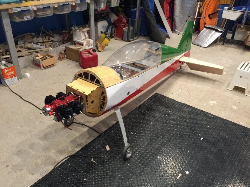

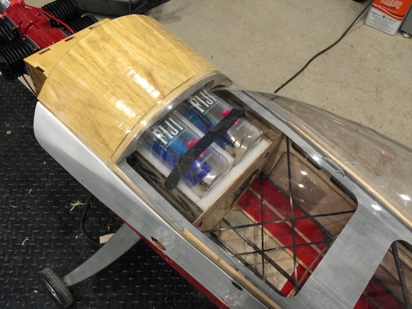

The fuel tank is installed, as well as the da 200 L.

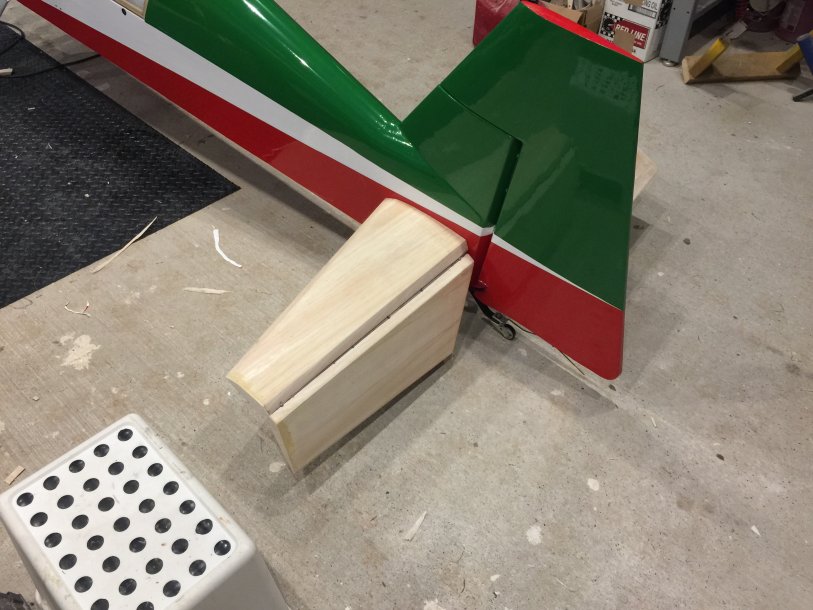

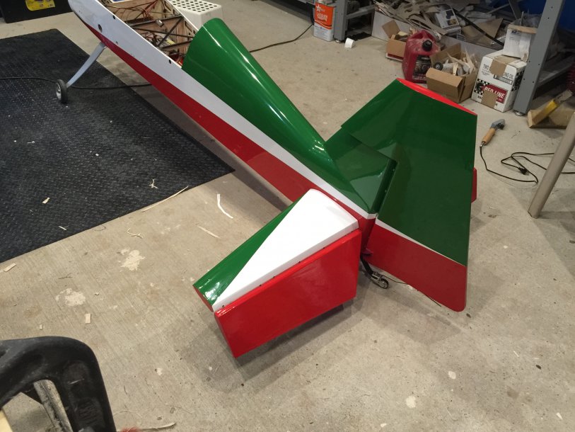

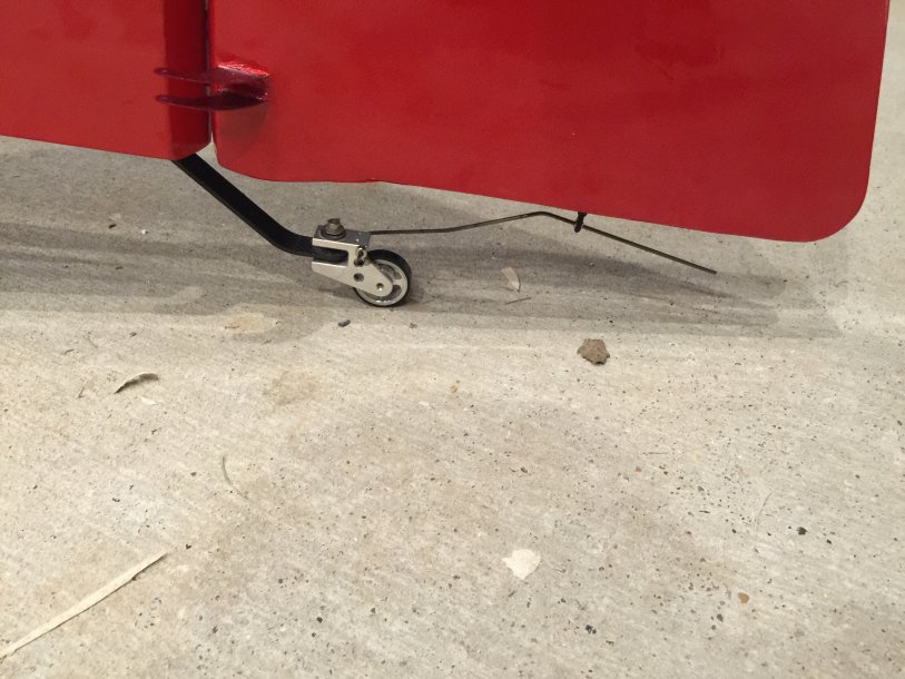

Just installed the tail wheel, and I have glued the rudder on to the hinges. This is a White Rose Tail wheel.
Cam, it looks to me like this plane needs the extra large carbon fiber spring. It will raise the tail an additional two inches off the ground.

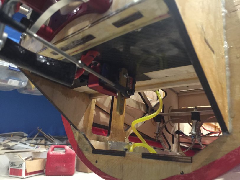

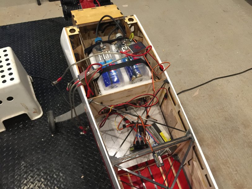

I installed the fuel tanks and started to work on the electronics. The Receivers have been bound to the Tx, and the electronic switch has also been programmed.

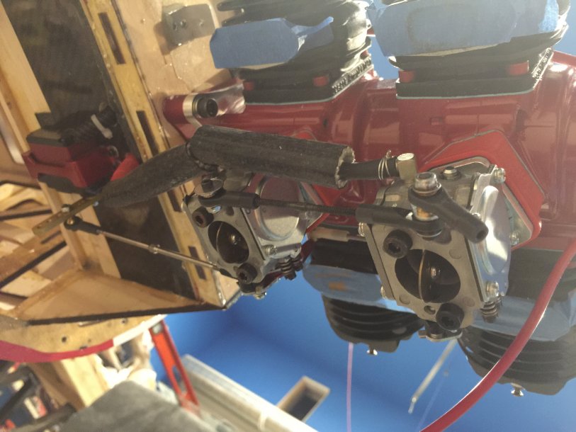

the throttle servo has been installed and programmed and all other good stuff to go with that step.
The servo is programmed so that at full up stick, meaning, WOT, the actual carb opening does not open 100% of the carb arm, maybe it opens 95%. I did this intentionally, so that, during flight, there is no binding.

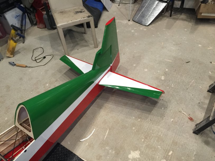

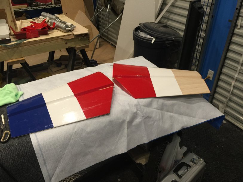

The Stabs are covered now!! next, is to install the rudder servos, the elevators servos, then i will work on finishing off the wings, covering them, then I will install the CDI's and the receiver tray.
