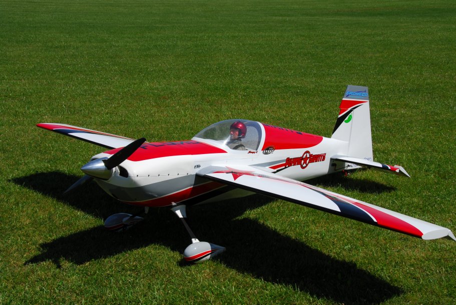

Found a pic of my old Dietrich Slick!
Excuse the foul graphix. ;)
-Rick-
Nice Sleep! Mine isn't going to look anything like that when done, and I ain't just talking about those :steamer:ty decals on yours!!
What ya have in it for motor?
