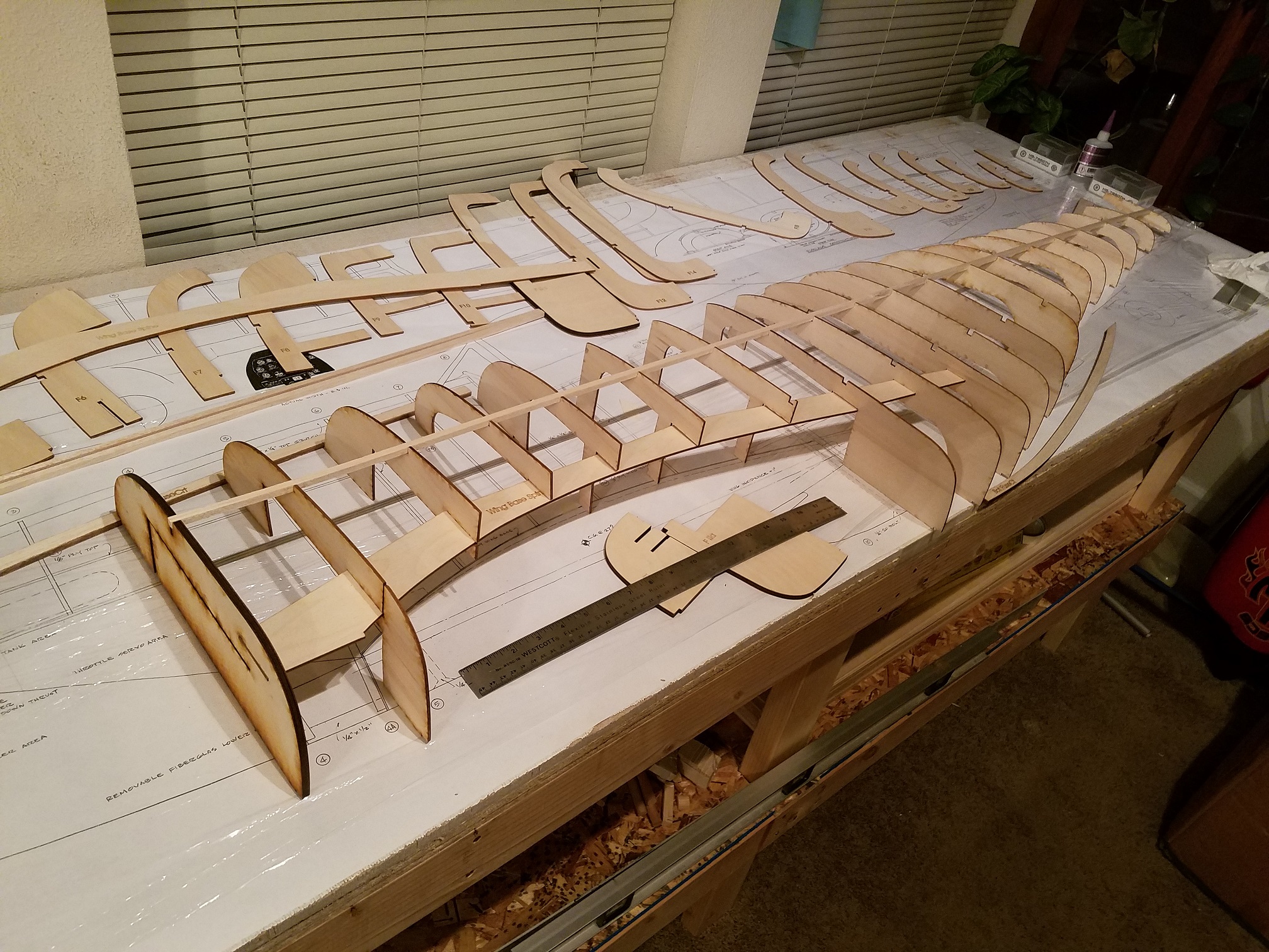

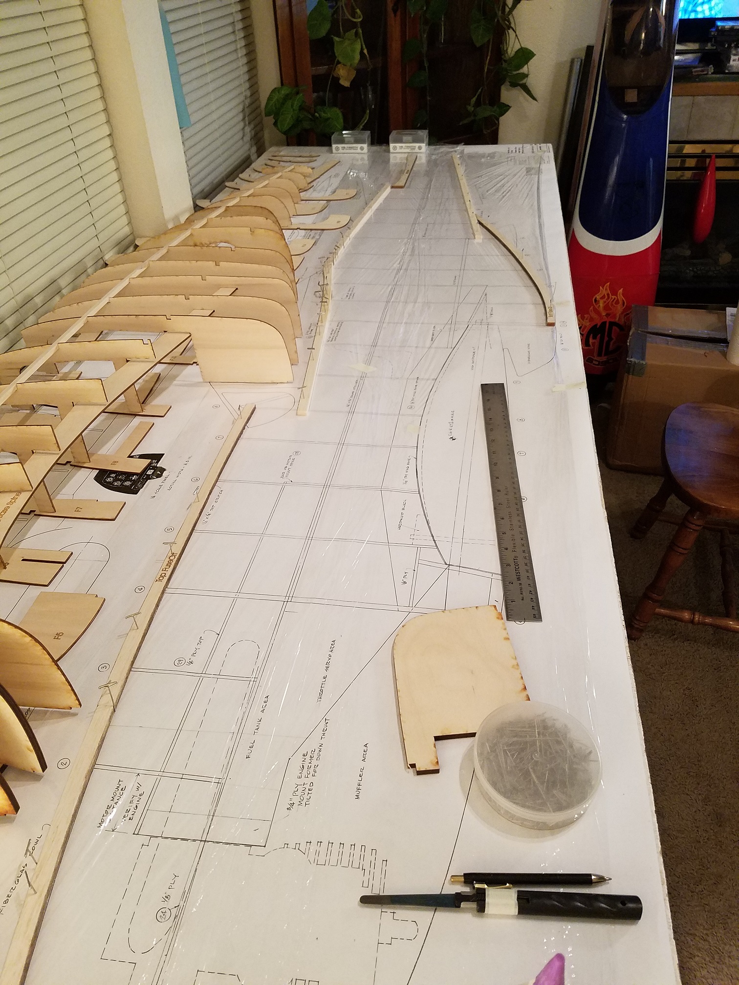

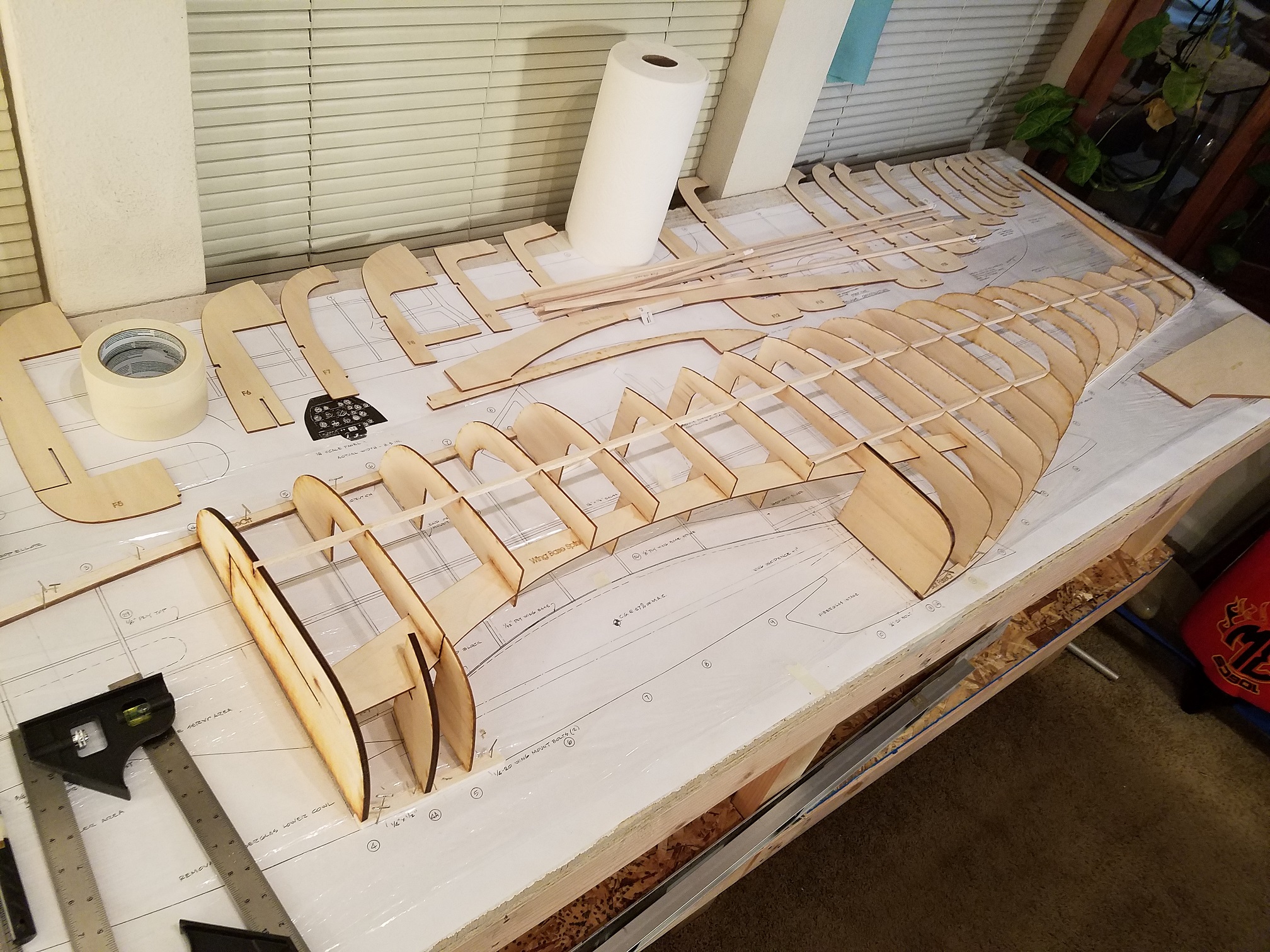

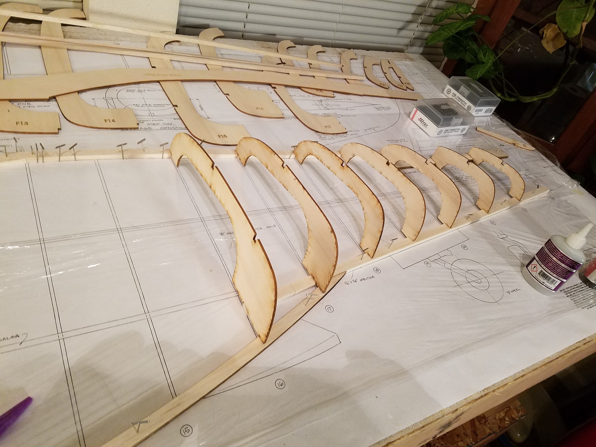

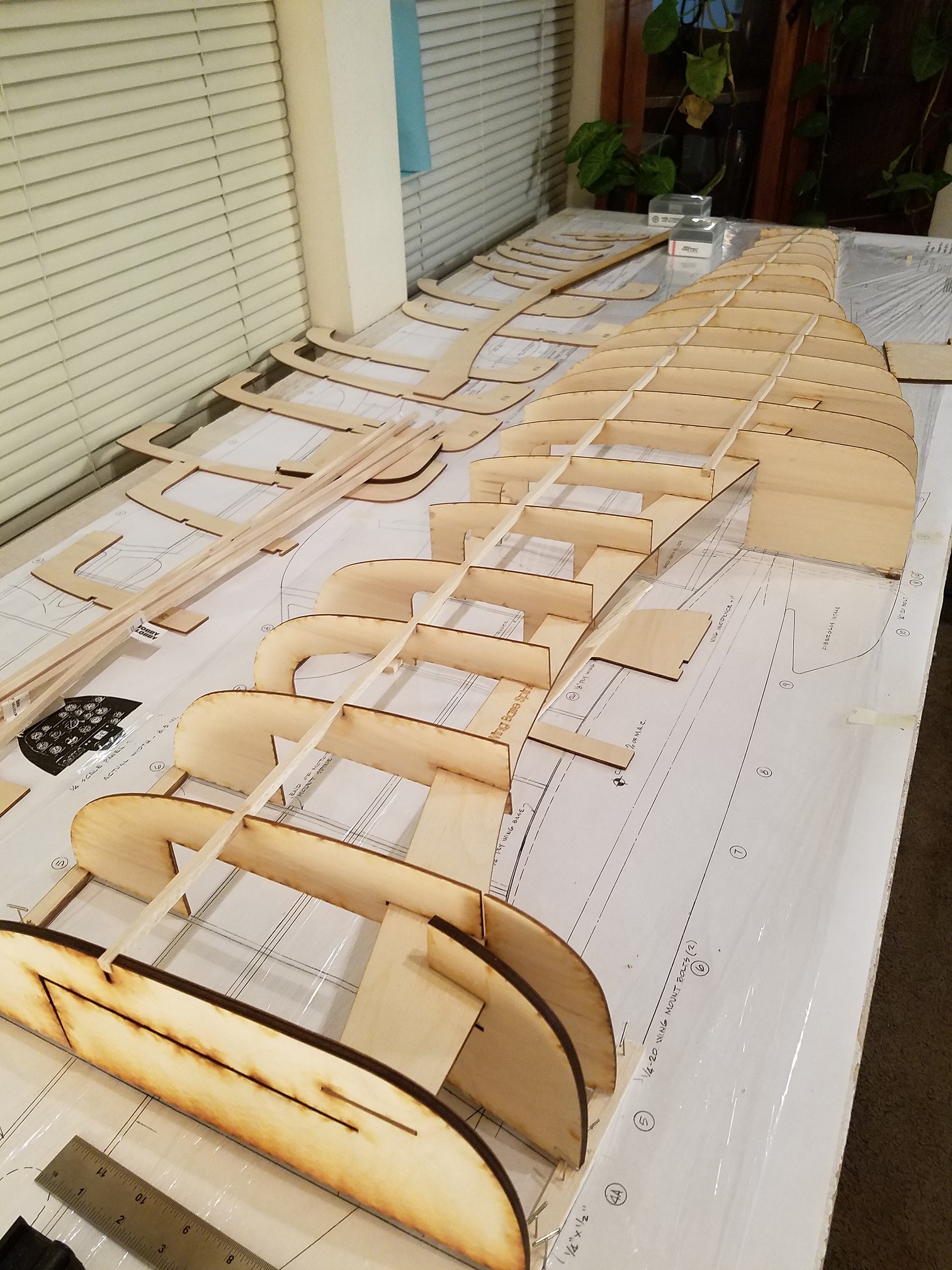

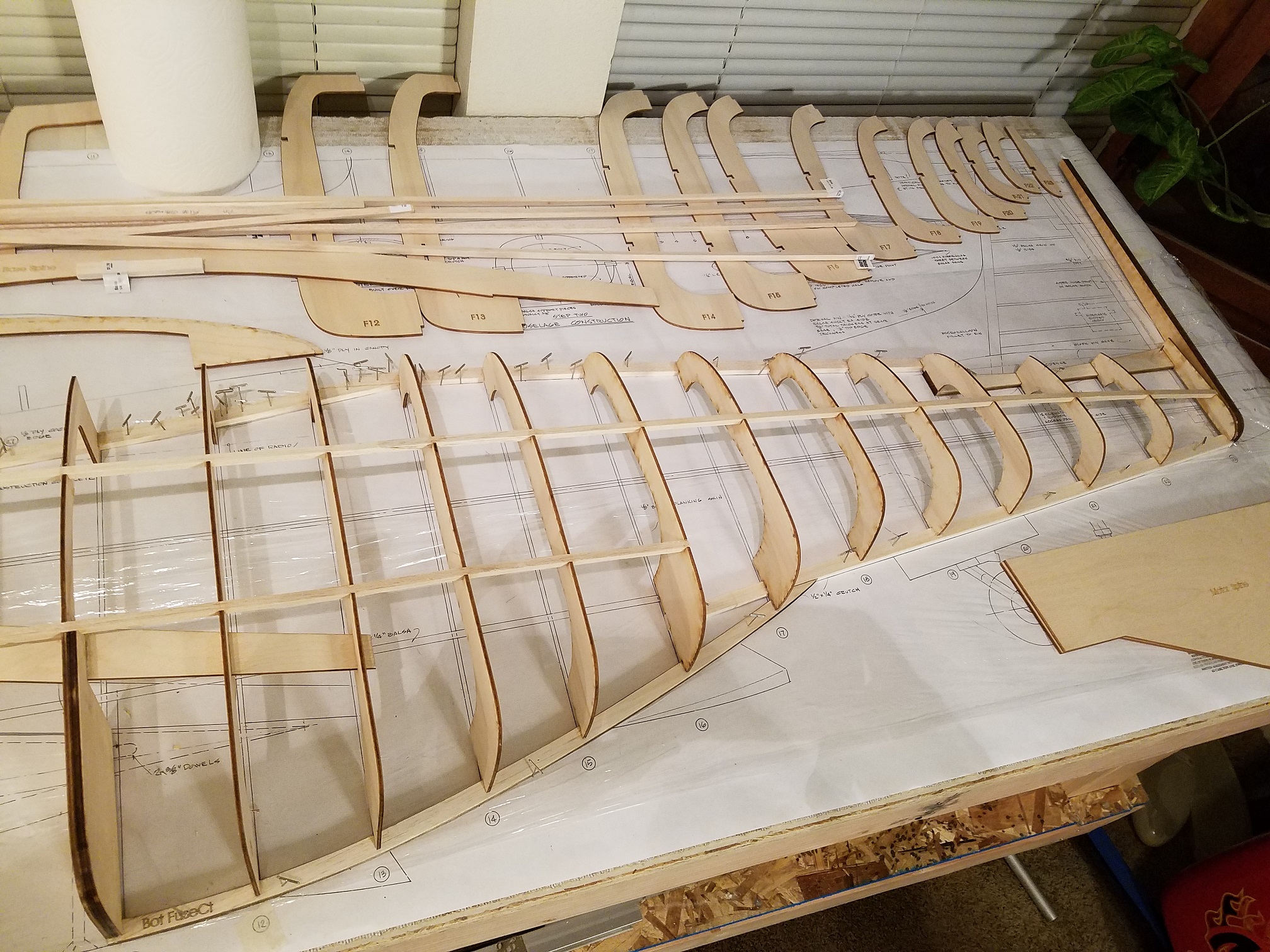

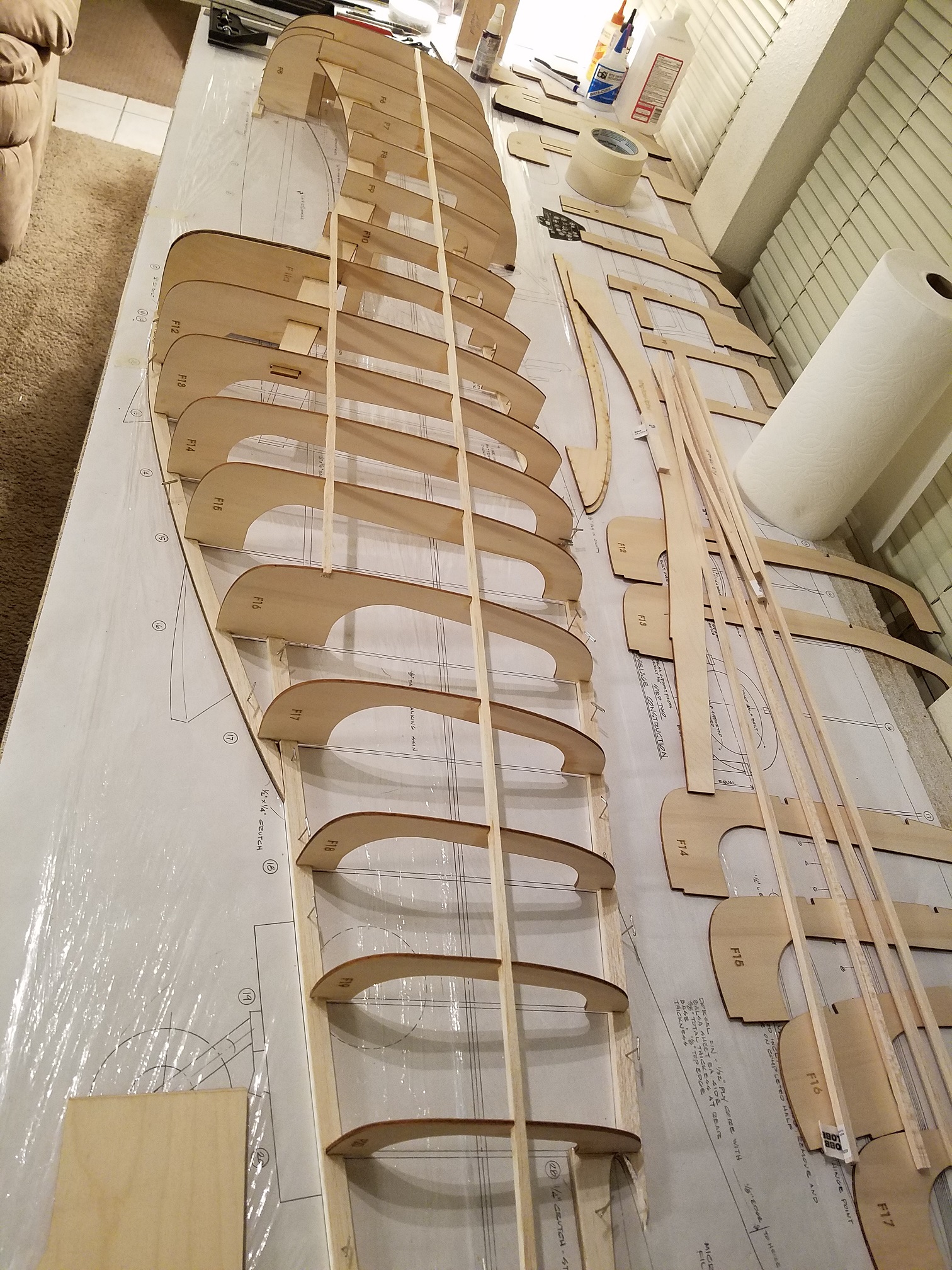

I started tinkering this evening by going through the wood and inventorying everything. As far as I could tell, it was all there. So, according to the plans, the left side is built right on "top" of the plans. I layed out the fuse and protected them with plastic wrap. I've been doing this for years and as long as a guy is cautious, the plans stay perfectly clean with no glue droplets or cut marks. I then started laying out the formers. First one, then another and before I knew it I had all 23 fuse formers layed out and basically resting in position.

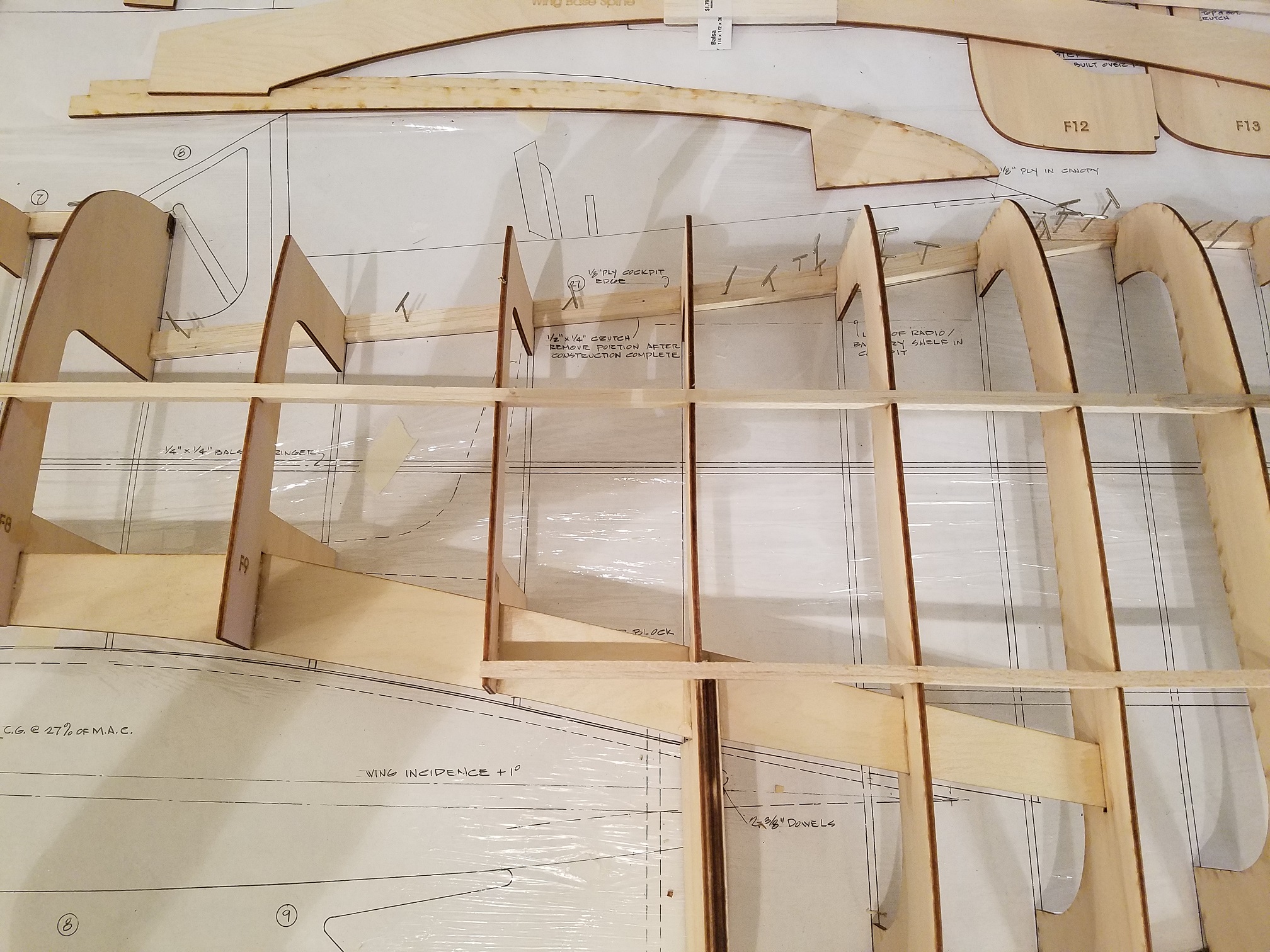

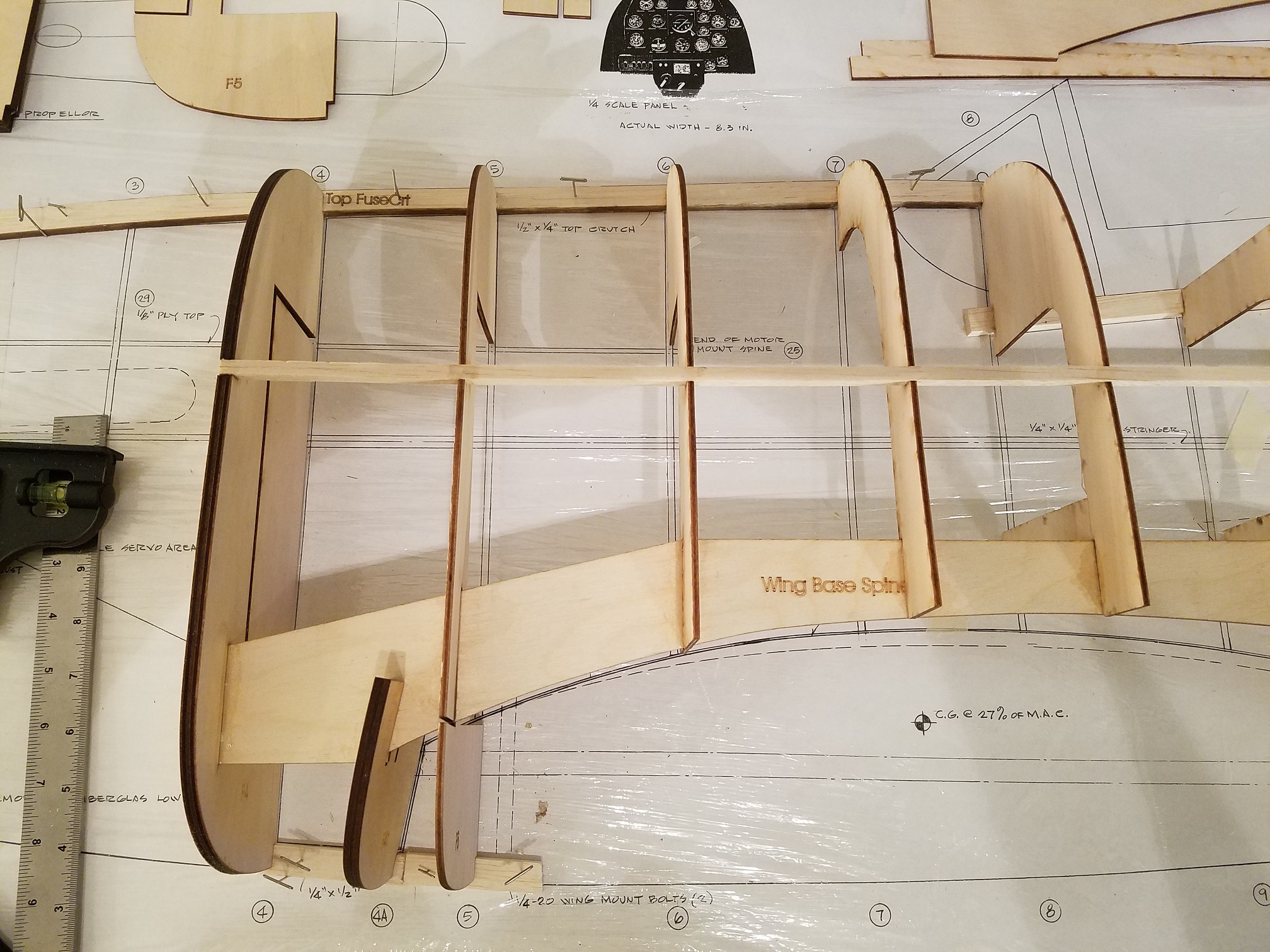

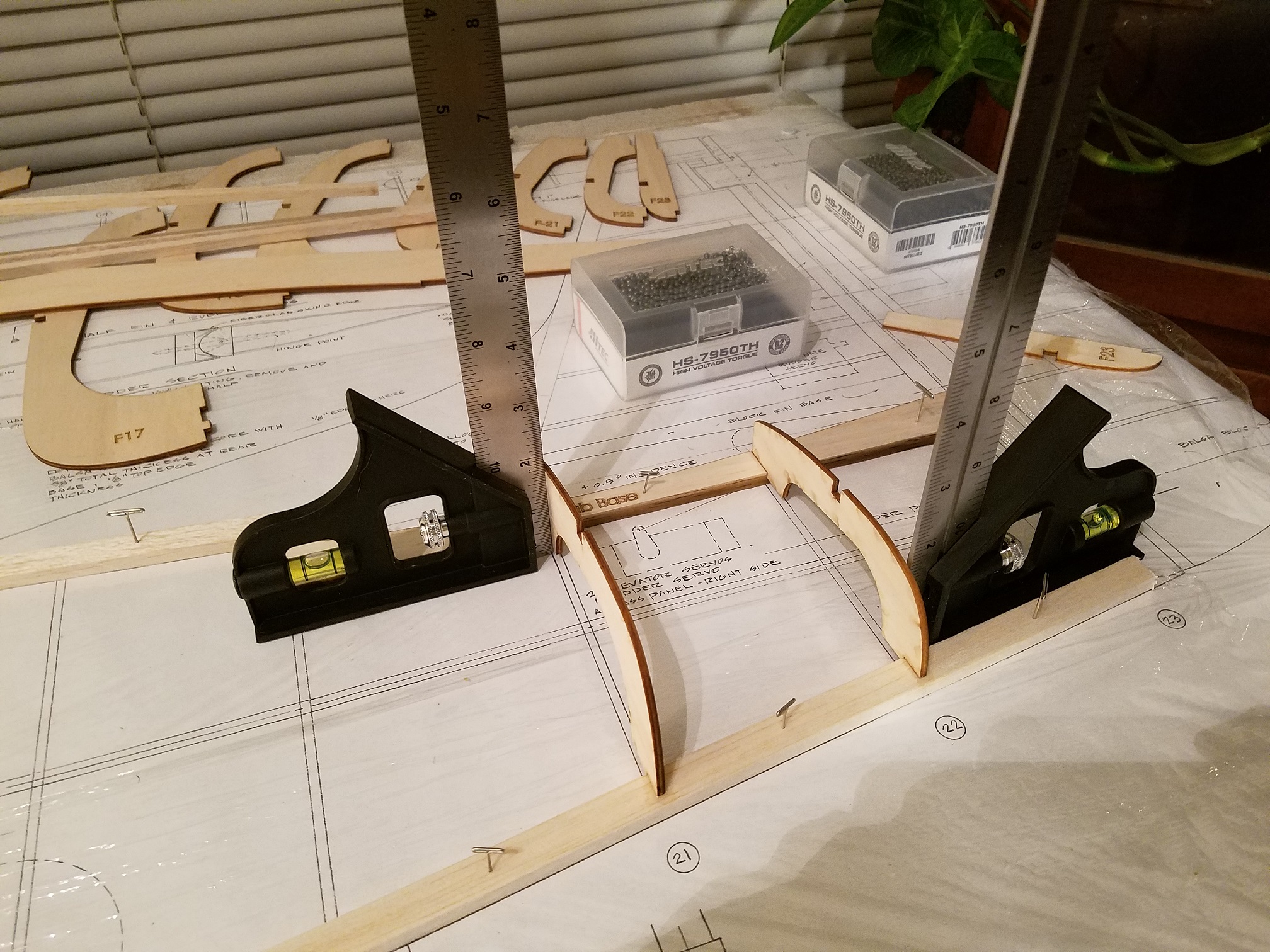

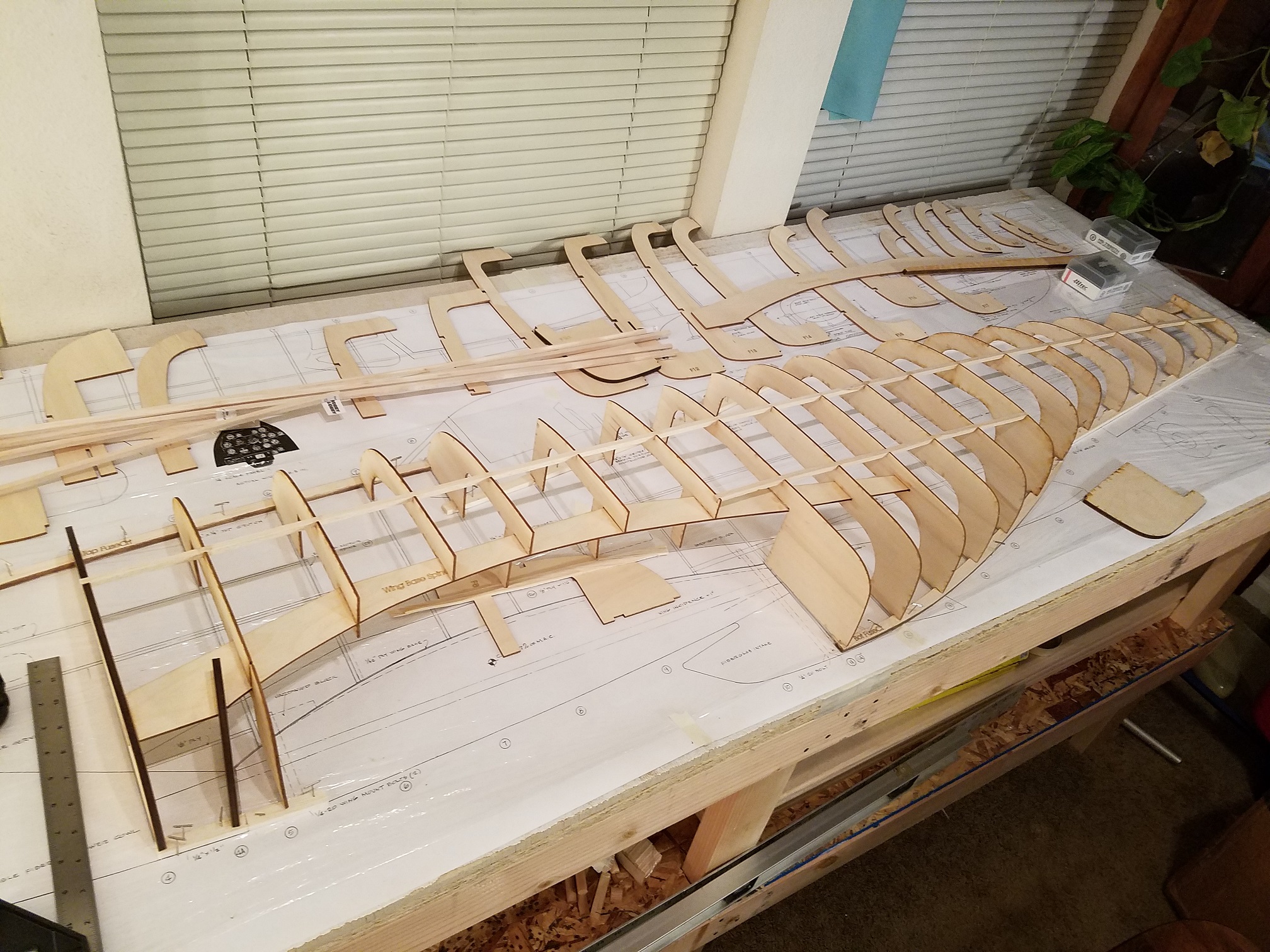

I kept tinkering and before I knew it, I had "officially" started the build with the angle cut of two 1/4x1/4 inch balsa sticks then glued them together to make a fuselage longeron. Yep, it is now official. Make one cut or one glue joint and the build has started. LOL. I positioned the wing saddle support and decided I would keep adding parts as per the plans. Bottom fuse crutch...check. Top (forward) fuse crutch...check. Hey, hold the phone...

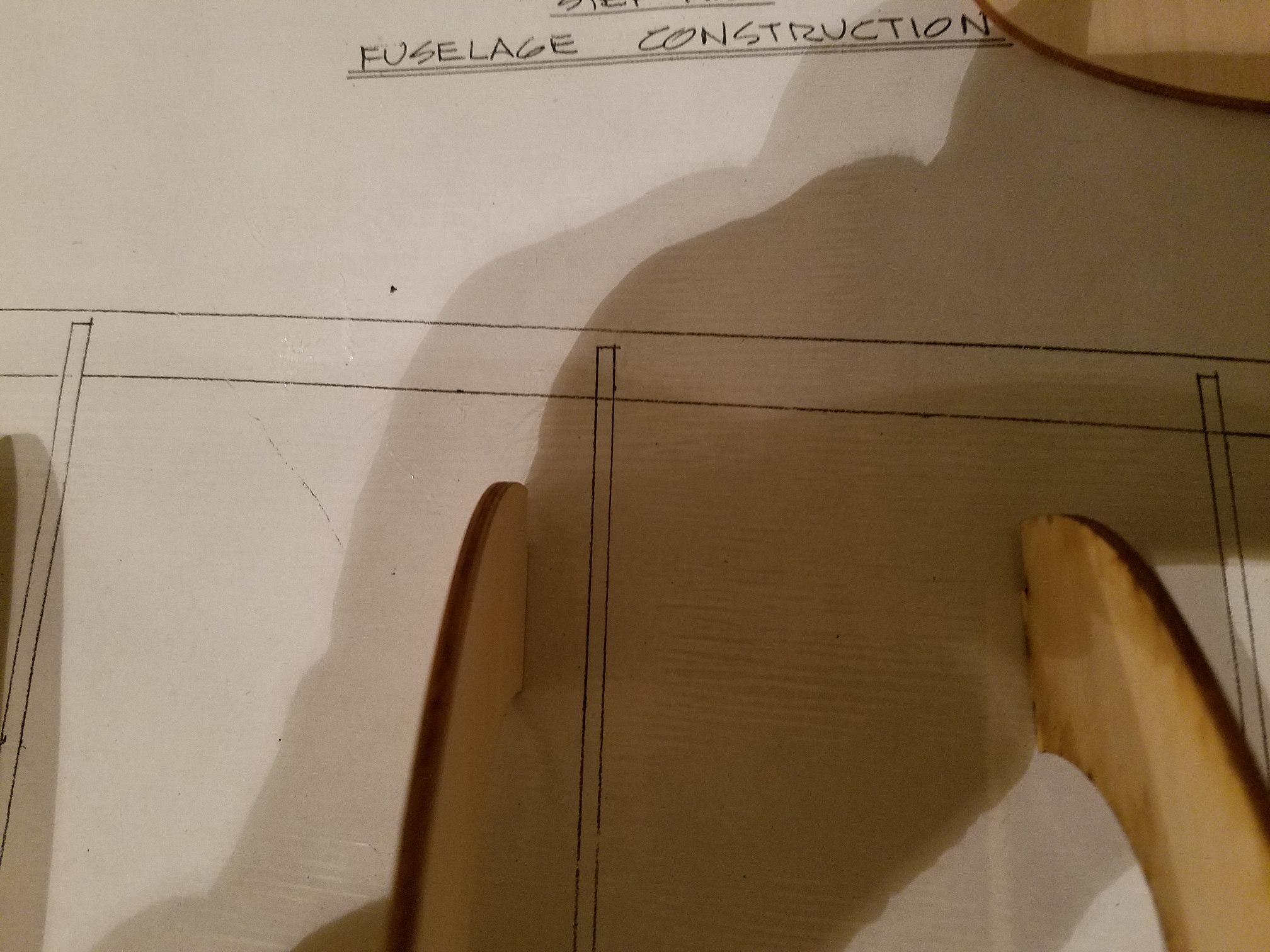

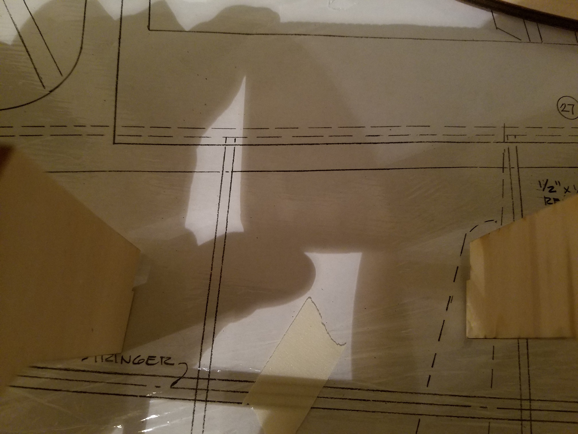

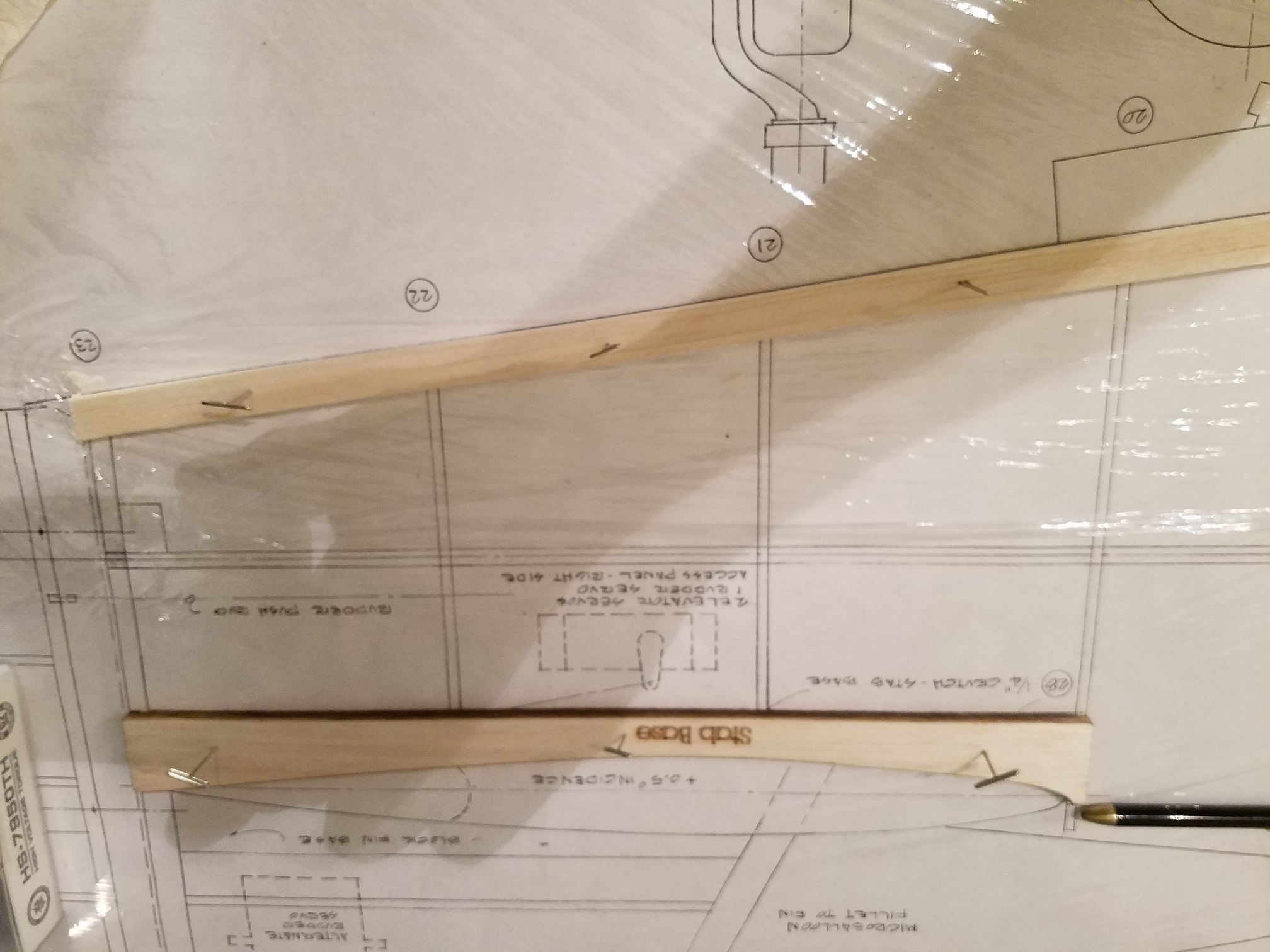

missing the top turtle deck crutch,
the canopy crutch
and the lower rear fuse crutch.

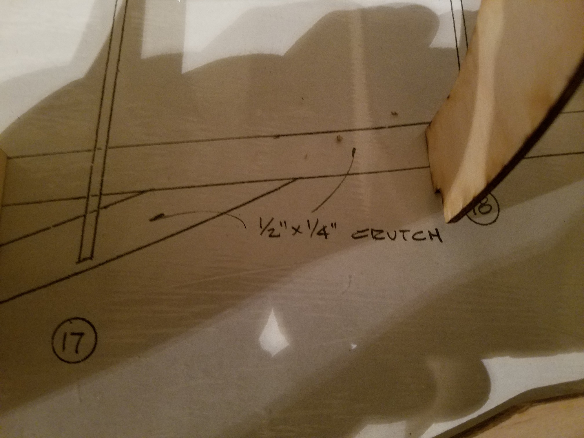

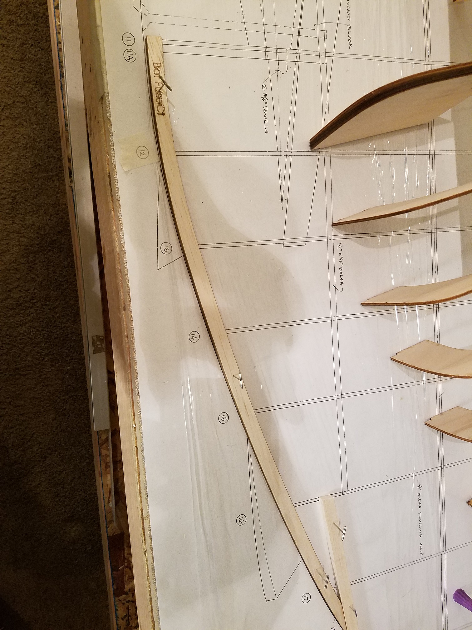

Not to mention I am also missing two 1/4"x 1/4" balsa stringers for the lower sides of the fuse formers. This is "NOT" the way I wanted to start this build. So I guess I need to round up the two balsa stringers. Not a huge deal on that. Michaels and Hobby Lobby are basically down the street. Hobby Clown (Town) is just a short ten minutes away in Boise. The problem is going to be the three missing crutches. I am going to try to locate some 1/2"x1/4" balsa and then pin it to the building board over the plans. If I moisten them before pinning them into position, they will take the shape needed from the plans. At that point, I could actually start gluing the formers to the crutches.
