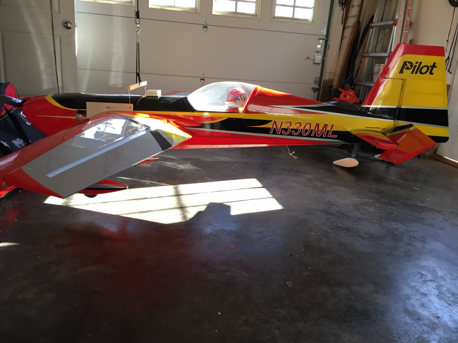

I've attached a picture of a similar setup where I used much smaller plywood pieces that were attached to a spreader bar with wire. This is a 30% Pilot Extra with a DA 70 in it which makes it a little easier to handle.

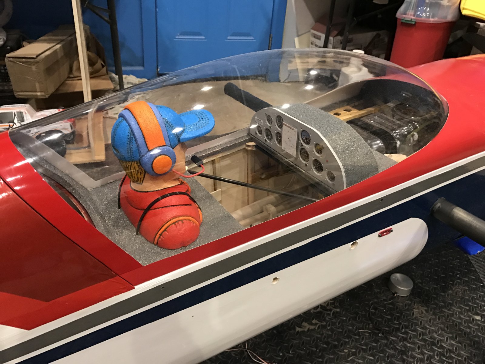

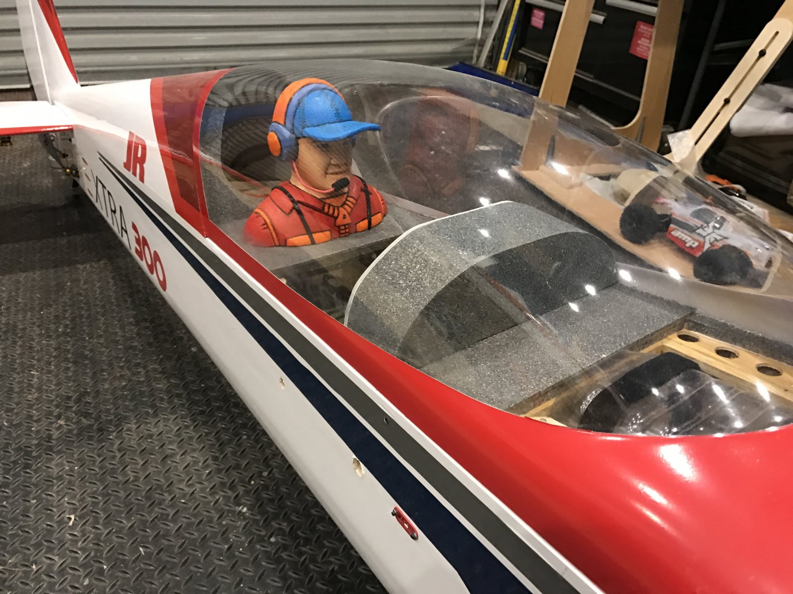

These are the lightest pilots. 1.1 ounces. I have installed both into each Carden. Both of the airplanes, right now, are tail heavy, so time to go to work, and see what happens.

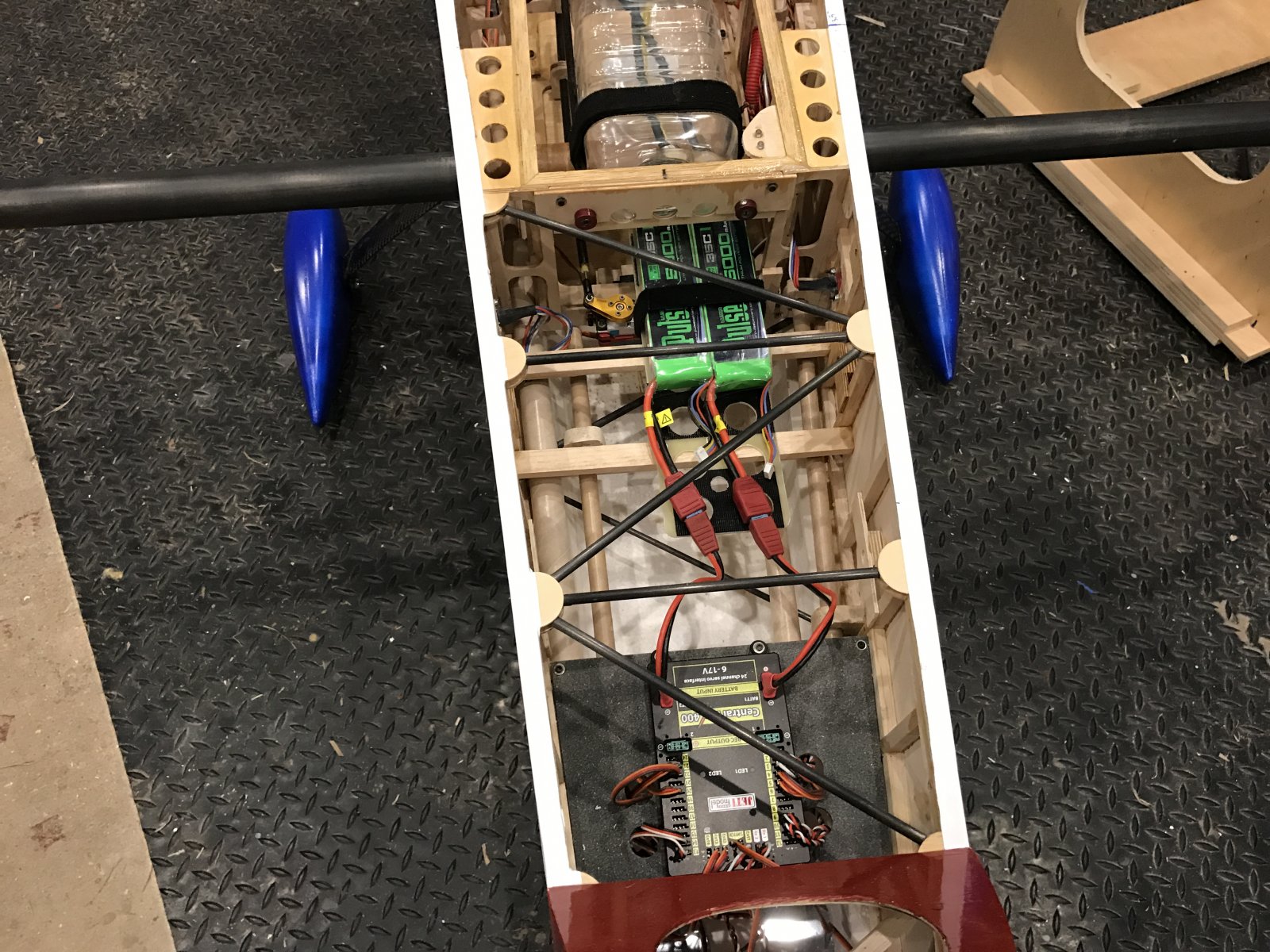

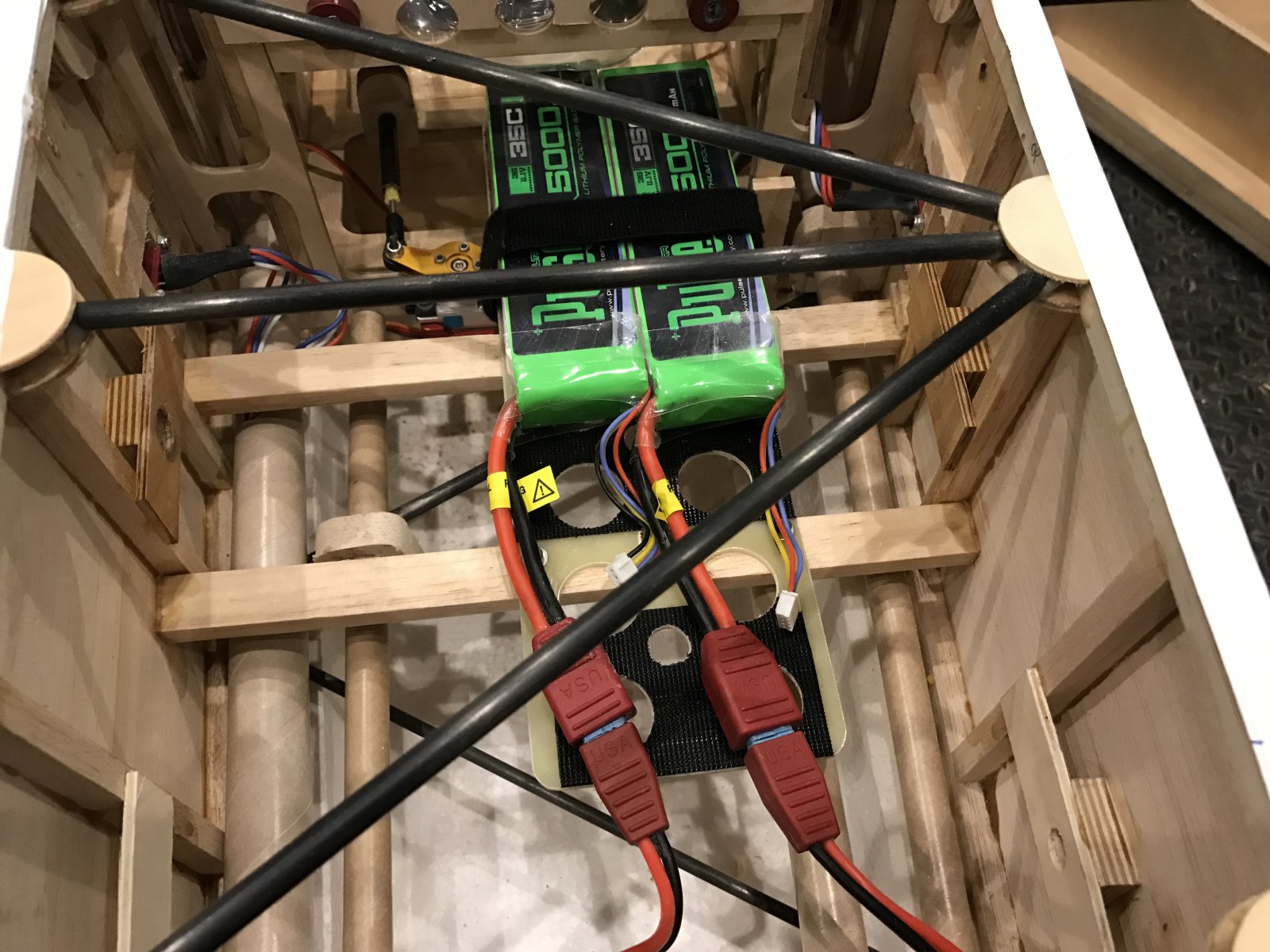

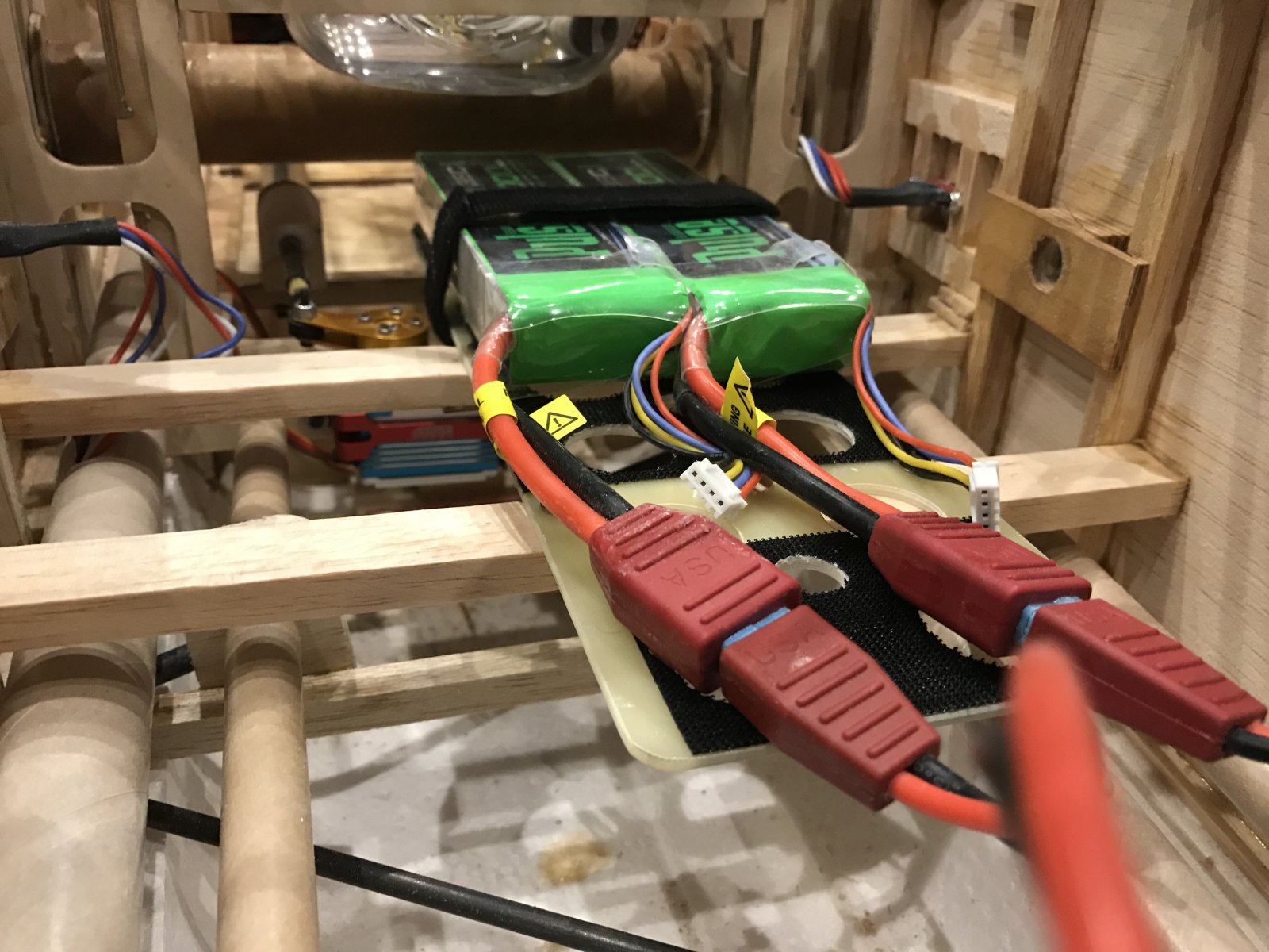

I did have to move batteries forward, and I made a tray that will allow me to move the batteries forward or back to make adjustments of the balance point. The batteries are now rear to the wing tube. When they were forward of the wing tube, the airplane was nose heavy. I will take a picture so you can see what I have done.
This tray weighs 3.25 ounces, with all the wood used to mount it, and the velcro. the tray itself is made of G10 material sheet, that weighed 6 ounces. I then drilled out multiple holes in it, and got the weight down to 2.8 ounces. I weighed everything!! LOL, being OCD.
