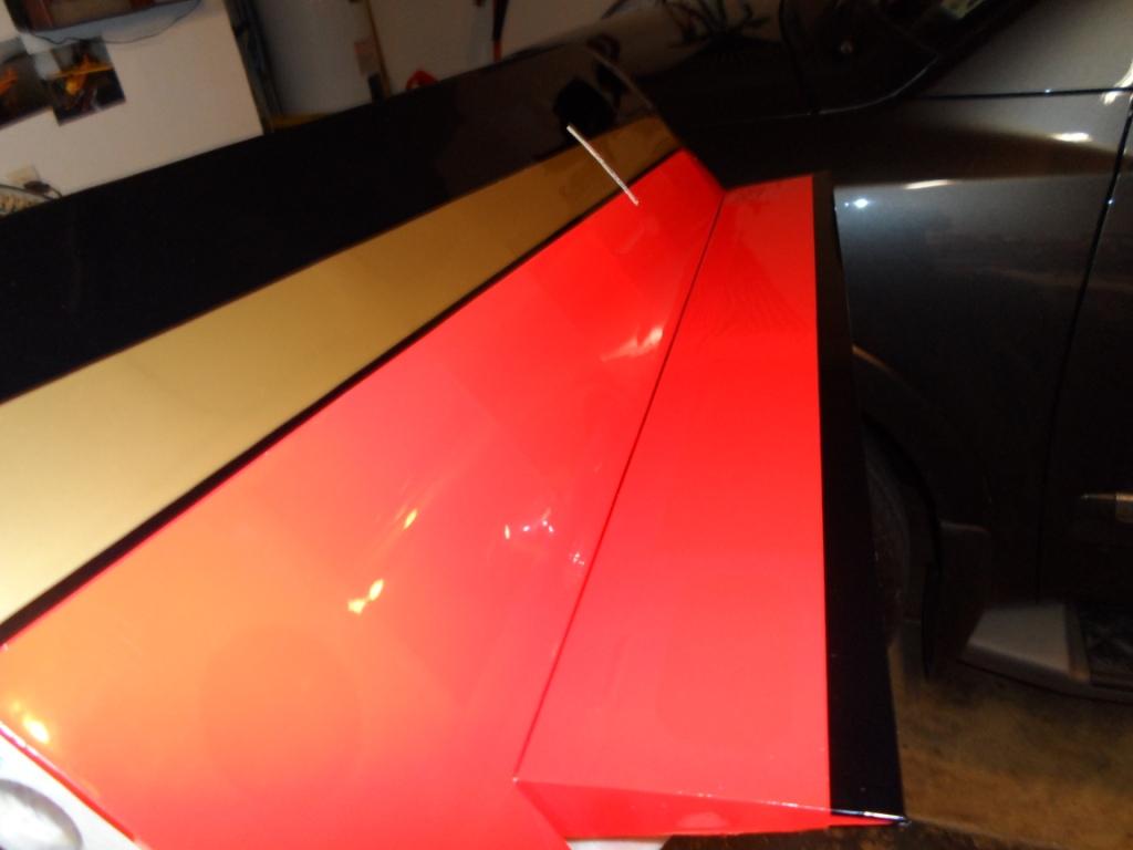

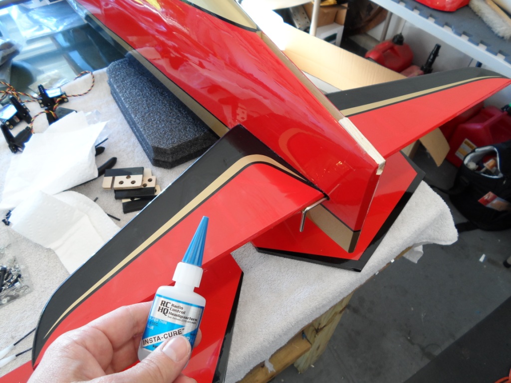

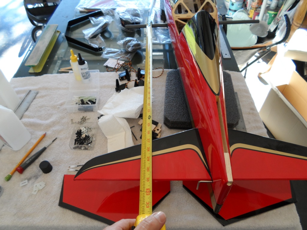

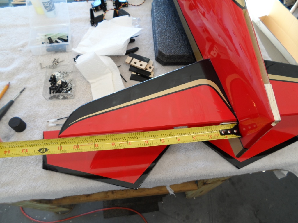

Aligned and glued in stab.
Manual says to use thin CA here and keep flowing it in. Works really well. Dont forget to put the elevator joiner in before you glue !!!
Clean up with alcohol and acetone if needed.

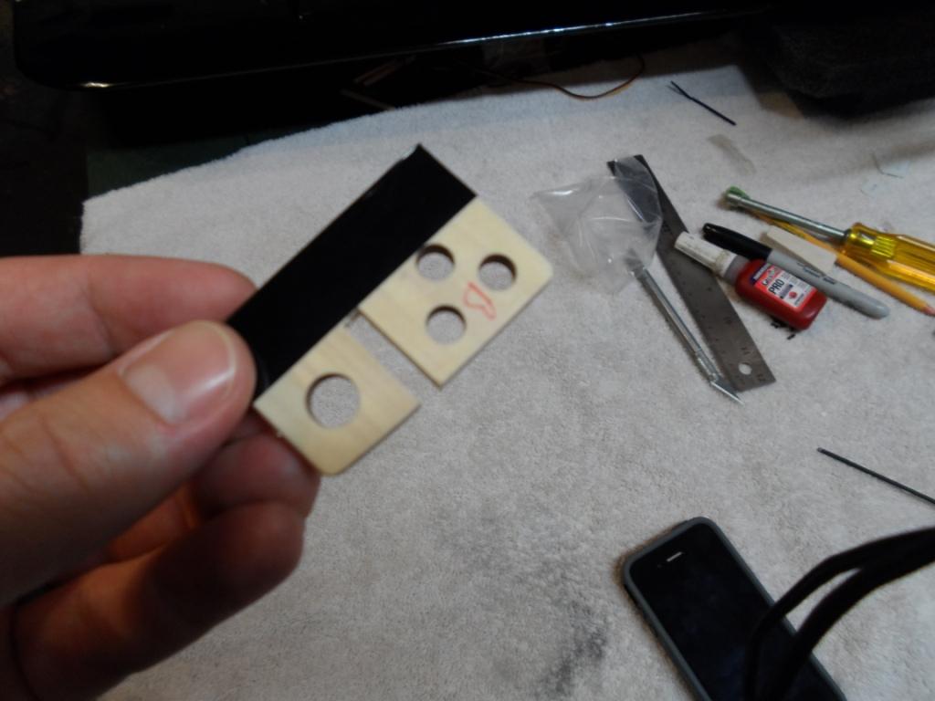

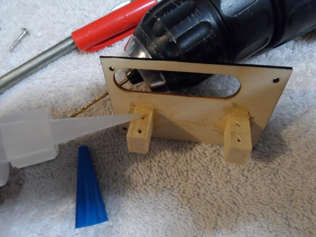

Ok, I got a little more done in the last few nights.

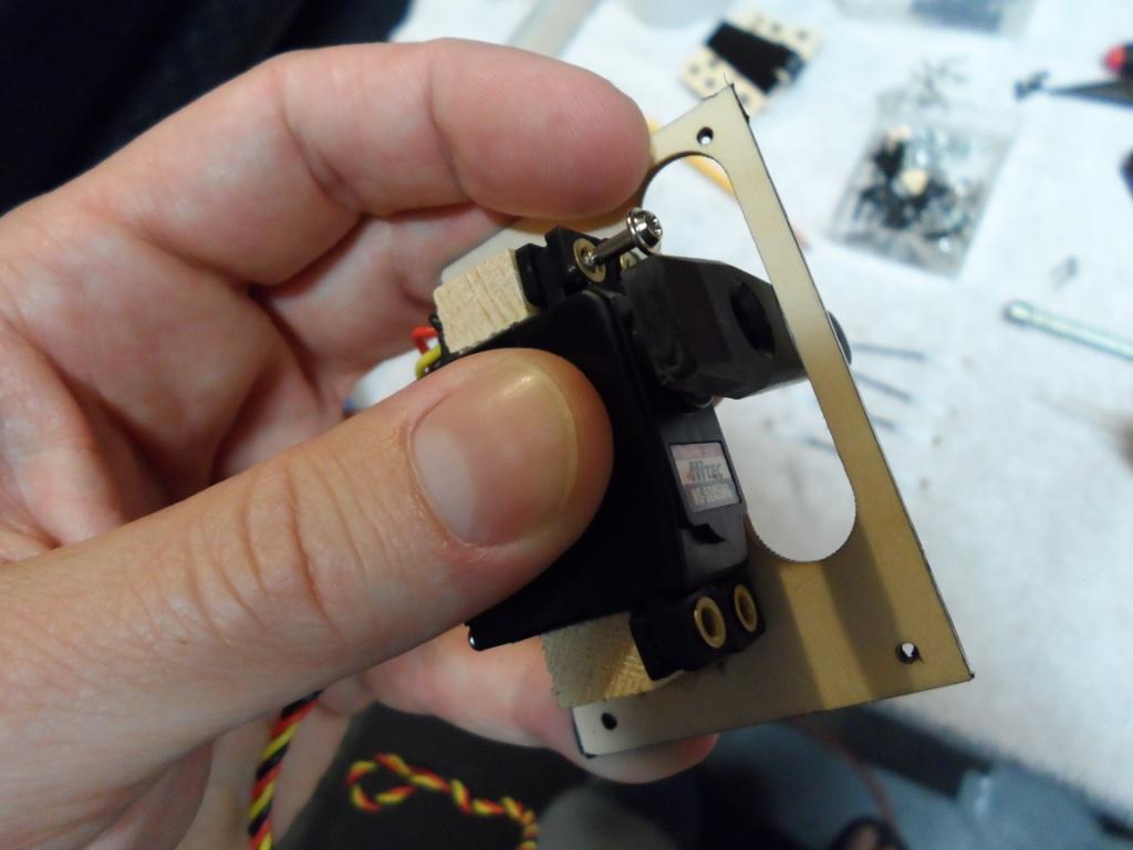

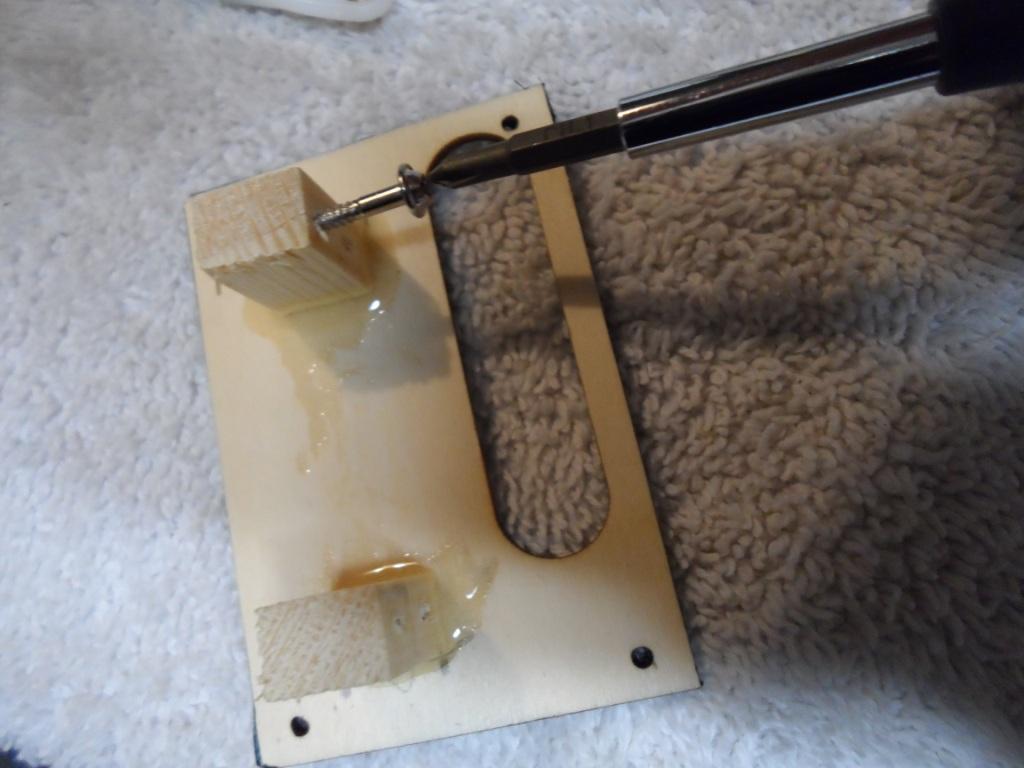

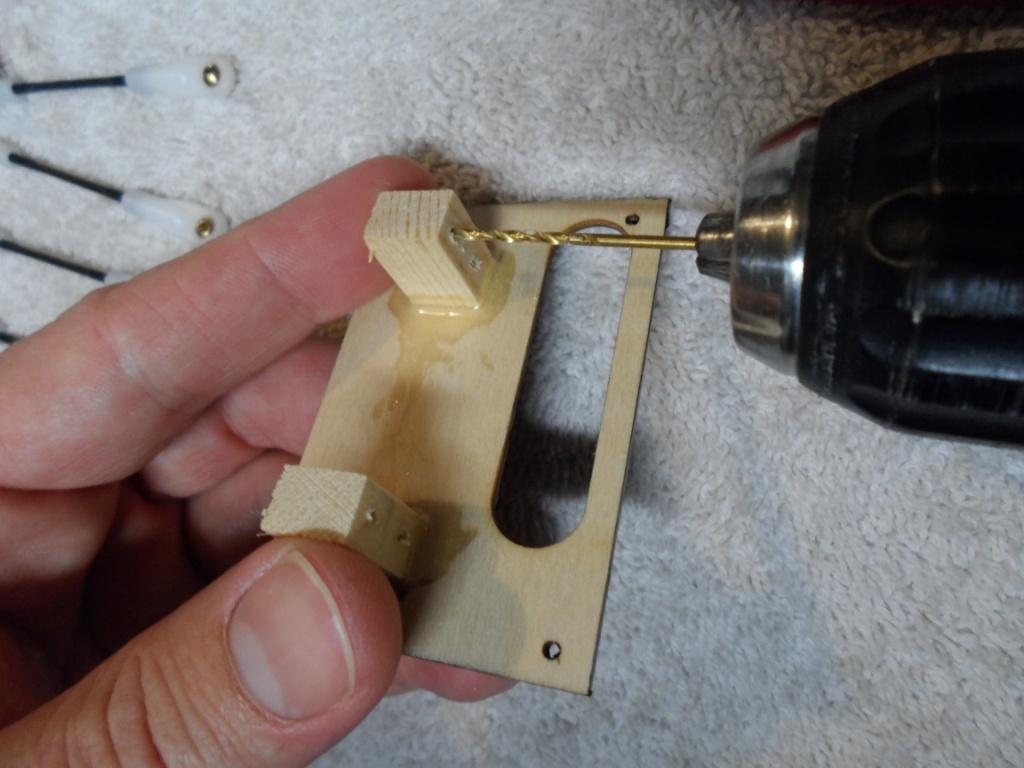

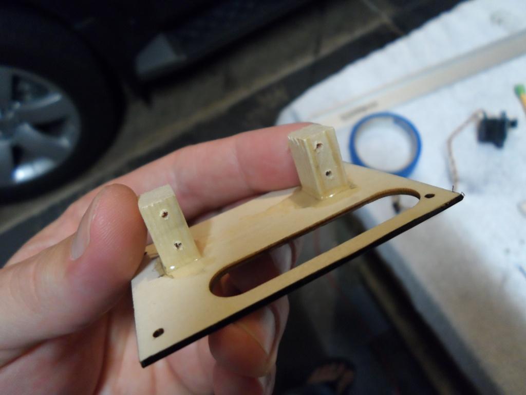

Finished up the aileron servo trays.
I use the screw to mark the hole then removes servo and drill. Don't try to make the hole with the screw, the block will crack.
Then tap the screw into the hole.
Remove screw and flow a little thin CA into the hole to strengthen it.
Done......

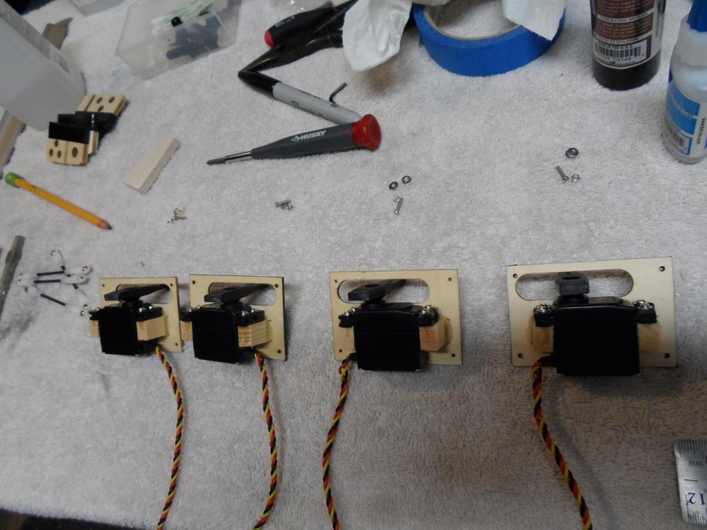

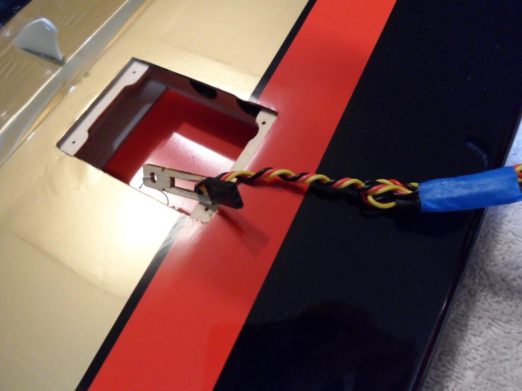

Drew

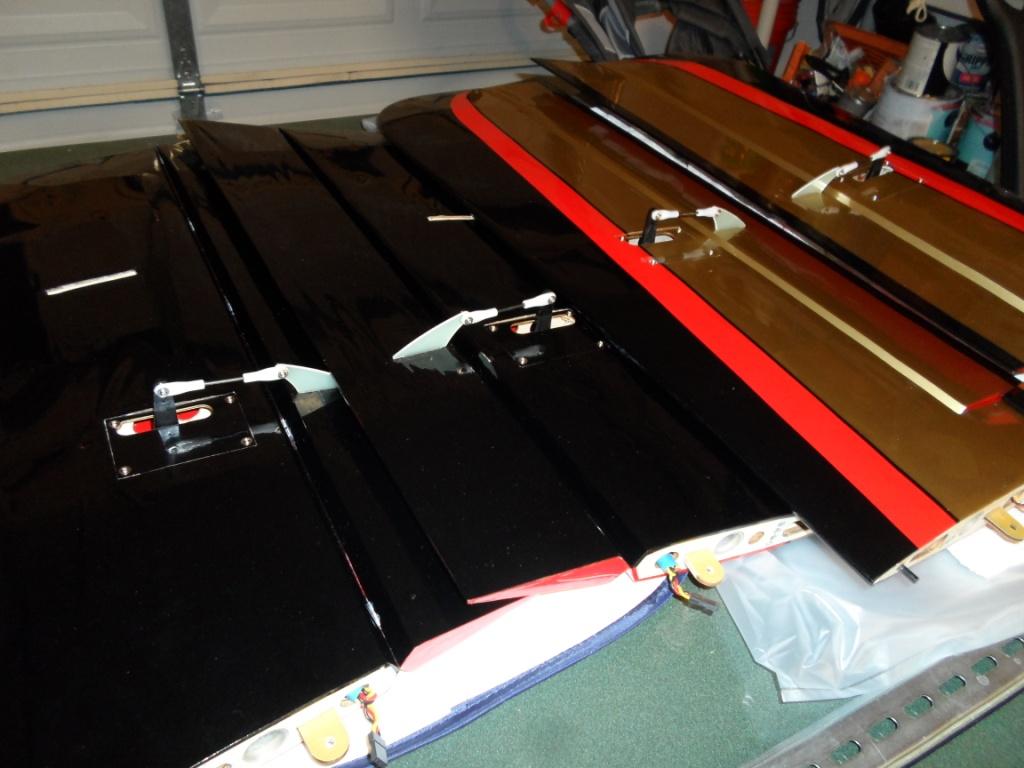

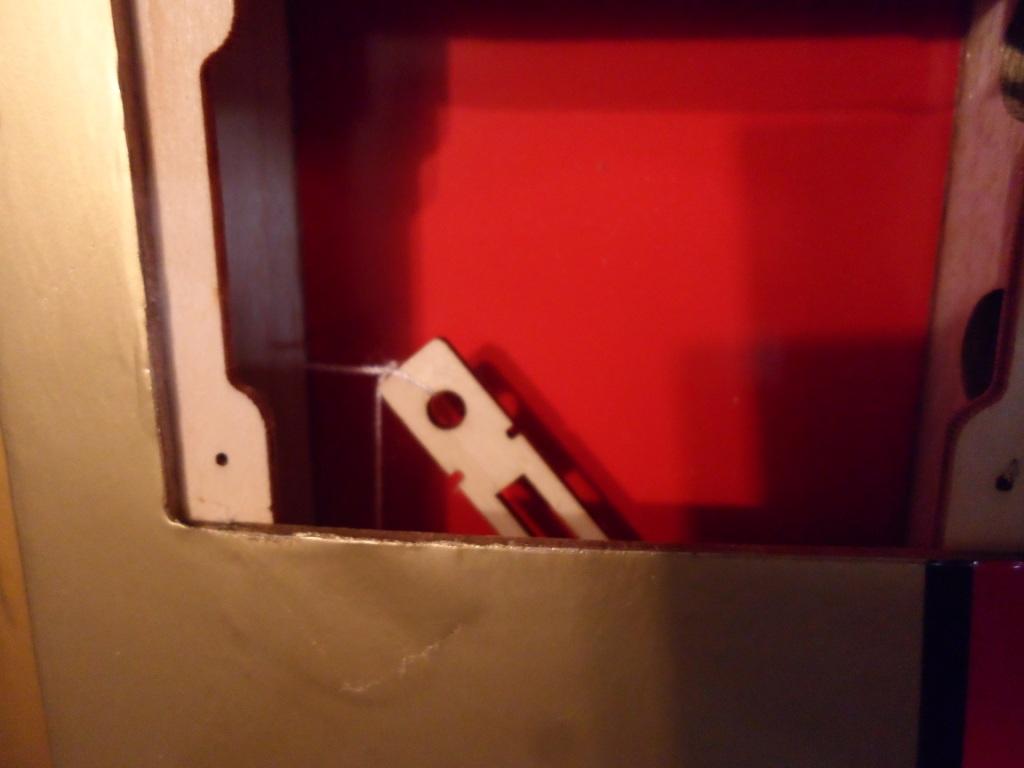

Installed servos into the wings.
Horizon puts these nice little pull strings into the wings to make this super easy.
Pull the wire threw....

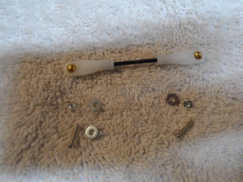

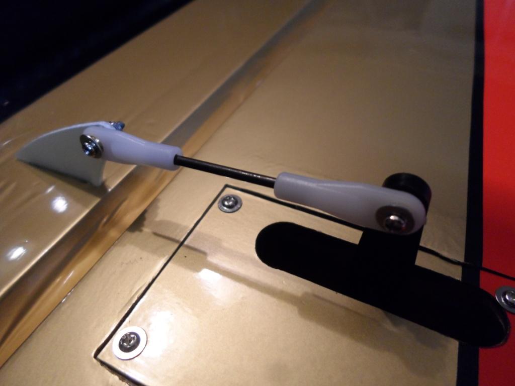

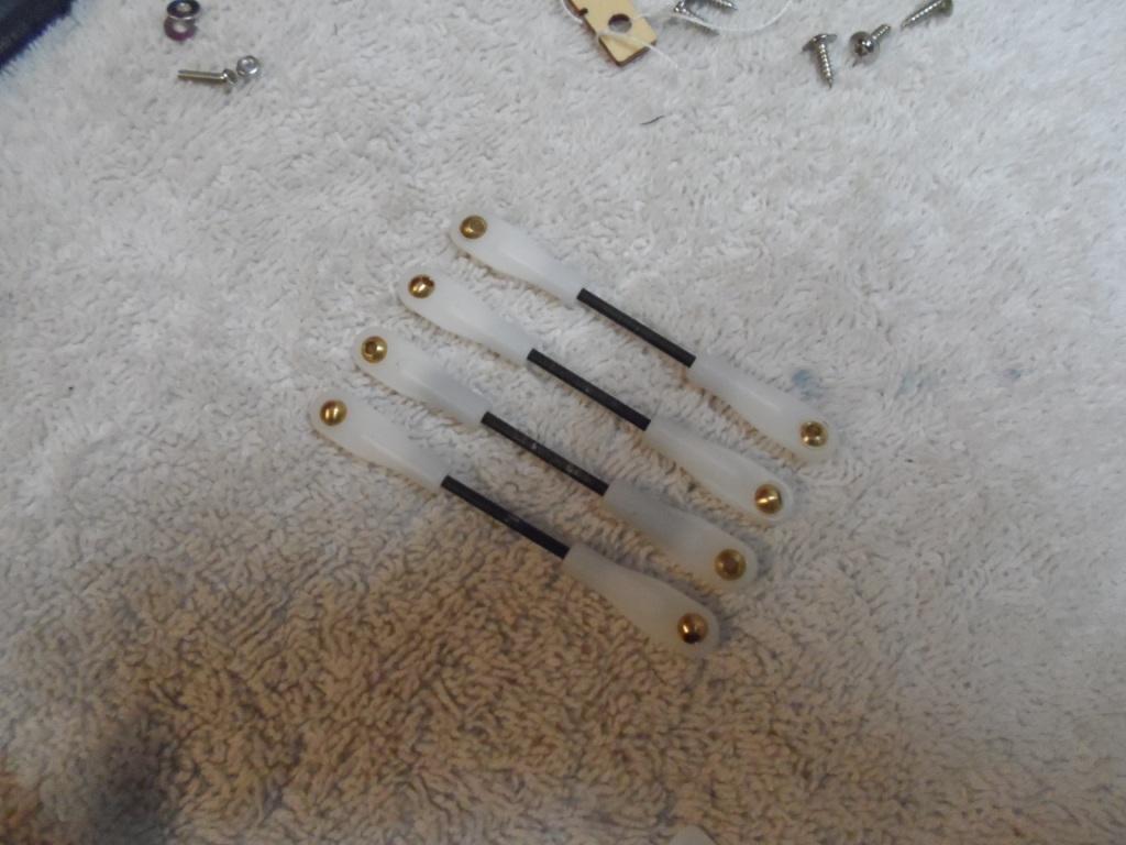

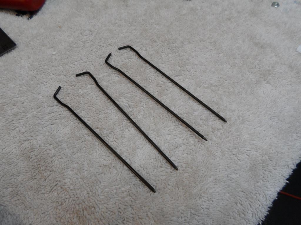

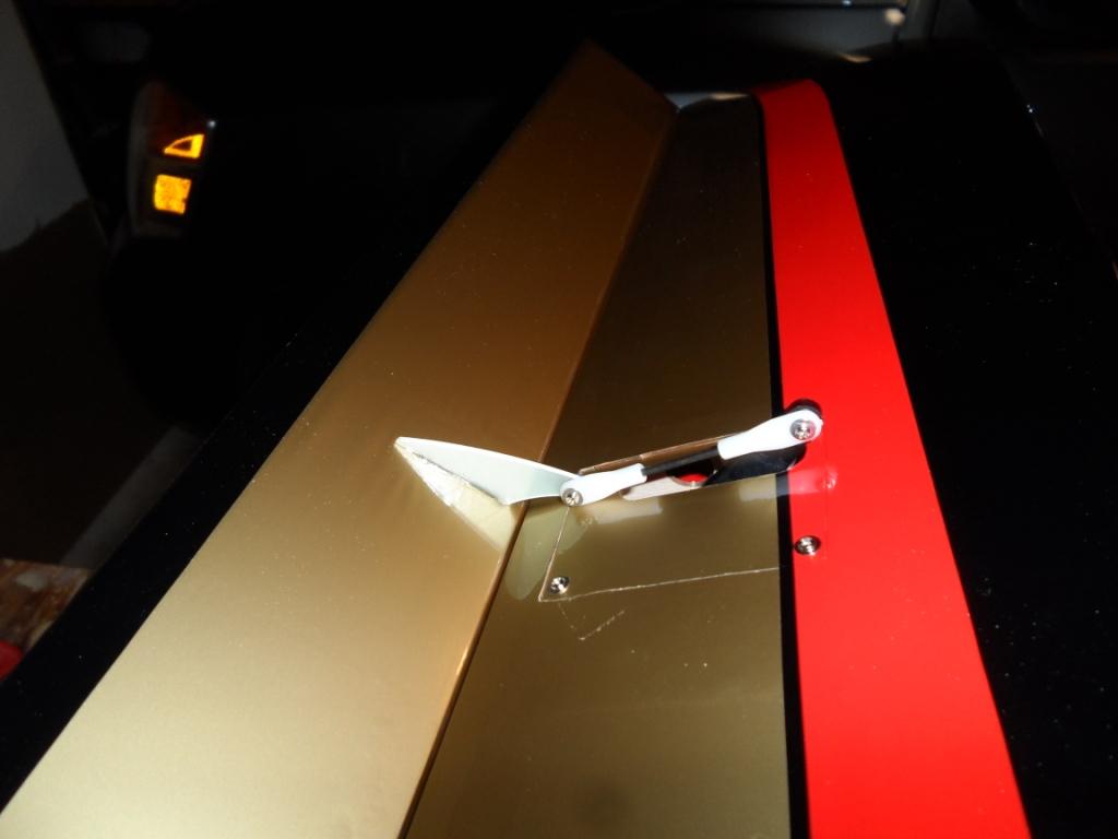

Made up the 4 control rods, all the exact same length.
Control rod hardware.

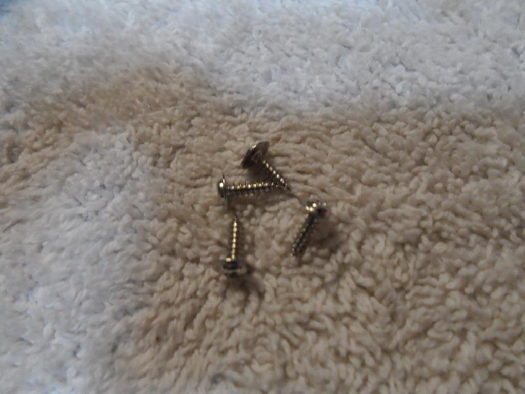

Screws for mounting servo tray.
Done.....
Plenty of throw !!!

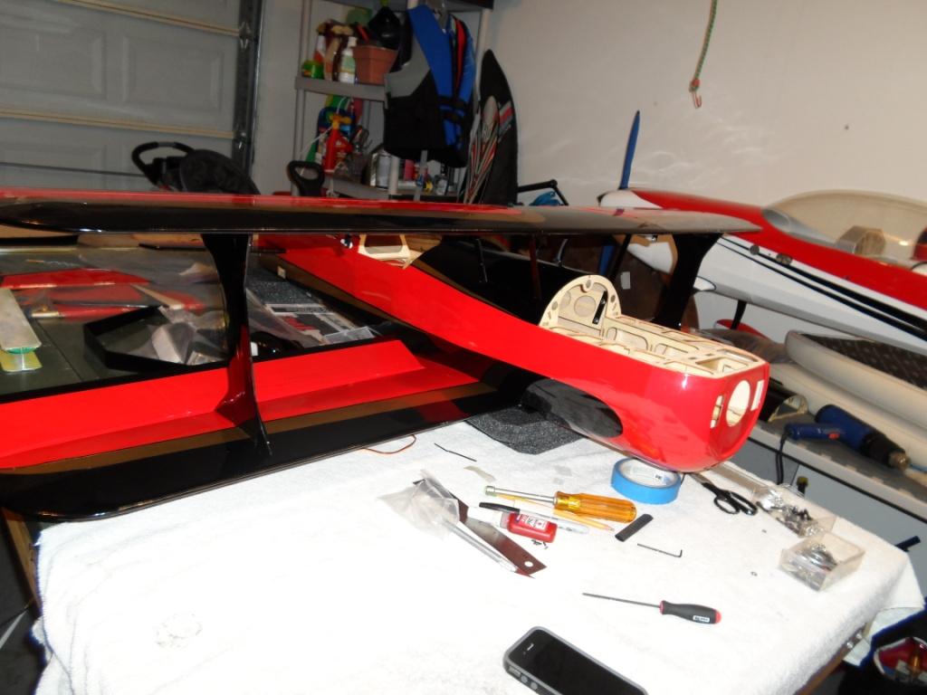

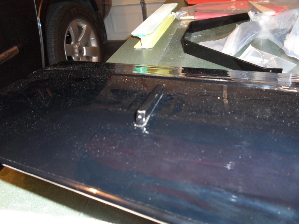

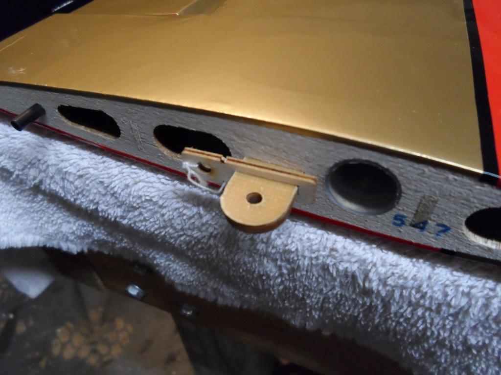

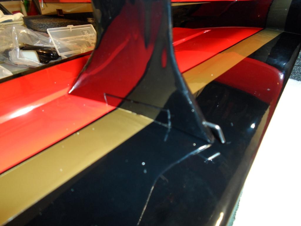

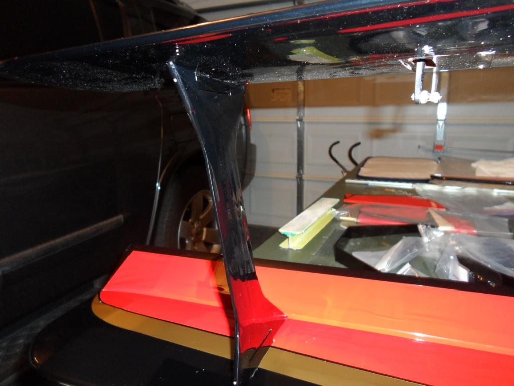

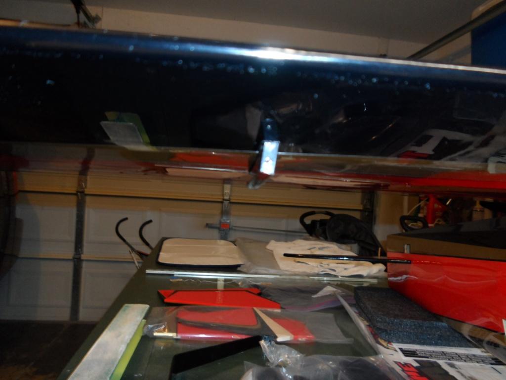

Next I epoxied in the wing strut mounts for the wing struts.
There is a upper wing mount and a lower wing mount, make sure you pay attention here. I marked them with a red pin once I figured them out.
The struts only install one way, make sure you get this right when checking the alignment.
Kit comes with these retaining pins for holding them in place. I couldn't get them to go all the way in just yet, but I'm sure they will loosen up after a few times inserting them.
Wings are done.....
