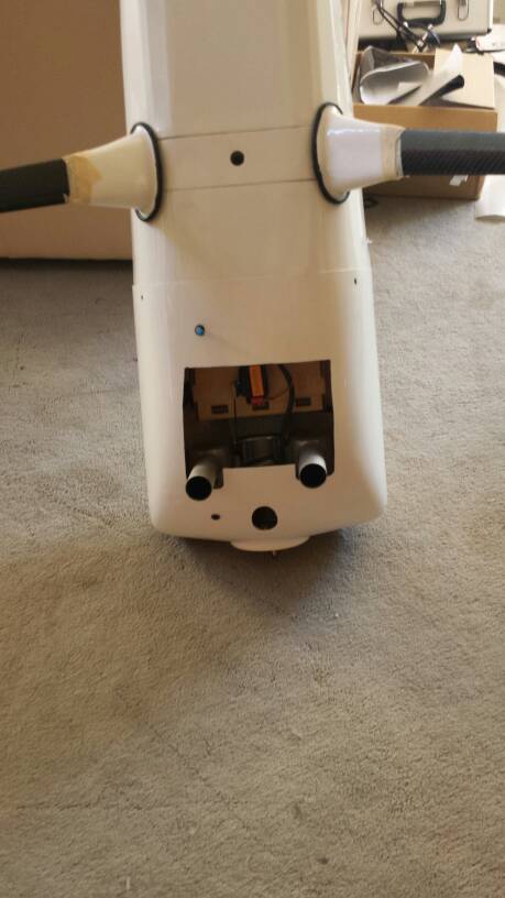

Forgot the picture of the cowl. I decided to cut just the cowl and not open the vents on this one. uploadfromtaptalk1397836623461.jpg

I'm surprised you didn't open the vents...any particular reason? It seems like it would provide better airflow than just that open space behind the pipes?
On the last one I left the pipe tunnel open and opened the vents. Worked great but the bottom looked a little busy with all the holes.
On this one I blocked the pipe tunnel off with the provided wood cutout so the air can't enter the tunnel. I also baffled the engine.
Azhar has a few set up this way with no issues.
