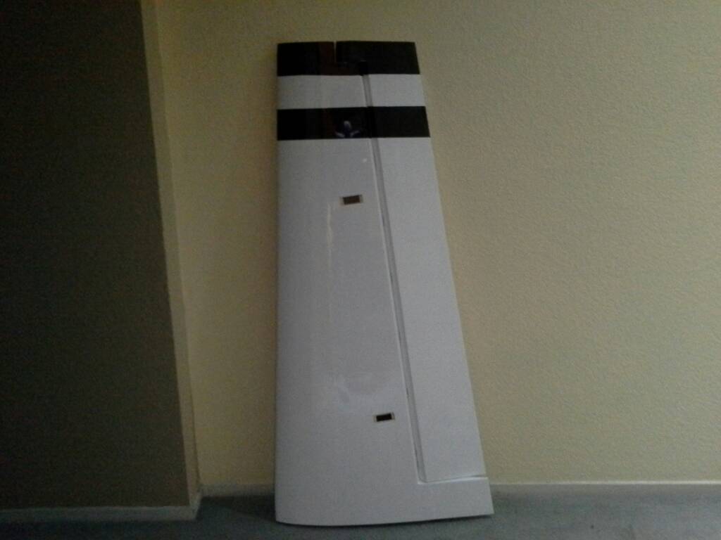

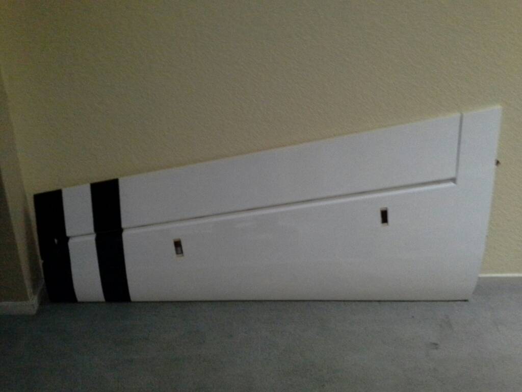

Looking at the wing this morning i noticed that i followed the taper of the wing so my stripe isn't straight. If i do a second stripe i think it would look weird since it would have to be at an angle as well. I'm going to re-do the first one to make it straight then add a second stripe.

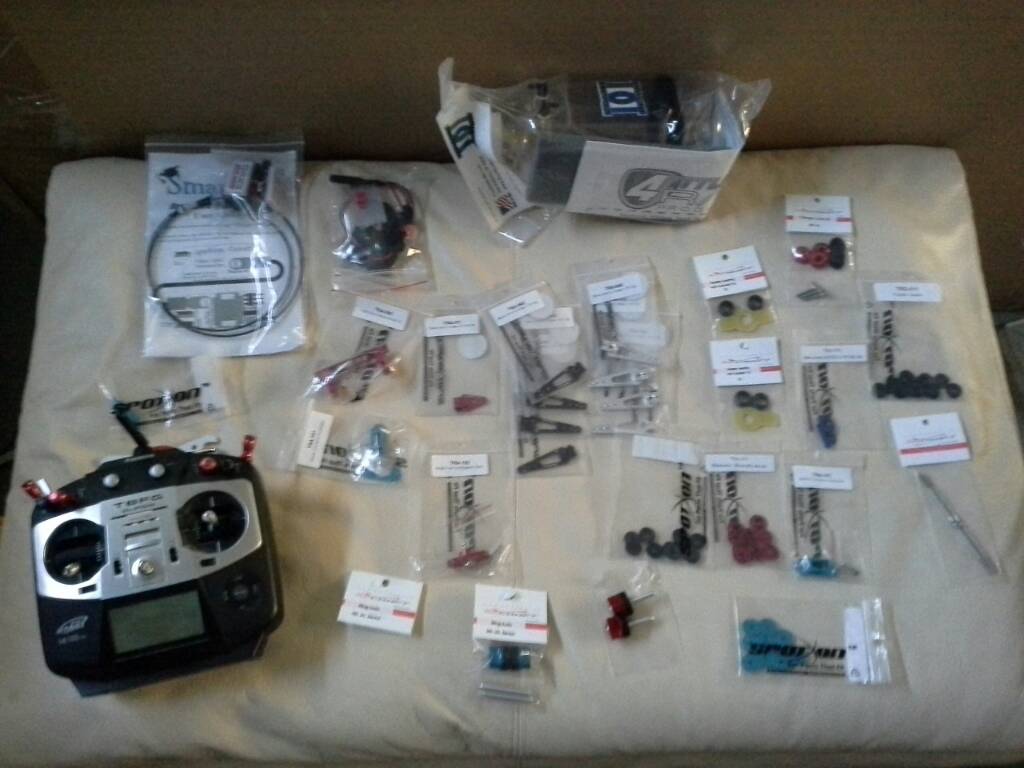

Lots of bling from Aztech showed up today :) I should be able to get the build moving along nicely this weekend.

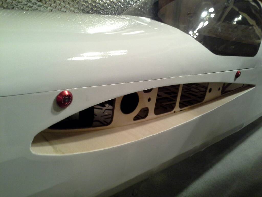

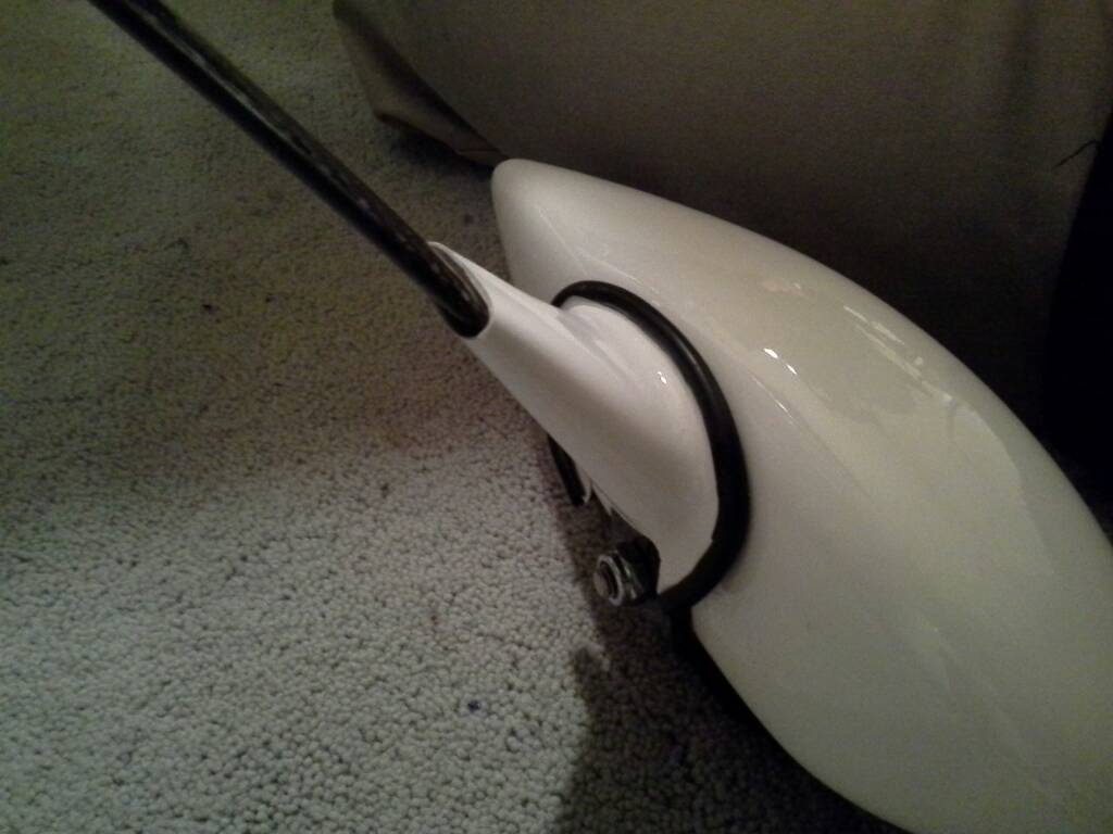

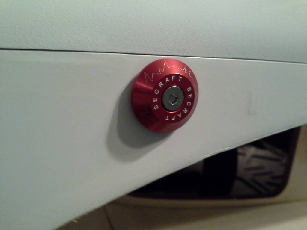

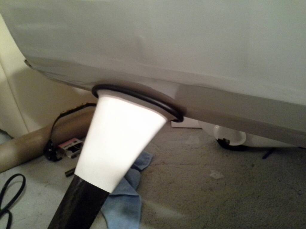

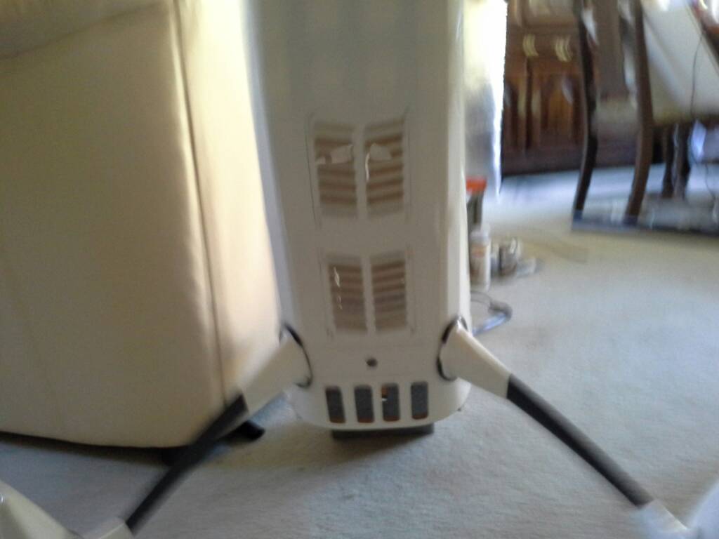

Got some more work done. Added some Secraft canopy locks and wing bolts for that added bling factor. I also installed the LG fairings, as you can see in the pics I added some black neoprene tubing around the fairings. I also added a second stripe to one wing panel. I'd like to add the stripes to the other wing and elevatos this weekend. I'm hoping I get my receiver tomorrow so I can begin the servo installation and setup. This will be the first plane I set up with my Futaba 8FG Super.

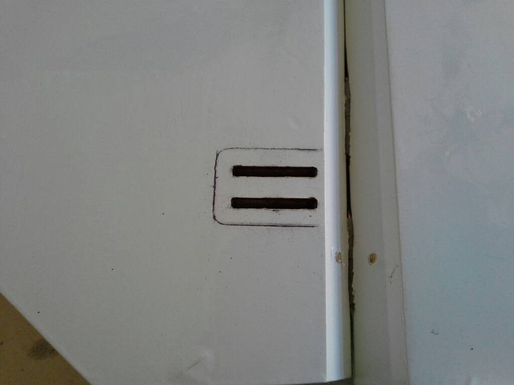

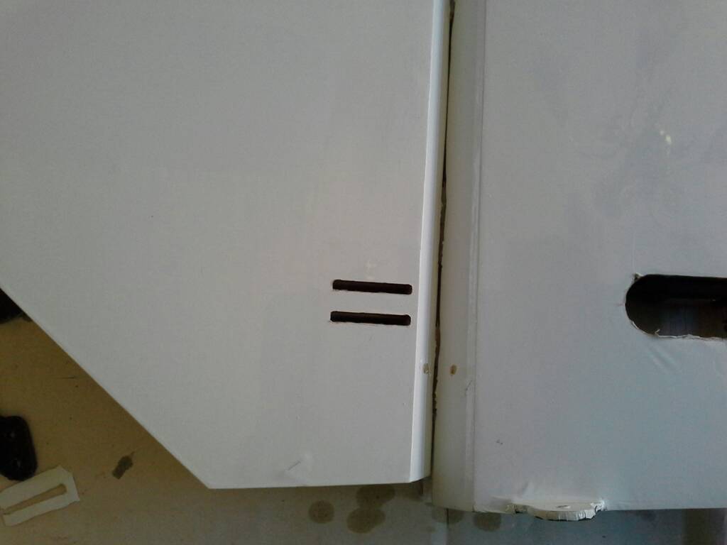

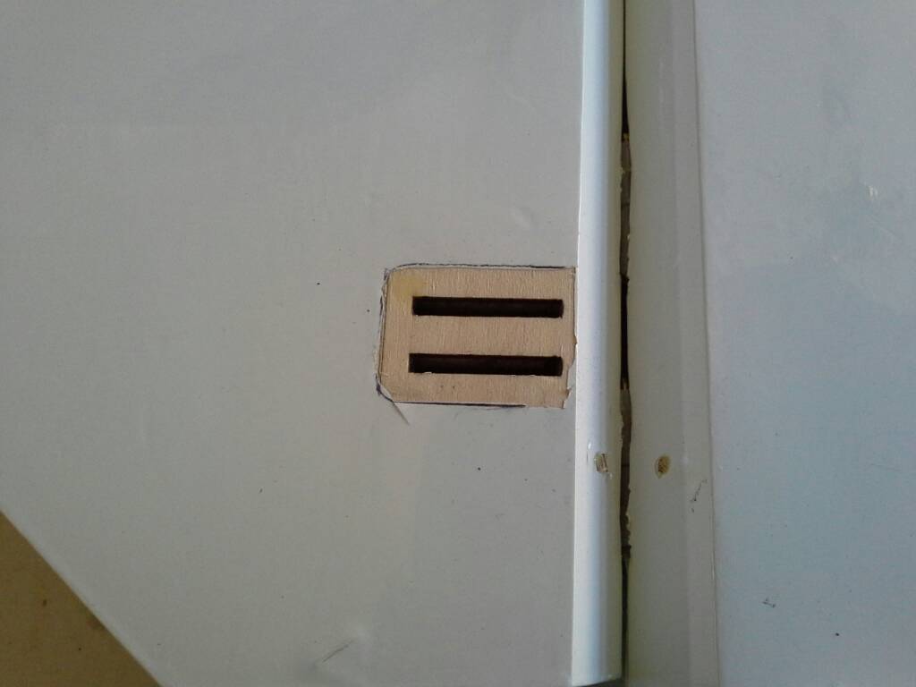

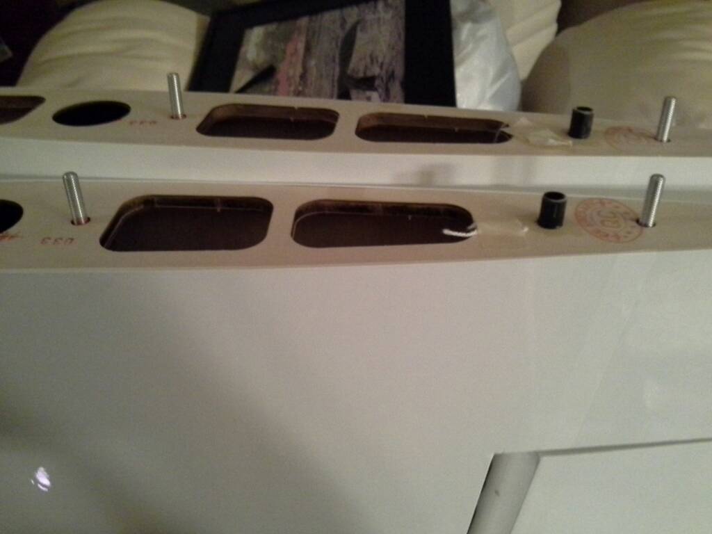

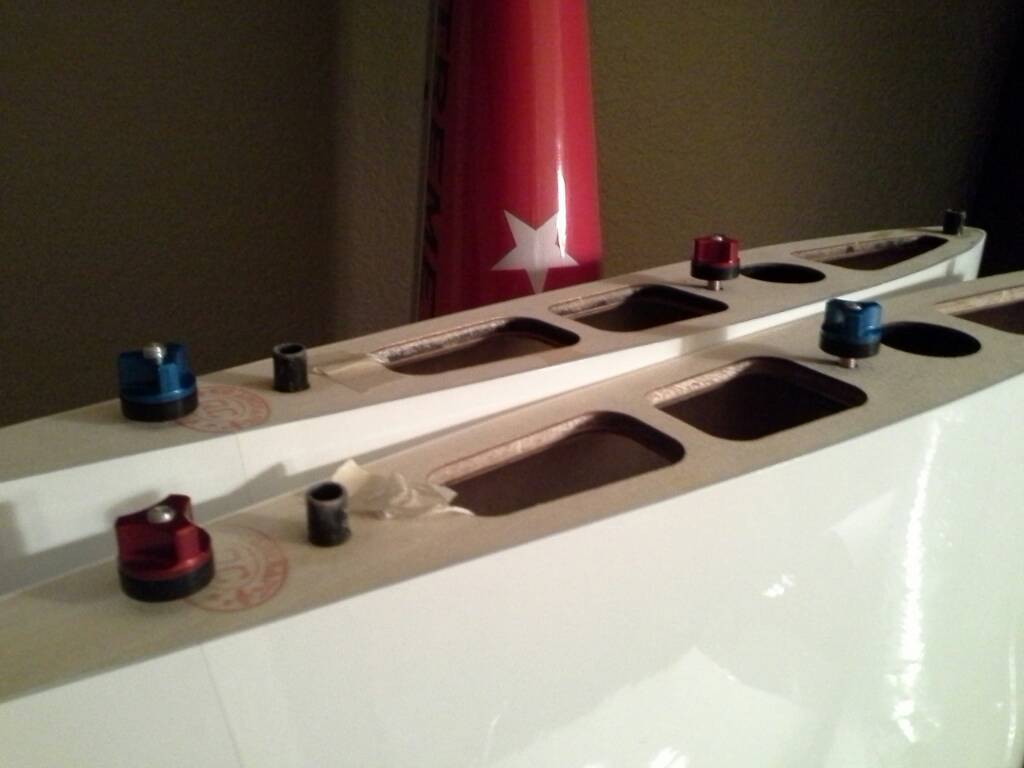

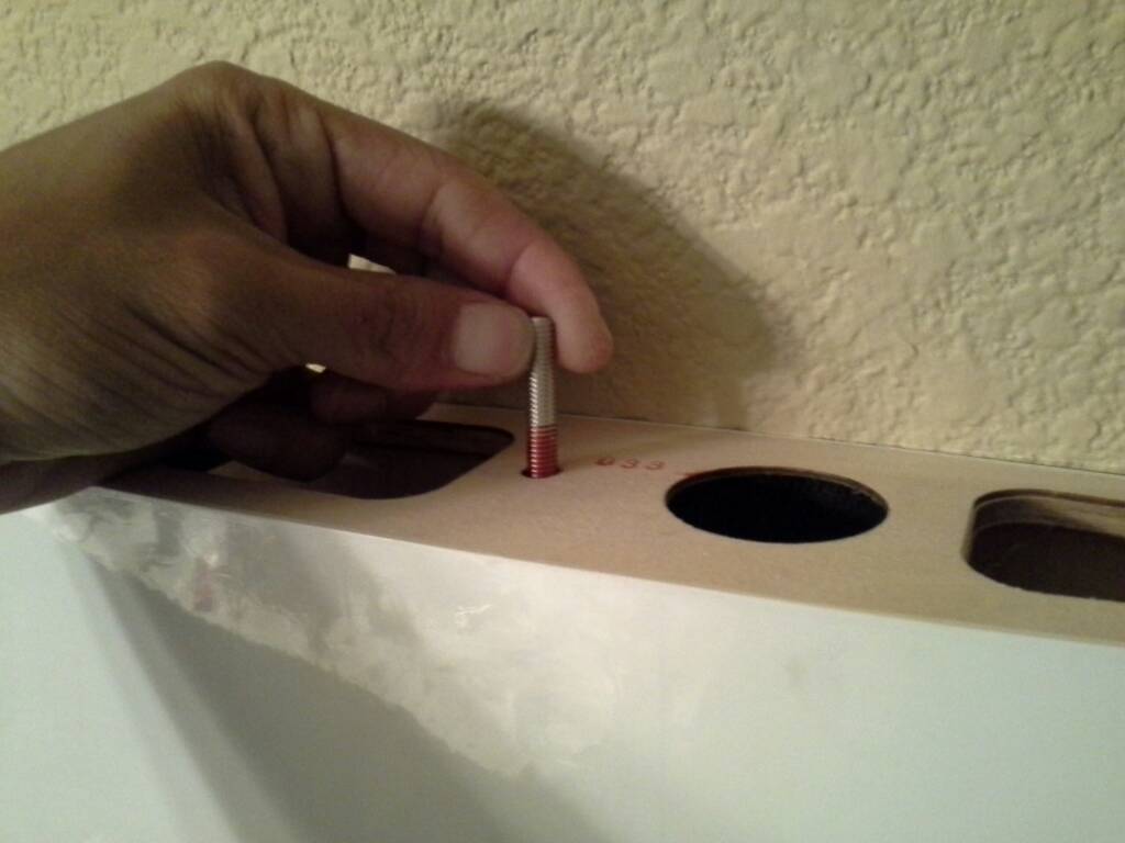

Got the ventilation holes cut out.

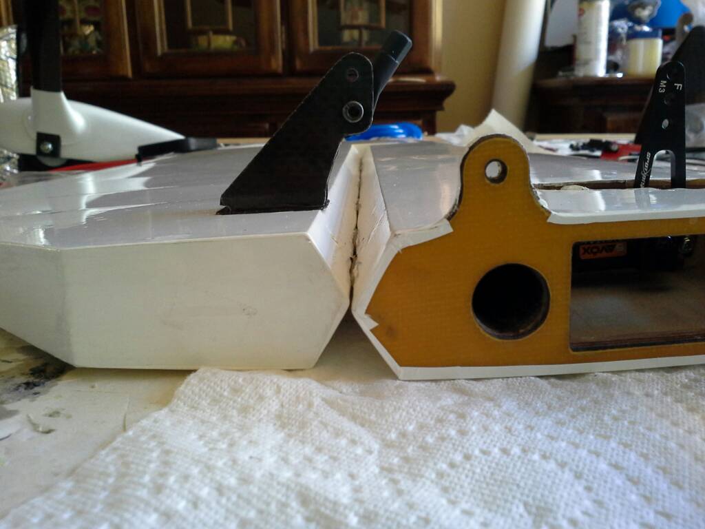

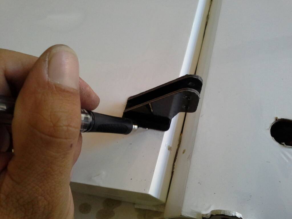

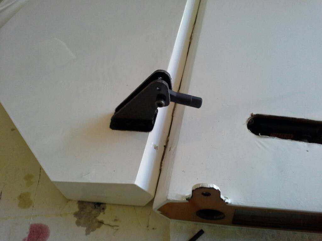

I also installed the control horns on the elevators. First I test fit the horns in the pre cut slots then I marked around the horn with a pen. After that I pulled the horns back out, scuffed them with sandpaper, and cut the covering from where I marked with the pen (being careful not to cut into the wood). Now I mixed my 30 minute epoxy and filled the slots, pushed the horns back in and cleaned up any extra that oozed out with a paper towel and some rubbing alcohol. The horns line up with the hinge lines perfect so they won't need any adjustments.
