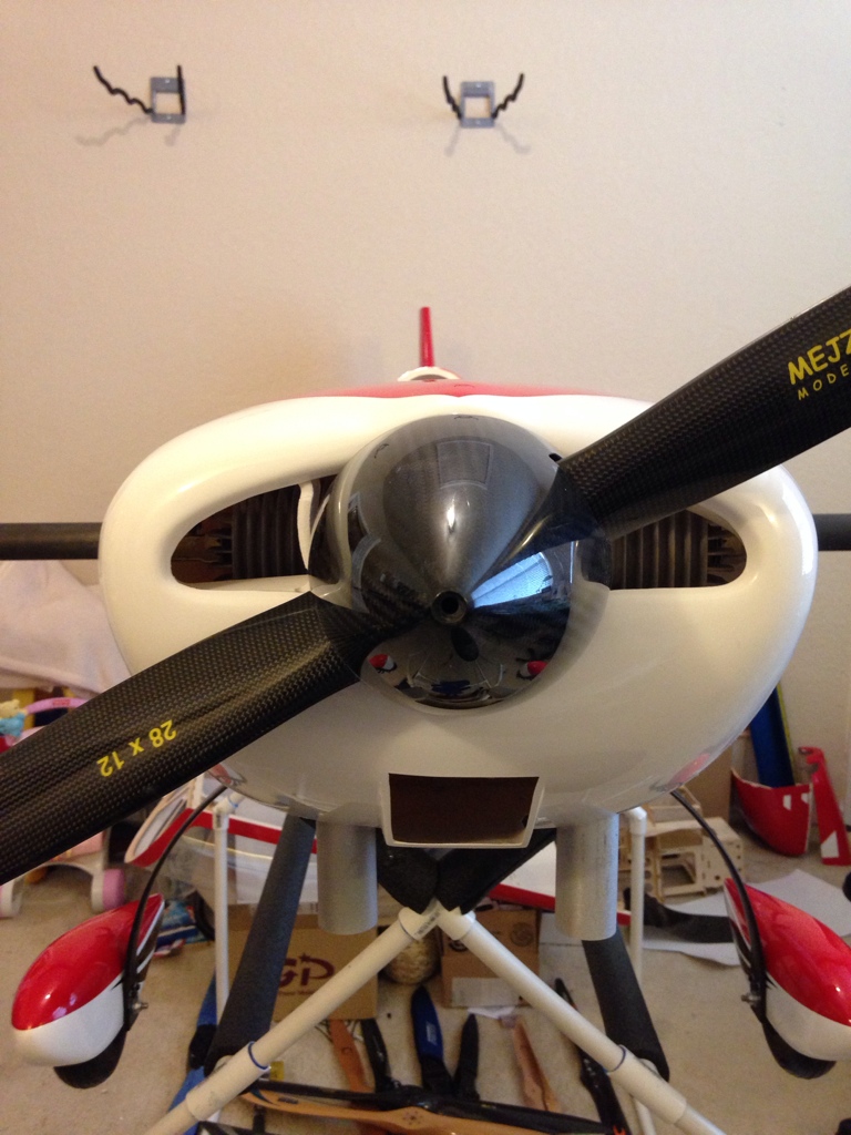

I'm almost done!!!

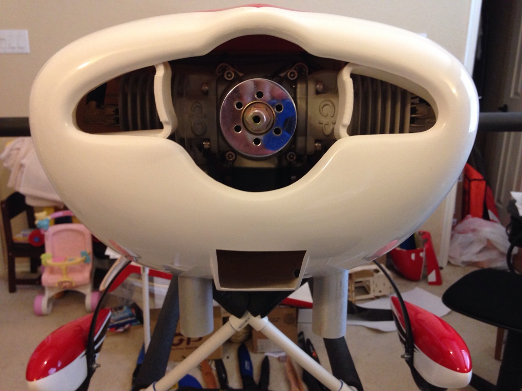

Only need to cut the cowl/vent holes, and mount the prop/spinner.

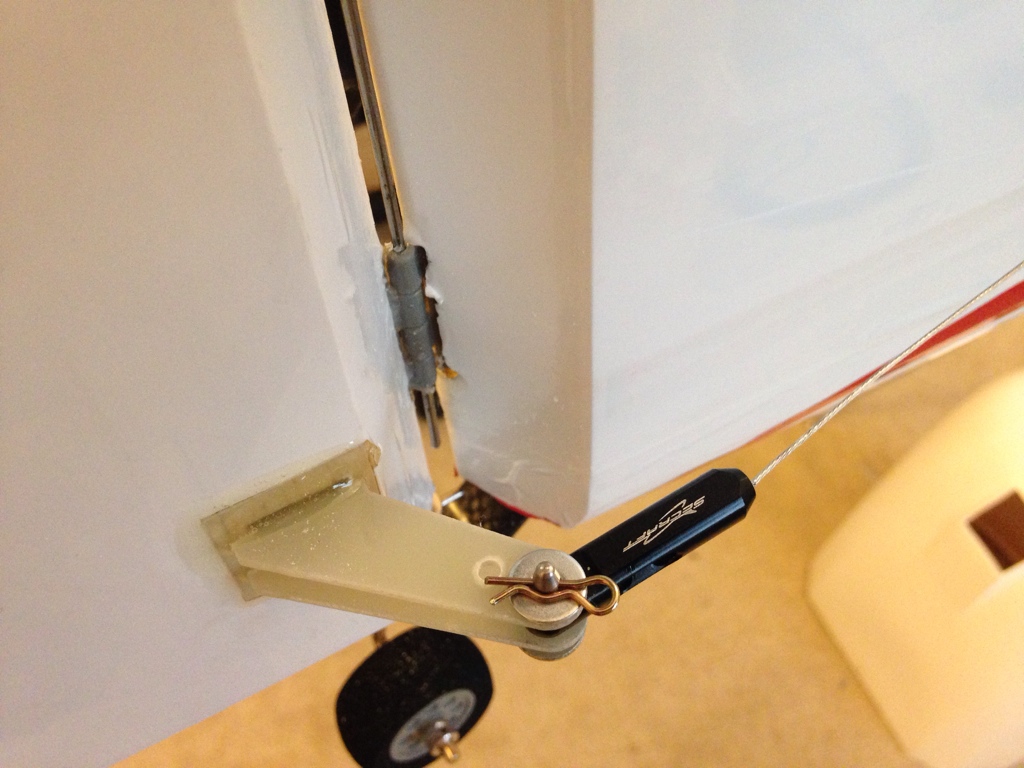

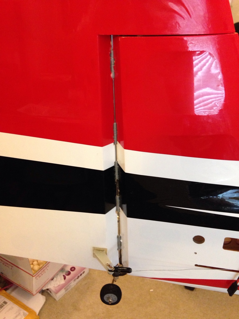

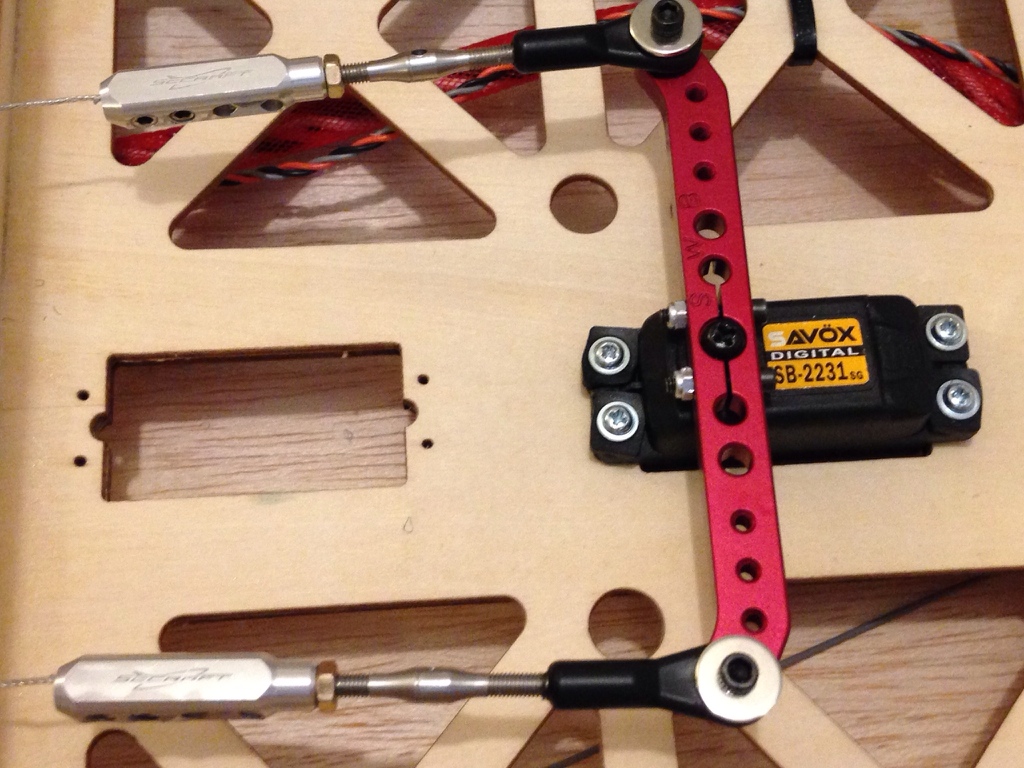

Installed my removable rudder. I'll admit it's not as clean looking as it could have been (as I'd hoped it'd be...) but it's perfectly functional and doesn't bind.
I used some quality Secraft hardware from [MENTION=388]Aztech Aeromodels[/MENTION] to make taking the rudder off a breeze:
All I have to do is pull the cotter pin on both sides, and slide the hinge pin out, and I'm done. Takes about 30 seconds. Very pleased!
Also used the Secraft adjustable turnbuckles for tightening down the wires as they relax a little over time. Functional bling!

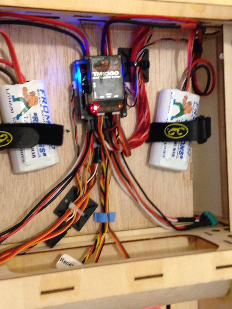

I also finished my wiring, and it's nice and clean. Power is 2 [MENTION=1155]Fromeco[/MENTION] ReLion batteries and a DCUP (not pictured).
I can confidently say she'll be ready for flight by the end of this weekend. Finally!
