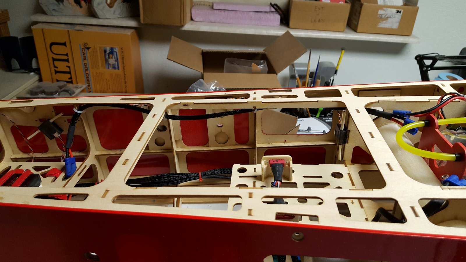

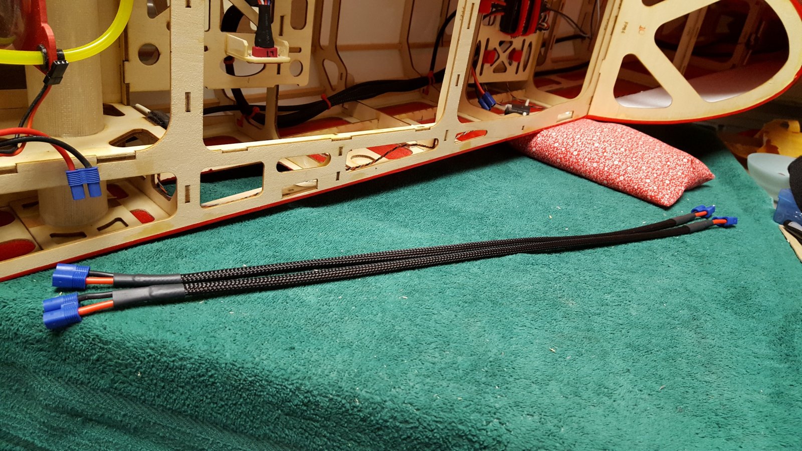

On a better note, last night I made the battery extensions and got them installed. That gets me down to balancing the prop, putting the airplane back on the balancer to check the final CG, test running, and adjusting the throws in my flight modes. Then it will be up to Mother Nature if it flies Sunday or not.
