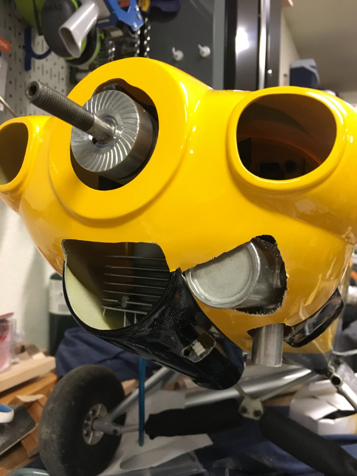

    VVRC 21cc getting fitted with a new cowl. Getting there, just some more trimming needed. Can't wait to fire it up!

  8. AKNick
    AKNick 150cc
    2,184
    3,559
    Alaska
    [​IMG]
    More trimming. Put some foam plugs in the cowl ears too.
