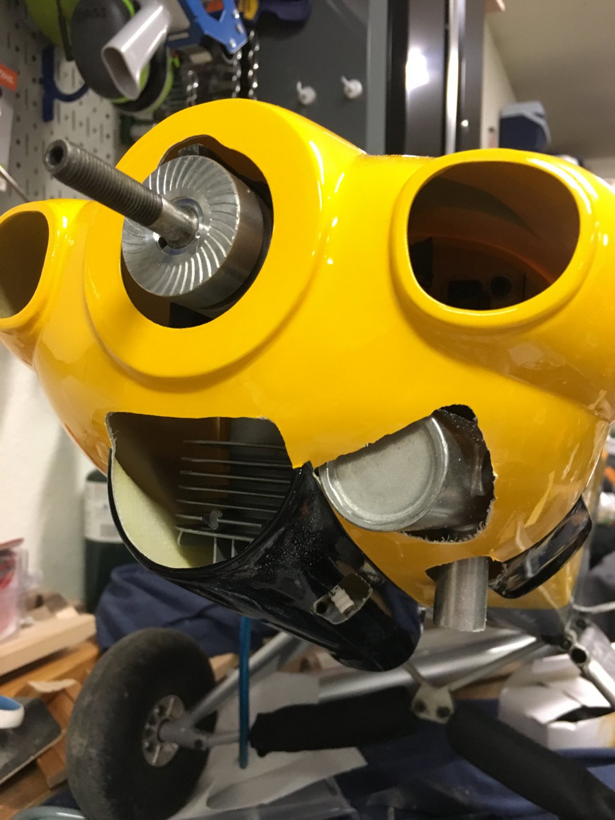

    I'm betting that really thin section of the cowl between the intake and the muffler will eventually crack. I'd reinforce the inside of it with some fiberglass at least to strengthen it up.

    I just realized I never responded to these. Small engine/muffler makes the permatex layer look larger than it was to be honest. But thanks for the feedback.
