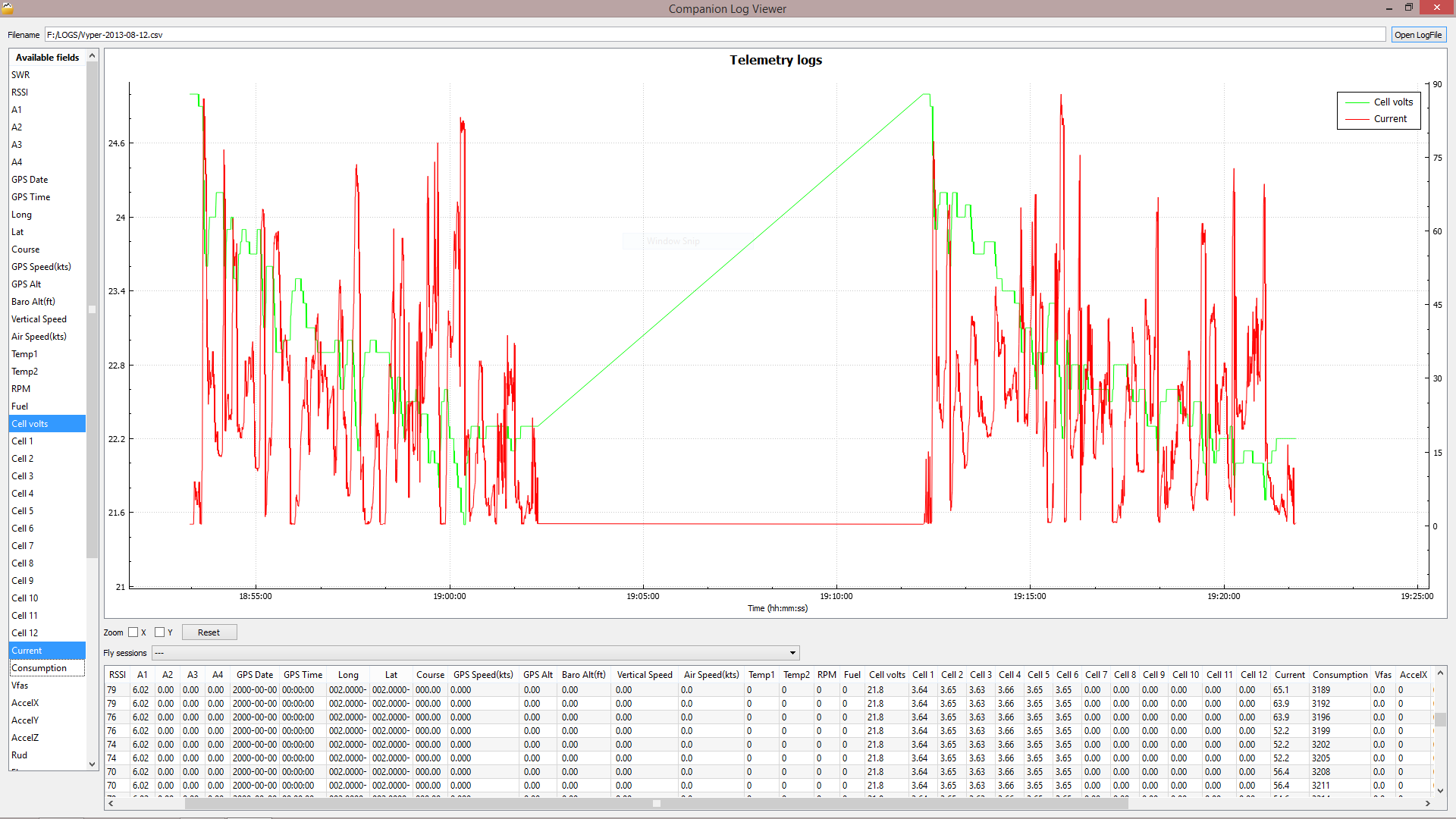

Finally got some data on Motrofly 4320-450kv, 18x8 Xoar, and ZTW 125 Amp with SBEC with the updated firmware. I turned on telemetry logging on my FrSKy Taranis. This is from Wednesday evening. I had two flights. On the full power take off on the first flight, the log tells me that I was pulling 87 amps at 24.7 volts for 2148 watts. The ZTW with the updated firmware is working well with the Motrolfly 4320-450kv. For those of you planning to upgrade the firmware on your ZTW Gecko controllers, be careful not to install the opto ESC firmware onto the SBEC ESC. If you do, you may not like the result (hint: possible smoke coming out of your controller). Make sure that you use the correct firmware.
