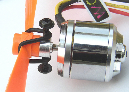

I am assuming that the hardware stays in place and you a just loosing the prop? I had this issue with another set up and it was caused by a loose O ring. What i did was go to the auto parts store and find a O ring that was thicker and just a hair smaller diameter. It was a pain to put it on but the prop did not come off again. I believe what happens is the thrust from the prop is strong enough to stretch the O ring causing it to come off when it is spun up.
hope this helps, let me know if it is something different coming off.
I assume you are installing the prop like so:

Yes that is the problem I was having. I got some different o rings. As you said a little thicker. I also put two on, it is staying on just fine now. Thank you.

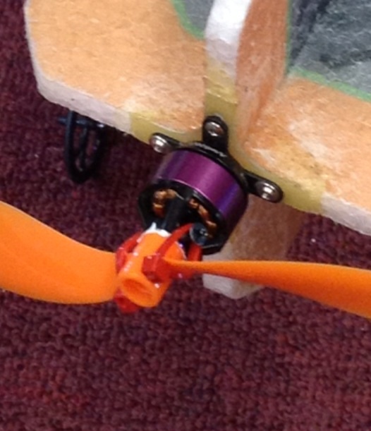

Need some help. I followed this thread and completed the build. I am having a problem. The prop will not stay on. I am using the motor that came with it and got a 8040 prop for it. I used the proper insert that comes with the prop and fit the metal piece into that, place it on the motor and used the o-ring to retain it. Twice it came off with little throttle. Are you supposed to use both of the O-rings or am I just doing something terribly dumb?
FYI this is my first plane that does not have a shaft for the prop. I assumed it wouldn't be too hard.
A couple zip ties does the trick.:way_to_go:
