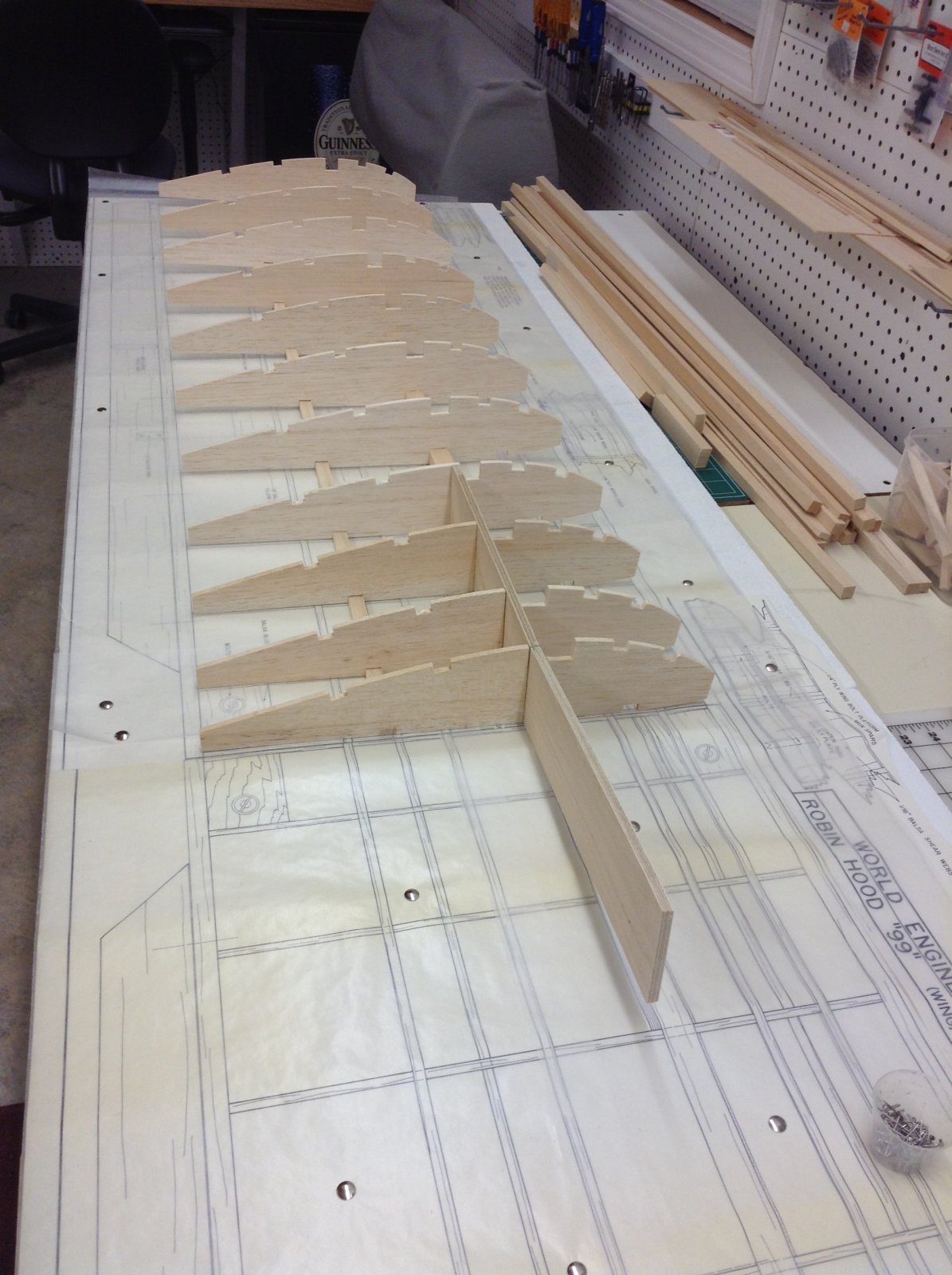

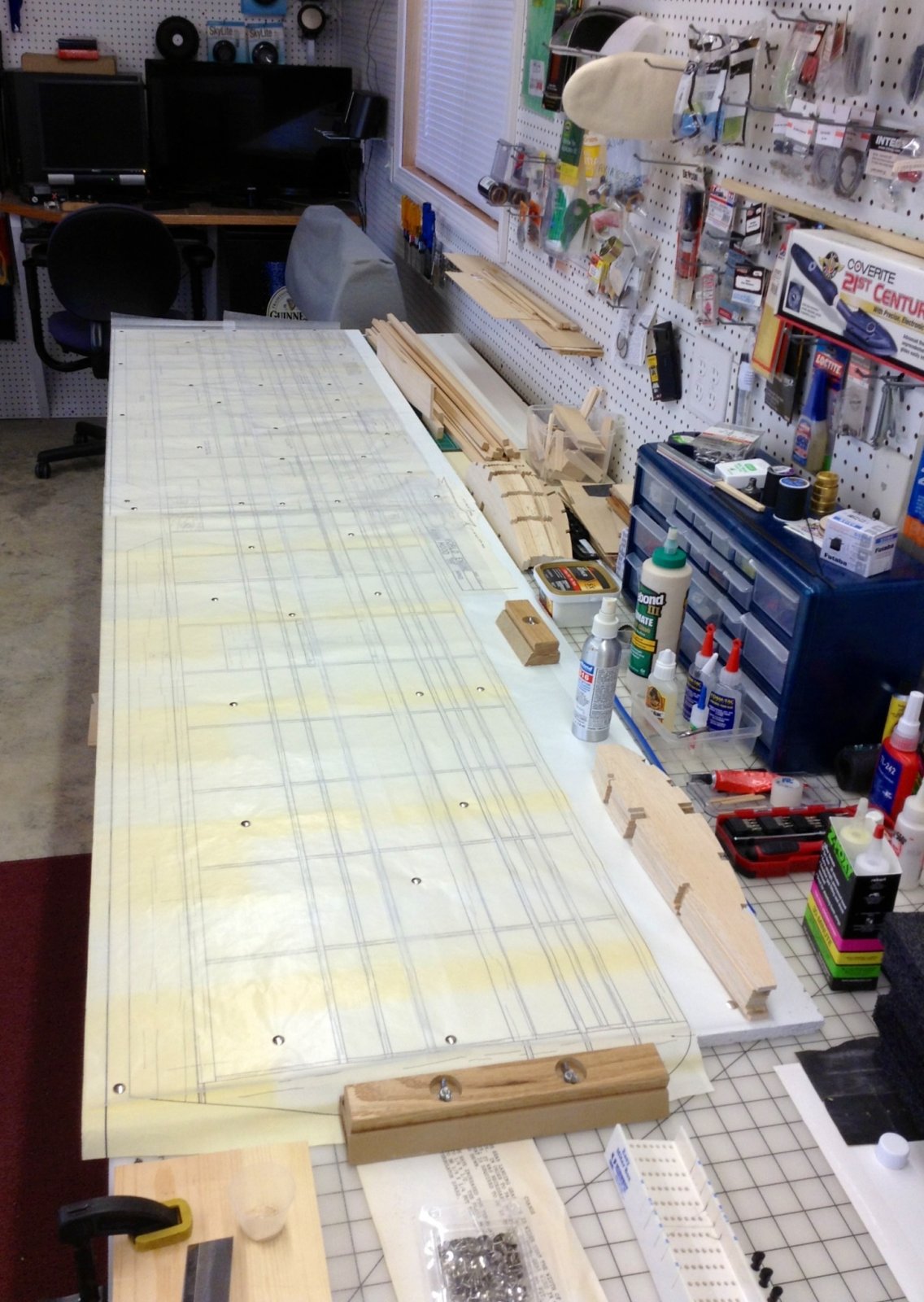

		No glue yet. Just a dry run while I muster up the courage to start smearing some glue on this big O'l wing.

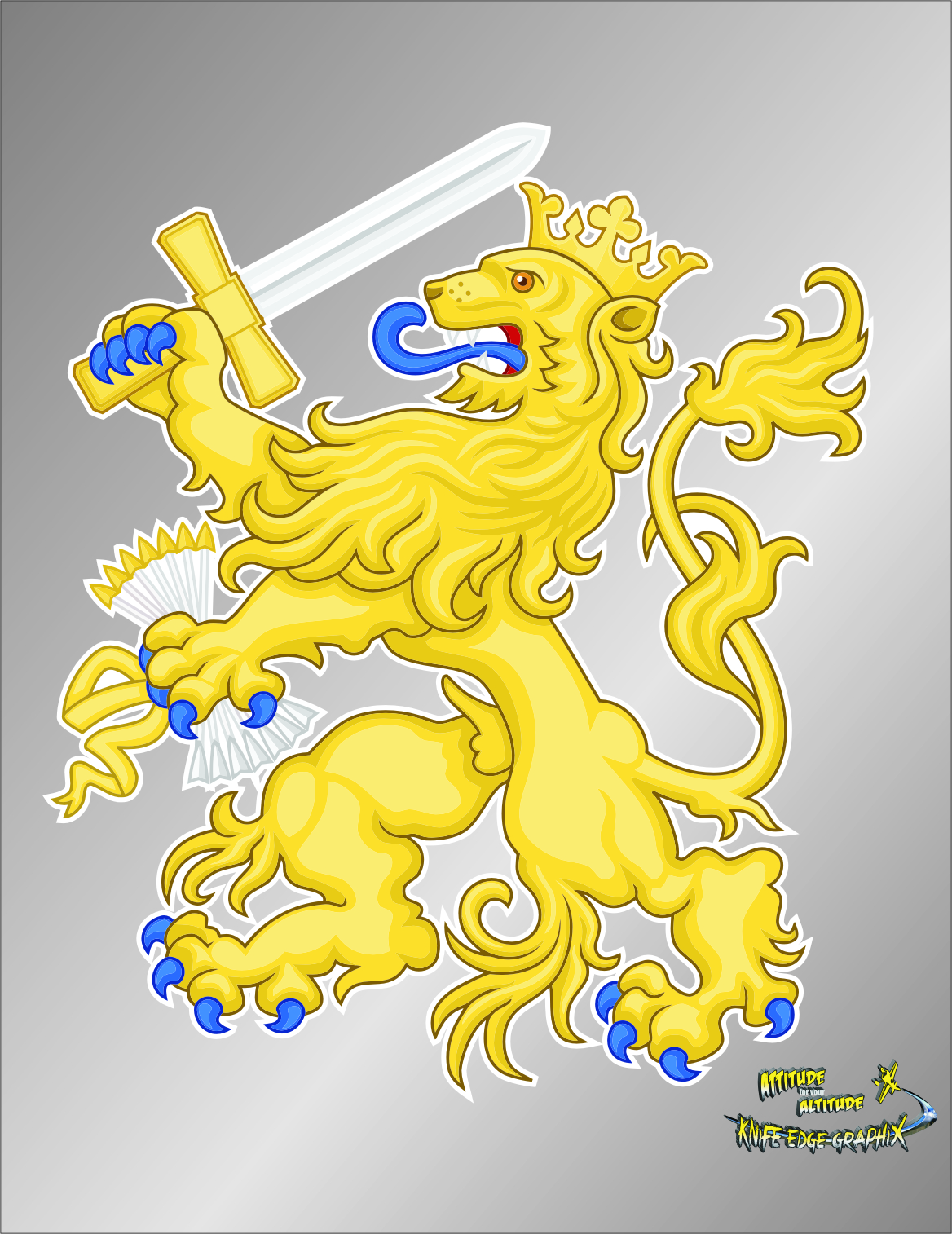

@Decal Dennis my I ask you a question. The picture shown is the arms of Dutch orange brigade. Is it possible to make a decal of with out the red background and the loin shown with a small outline to make it stand out it does have a out line already that my be sufficient.

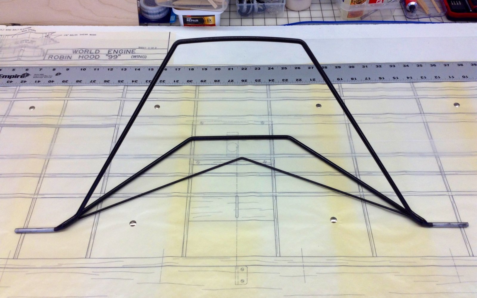

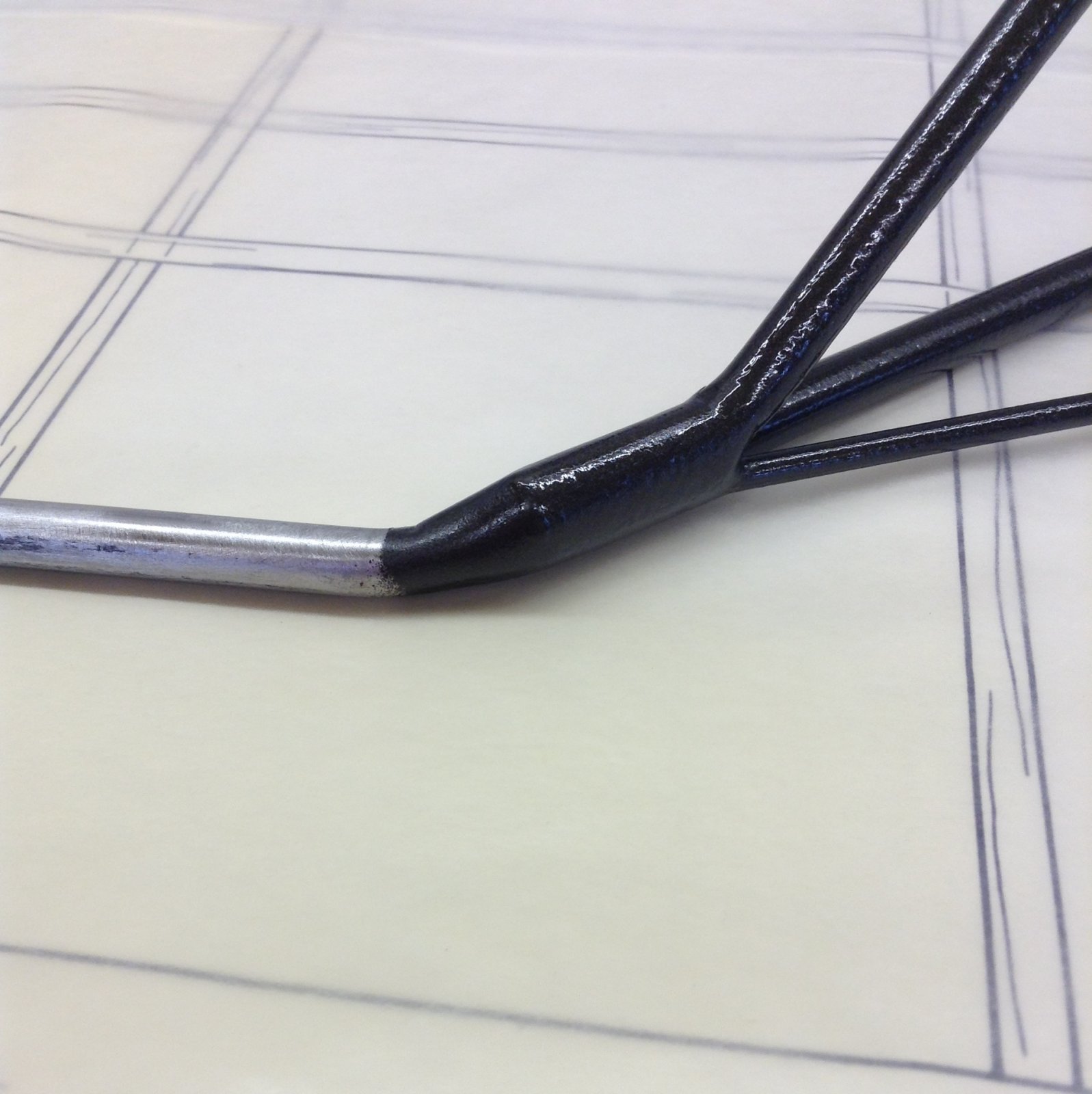

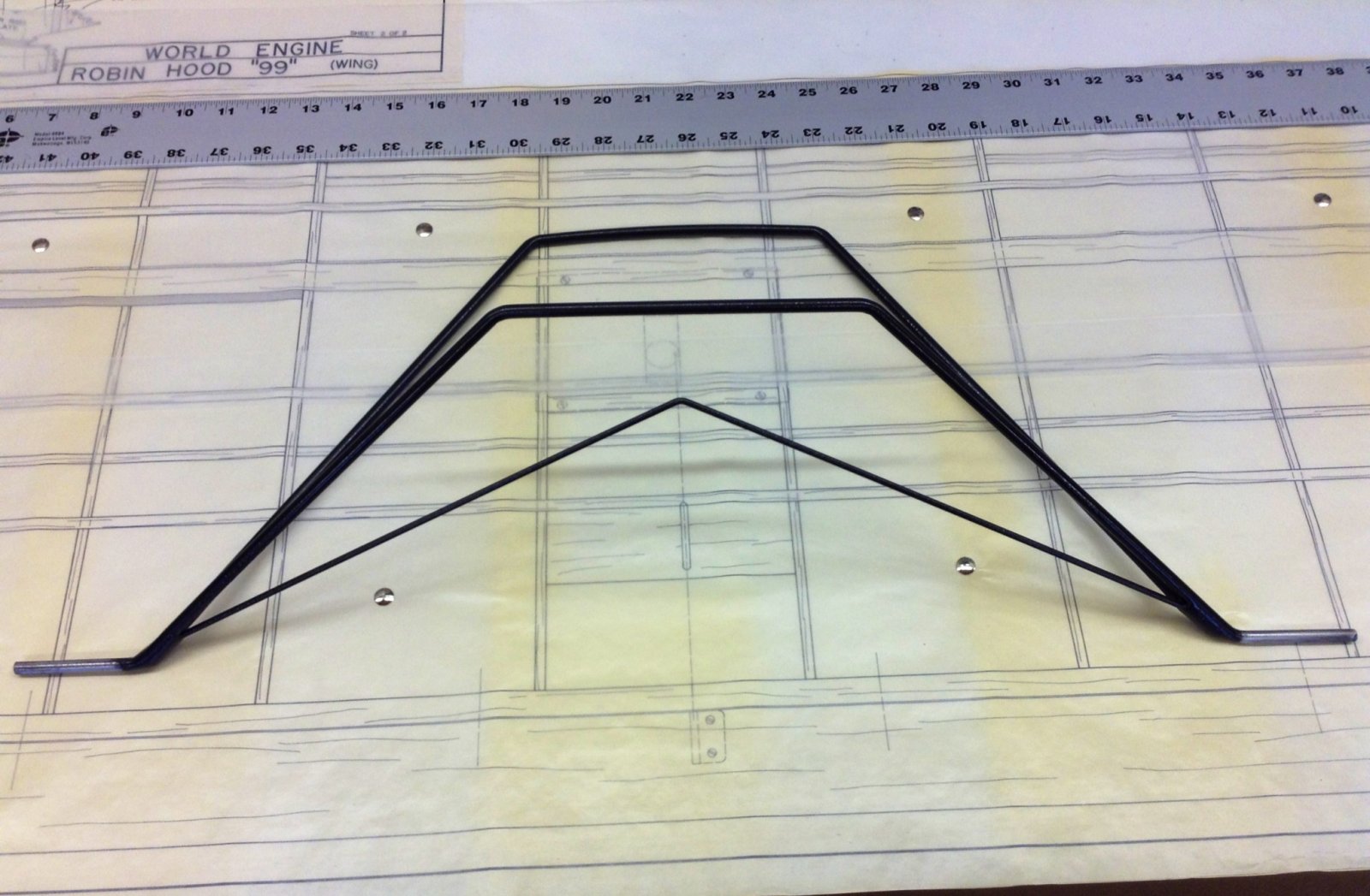

wLanding gear bent, welded and painted. Many thanks to my buddy Kevin Cooper for the awesome welding job and @Decal Dennis for the paint work.

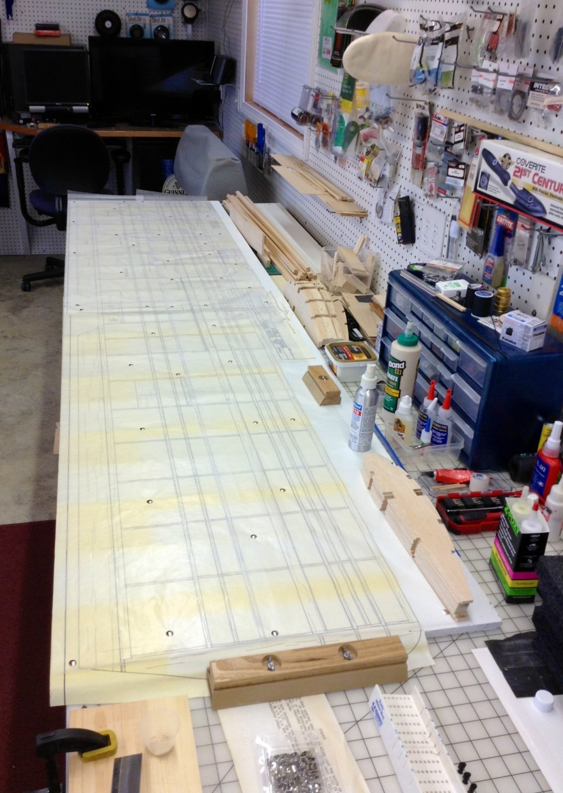

Man hope that is the full wing and not just one half, if it is I can see why you are apprehensive I would be that is big ****wing. Make sure you get all the sparse in correctly.Got the wing plans laid out and covered with wax paper. But now I'm scared to get started. That is one big ass wing! Pic doesn't do it justice.
That is exactly what I meant. Looks great can you give me an email address so that can email you thanks. Sorry for the invasion.

When you say welded. Do you steel welded or silver solder (brazing). Interested to know if you did do the proper silver solder how did you do it and where did you get the solder.
You had better get a big soft padded wing bag for that it will suffer from Hanger rash for sure at that size.Kevin used a mig welder on the landing gear.
Yes that is the whole wing. 99" one piece wing. Would like to have made it a two piece for easier transport, but with the dihedral it would have been a real pain in the arse. I could have built a two piece without dihedral pretty easily. But the whole purpose of this build is to have an easy lazy day flyer.
