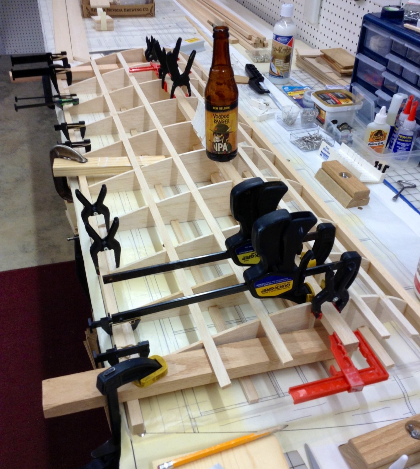

Dang. Takes a lot of clamps to stick build a toy airplane.
Clamps on wooden structure: Good
The IPA is what keeps me going.Clamps on wooden structure: Good
Spilt beer on wooden structure: Not so much.
Drink that brew, and another and another and.... Oh, you want that wing straight??? Lol

Sorry didn't check back for a few days, I really like the Titebond CA because it does not get brittle like other CA's and it also bonds really well with plywood. Apply in in two coats. First a bead with parts clamped together in their final position, let that bead soak in and cure for a couple minutes and then apply another bead. After curing is an amazing bond. Again, not starting the glue debate but tested right next to Zap it is no where near as apt to get brittle. Especially if you use accelerator which you should try to use sparingly.

Are sure you want to build this as a one piece wing you still have the opportunity to make it a 2 piece wing with a tube. If I was building this plane it would be a 2 piece wing. This takes me back in the days when I first got into so called giant scale in the days all the wings from Ohio RC and Midwest were all 80 inches and up and one piece and they were a really pain in the A** to work on and carry around.
