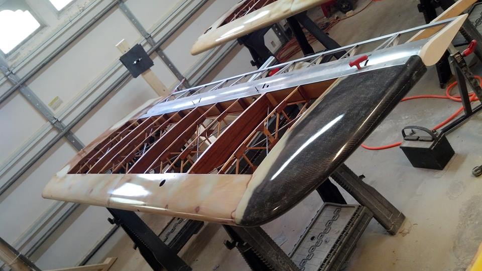

Agree with you on the round wing tips. Those are from the plans built version.
Photo below courtesy of a full scale Model 12 builder. These are the wing tips I referred to above as "Thor" and my personal favorite.

Yup...those be the ones. (Second photo) I first considered the wingtips like the one in this photo.
I like the Round wingtips, they just say "Pitts" but to be completely honest on the M12's I like the half round ones.

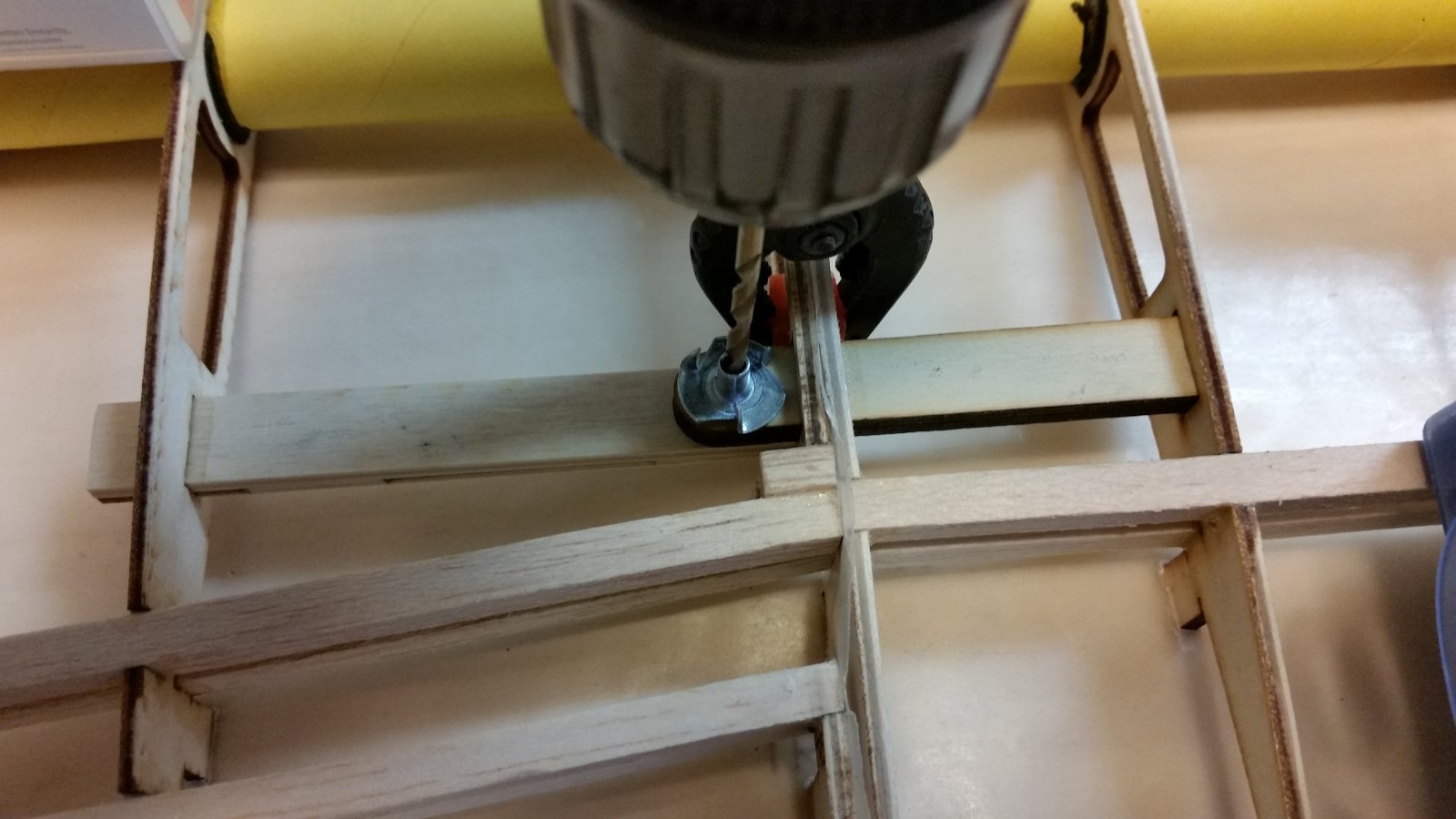

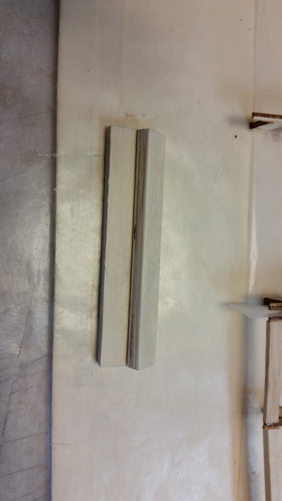

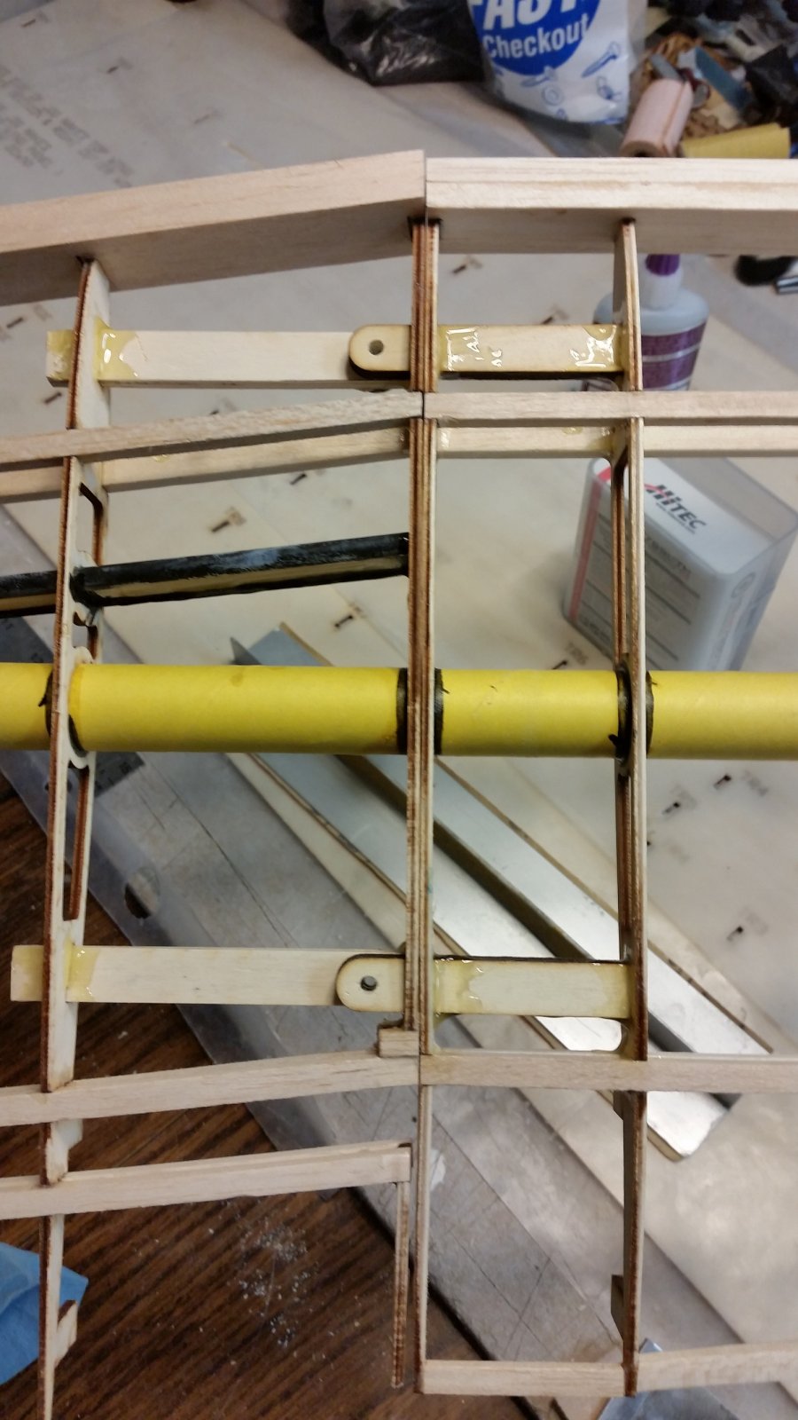

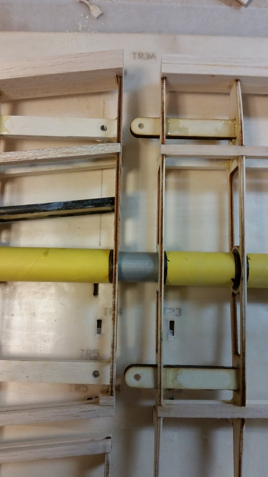

Thank you for the vote of confidence and for your comment. I do absolutely agree with you about taking a break. I must be a gluten for punishment, because after I ran off to the store for a Pepsi, I took a minute to look back over the issues I was having. Ah ha! I can fix this. I started by taking some 1/8" light ply strips and laminated them to make 1/4" plates. These plates, or strips would be my new bolt down blocks. After opening up the slots in the ribs to accommodate the ply plates, I slid them into position so they came flush with the TR4 rib. Then sliding the original center section bolt down plates into position, (which by the way were the ones that were intended for the wing halves) They overlapped perfectly.

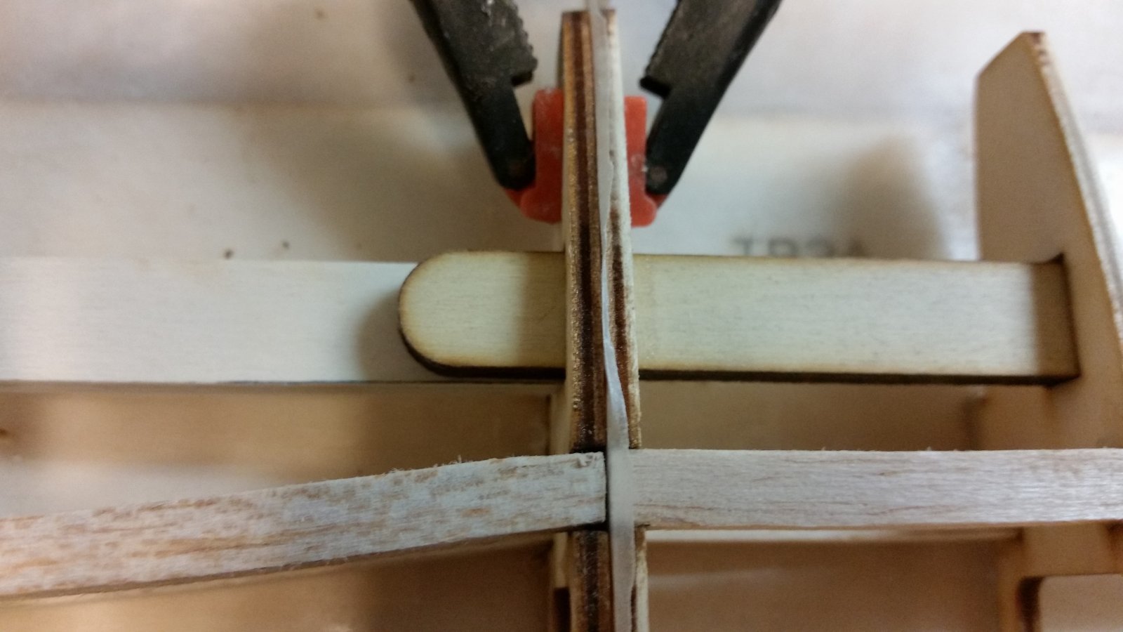

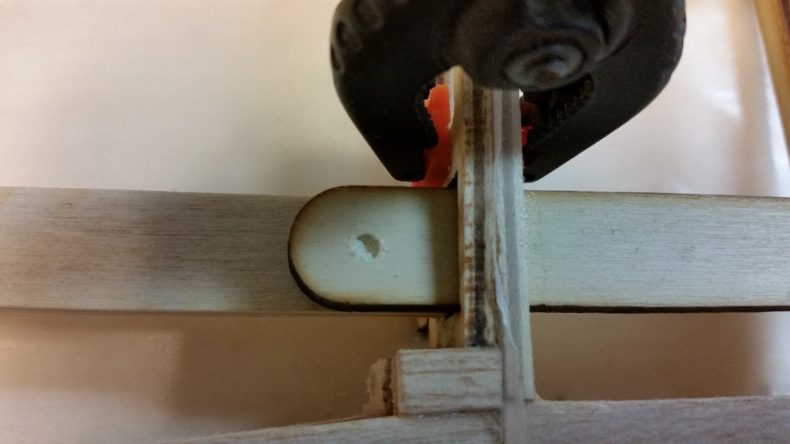

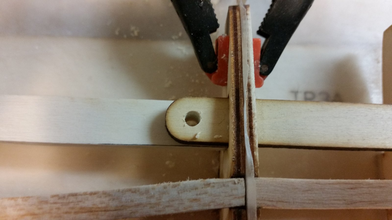

Next I used the 6/32 blind nut to use as a guide for spacing the hole that I drilled through the two bolt down blocks. (Leading edge and trailing edge of wing). Once I had a small divot started, I removed the blind nut and finished the holes.
After that, it was pretty much all down hill. I tack glued the blocks into position long enough to make sure the two sections fit correctly and would slide apart and back together with no issues. After I was sure the TR4 rib of the center section and TR5 rib of the wing matched perfectly, I epoxied the blocks into place and installed the blind nuts.
Time to slide the two together for a dry fit. WOW!!!! They slide together and "snapped" into place like a boss. Actually very pleased with the snug and precise fit of the two sections.

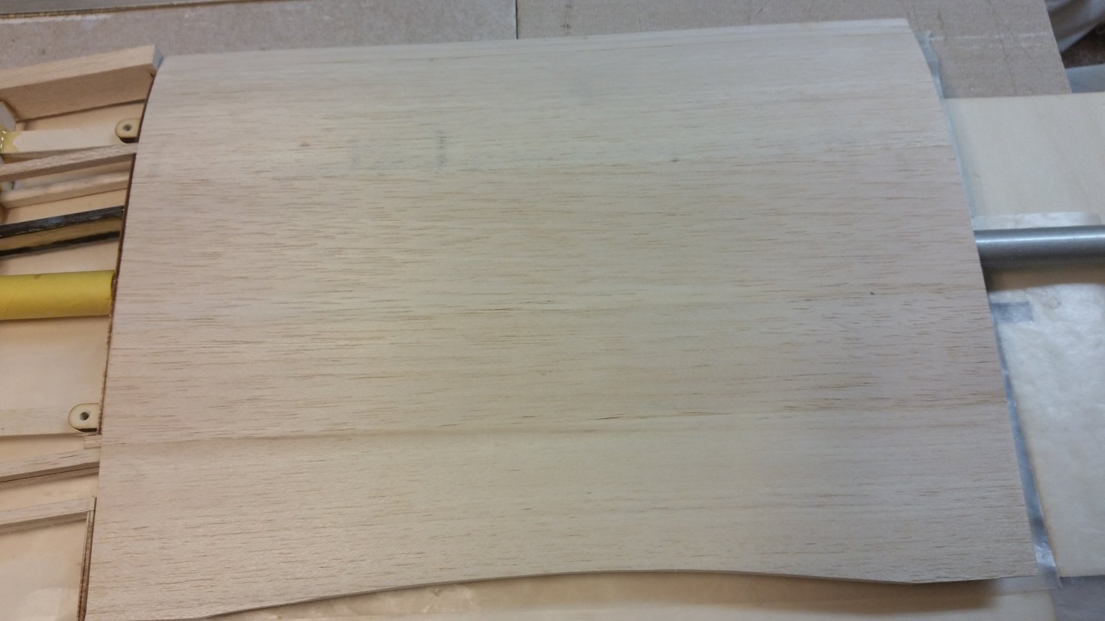

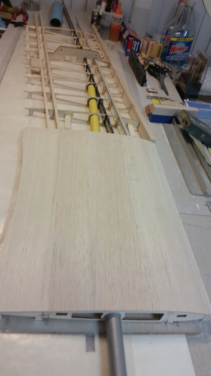

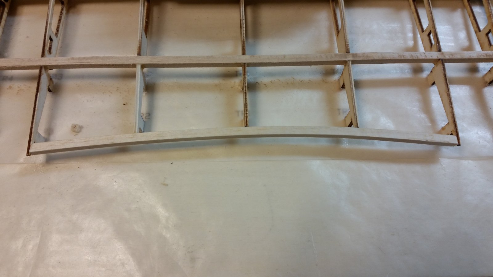

I also addressed the trailing edge of the center section. The way it is designed to be built, sheeting goes on the bottom of the center section, then flipped over and sheeting on the top. With both top and bottom sheeting coming together at the trailing edge. I didn't feel this would be a good idea especially since the curvature of the trailing edge in the center will be sanded to an "arched" shape. It was a suggestion from Brett, @Wacobipe to add some structure in that area so that there is something more to sand and give the proper arch and shape. I used 1/4" square balsa. That worked really slick. Now I will be able to sand not only the arch without the sheeting separating, but will also be able to give the trailing edge of the sheeting a nice constant edge like the rest of the wing.
I got a head of myself and sheeted the center section. It should have been done "AFTER" I set the section on the cabane struts and drilled the bolt down plates for the center section. Oh well, I will deal with it. Not that big of an issue, I'll get it. I do have to admit, the wing is really taking shape and looks, (and fits) very nice.
Just a little basic sanding to get an idea of how she is going to look. Like the rest of the wings, fuse and tail feathers...everything will get a final "sanding" and "shaping" once the construction is complete and I am ready to cover.
