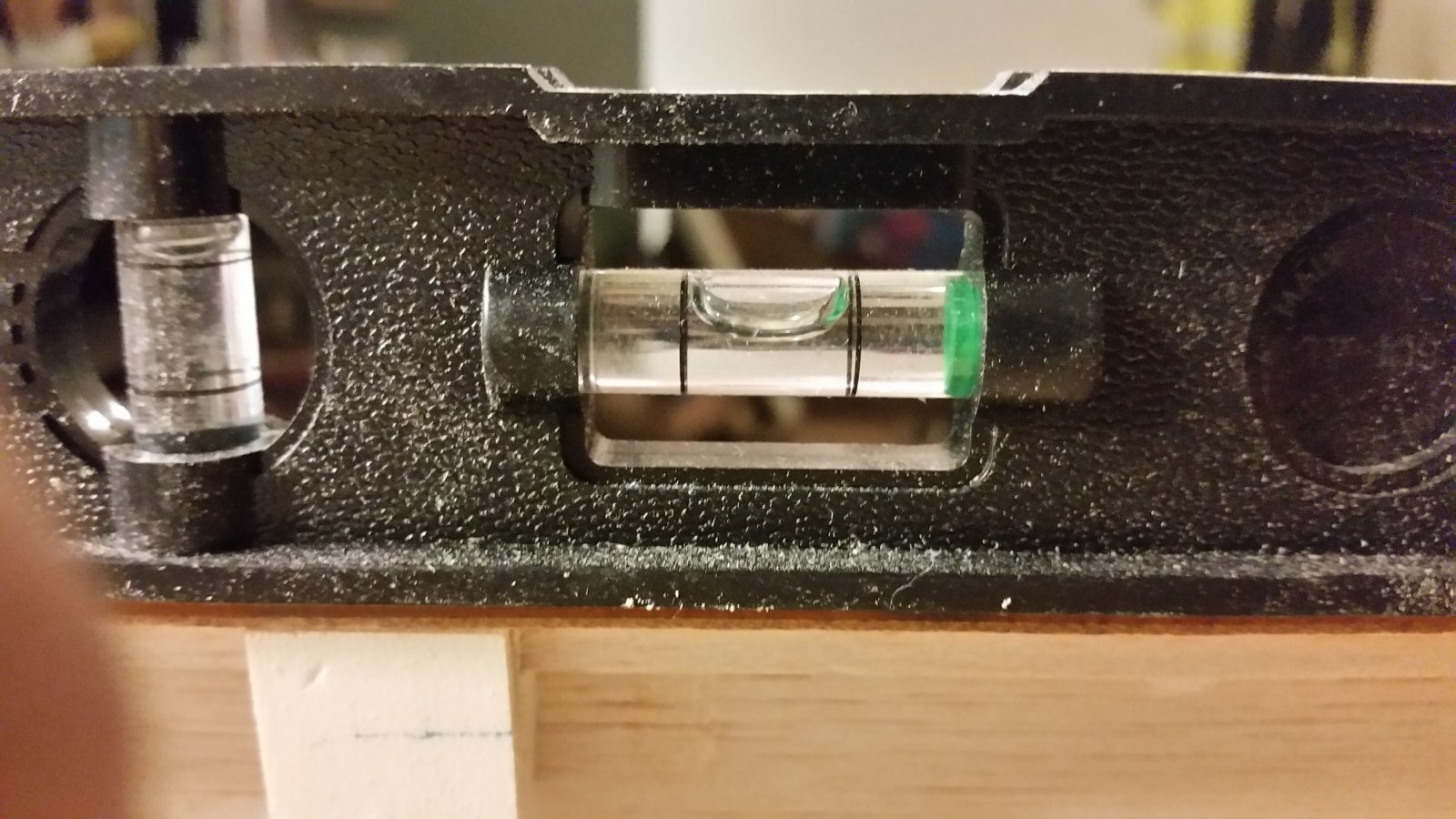

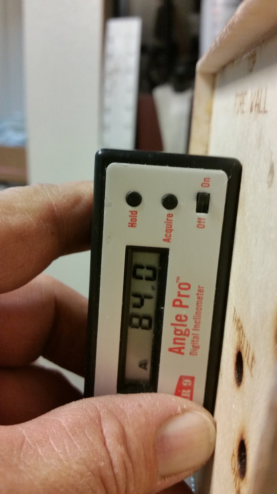

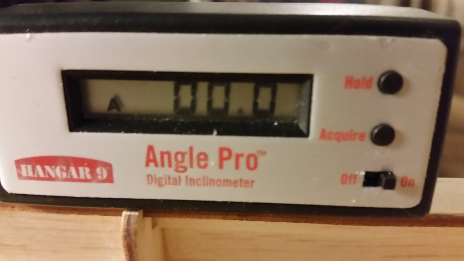

I understand and fully agree with the "right" thrust. I am fully aware of that. However rough guess on "up" thrust is around 2 degrees or more. I will put my digital meter on it this evening for a more precise measurement. I was not aware of the need for so much "up" thrust on any plane.
Aren't you always? Bwaahaa haa haaUp/Down thrust just depends on where the engine is placed in relation to the centerline of the airplane... Or so I thought, I could just be talking out of my rear here...![]()
6 Degrees "UP" thrust.All the pitts have 2 degrees up thrust in them. I verified both on the fuse we have here and the AutoCAD files to confirm.
While the "wedge" would be an option, I believe I am just going to use slightly longer standoffs in the top motor mounts. I should not need much extra length.Well it's good you found that out now
Seems like the easiest solution is going to either add an angled shim in place over the firewall or do some trickery with the structure...
