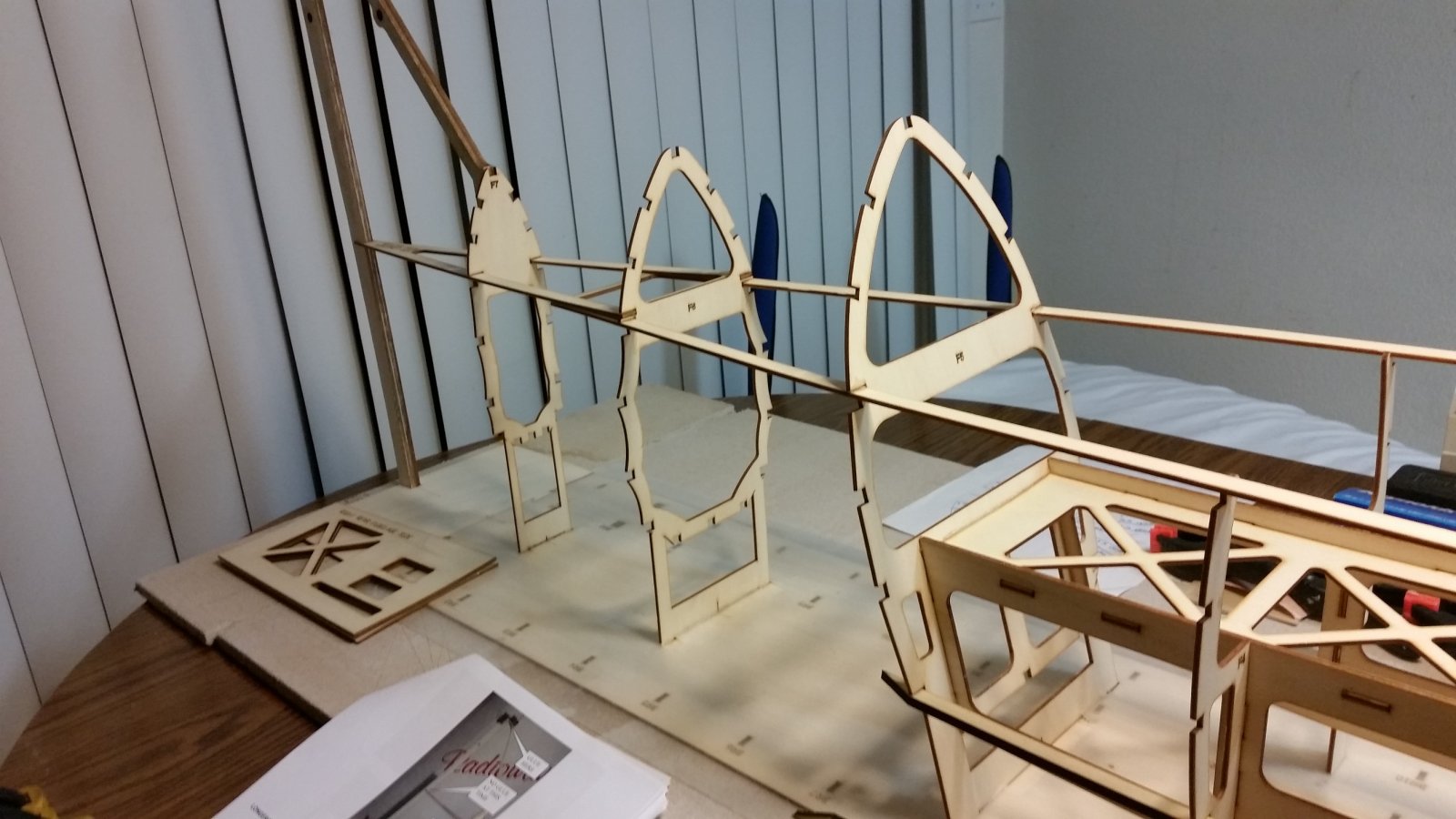

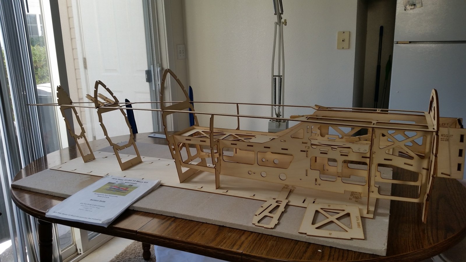

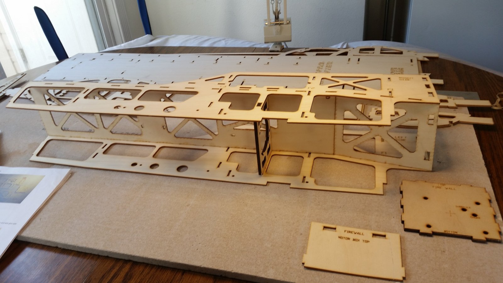

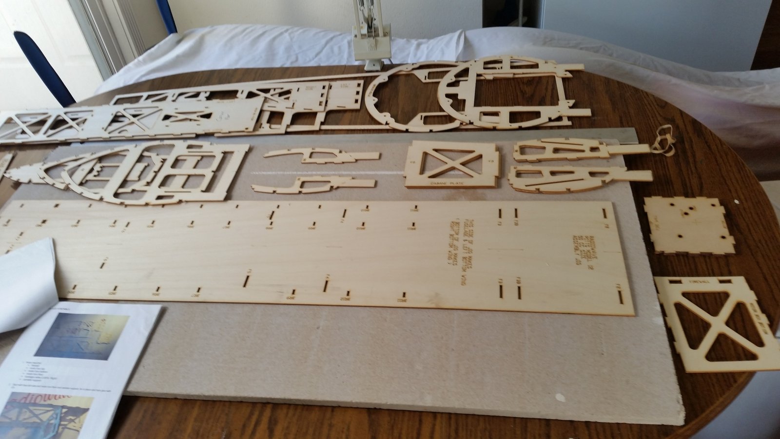

Thanks guys.... I decided to use the Gorilla. I think it "tacks" just a tad quicker. I was able to get the Pitts on the table and jig today. I started by disassembling the prefit parts. Who says your dinner table is for eating meals? hee hee....

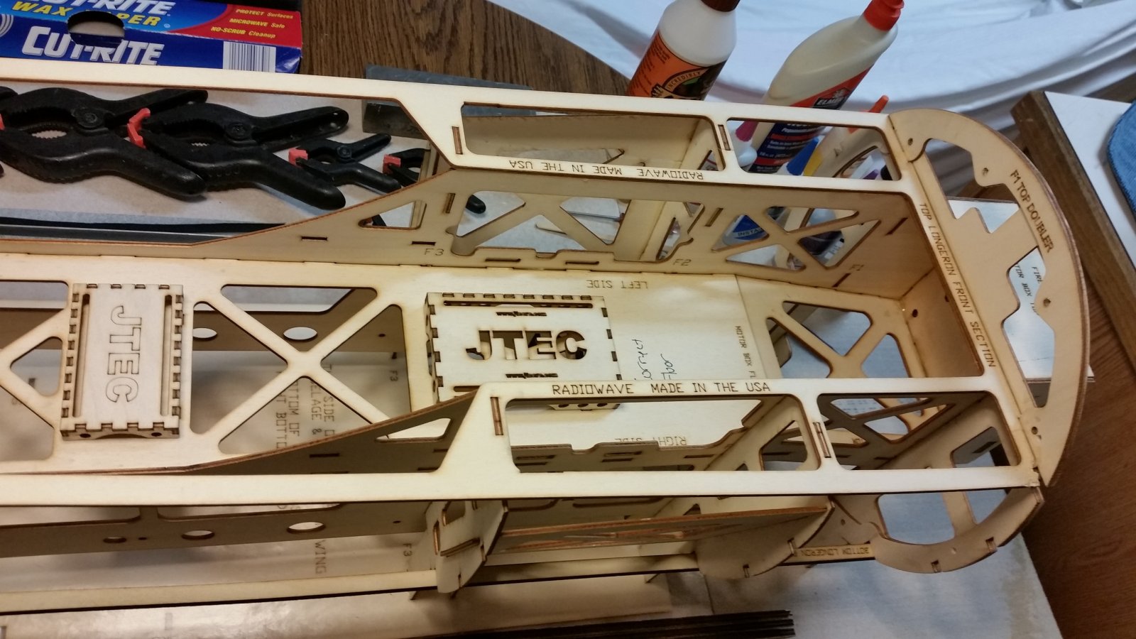

After separating all the required parts for the beginning steps, I started with the motor box sides and associated parts and canister support. It's been a very long time since I actually assembled a plane from sticks, so I am taking my time to make sure I do this right. I did find myself confused once or twice, but it didn't take long to figure things out. I now have the major fuse construction framed up and all joints are glued in place. I am quite impressed of how everything is lining up so darned straight after this thing sitting in a box for so long. With the supplied jig for the fuse and the wings, A guy would have to try really hard to get this fuse twisted or crooked. Hey, this thing is coming right along. I need to get a few supplies tomorrow to finish the fuse framing and then on to the wings.

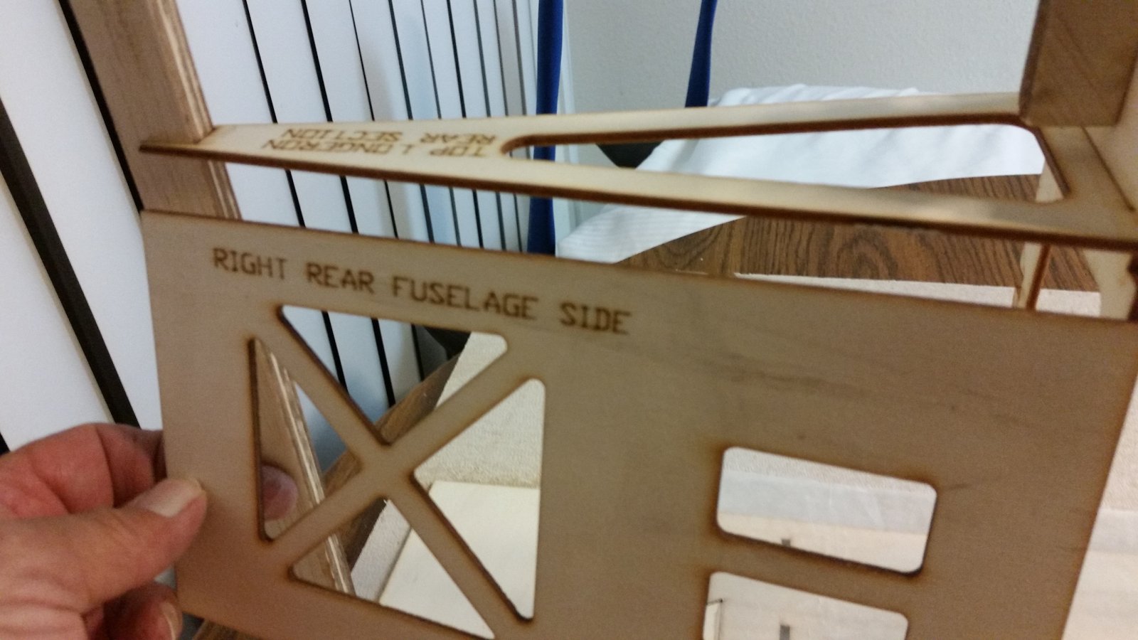

I do have one question to the guys that have built this plane. The rear fuse side panels will be next to be placed. But I am a little lost on this step. Can someone tell me if the "rear fuse sides" glue "ON" and flush with the top of the rear fuse longeron? Or do they actually glue "under" and flush with that same longeron? According to the photo in the manual, it looks as though they are to be glued "under". But they just really do not have a good fit putting them in as such. If however you lay them against the side of the longeron from F7 to the trailing edge for the fin, they seem to fit quite nicely. Can someone give me a little direction?

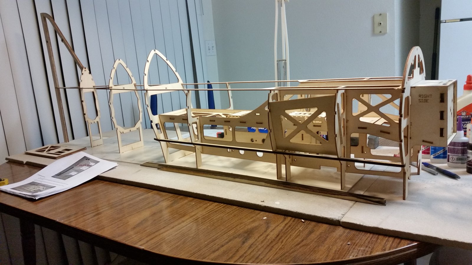

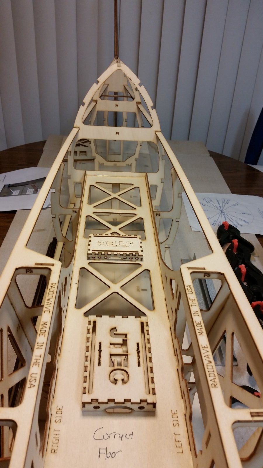

Here are a few photos of todays progress.
