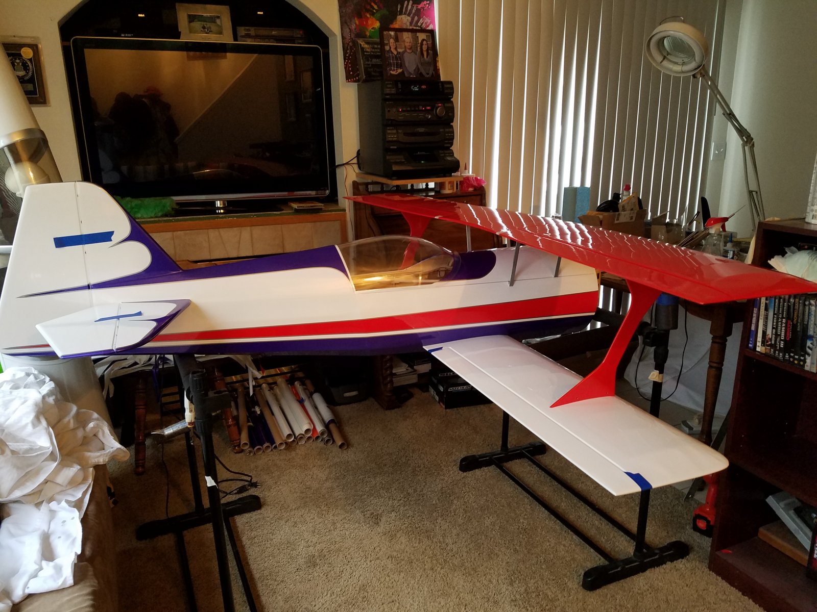

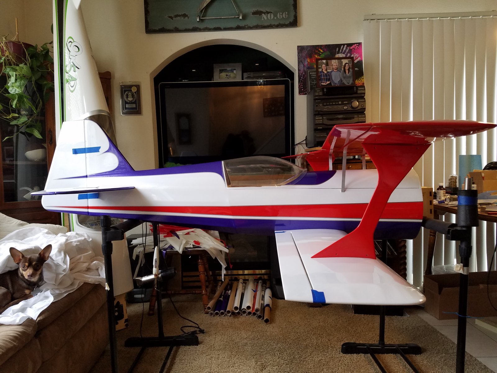

    Just did a quick weighing of everything. Without wiring, including everything else she's coming in at 21 lbs., 8.4 ounces. Taking into consideration last minute nuts, bolts and hardware and harnesses, I should still be able to make under 25 lbs. This could be lots of fun with the "Dub" 70 up front.

    That is GORGEOUS!!
    And an excellent addition to any living room!

    I belive you made the right choice it does look good.

    Hey thanks...it looks much prettier than I had envisioned. You hit zero? Is that all? Hit me up when you hit 30 below and the snow is taler than your pooch. (X10) lol... I can't believe this crazy weather.
